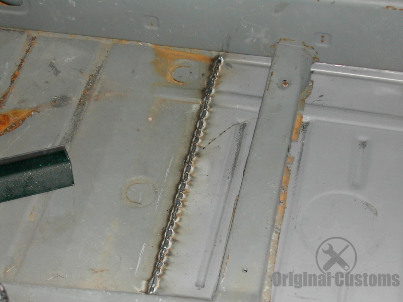

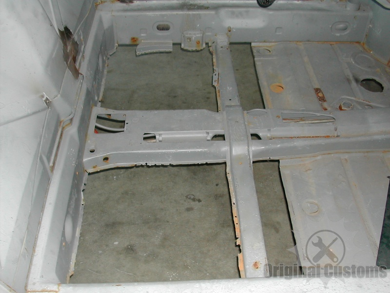

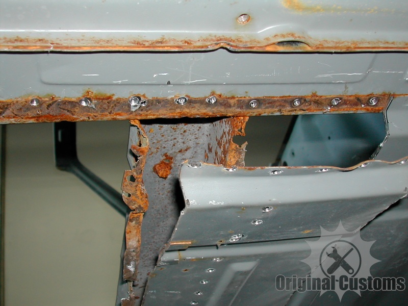

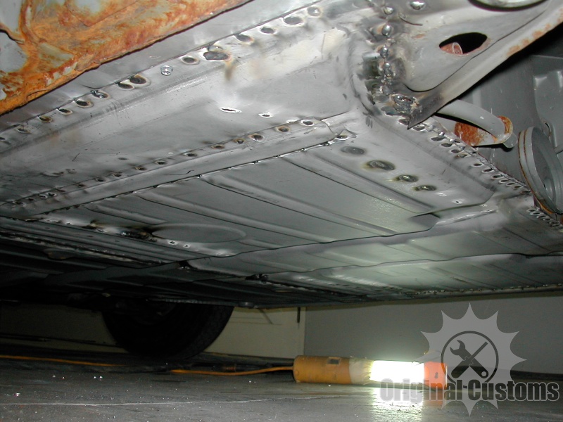

Here's what I did.

I drilled out the spot welds when I removed the old floor pan.. The car currently looks like McMarks second pic..
I will take out that last inch and butt weld the floor pan in.. Thanks for the advice !
