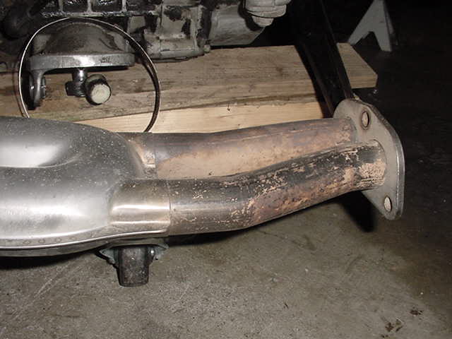

here is a 2.0 he. they have a very slight upsweep at the flange. the 1.7/1.8 have a pronounced turn up. maybe 2".
kevin
