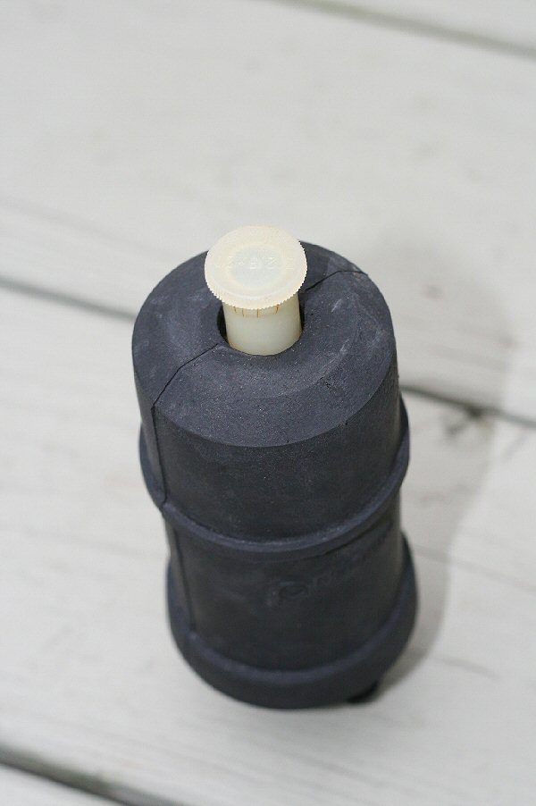

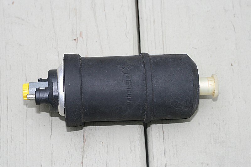

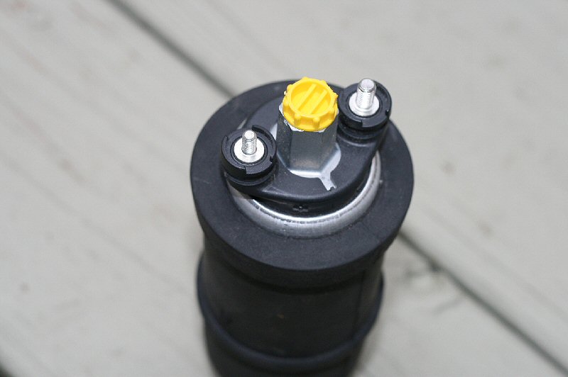

I was going through my stuff this morning and I found a new fuel pump someone gave me a long time ago. I went online to try to find what it fits but the pump has no markings except for the name "Pierburg."
Are there any Pierburg experts out there that might point me in the right direction?
Pictures attached. Thank you in advance.
Terry

A rotary pump for carbs? What's the mod #?

Pierburg makes a wide range of pumps in different pressure and volume specifications. Might wanna slip off the insulation and see if there are any identifying marks on the body of the pump.

You are much smarter than me! Why didn't I think of that!
I removed the insulation and there is markings on the pump!
99T183 and 7.21565.00
Does anyone know what these markings mean?
Terry

It's a "universal fit" pump, but the pressure output is suited to /6 CIS systems.
SPECS:
EXTERNAL FUEL PUMP
150 LPH @ 5BAR
INLET CONNECTION 15mm(1/2)
OUTLET CONNECTION M12X1.5
LENGTH: 200 mm
DIAMETER: 42 mm or 60 mm (with rubber sleeve)
MAX POWER/Cons(Amps): 10
CROSS REF:
BOSCH: #0580464070, #0580464008, #058046491
All you need to add is the check valve fitting at the outlet end.
