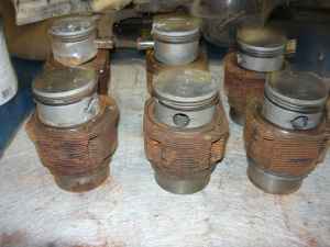

Are P/Cs within spec or do they need to be replaced? Heads need to be rebuilt?

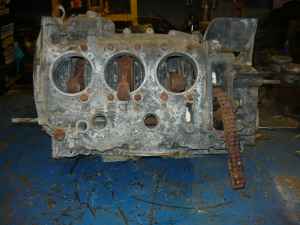

I looked the same ad a couple days ago and here's my opinion.... Your going to have a ton of $$ in this due to the condition of everything. Had it been stored where the weather could get to it, it would be a nice deal. However, the rust on the rods is a good indicator of terrible storage location. Usually a 6 rebuild is around 6k from what I've seen and that is a bare bones rebuild assuming you have good components to start with. I would honestly look for a recently rebuilt engine, you'll have probably half the money in it after it is all said and done.

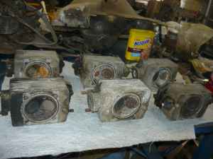

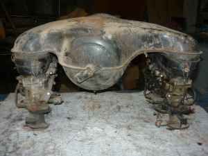

But the carbs are worth something and the heads and maybe the crankshaft,
400 carbs Dan Root was looking for some
100 heads me
100-300 crank 911s registry.

Did he use it as a saltwater boat anchor? If it's a 2.2 T the cranks aren't counter weighted. Junk IMHO. Heads and maybe carbs are all that's worth saving. They would both need lots of work to make useable.

IMO, the REAL question is how much the seller would pay you to haul it off. It's SCRAP.

Thanks guys. Basically confirmed my suspicion. The guy hasn't replied to my email asking a few basic questions, so I am assuming he knows it is junk. (IMG:style_emoticons/default/icon8.gif)

Junk is a kind assessment on that picture you posted of the T parts.
I have a working 2.2 with Zenith's from THOMAS. I would use those parts to hold down my day tent in a strong wind.

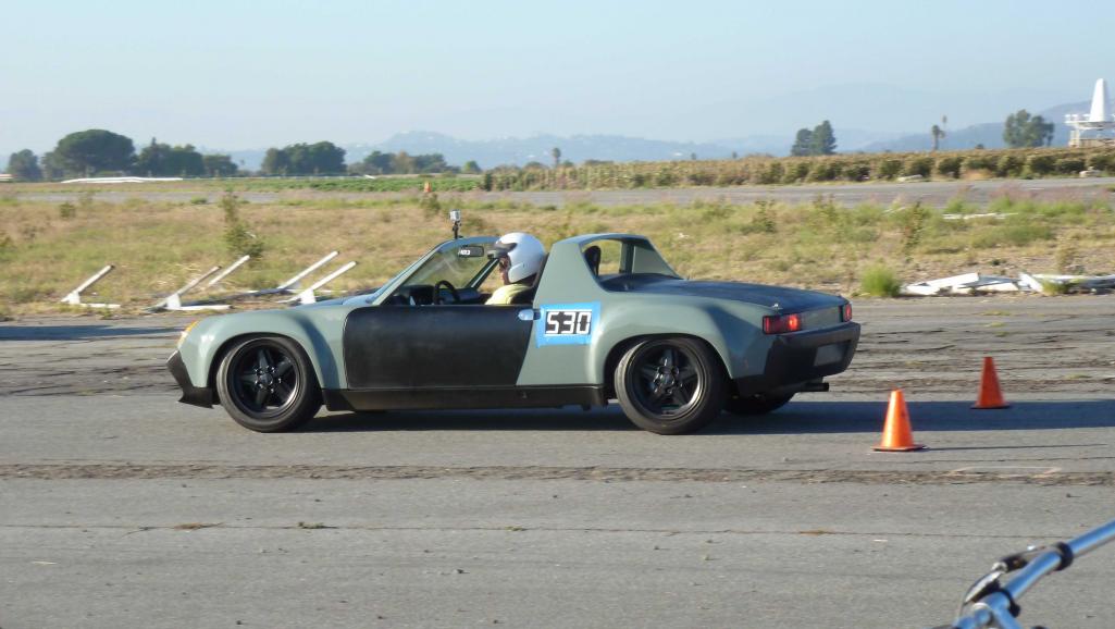

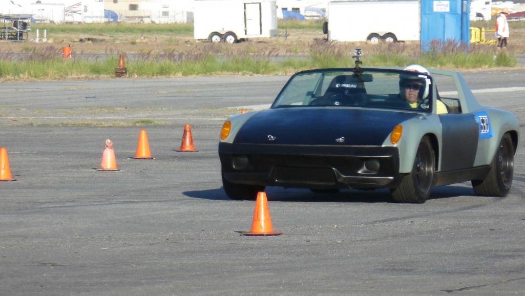

BTW, a T motor was not my first choice, but THOMAS did such a GREAT job on The Dark Knight, that I hardly had to do anything to make it scream on the 16th at the PCAOCR AX.
He did the tensioner upgrade and it does have an early Marelli (retard only vacuum). No Problemo!
Here are some pics. FLAT in the turns, and I was banging third gear to 5.4K rpm.
That is a lot for an engine that has basically 6 hours on it. Again, a 72 T with Zeniths.
