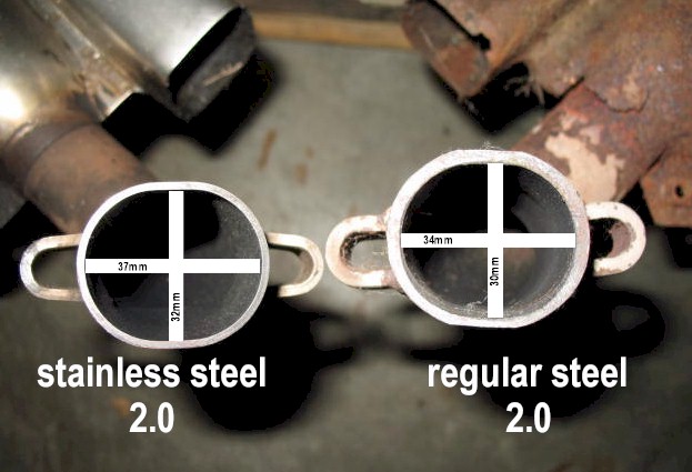

Ports at the muffler end same dia. Ports at the head are just slightly bigger on the SSi's.
