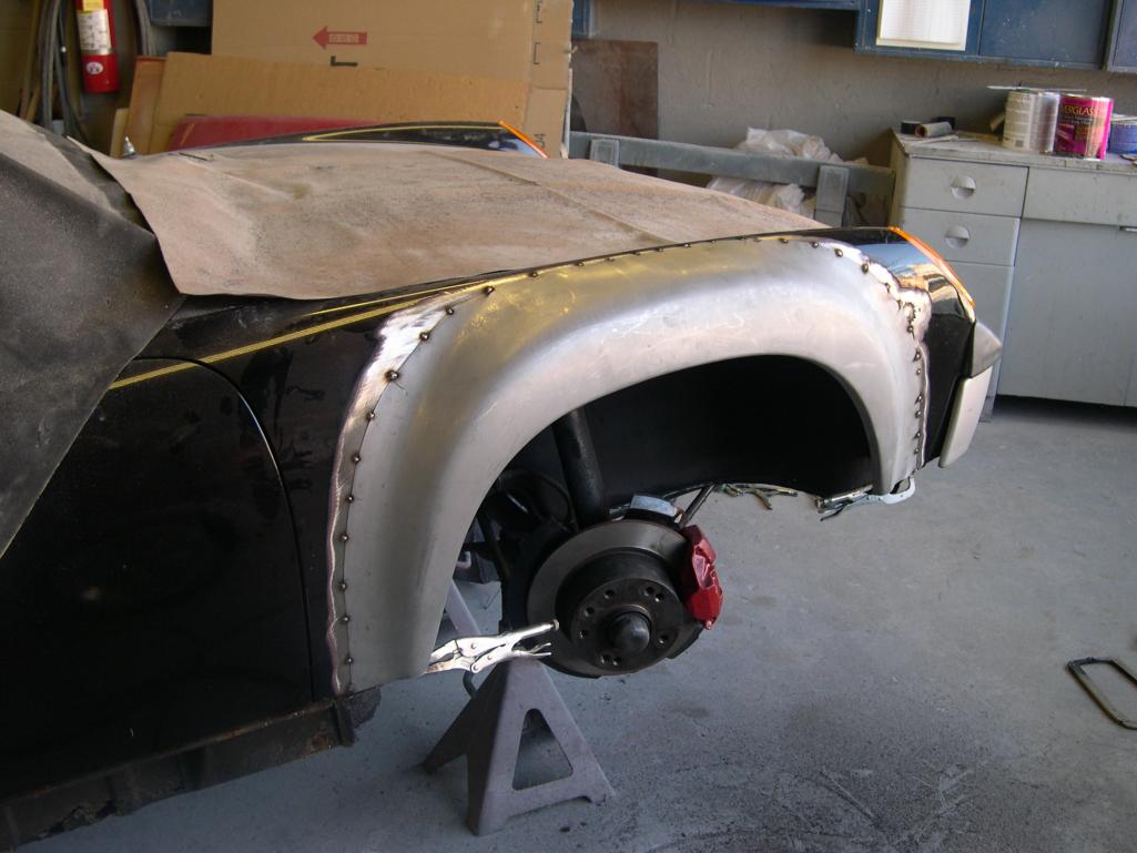

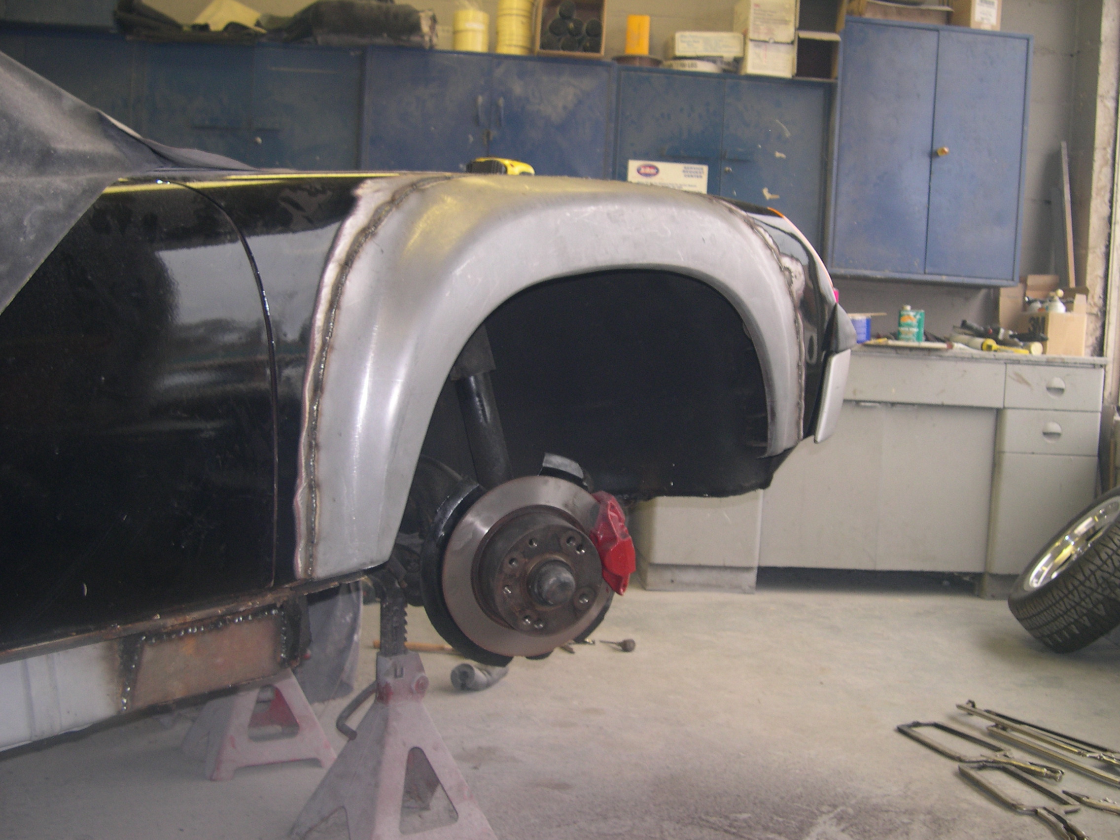

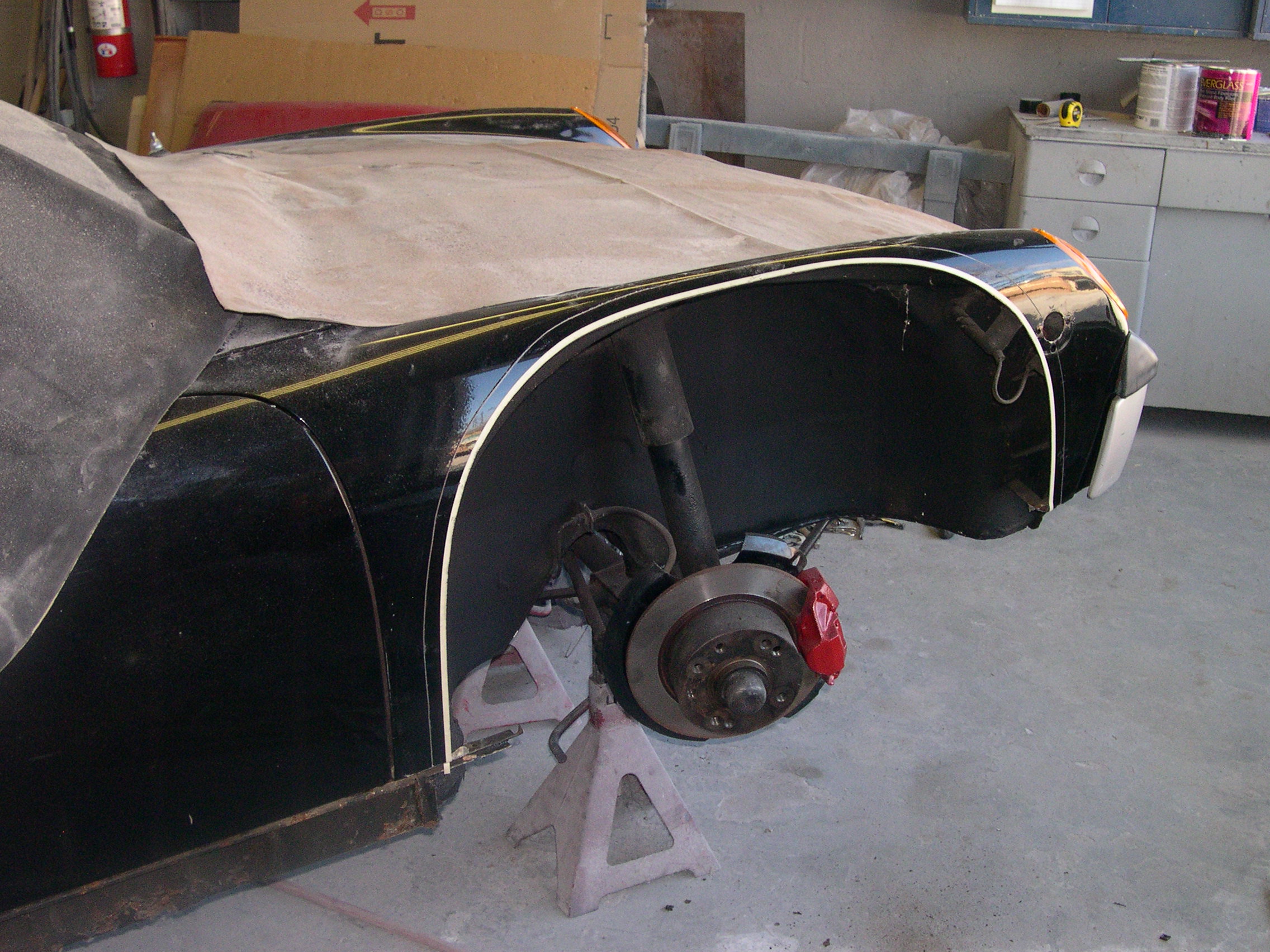

I finally got my flares welded over the Turkey weekend
marking the panels
Attached ImageAttached Image
the cut out
the weld
all welded up

Did you butt weld or lap?
Did mine last week also, found lots of bondo and had fitment issues on left rear.

Please tell me you didn't leave that flap of metal in there. (IMG:style_emoticons/default/yikes.gif)
If so, get your head up in there with a grinder and get it out. Overlapping panels like that will capture water and lead to rusted out fenders. Seam sealer will only work as a band-aid. Once the seam sealer breaks down, it traps water BETTER!
Otherwise, nice work! (IMG:style_emoticons/default/cool_shades.gif)
rick 918-S
post Nov 29 2011, 08:16 PM
Hey nice rack! -Celette
Posts: 21,294
From: Now in Superior WI
Member No.: 43
QUOTE(McMark @ Nov 29 2011, 06:55 PM) *
(IMG:style_emoticons/default/agree.gif) It's ok to use the overlap method for welding only. This will help with heat warpage. Once your finished get in there and remove the strip of metal, grind everything nicely, use a light on the inside and check for pin holes.

Yes, deleted the side marker lights. I had a lot of trouble deciding to remove them but after looking at a lot of pictures I did not like the look of them moved forward and like the cleaner look of the European cars. I may add a small side marker behind the front flares some day.
Yes, we did overlap weld cut out the ribbon of metal behind and ran a weld bead along the inside as well. We then coated with an epoxy primer and will spray with undercoating next. My friend who has done body work for 18 years believes this gives a stronger joint. Right or wrong he did most of the work so I went with his suggestion.
We had some fitment issues as well getting the bottoms to fit well. Otherwise the panels went on very well. Looking forward to all the sanding and filling and sanding to get everything baby smooth.

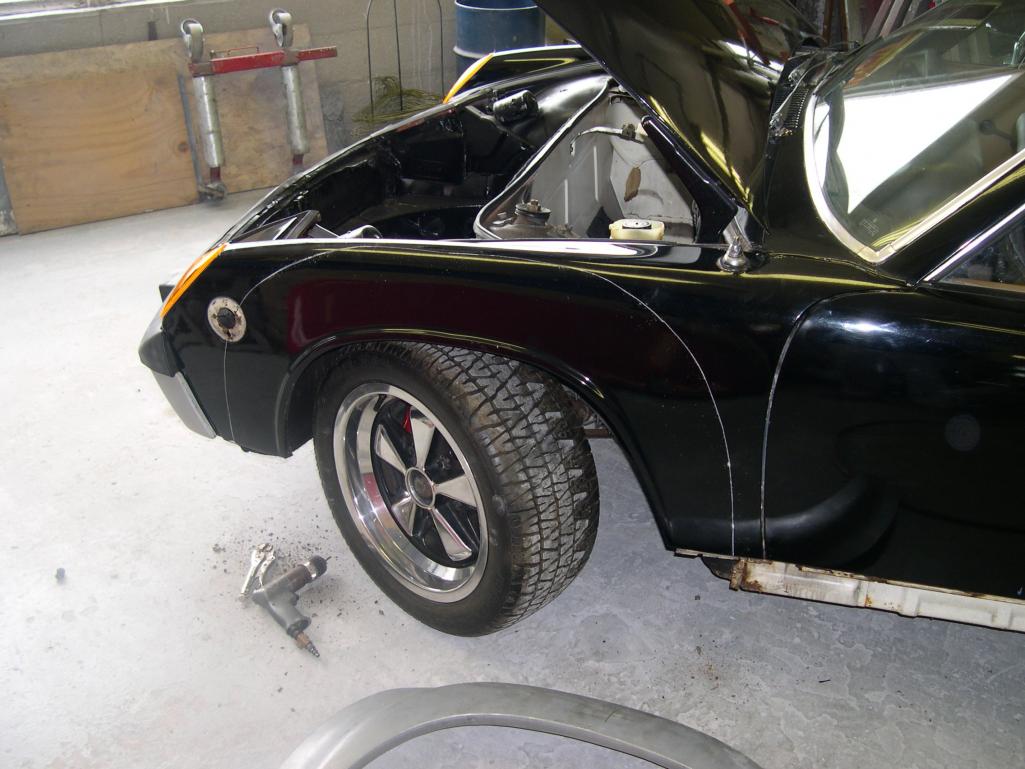

QUOTE(kfish914 @ Nov 29 2011, 02:12 PM) *
marking the panels
the cut out
the weld
all welded up

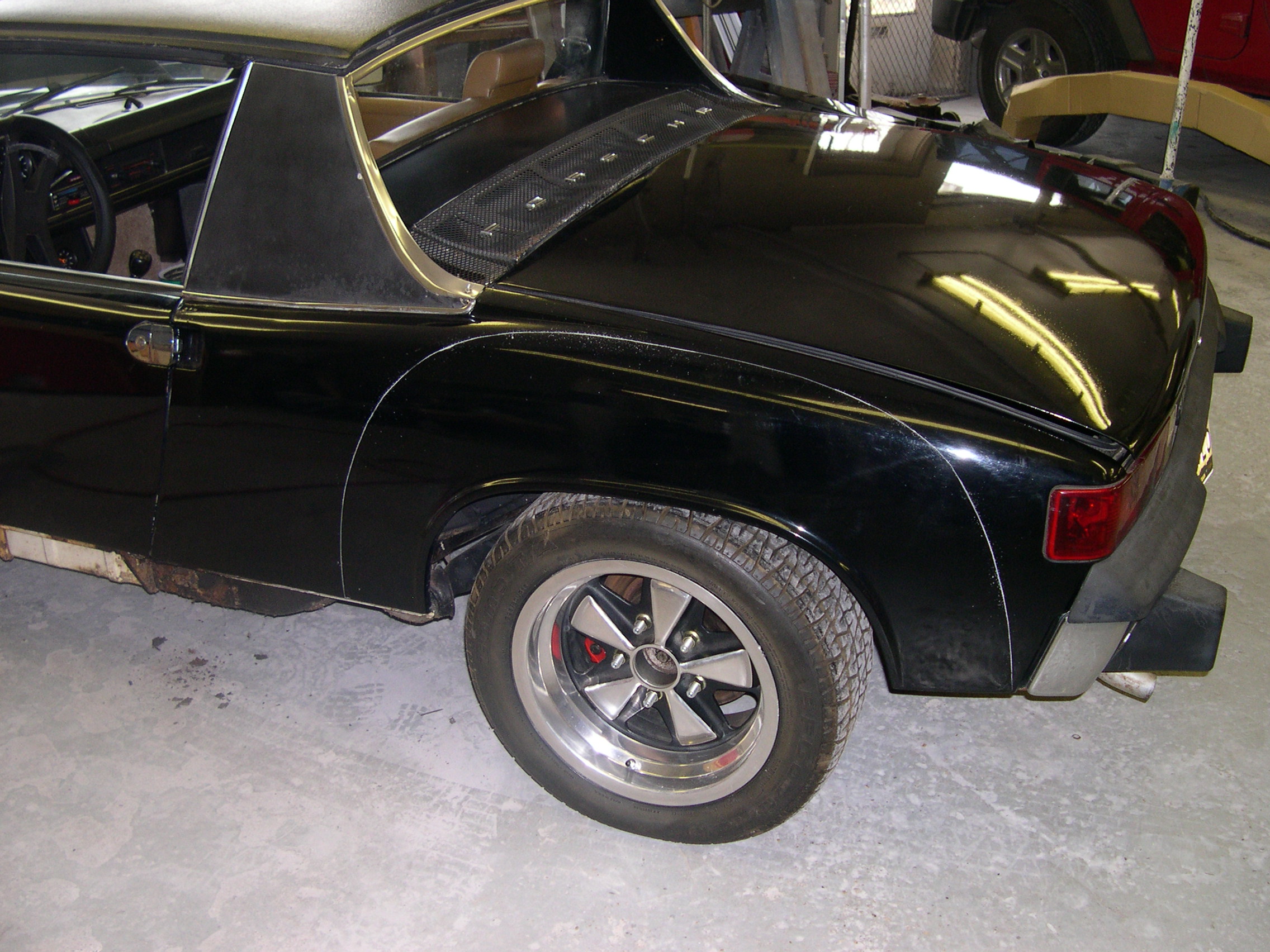

Who's flares are those? And any pics of the rear on?

could you please show us a close up of the bottom joint near the rocker panel?

If I were to do it over I would butt weld. Only because of the amount of body work I am looking at this time. I think the butt weld would have given me a smoother starting point.
I went with what he suggested because of his experience, and it was his shop that we did the work in.
I know some are thinking it’s my car I should have done it the way I wanted. For me I like the idea of a strong joint and hind sight is always 20/20. The end result is I have the flares welded on with from what I can see a good seem on both the inside and outside of the car.

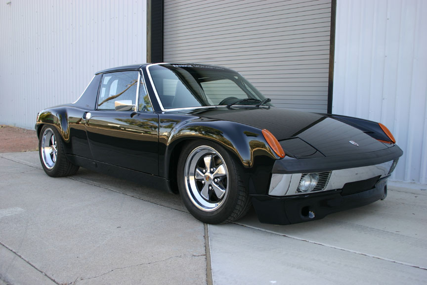

This is what I hope it will look like when all is said and done.
I will get those photos once I charge up the camera again.
