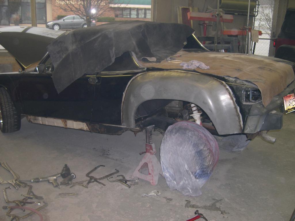

I finally got my flares welded over the Turkey weekend
marking the panels
Attached ImageAttached Image
the cut out
the weld
all welded up

bulitt   Did you butt weld or lap? Did mine last week als...   Nov 29 2011, 05:35 PM

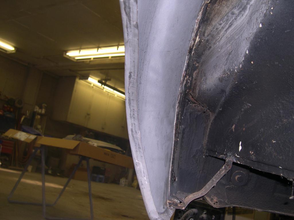

sean_v8_914   could you please show us a close up of the bottom ...   Dec 1 2011, 07:55 AM
pdlightning   could you please show us a close up of the bottom...   Dec 1 2011, 10:44 AM
mepstein   could you please show us a close up of the botto...   Dec 1 2011, 11:23 AM
kfish914   If I were to do it over I would butt weld. Only b...   Dec 1 2011, 09:39 PM

kfish914   I found a picture of the inside before we ran a we...   Dec 1 2011, 11:00 PM
