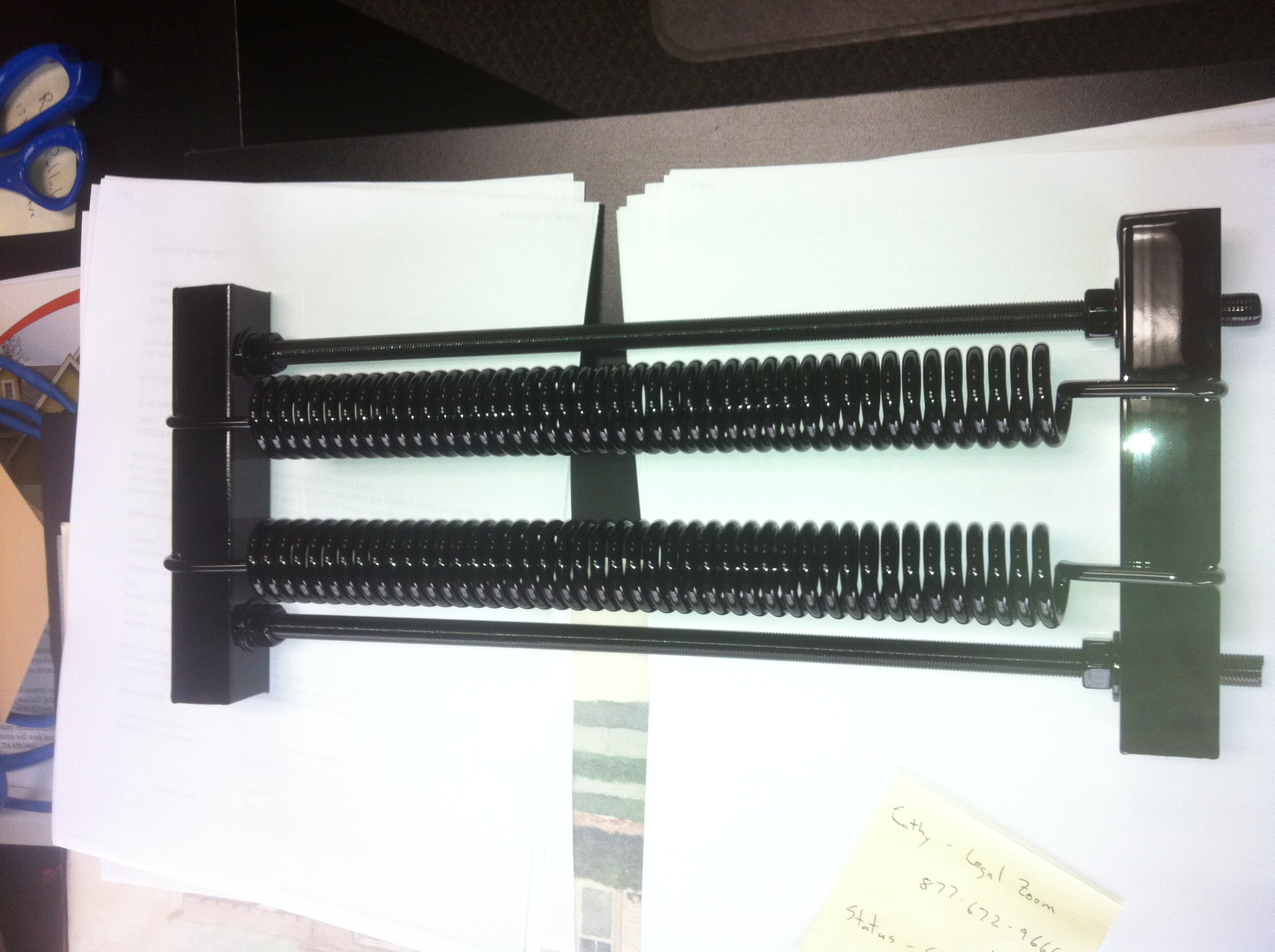

I sent my hood springs out for powder coating. I need a way to spread the springs apart to get a good coating. Seems to have worked well!!

Cairo94507   Very nice and clever.   Nov 29 2011, 06:15 PM
kg6dxn   :trophy:   Nov 29 2011, 06:25 PM
somd914   Been planning on doing mine - great idea.   Nov 29 2011, 06:41 PM
Rob-O   Did almost the exact same thing back in the late 8...   Nov 29 2011, 10:42 PM
Rob-O   Have you installed them yet? I was worried about ...   Nov 29 2011, 10:45 PM
LotusJoe   Have you installed them yet? I was worried about...   Nov 30 2011, 04:47 PM
6freak   Have you installed them yet? I was worried abou...   Dec 2 2011, 03:50 PM
nathansnathan   I've read that you need to keep the temp below...   Nov 30 2011, 08:01 AM
zymurgist   I've read that you need to keep the temp belo...   Nov 30 2011, 08:31 AM
nathansnathan   I've read that you need to keep the temp bel...   Nov 30 2011, 08:42 AM
RobW   :headbanger: :headbanger: :headbanger:   Nov 30 2011, 08:24 AM
Rob-O   Nathan, I'd make sure that your lab oven is r...   Nov 30 2011, 09:26 AM
nathansnathan   Nathan, I'd make sure that your lab oven is ...   Nov 30 2011, 10:24 AM
burton73   Nathan, I'd make sure that your lab oven is...   Nov 30 2011, 11:47 AM
zymurgist   Nice! I use an electric kitchen oven (not the ...   Nov 30 2011, 10:42 AM
nathansnathan   Good to hear! :) I'd wondered what the mid...   Nov 30 2011, 11:57 AM
charliew   Pretty blue and the springs look nice. It reminds ...   Dec 3 2011, 01:12 PM
Rob-O   I'm unsure if the oven would be okay. I don...   Dec 3 2011, 04:24 PM
swood   I wouldn't think that powder coating would be ...   Dec 3 2011, 10:38 PM
