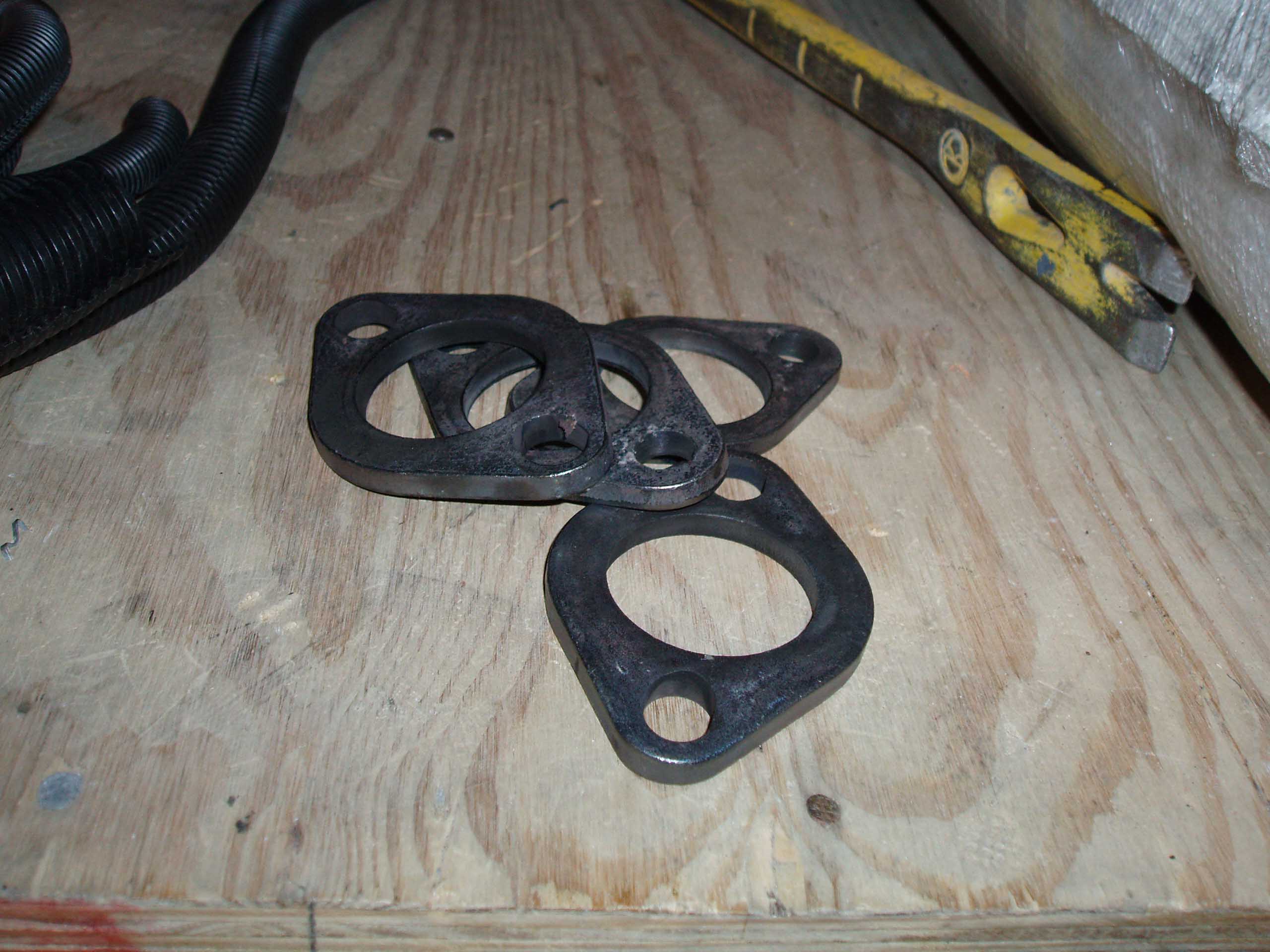

2.0 and 1.7/1.8 flanges are different.
see 1.7/1.8 on a pair of 2.0 sshe's pic.
this one set i have is stainless btw and are $30 shpd.
