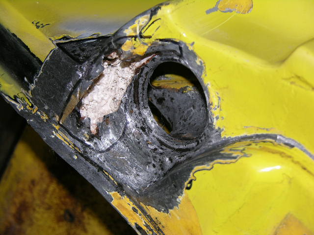

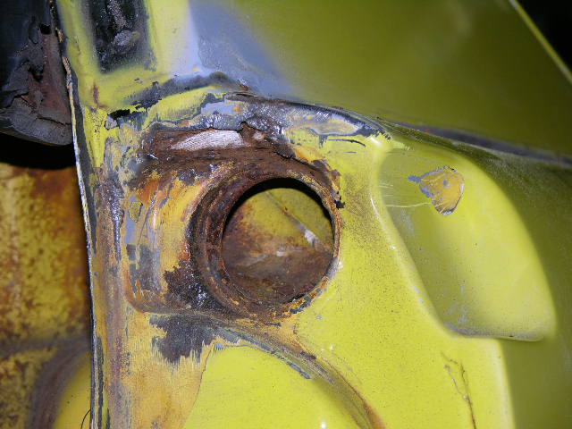

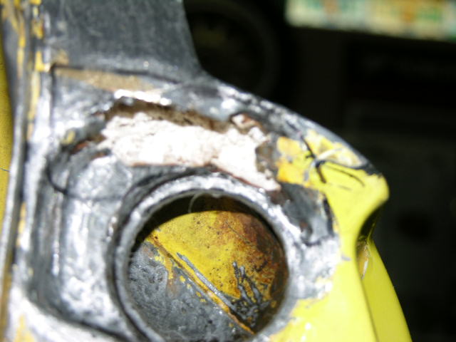

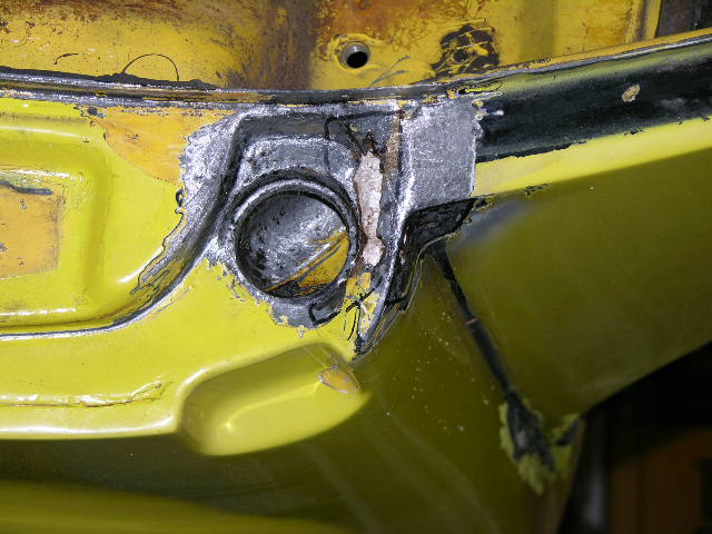

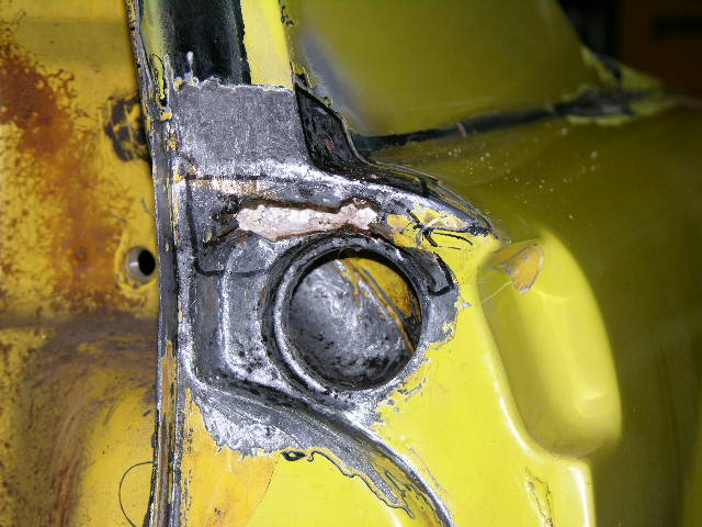

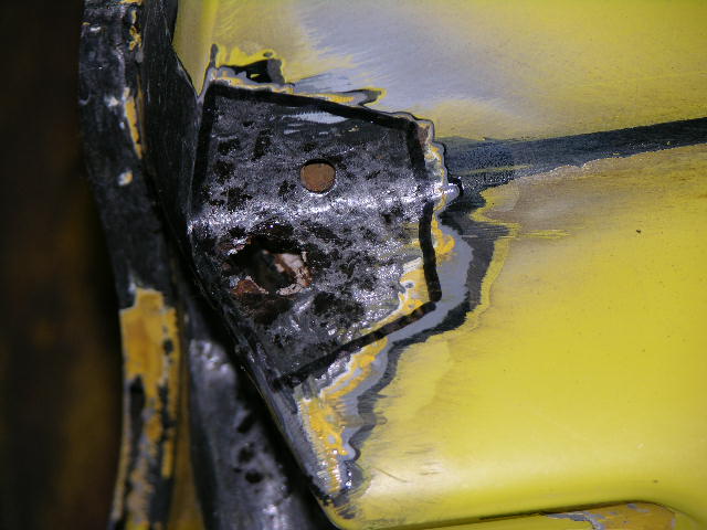

![]() ![]() [attachmentid=286033] ![]() ![]() Hello World, Yesterday was fairly productive and I am at the point where I need to start repairing several areas before I replace my rear floor boards. Both of my door vent tubes have rust, Driver's side looks to be worse than passenger side. I would assume after looking at the way Armando fixed his, that I should tackle the bottom hole first before welding in a piece on the top. Or you may opt to cut out the whole section? Once I broke through all the rust, the cavity was obviously filled with bondo, I am open to all suggestions, I have 4 or 5 areas that are in need of major rustoration. The areas with the rust do not seem to be along the longs so this project has hope. The dull gray appearance is from the application of Ospho to hold the rust at bay. I do have the Engman Long Kit and am trying to get several areas in good shape before I put the kit in. The history on the car is a 76' chassis, with fiberglas flares, 911 5 lug suspension. Let me know what course of action you would suggest for the vent hole repairs. Thank you in advance, Vysoc (IMG:style_emoticons/default/flag.gif) Attached image(s)

nathansnathan The stuff all behind isn't bondo but the facto... Dec 9 2011, 09:13 AM
FourBlades That is probably the factory seam sealer behind th... Dec 9 2011, 09:15 AM

TargaToy That's definitely one of those "tip of th... Dec 9 2011, 11:12 PM
