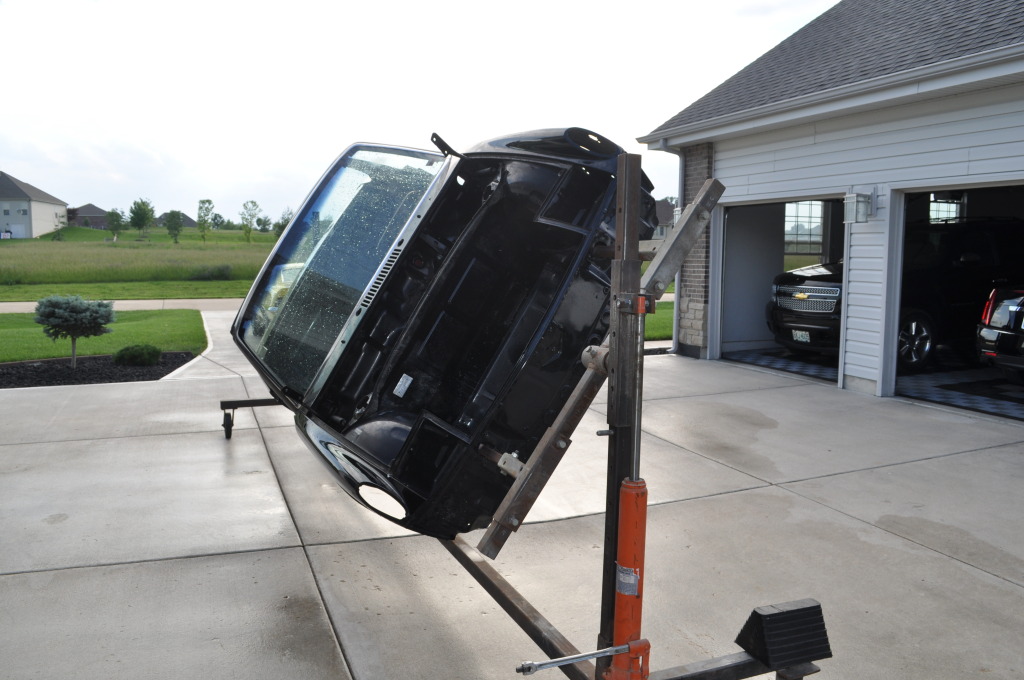

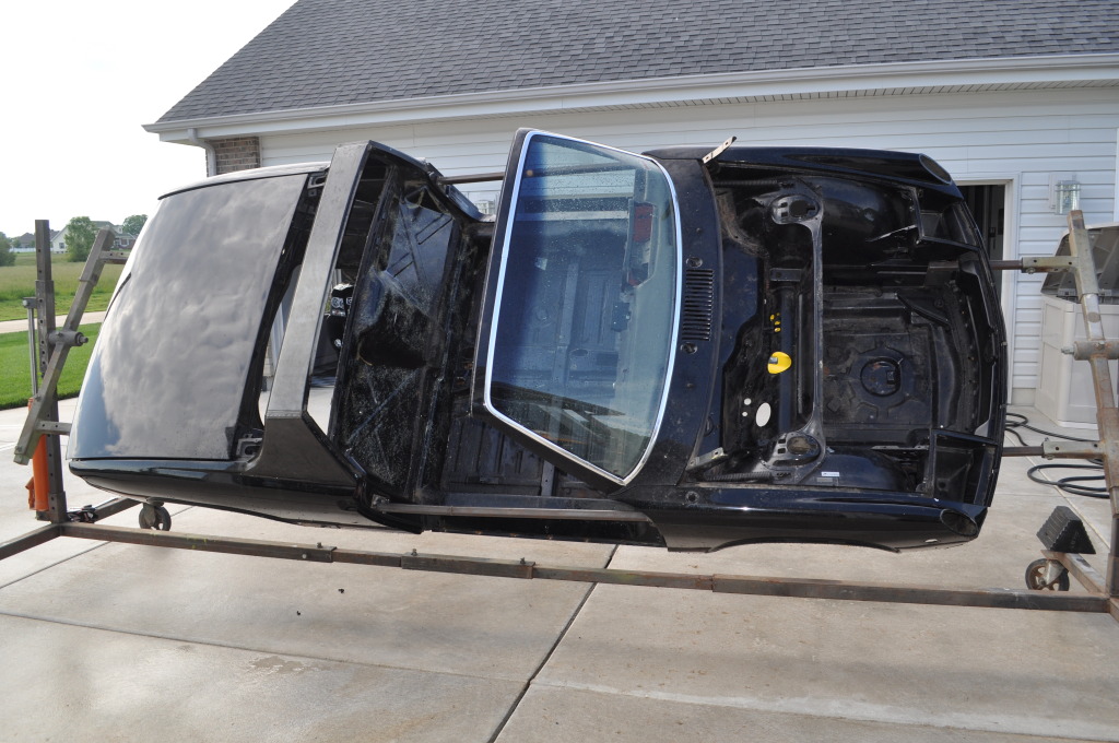

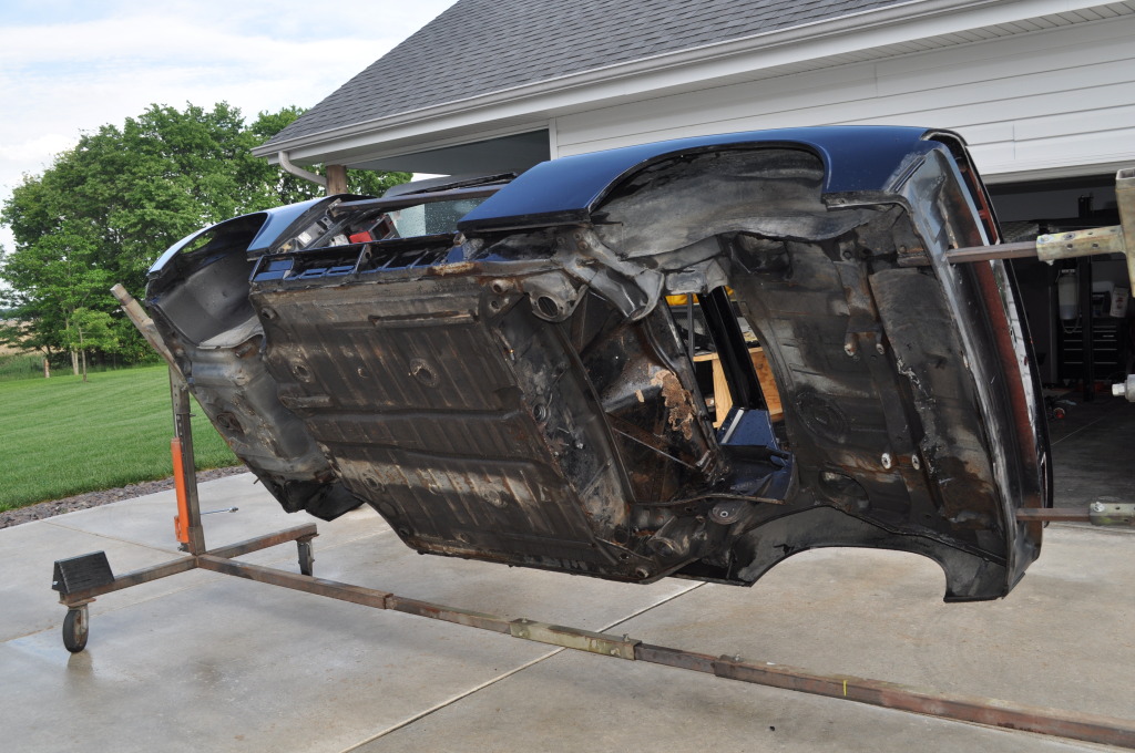

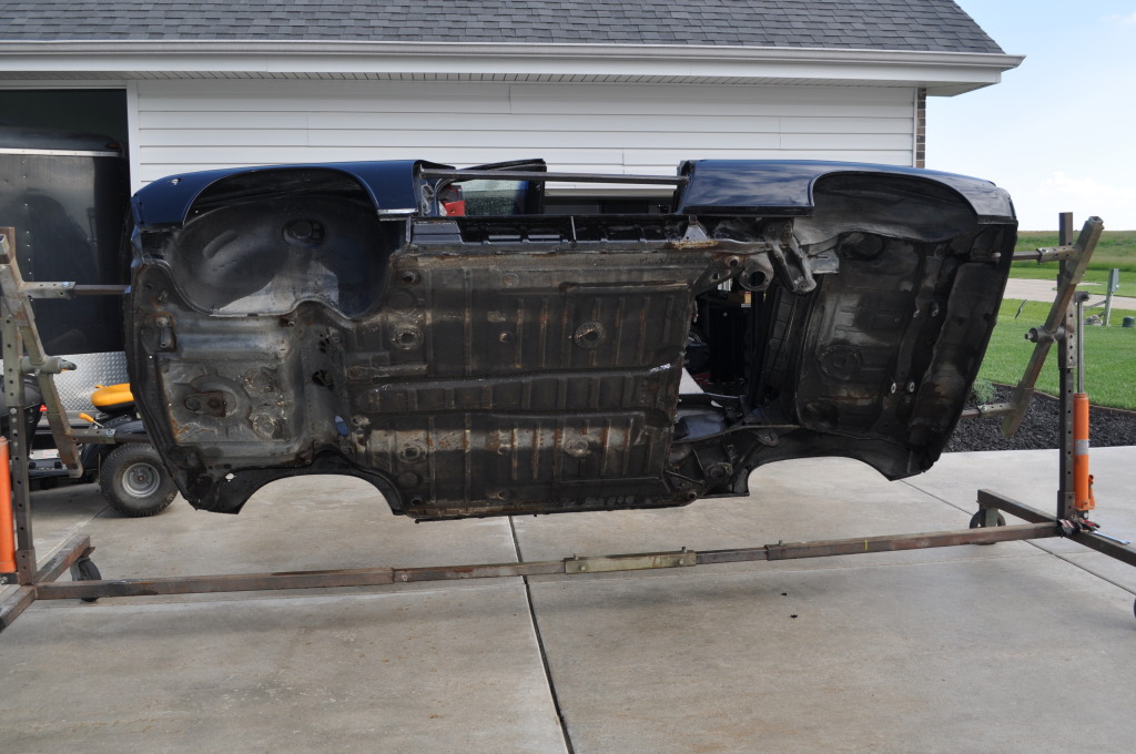

I power washed it once i got everything off of it...I rotated to on it's side to get all the water out...just had a big grin on my face watching in sit there rotated 90 degrees from the ground.
(IMG:http://www.914world.com/bbs2/uploads_offsite/i139.photobucket.com-11790-1337400363.1.jpg)
(IMG:http://www.914world.com/bbs2/uploads_offsite/i139.photobucket.com-11790-1337400363.2.jpg)
(IMG:http://www.914world.com/bbs2/uploads_offsite/i139.photobucket.com-11790-1337400363.3.jpg)
(IMG:http://www.914world.com/bbs2/uploads_offsite/i139.photobucket.com-11790-1337400363.4.jpg)

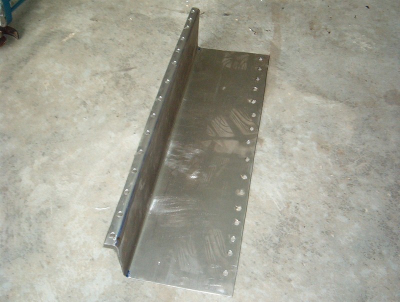

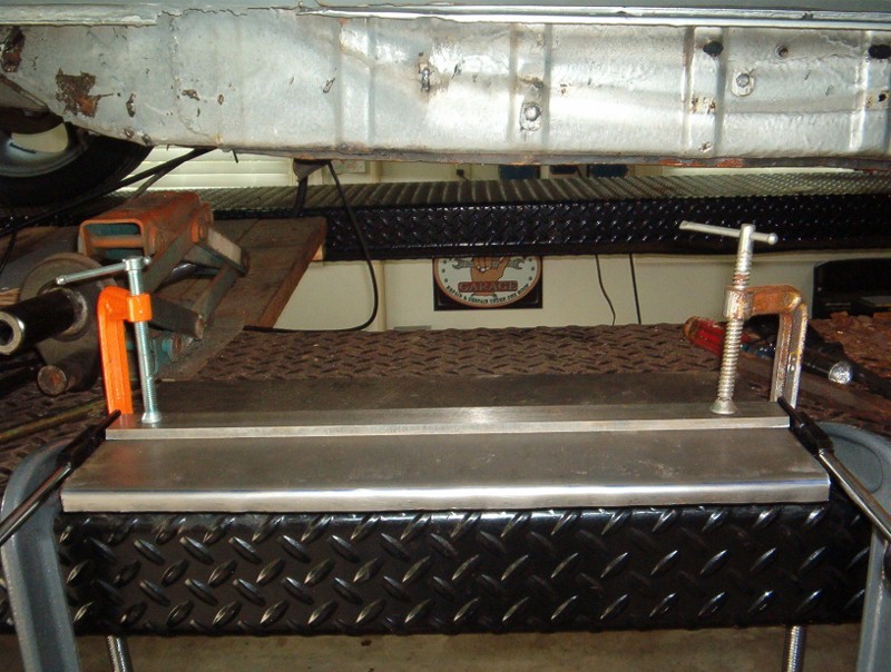

Bottom portion of inner longs are gone. Some prior PO added an outer clamshell which is decent shape. And some prior PO did alot of patching to weld the floors to the inner longs. So I am rebuilding the bottoms of the inner longs, then an Engman kit will cover everything.
Wow my door's finally close...
Starting...
Cutting the crap away...Nothing left inside...
Bending up a replacement section on my cheapo brake...
Time to start welding... (IMG:style_emoticons/default/welder.gif)

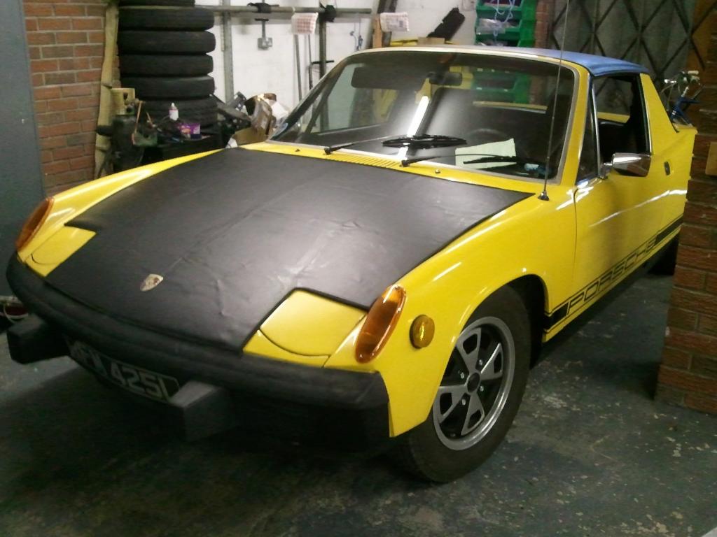

Fitted this full mask.......
