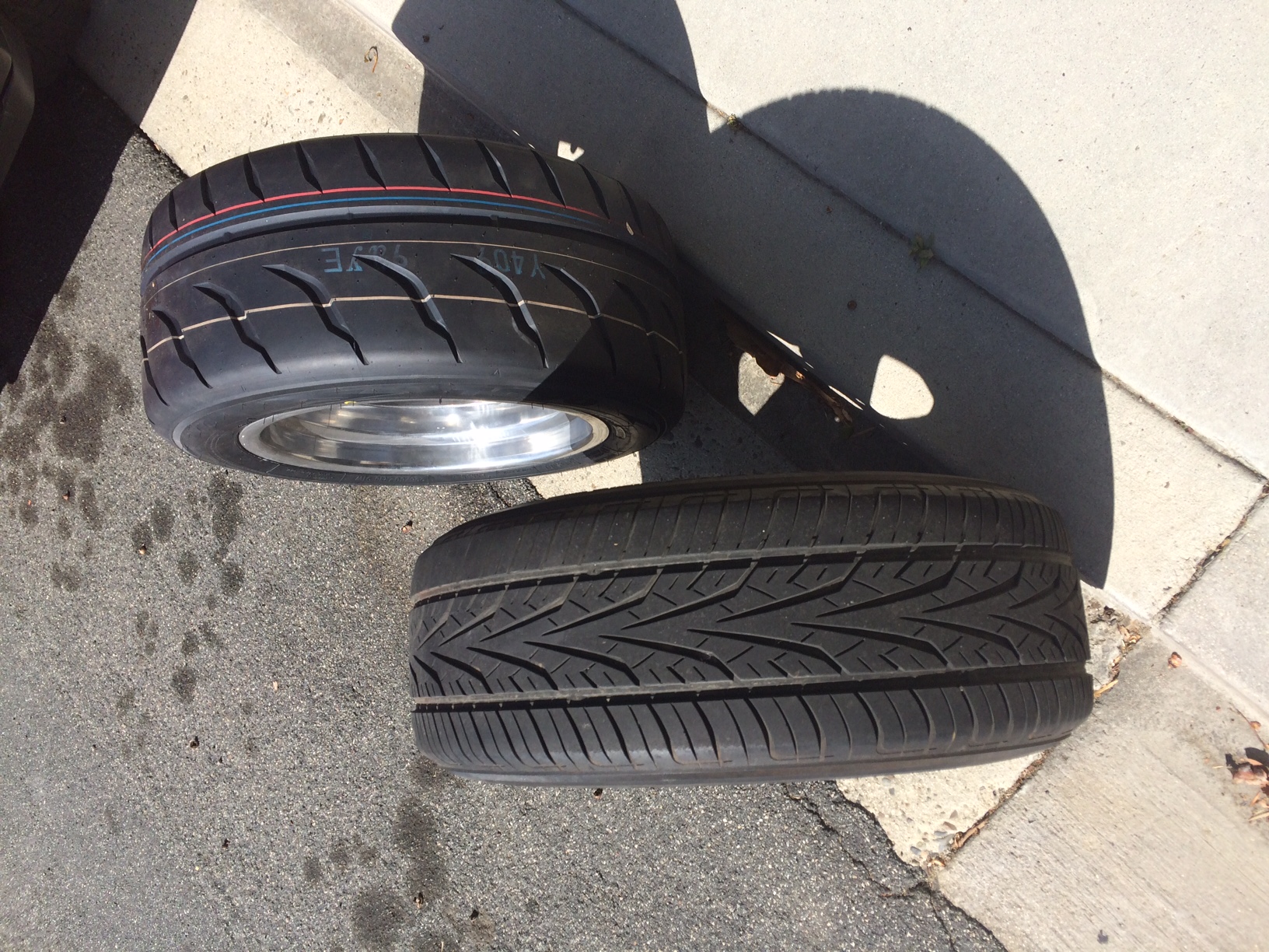

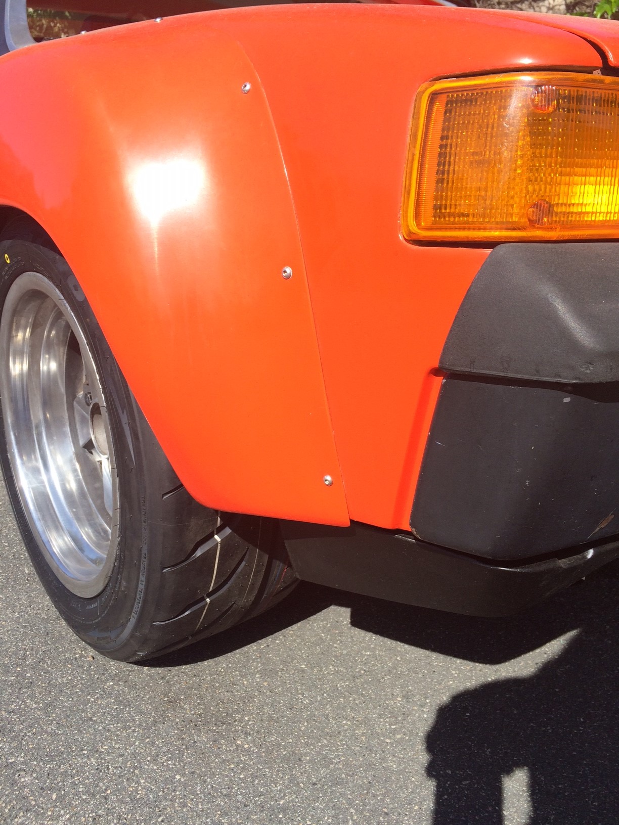

BADASS Meat! Put some new tires on the back end from Jegs.
Toyo Proxes R888R 225x50x15 on Fuchs 15X8 repros.
Looks like same tire can fit on & inch rims too,
but I think Ill have to add the fiberglass flares up front
to go to 8 inch rims.
New 225 next to 205 on 7 inch rim.

Nice tires sir Mark!

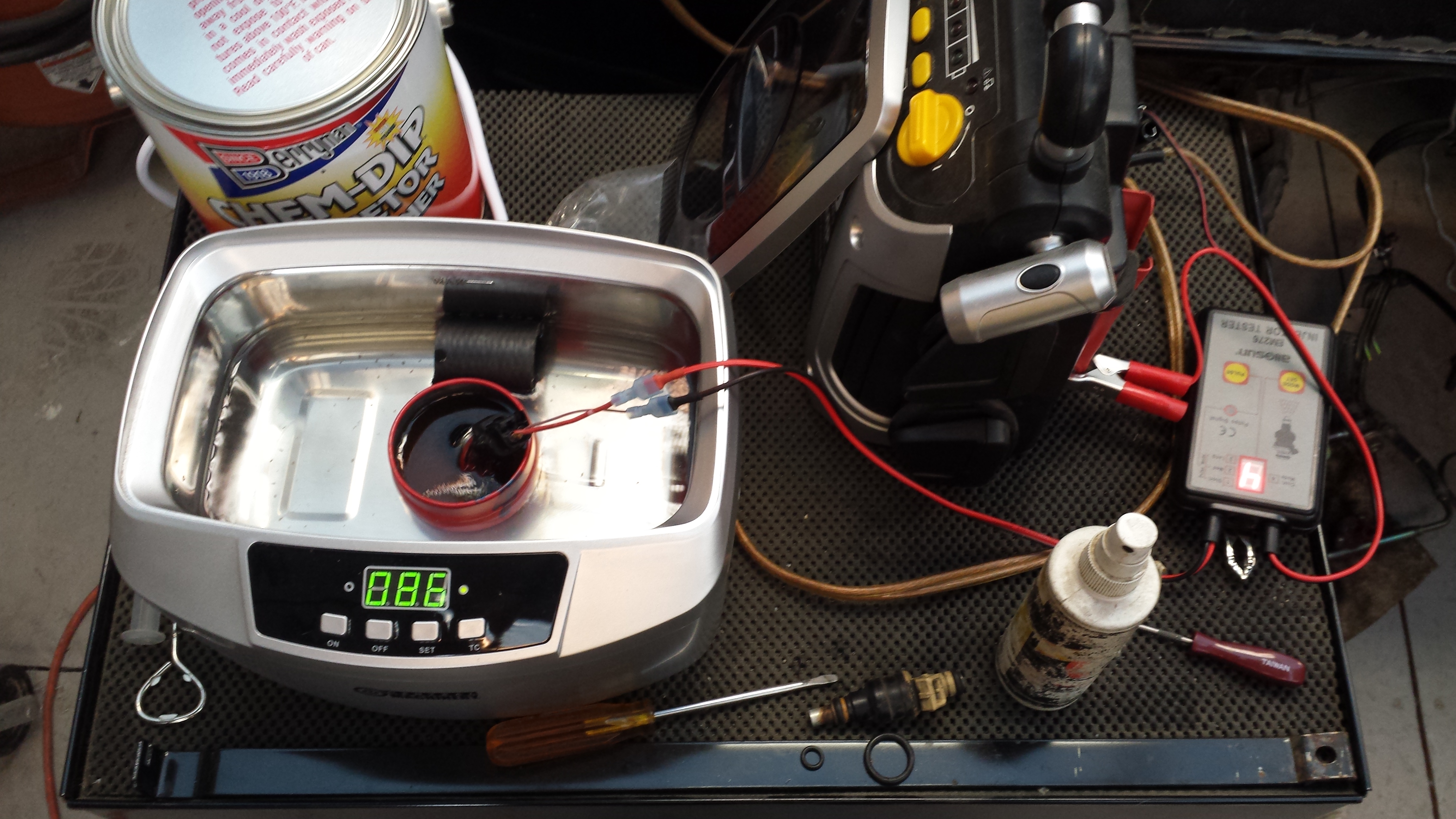

After spending 8 hours working on Toast's car Sunday, I felt obligated to work on my own (IMG:style_emoticons/default/poke.gif)
Got the injectors un-gummed up like a pro...
Also got the engine back together and tried to start it. Now I have squirts and no sparks (IMG:style_emoticons/default/headbang.gif) which is actually good because I might be stupid and try to drive it to Rt66 in 2 days after being parked for 10 years (IMG:style_emoticons/default/slap.gif)
For those that would like to know...
I got the injector pulser off ebay for $30 (All Sun EM276) and the ultrasonic cleaner from Harbor Freight. No $avings over Pro cleaned but I'll use it many more times.

I like it. (IMG:style_emoticons/default/smilie_pokal.gif)
