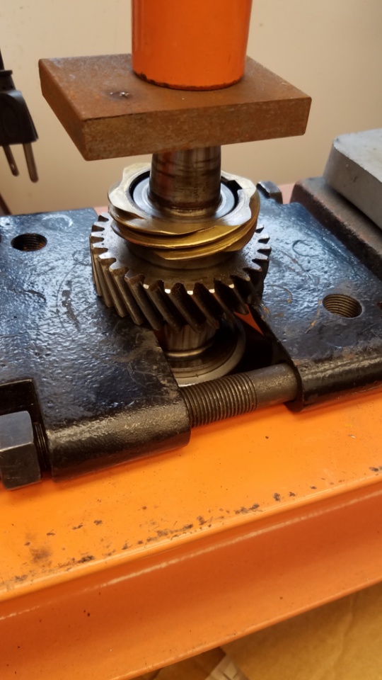

Today, started to work on engine again:
Removed gears from crank, and installed new gear on camshaft (thanks to McMark for the 5 bolts)
McMark also sent me new bearings for the rods and crank, thanks Mark.

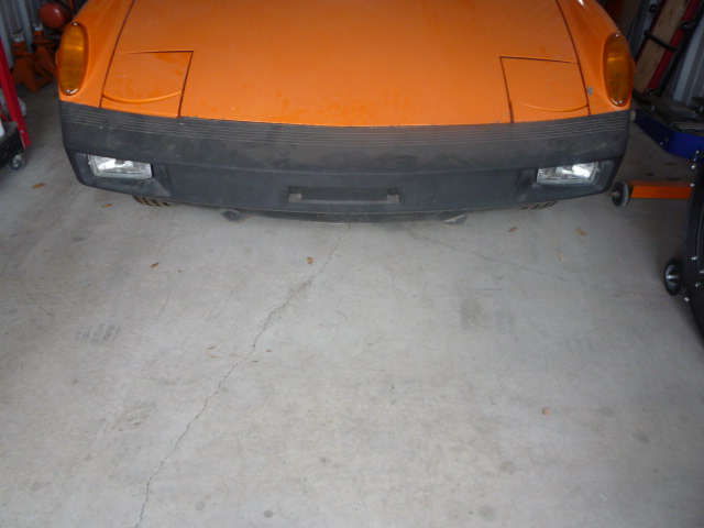

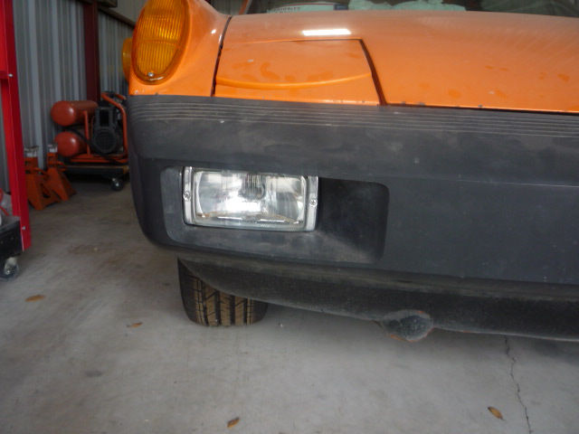

Converted fog lights to driving lights. Just a matter of changing out lens. Lens are very rare.

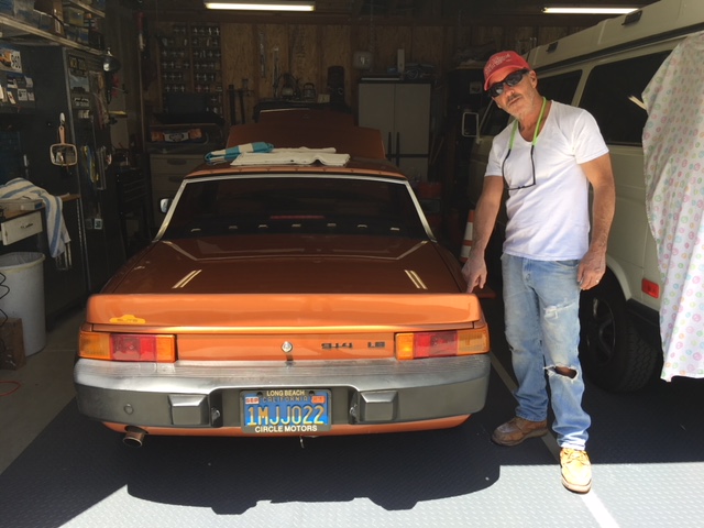

(IMG:style_emoticons/default/smile.gif) Big thanks to SB914 for helping align my rear trunk lid gaps.

Jim, the gap on my back trunk is too wide on the passenger side also (albeit not as wide as your before picture). How do you adjust it?
jim_hoyland
post Apr 20 2018, 04:33 PM
Post #10352
Get that VIN ?
Posts: 9,942
Joined: 1-May 03
From: Sunset Beach, CA
Member No.: 643
QUOTE(napasteve @ Apr 20 2018, 02:21 PM) *
First, We measured the side gaps near the engine grill and wrote them down. Then subtract the smaller gap and get the difference. This will be used after any changes.
Next, we both loosened the bolts on the trunk hinge. I pulled the hinge on my side to get the bolts closer to the edge of the hinge slot; Eddie did the opposite. Tighten up the bolts, close the lid, and remeasure.
Went through this a second time and the gaps got real close to being equal.
Then, we looked at the gaps at the rear. They were off a little; we loosed the bolts that hold the trunk latch ( the one on the lid). Moved it over a little, and ended up with the rear gaps pretty close.
Two people make this very doable. A small change on the hinges or latch make a good change....
If that wasn’t going to work, I was prepared to remove the lid and the latch. Then widen the spots on the hinge and latch where the bolts needed to be with a metal cutter _ Drexel bit. Fortunately, we did’ have to go there (IMG:style_emoticons/default/smile.gif)
