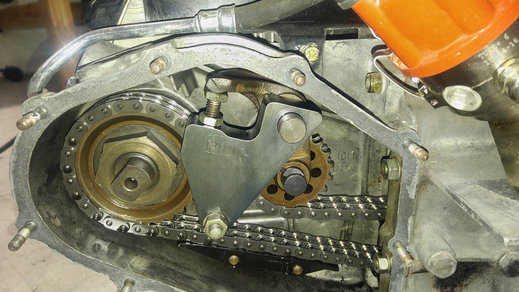

Pulled the cam covers to see if safety collars were installed or not. I guess not. (IMG:style_emoticons/default/blink.gif)

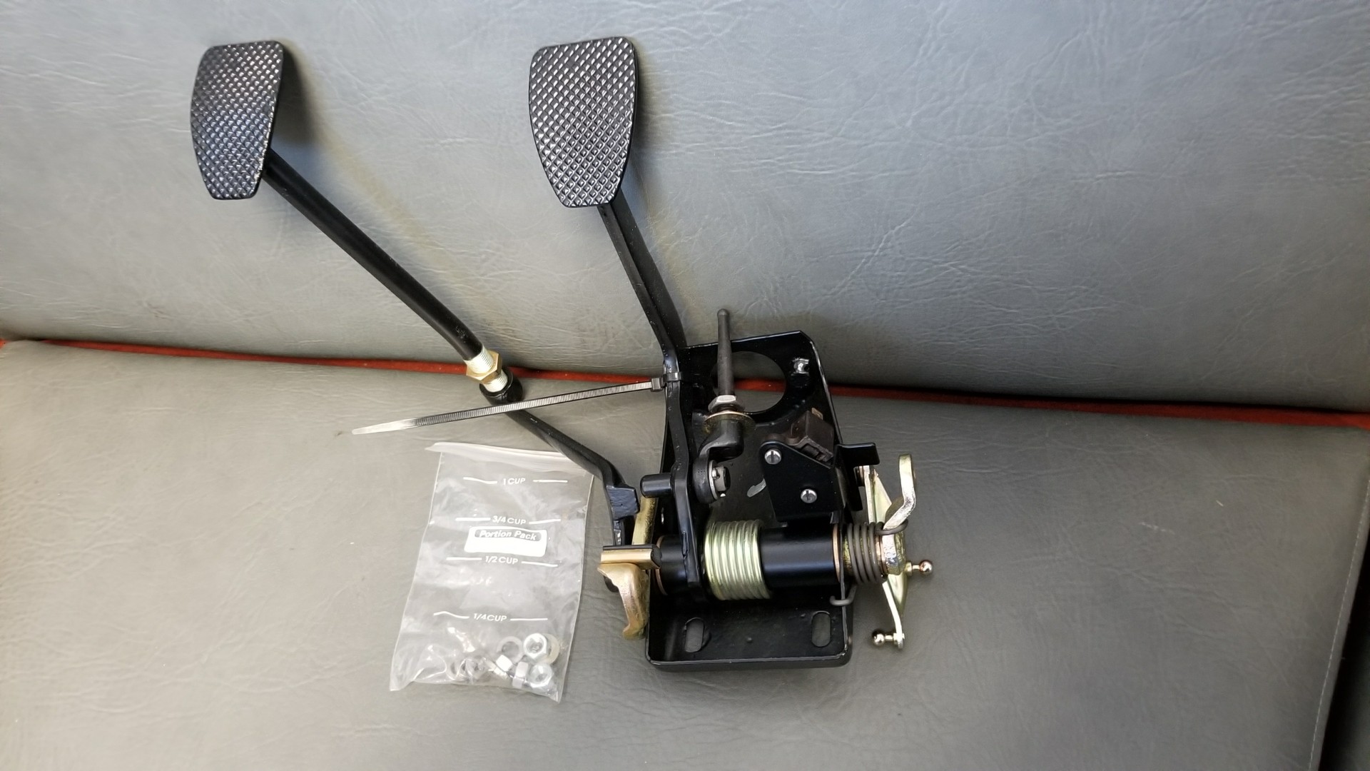

I received a pedel assy from Bruce Stone....beautiful.
thanks' Bruce.
I'll get you core soon.

QUOTE(Travis Neff @ May 7 2018, 10:39 PM) *
Are you going to run with those tensioners? ... seems like you'll be in there adjusting those often. You might look into some standard OEM tesnioners (IMG:style_emoticons/default/confused24.gif)

QUOTE(euro911 @ May 8 2018, 02:08 PM) *
I am for now, budget is tight. I wasn't really expecting to see the mechanical tensioners:)

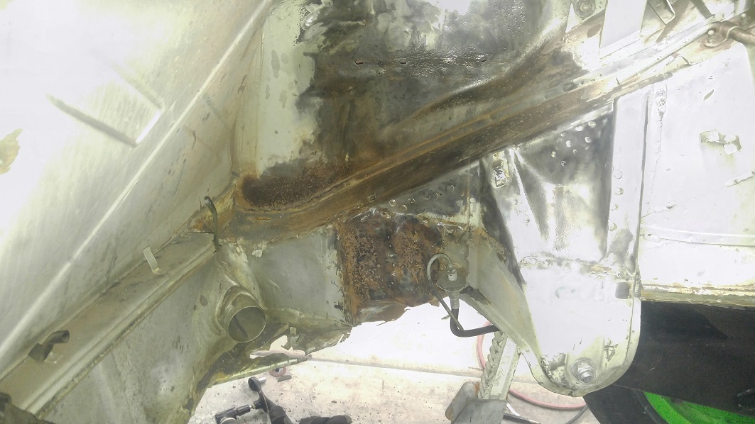

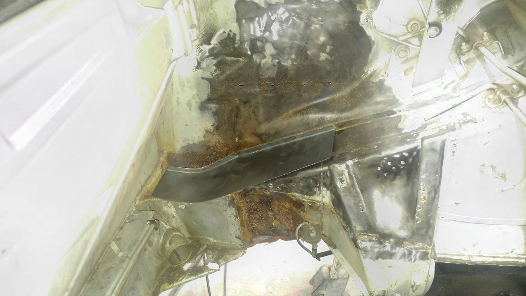

More cutting today. Looks like I will have to patch where the engine mount was as well as the top of the long. At what point should I be getting worried the car will start bending in ways I don't like while I am cutting?

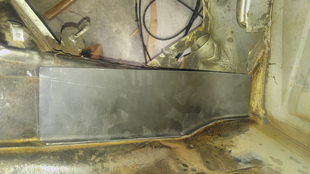

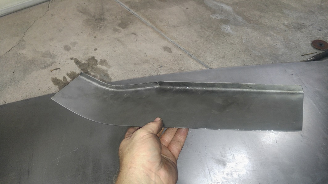

Yesterday I got a shrinker/stretcher kit from HF & a bending brake. Then picked up some 18G & 20G steel for creating patches.
I made a cardboard template using a set of dividers/compass thingy. I used the 18g for this patch. The flange is about 10-11mm in height.
Here is my first pass at using both the brake and the shrinker. I needed to make one cut in the flange and two separate bends. I am pretty pleased with how this one turned out. I will need to fine tune once I cut out the bad metal and cut the new piece to fit.
Now I better not let my good luck go to waste, I am off to buy some lottery tickets! (IMG:style_emoticons/default/cheer.gif)

Looks good Travis.. where do you buy steel from?

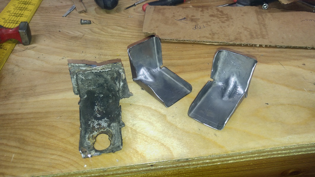

With the leftover scrap from the hell hole piece I tried my best to recreate the trunk supports. One was a wadded up booger and the other has seen better days, but I can get an idea of size and shape. Good thing this will be hidden, LOL.

Looking good Travis, now we have another metal shaping master on 914World! (not me, hahaha)
