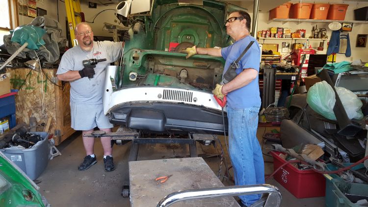

Glenn & I had a play date. 4742913130 was parted out. Lots of serious rust issues and filler. Saved as much of the good metal that we could, the rest going to the scrap yard tomorrow.
The great junk 914 hunters and their prey. (IMG:style_emoticons/default/sawzall-smiley.gif) (IMG:style_emoticons/default/smash.gif) (IMG:style_emoticons/default/laugh.gif)

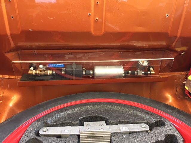

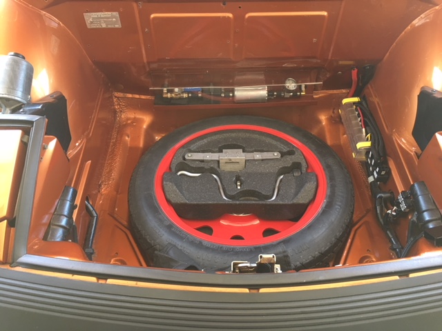

Finished fabricating a tray and cover to accommodate the fuel pump and filter. Next, gotta pull the tank and re-route a couple of hoses (IMG:style_emoticons/default/smile.gif)

^Wow Jim, show quality right there.

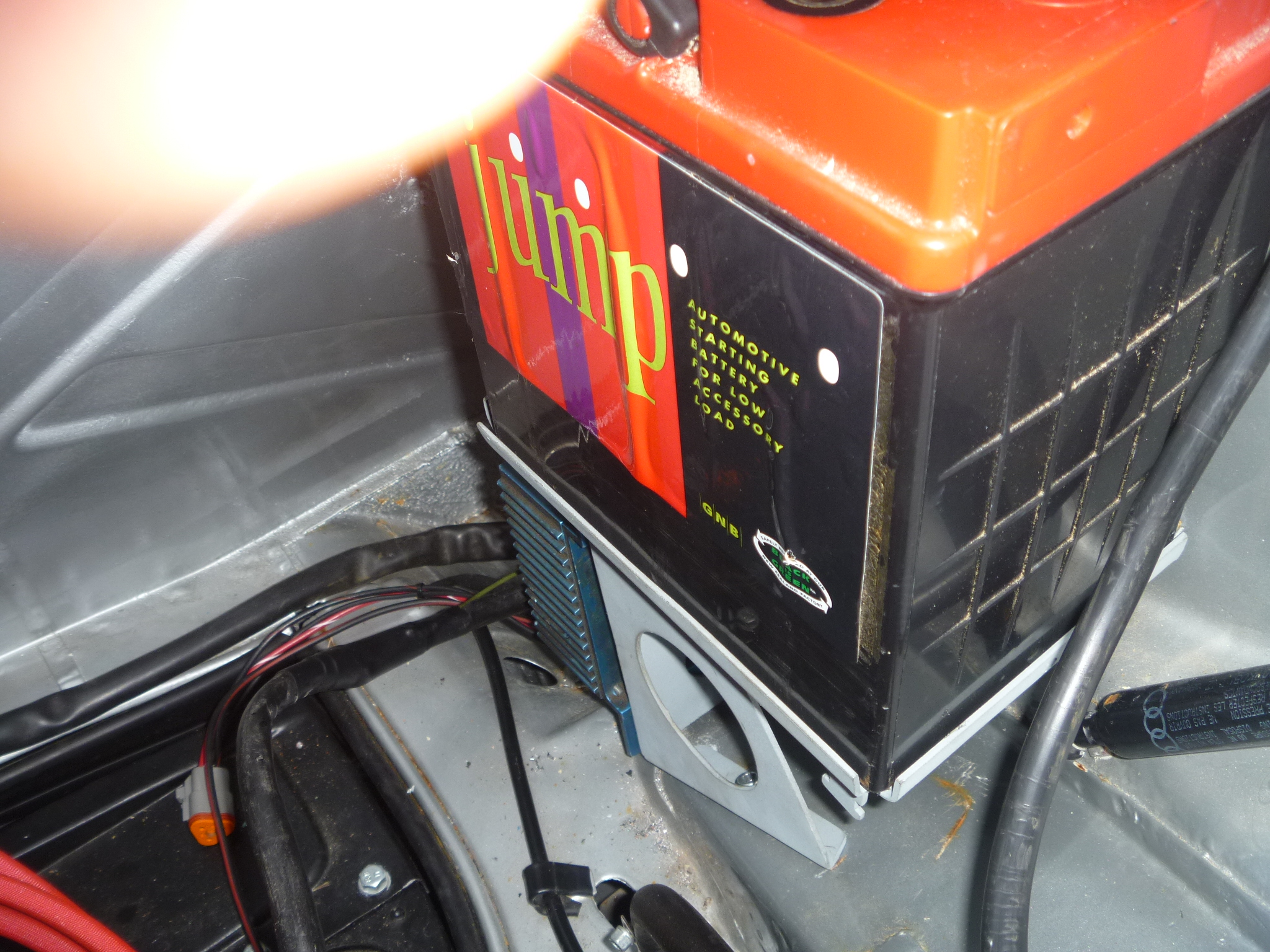

I made my own battery tray out of some thick panel steel,made a front section to mount my Permatune nicely out of the way,made the tray to fit my compact race battery and the next size up which is the size used in 'jump packs' and small cars.
I bolted it to the body with SS bolts so I can get to stuff underneath....most likely find rust in the future (IMG:style_emoticons/default/sad.gif) .

looks great!! boxster spare? i think thats what i will do when i get my car back from paint.

Yup, with the inner piece that holds the jack and handle. Find a shop that converts Boxster to spec cars; they toss out the spare and tool kits. I found several on eBay

Very clean! I am leaning toward putting the battery tray back in the original location rather than the trunk.

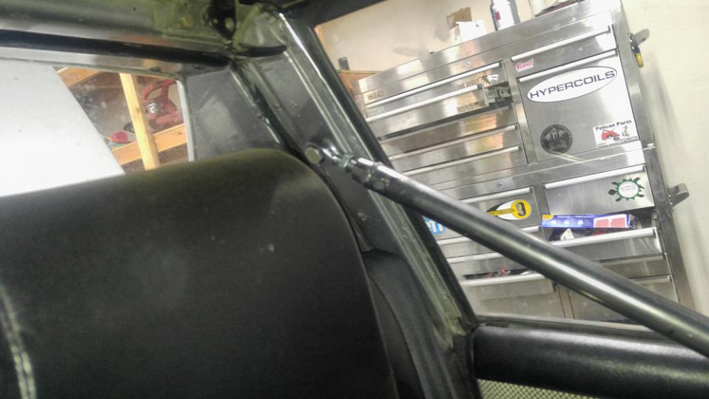

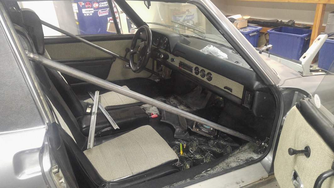

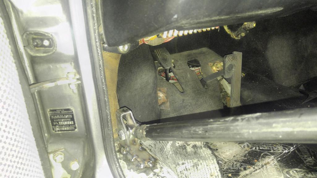

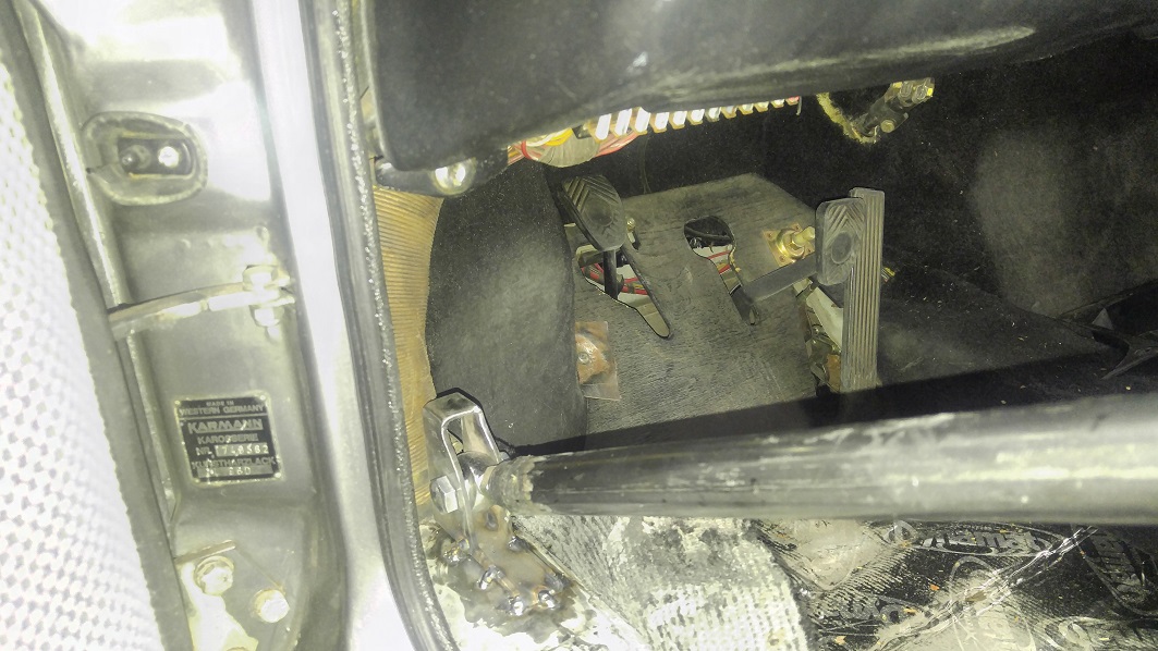

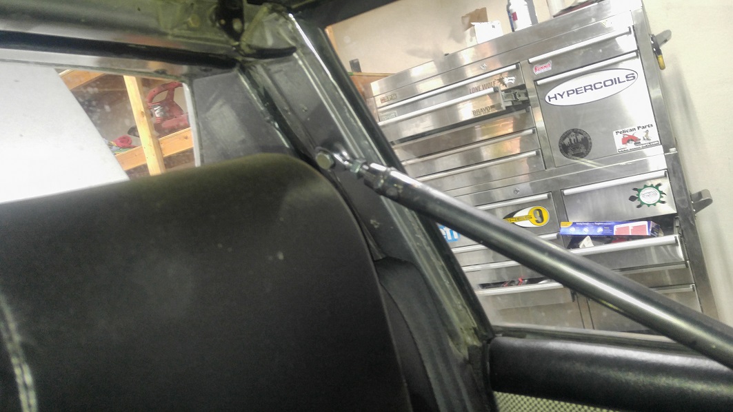

Made up some door braces today and got them tacked into place. I had to sacrifice my upper seat belt bolts, as the shoulder was a smidgen to wide to fit through the 1/2" heim joint, I put those fuggers in the drill press and used a file to get them the right size. For the bracket I made these out of 1x3 rectangular tube.
Nice that I can close the doors and not even have to take the door cards and handles off!

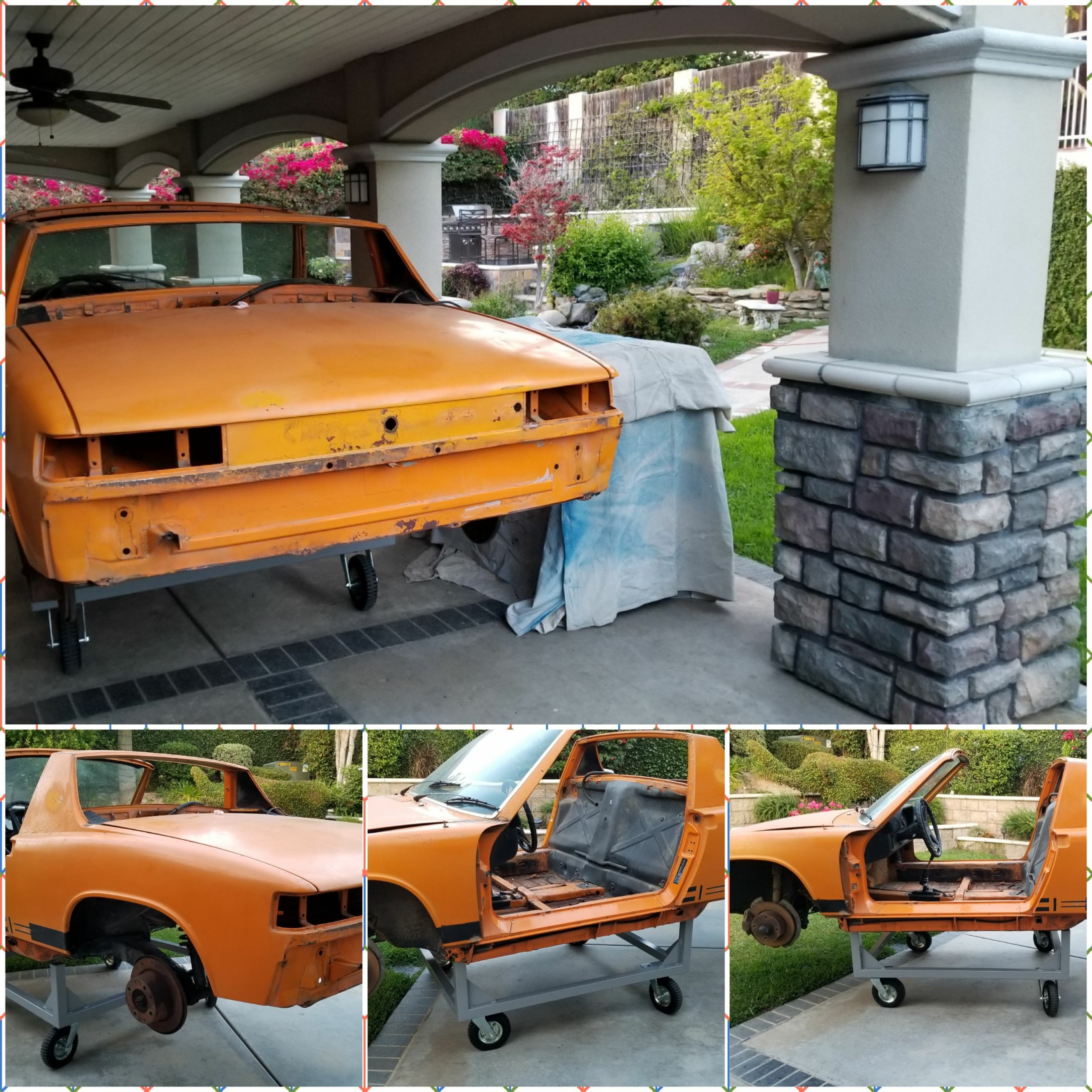

Placed car on my little dolly...rolls rather easily.
Wife will be surprised I placed it in our back patio...oh well..doubles as a carport.
