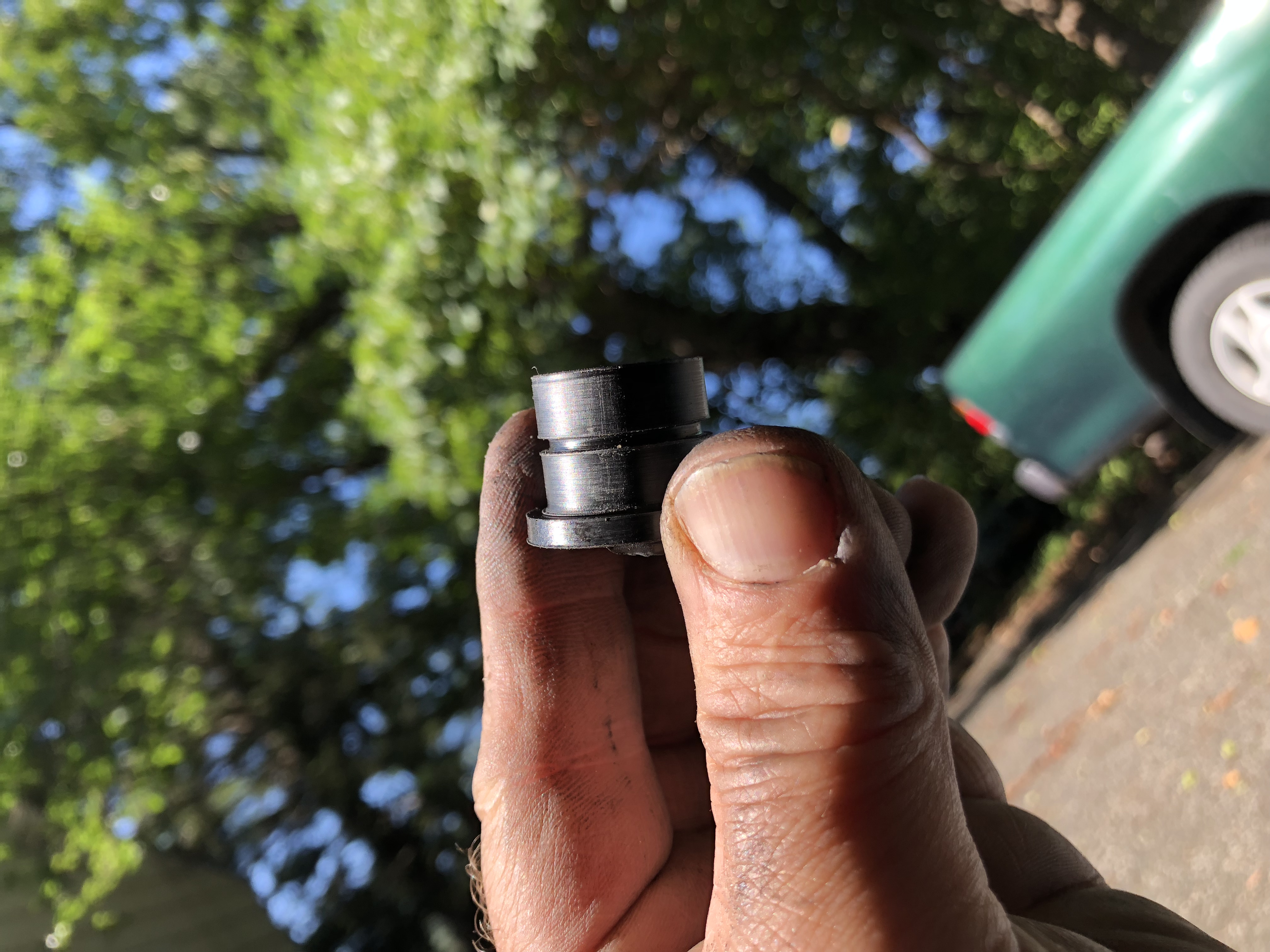

I had one bushing in the linkage that had a decent degree of slop, The one in the shifter console at the back of the tranny. I have been wanting to replace it for sometime, so today I took an hour and spun up a new one out of Delrin, pretty much eliminating any side to side movement at the shift rod. I was really pleasantly surprised when I took out the car for a test ride to find that finding first at a stop was totally crisp, no more dropping into third and then over to first or trying to force the first gear.
Really was an hour well spent, worth getting under the car

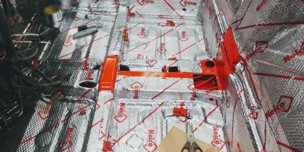

Almost finished the noise insulationAttached Image

QUOTE(mb911 @ Sep 30 2018, 05:13 AM) *
Looks like it'll do the trick real well. It reminded me that I bought a bunch of that Noico mat a couple years ago for the 'BB' ... I guess I can use it it 'Eileen' when I get a chance to replace the original paneling.

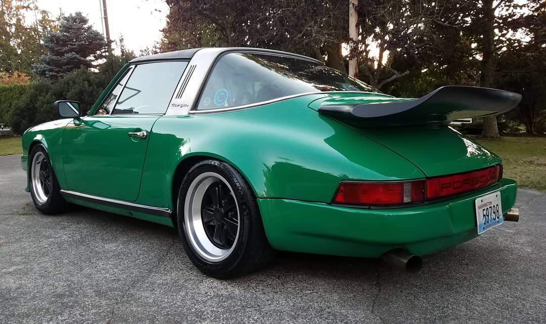

Well, since I don't have my 914 anymore, I did work on this the last two weekends (IMG:style_emoticons/default/smile.gif)

QUOTE(PeeGreen 914 @ Oct 1 2018, 05:13 PM) *
Which TB unit are you using and does this 911 have the 915 transmission? How do you like the TB? Have you tried the Limited Slip?

QUOTE(cali914 @ Oct 1 2018, 06:17 PM) *
It has a euro 3.0l engine with CIS. It does have a 915 gearbox with either a Guard or some other type of TB diff. Not sure as I've yet to dig into it. Hope to refresh it this winter.

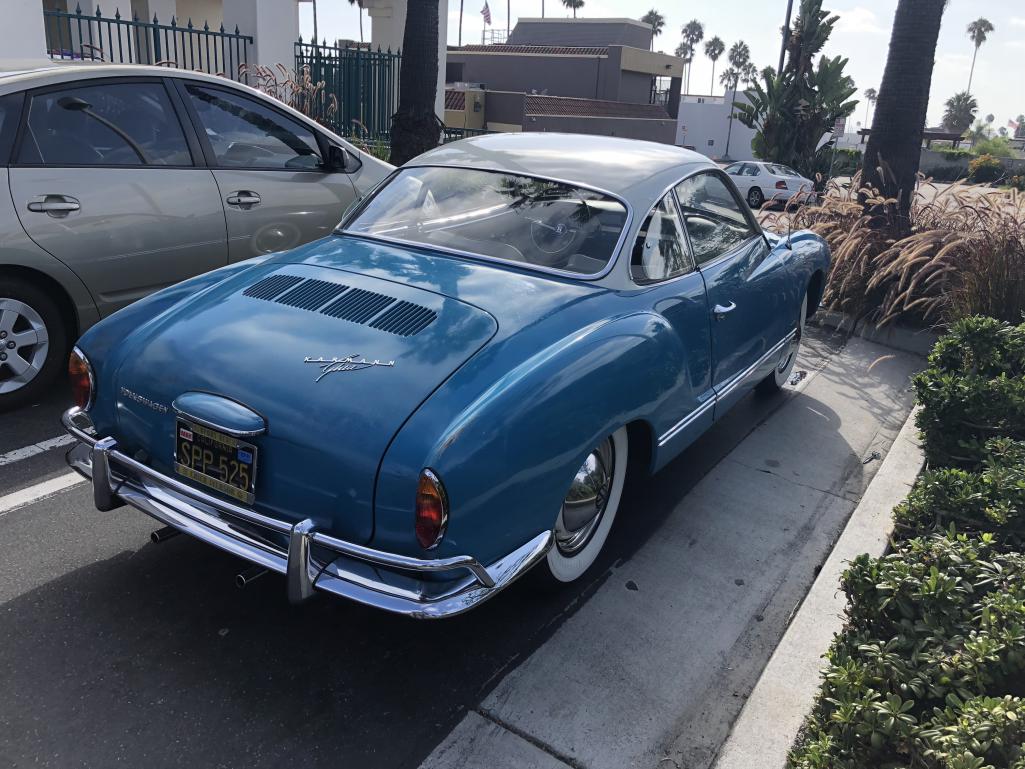

All I do is fiddle around with and drive my Karmann Ghia. What's wrong with me?
