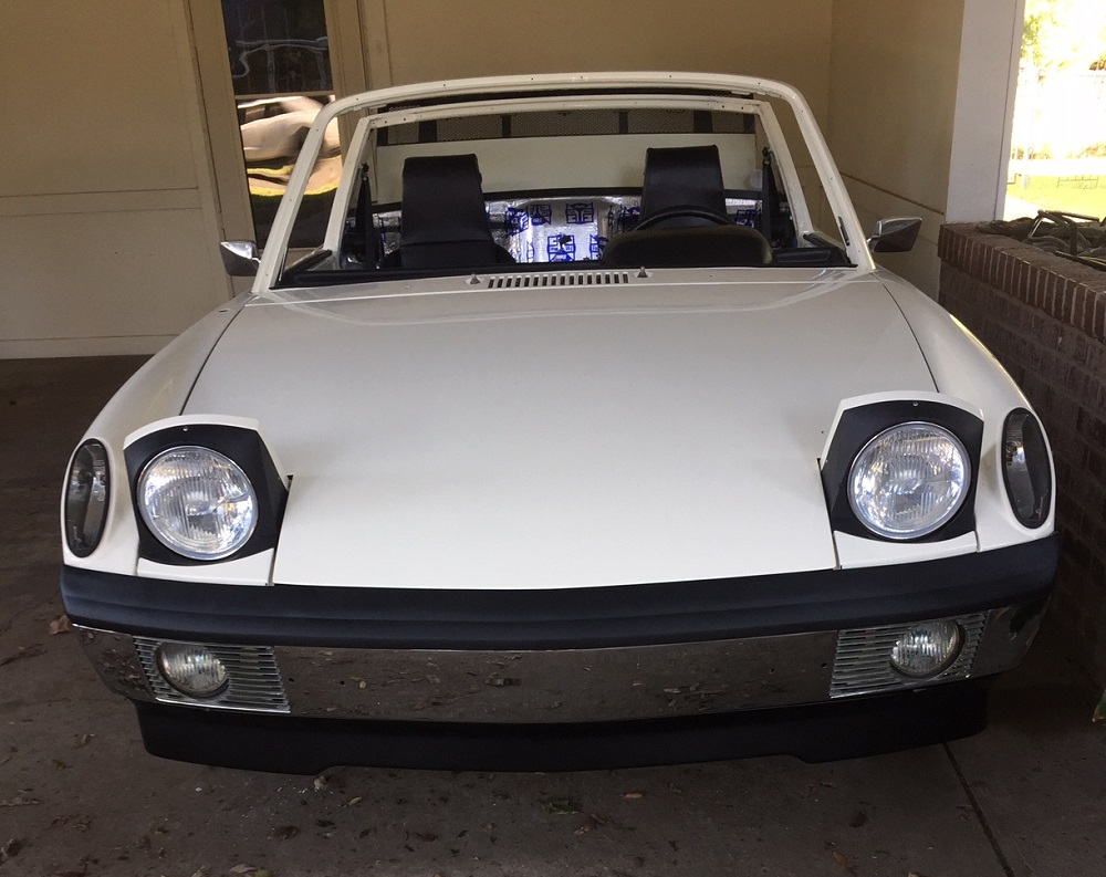

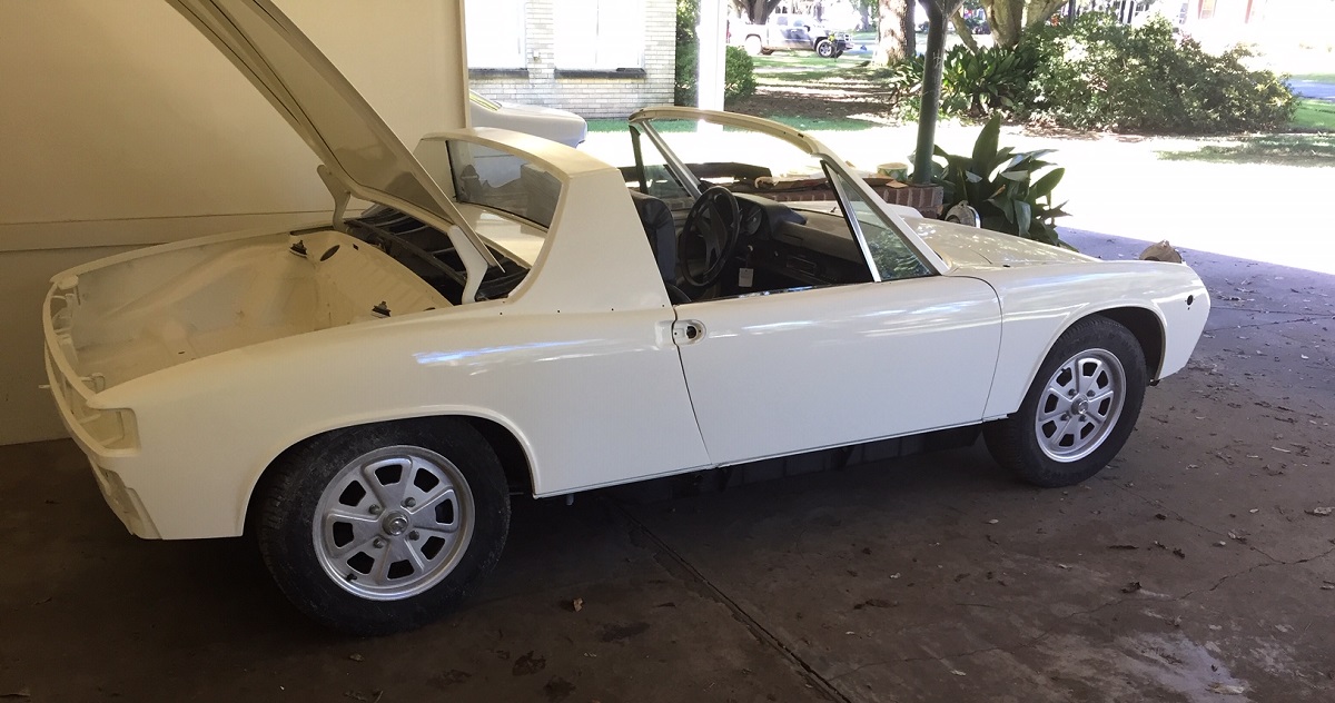

Most of the work was done this weekend, but I started putting it back together after it came back from getting repainted. Front end is mostly done. Rear end is waiting on the rear valence to be painted. After that I'll have to install the sail panel trim, windshield and the remaining interior bits.

(IMG:style_emoticons/default/beerchug.gif) amazing how getting your bumpers and lights hooked up and into place it makes the car look and you feel like you can see light at the end of the tunnel!
car looks super, love the white for sure.

Thanks, Phil. It does look much better now compared to the washing machine white that was on there before.

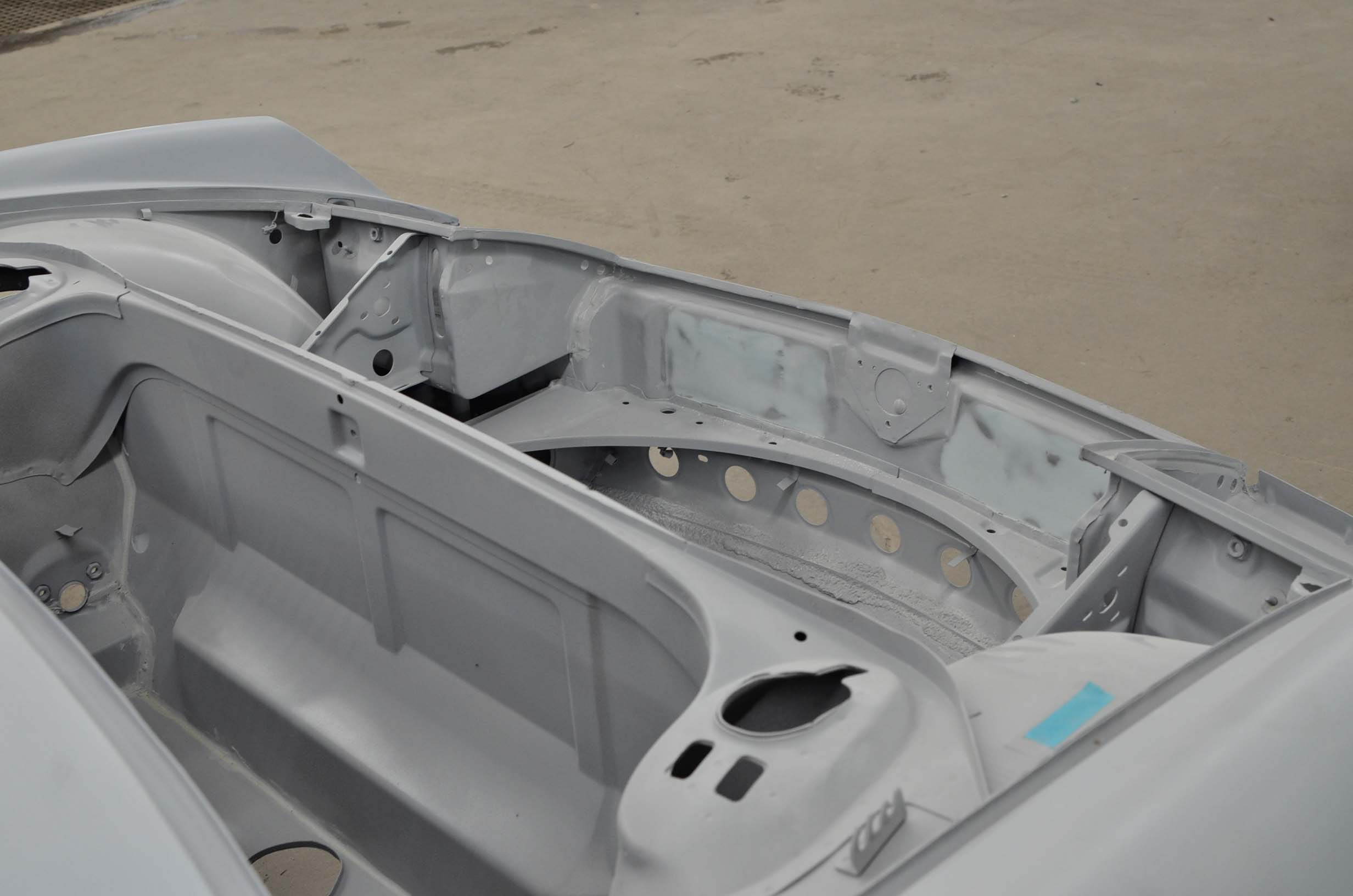

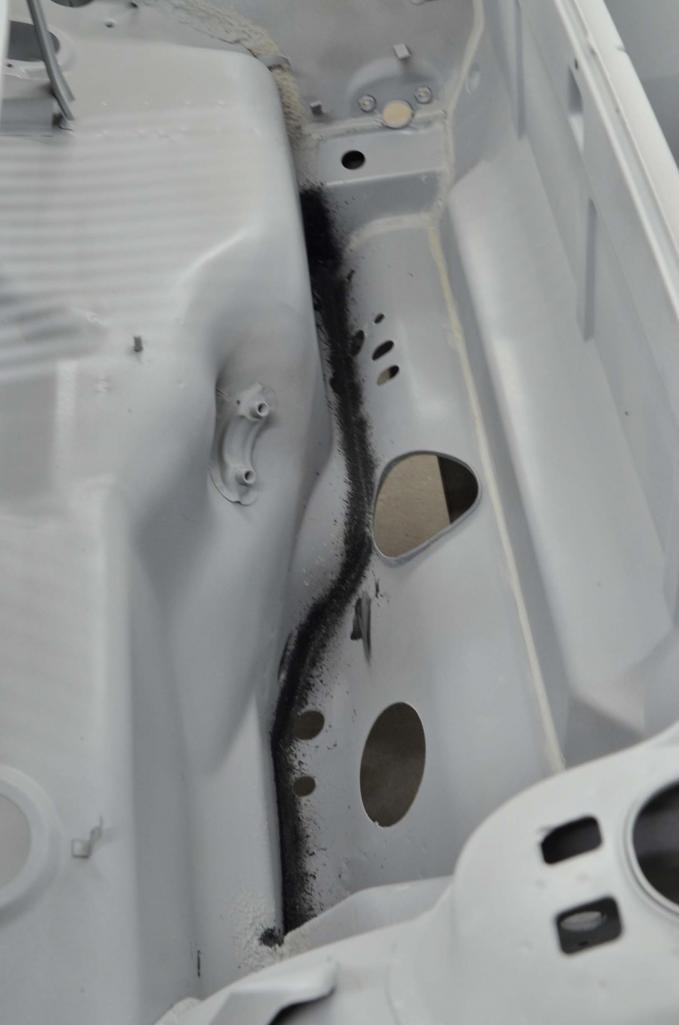

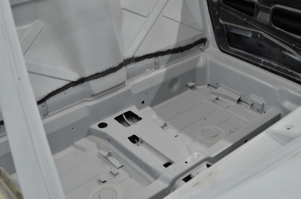

Did all sorts of work. Body, brakes, etc....
You can read about it here http://www.2002and914.com/?p=727 if you're interested.
Got the doors left and then it's on to the rust in the trunk.
Having lots of fun, that's the main thing!

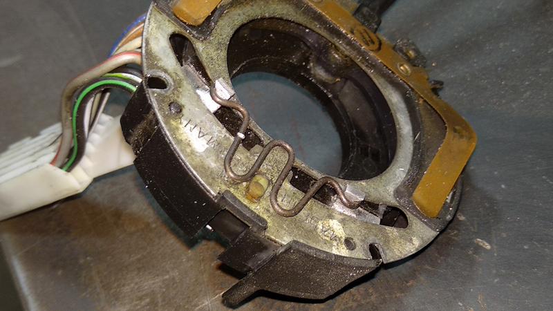

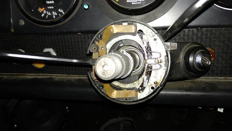

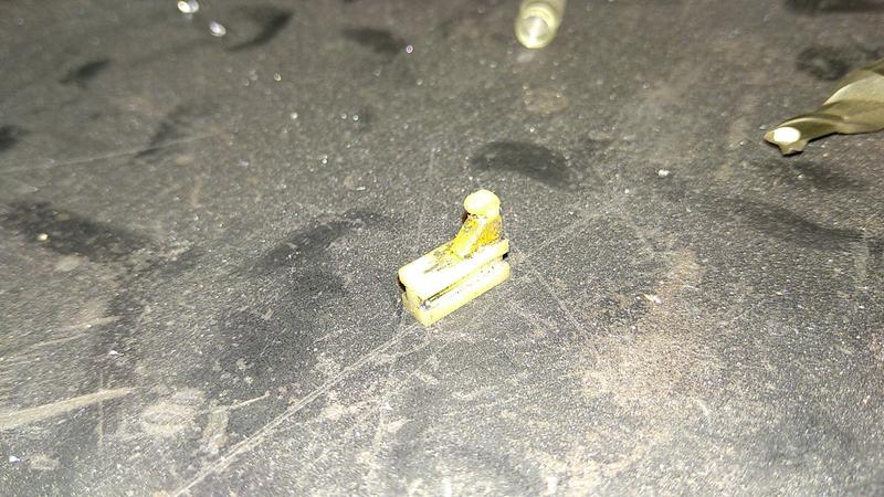

Today I repaired my broken auto-cancel turn signals, on Monday while driving home from San Jose, I tried to hold the lever up while it was auto canceling and it snapped one of the existing spring hooks.
(IMG:http://www.914world.com/bbs2/uploads_offsite/i.imgur.com-18880-1540981089.1.jpg)

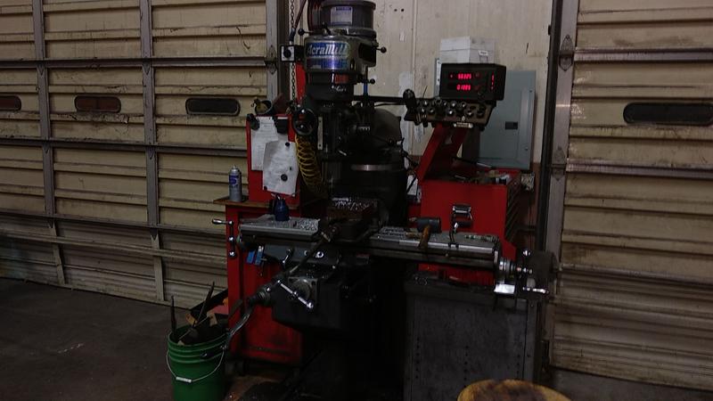

Took the dimensions of the good hook to figure out the profile I needed to make for the blank...
(IMG:http://www.914world.com/bbs2/uploads_offsite/i.imgur.com-18880-1540981089.2.jpg)

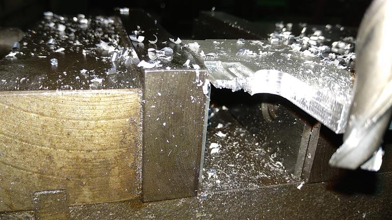

and went over to the milling machine.
(IMG:http://www.914world.com/bbs2/uploads_offsite/i.imgur.com-18880-1540981089.3.jpg)

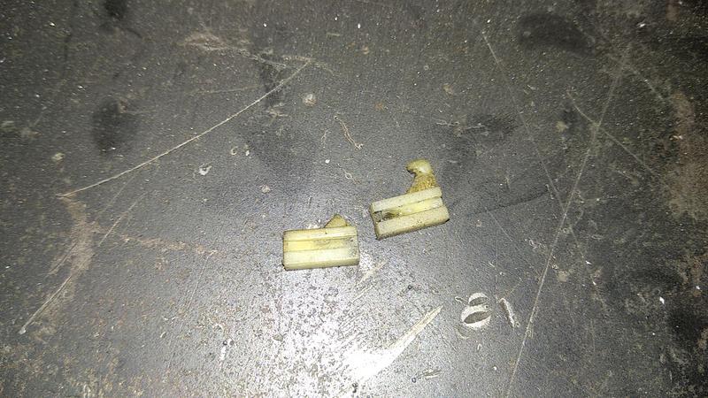

I milled down some aluminum to match the profile and cut the pieces out.
(IMG:http://www.914world.com/bbs2/uploads_offsite/i.imgur.com-18880-1540981089.4.jpg)
And then after finalizing the shape with files, sandpaper, and a bandsaw, I reinstalled it in the steering wheel with some lubrication.
(IMG:http://www.914world.com/bbs2/uploads_offsite/i.imgur.com-18880-1540981089.5.jpg)
(IMG:http://www.914world.com/bbs2/uploads_offsite/i.imgur.com-18880-1540981090.6.jpg)
Attached the steering wheel and gave it a quick test before heading back home.
Works just like before now.

Thanks! Went through a couple end mills making it unfortunately, not used to making slots that small, but it seems to be doing just fine so far!

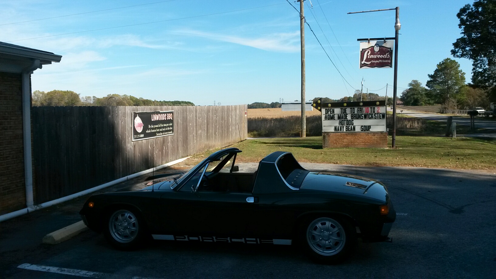

drove it, then a "pit stop":

Nice work (IMG:style_emoticons/default/aktion035.gif)

home made brunswick stew, yum! (IMG:style_emoticons/default/beer3.gif)

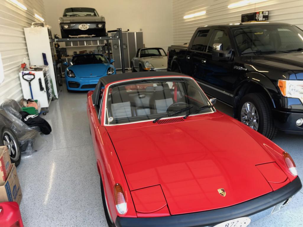

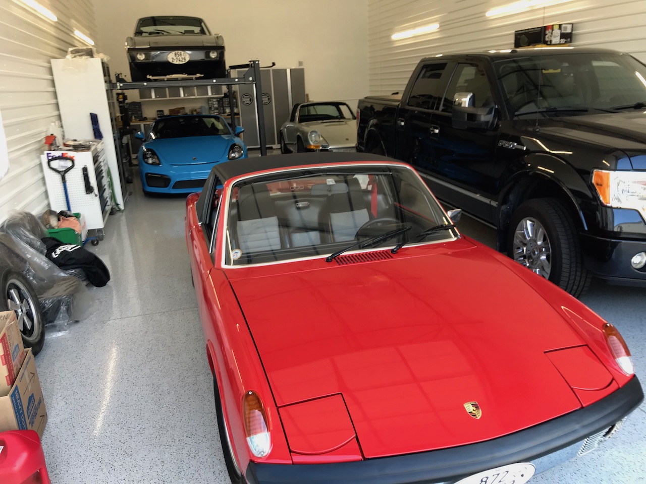

Drove both 914's and did some rearranging in the garage... big PCA concours in Scottsdale on Saturday and I'm entering the bahia '73...Attached Image
