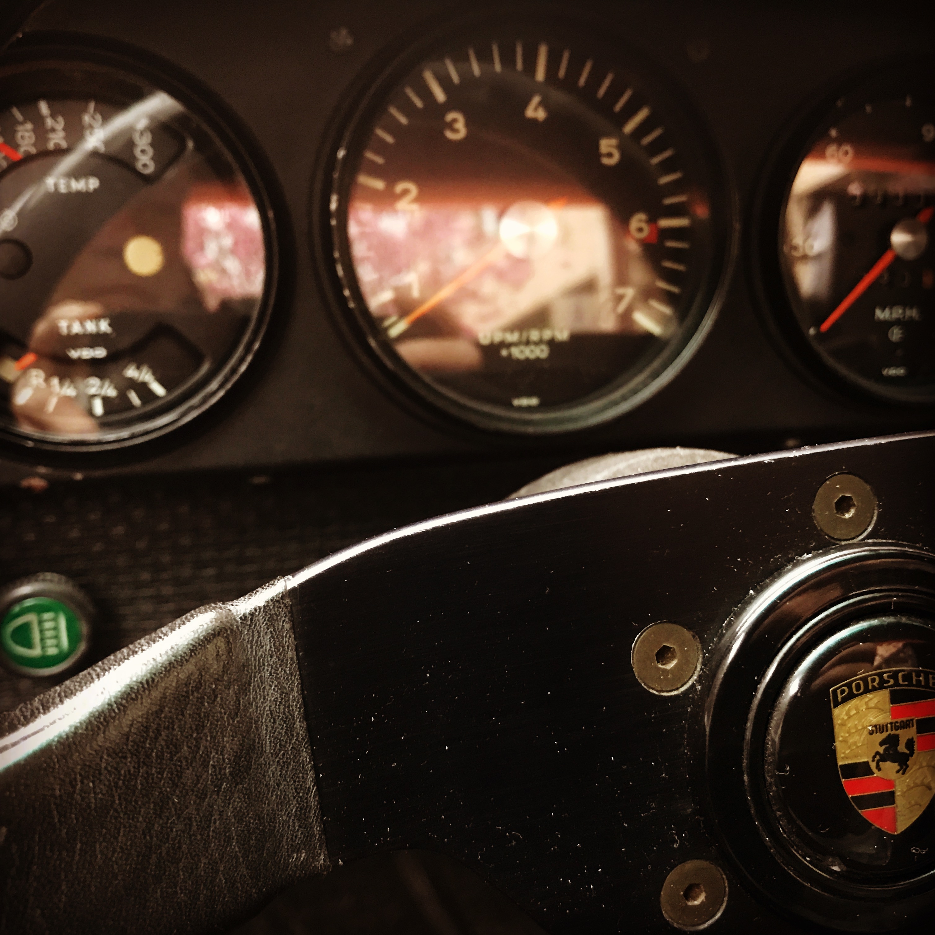

Drove it like I stole it...

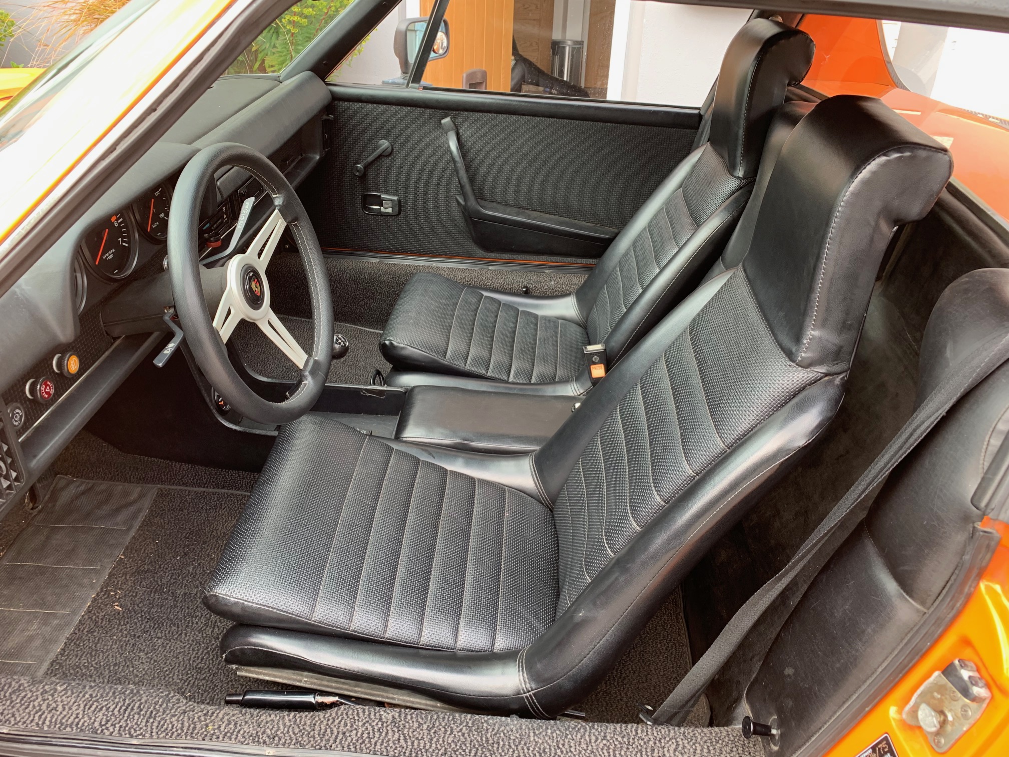

Went from this, with past owner's lovingly applied electrical tape 'repair'
To this, with Facebook-find ready retrimmed seats...

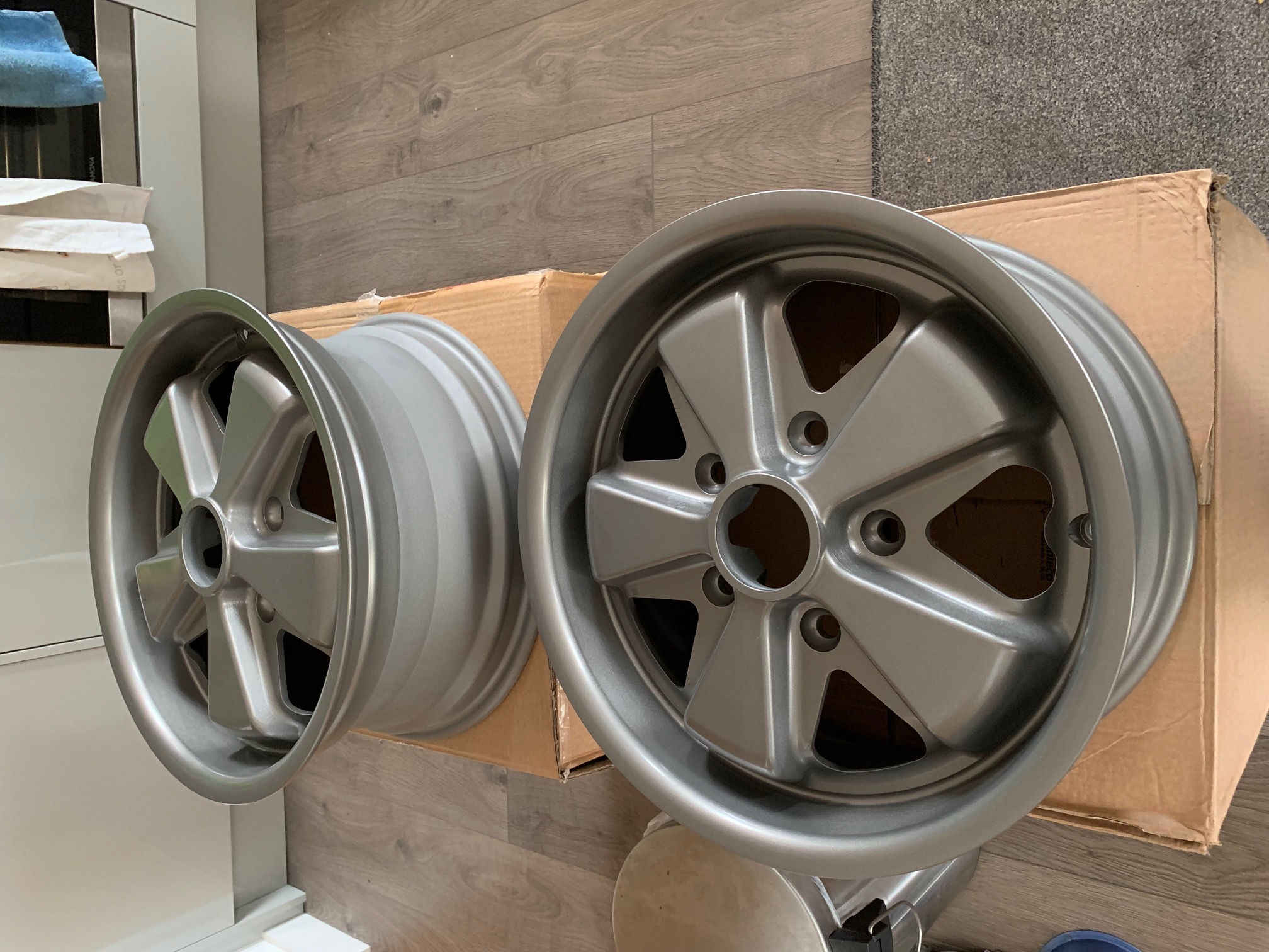

And collected new 7R wheels from paintshop...

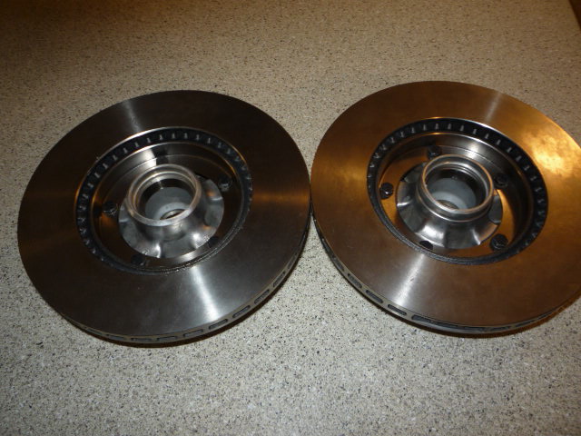

Cleaned up -6 hubs. Got new bolts, washers and nuts. Bolted and torqued (17 lbs) new Bosch Quite Cast rotors to the hubs. Rotors say they were made in Italy, thinking Bosch farmed them out to Brembo. Got new Timken bearings seals for the hubs.

Mmmm ... eye candy (IMG:style_emoticons/default/drooley.gif)

Diggin' the wheels.....nice.

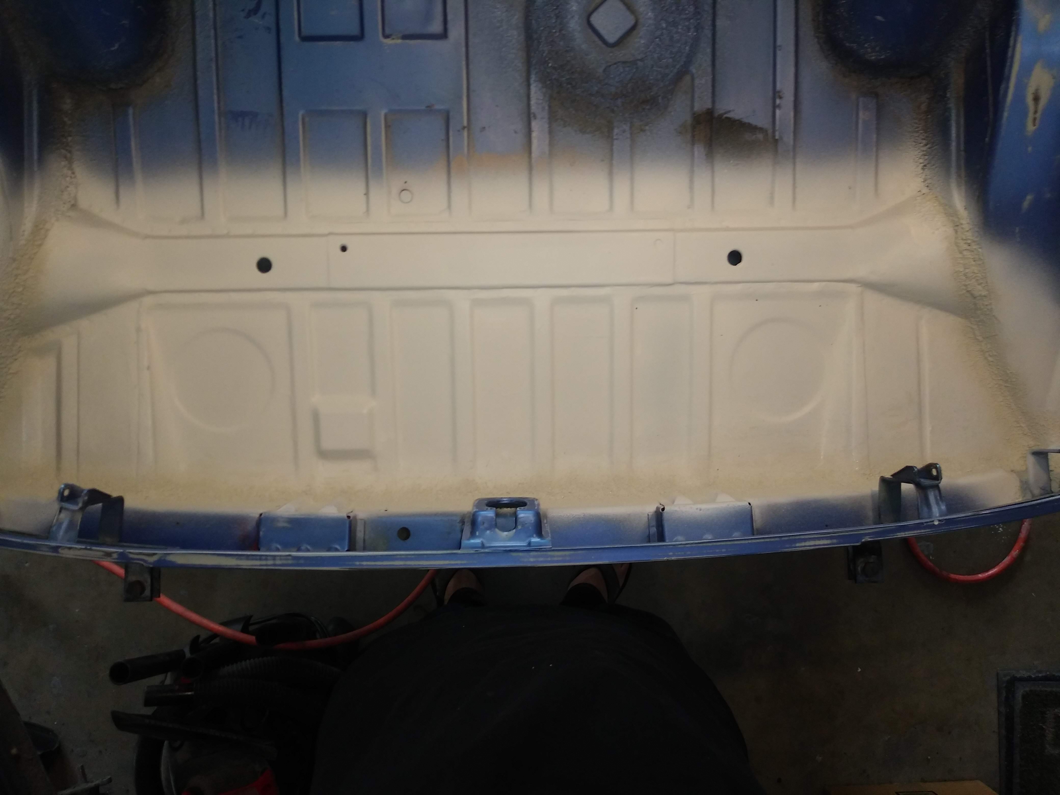

Got the sealer on the replaced rear trunk floor today. Not much to look at but a huge step in the restoration repair. Check out the full rust repair story at http://www.2002and914.com/home/the-914/bod...nk-rust-repair/ … go thru the other pages while you're there, if you're up for it.

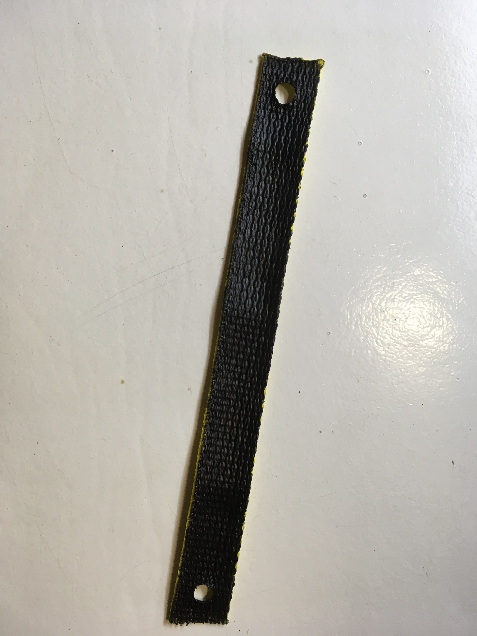

Made a concours weenie throttle cable strap!
1). Ordered 1’ of 3/4” wide lightweight polypropylene yellow webbing:
2). Cut to 7” length, punched 1/4” holes, on ends then heat sealed holes and strap ends and painted backside with 3 coats of black plastidip:
3). Finally installed 1/4” brass grommets in holes:
closeups:
