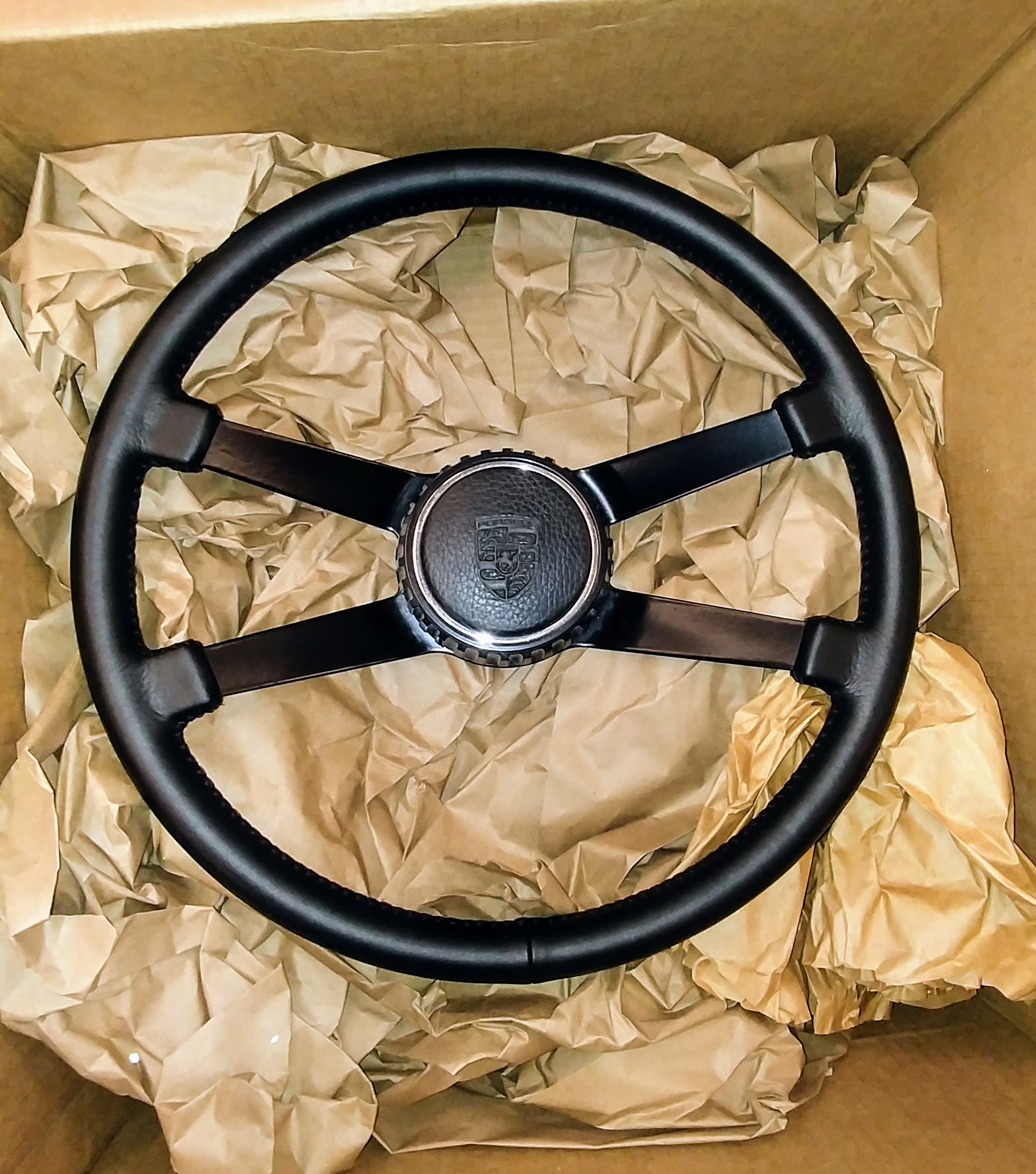

Got my wheel back from Dallas. Attached Image

Oh, my. That's beautiful @mb911 ....how thick of a wrap is that? Mine is going to dallas after Memorial Day.

It was the same cost either thickness and I liked the 1/16" wrap more then the 1/8" from the pictures. It is still thick wrapped just not as bulky as the thicker ones.

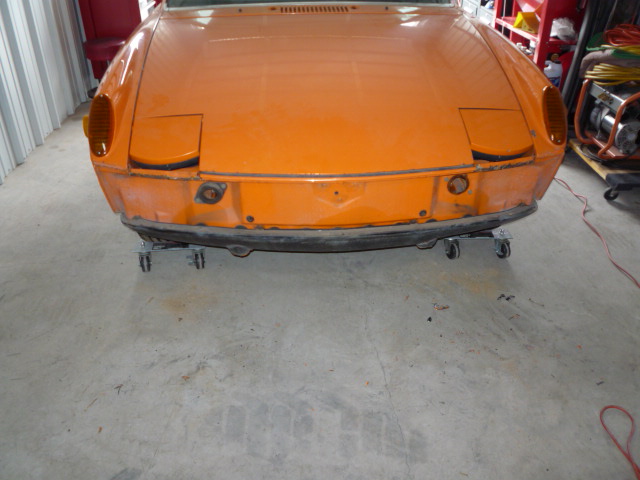

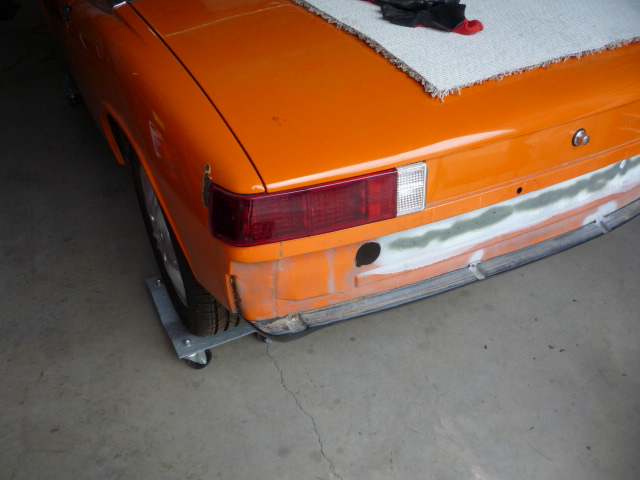

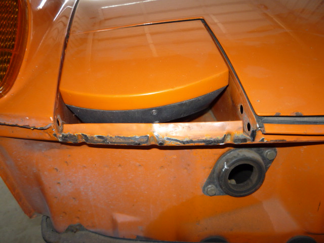

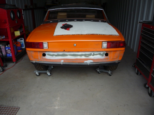

Started the bumper conversion today. Got the grinder, some cutting wheels and got started. I opted not to drill holes and just ground everything off. Found rust, imagine that. Primer in rear is from trunk pan replacement.

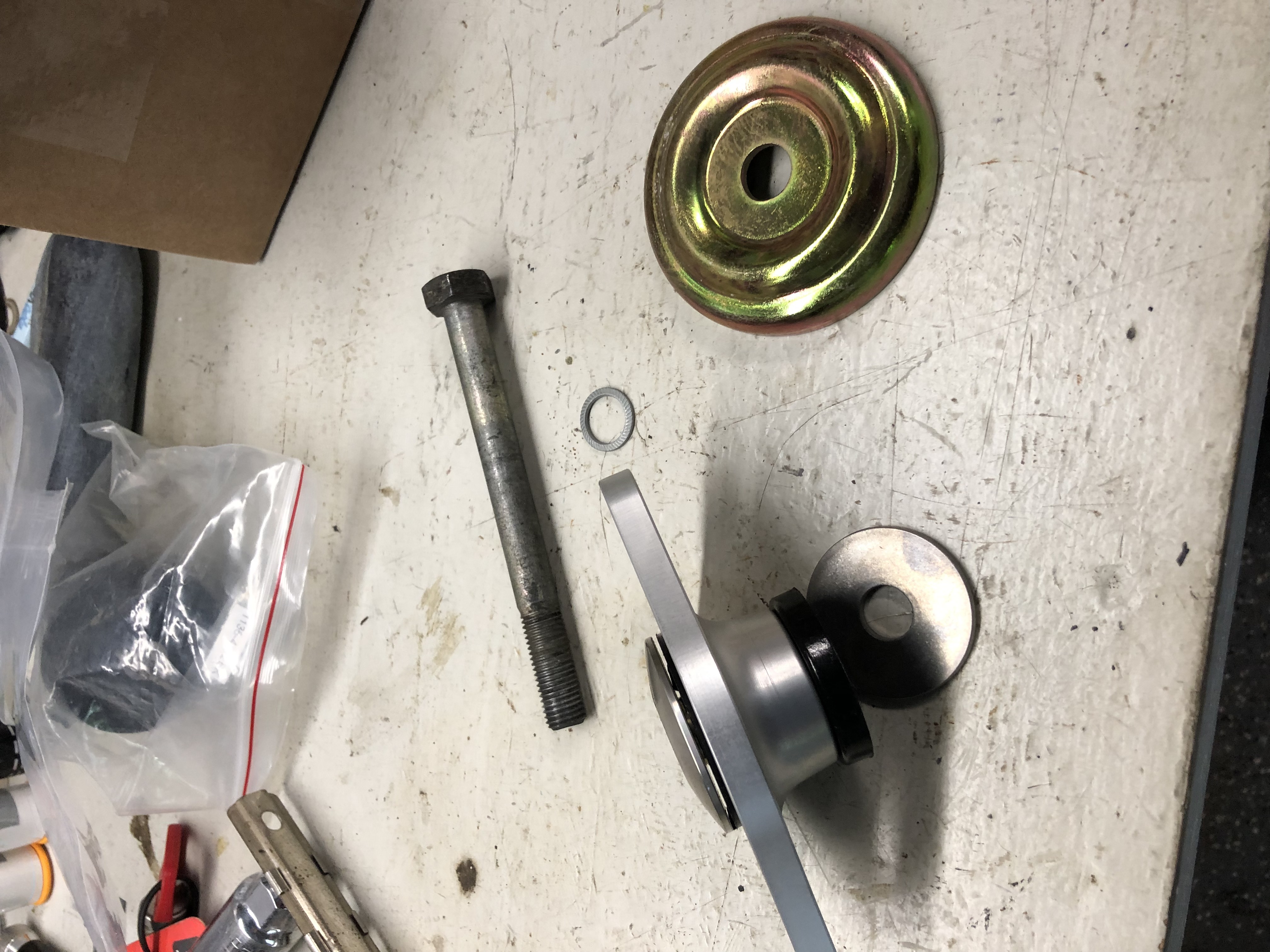

I replaced the solid aluminum/Delrin PatrickMS sourced transmission mounts with Wevo mounts. I chose the softer black pillows. I think the vibration through the chassis from the hard mounts was too much for me. I used the cup washers under the mounts and on top of the transmission ears.
After driving the car, it really seems better. Less "valve" sound through the car.
I think it was the right move.
