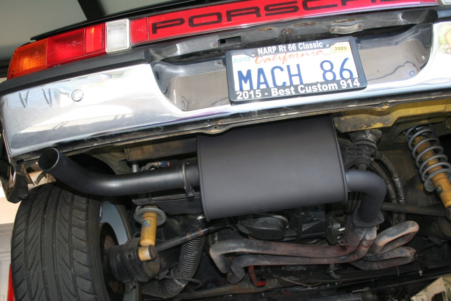

Installed a new muffler. Re-wired my CHT gauge with a new spark plug style sender. Now the CHT works. 325/350 degrees. (IMG:style_emoticons/default/biggrin.gif) Found and tightened up a small exhaust leak. Then just a general cleaning up. Drove it to the airport today and when I started it to come home, it made a nasty sounding whirring noise for a few seconds. I think my alternator is about to die. I'll pull the belt off tomorrow and spin the pulley and see how it sounds. So, I either change it out now or wait and see if it will get me to the WCR and back. (IMG:style_emoticons/default/confused24.gif) The alternator has probably been on the car since 1973 so, maybe I'll end up changing it before I leave. (IMG:style_emoticons/default/biggrin.gif)

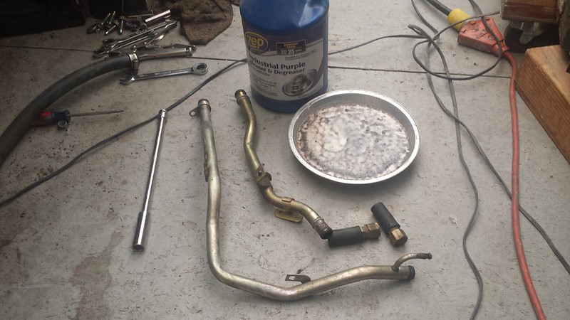

Busy couple days on the no flow problem.
Pulled the thermostat, cooked it and it popped just fine.
Had to drop the motor to pull the water pump, which was fine.
(IMG:http://www.914world.com/bbs2/uploads_offsite/live.staticflickr.com-431-1559378361.1.jpg)
Found the problem with crud buildup in these 2 pipes. One is the heater return, the other is the radiator bypass, which is how the coolant flows when the thermostat is closed. Capped the end, filled with Purple Stuff and left it overnight. Dumped it in the pan and created a chemistry experiment. (IMG:style_emoticons/default/huh.gif)

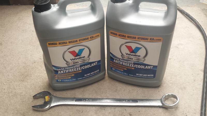

Did it proper this time and filled with toxic masculinity (blue) (IMG:style_emoticons/default/laugh.gif) Discovered the new system capacity with the Celica Performance rad and heater core in the fresh air box is nearly 3 gallons. Took 10 top-offs to get it burped.

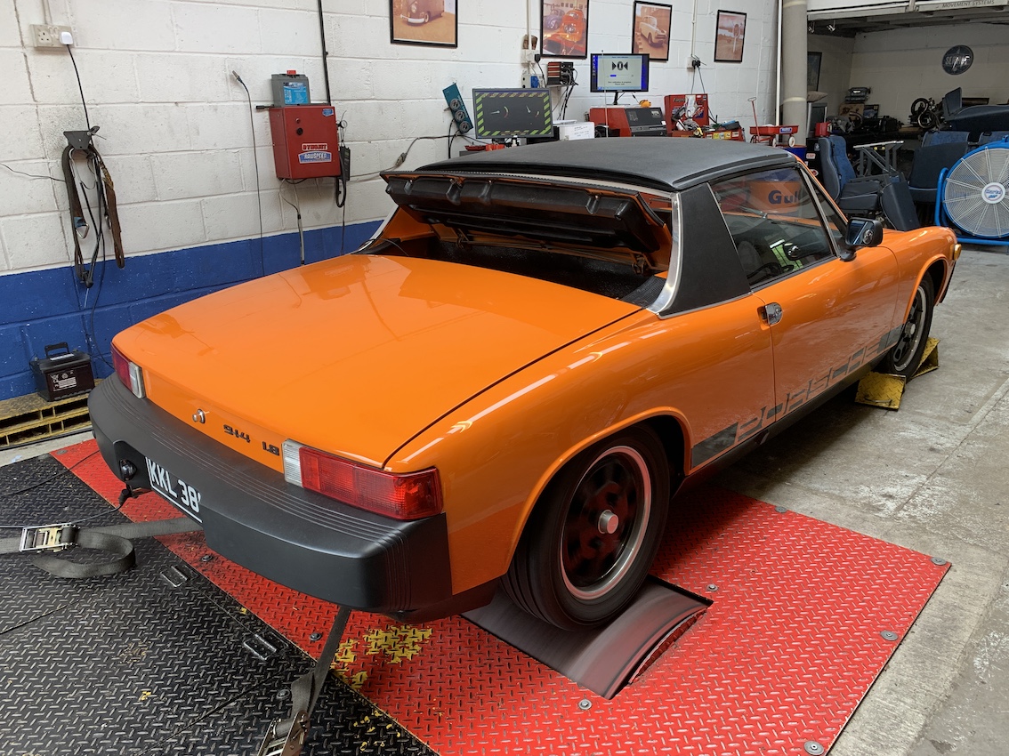

Spent time on rolling road - crap results from a 2056 with Webers, 86A cam and 42 x 37 heads. Car came with 28mm venturis (ordered some 32mm...) and has those awful 2.0-litre heat exchangers with restrictive primaries. Barely struggled to 77bhp at the wheels - roughly a little under 100bhp at the flywheel. New SSI and Dansk GT-style muffler on order...
