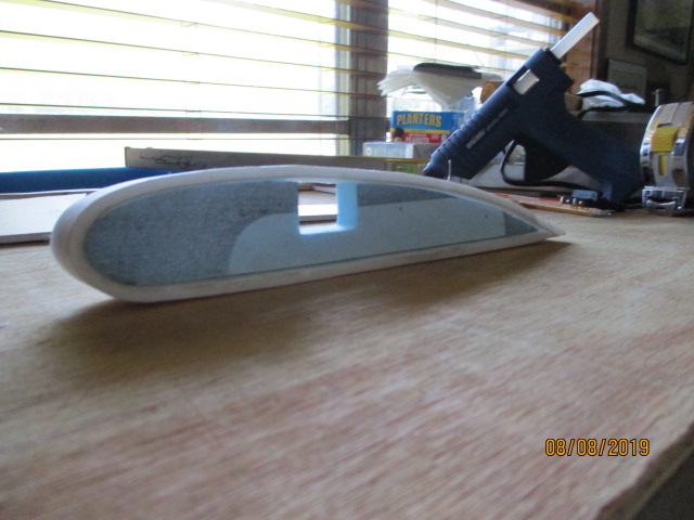

Make a mock up of the frame for the rear wing on Carerror. It's to big, I need to make so I can wrap the foam frame in only 20" of foam board. Right now it takes 21 1/4".
I'll make templets of the foil shape when I fond one that works.

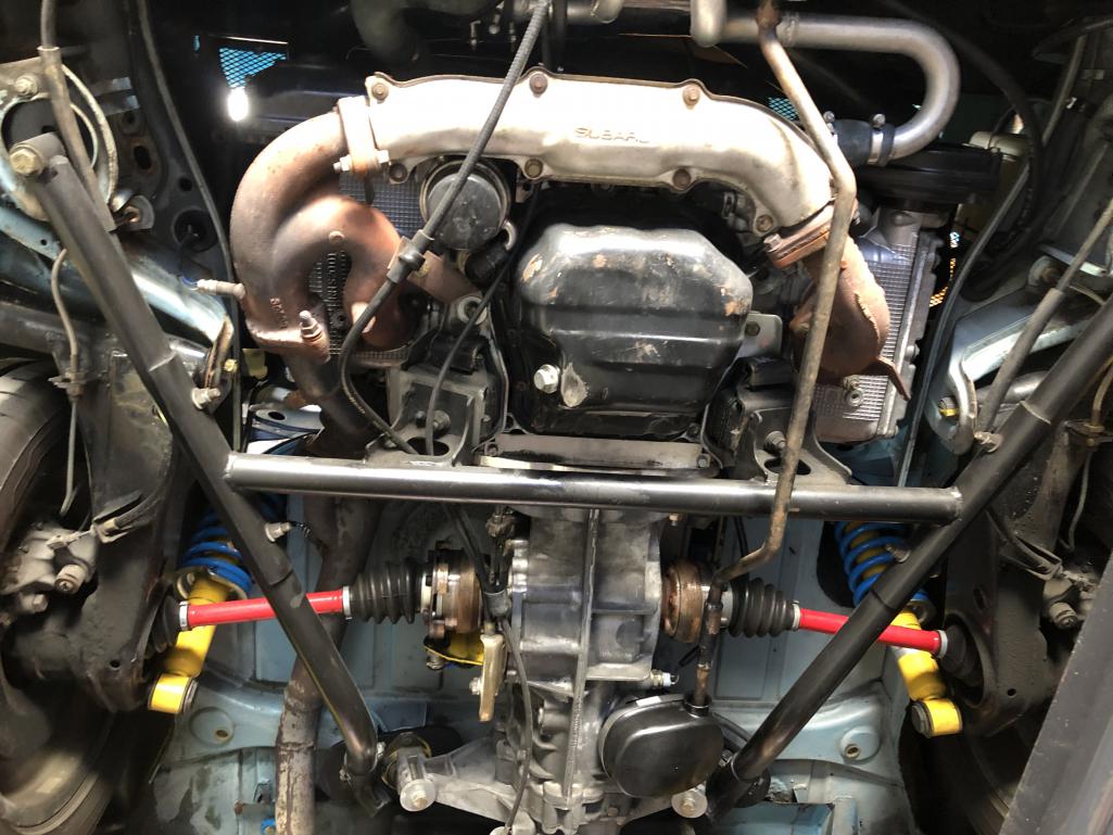

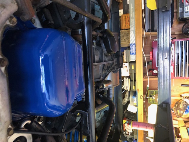

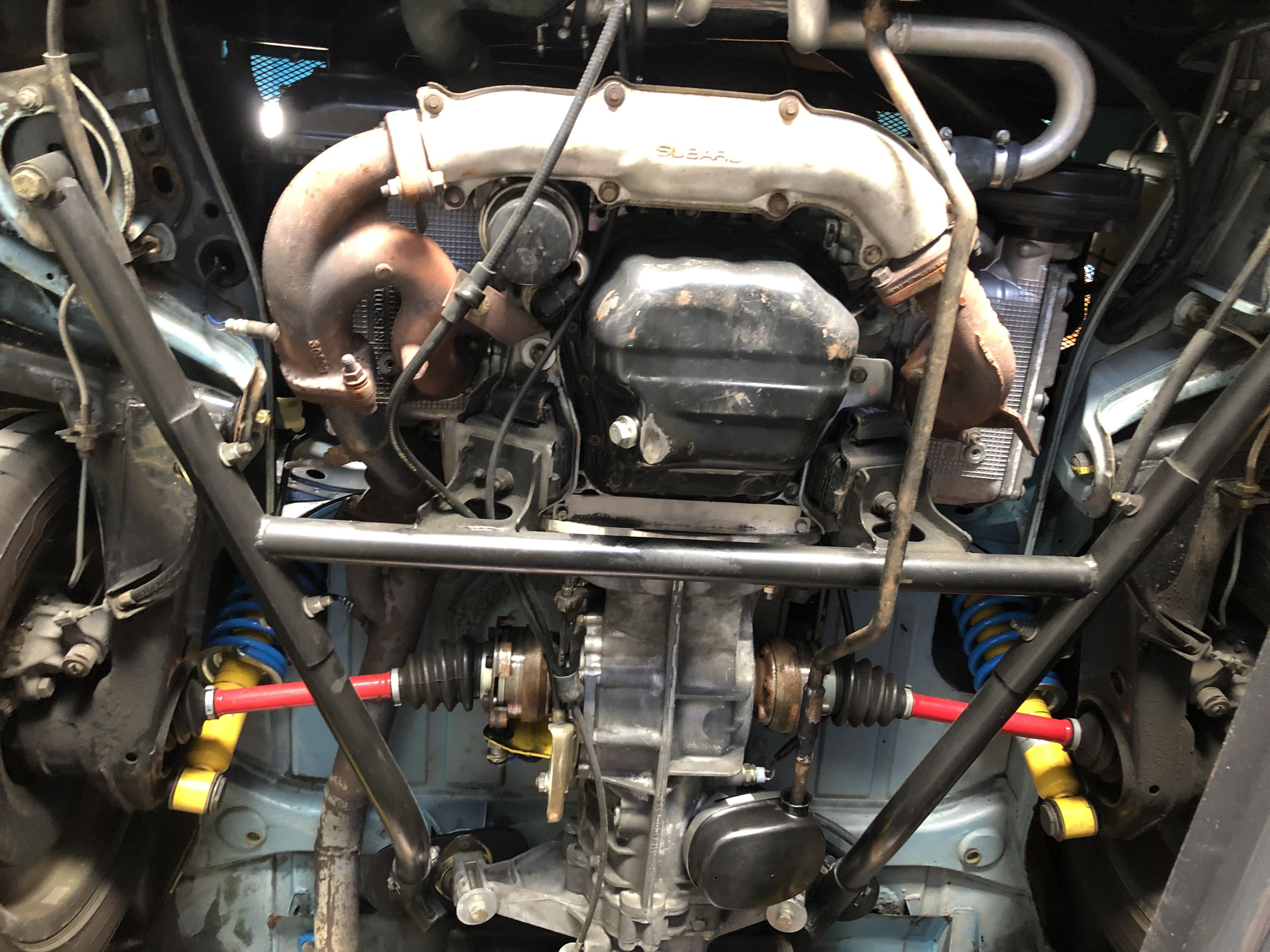

Had a pretty ratty oil pan.. needed an oil change too..
So I pulled the old pan and decided to upgrade the 2.0 Subaru Turbo with the Killer Bee Motorsports oil pick up tube (really beefy) and baffle. Cleaned up the pan, and painted it Ford Blue to give a little color under the car. Also wrapped the up-pipe and some exhaust tube with heat wrap to try to lower the temp under the cylinders a bit.
The turbo was not properly venting and causing weird noises due to pressure irregularities. So I installed an atmospheric blow off valve. The PO had a shot totally block off the valve so it was not right to being with.
Also installed a COBB 3-port electronic boost controller and plumbed all the vacuum lines.
Fresh Motul, factory Subaru filter.
So far, it runs very smooth. Accessport Version 3 tune on the horizon, to replace the 2006 Accessport Version 1 tune it runs on currently.
Photos were larger than expected so Ill put them in another post....Attached Image Attached Image

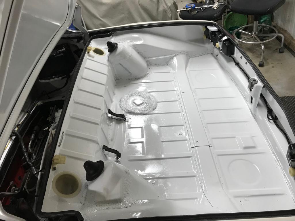

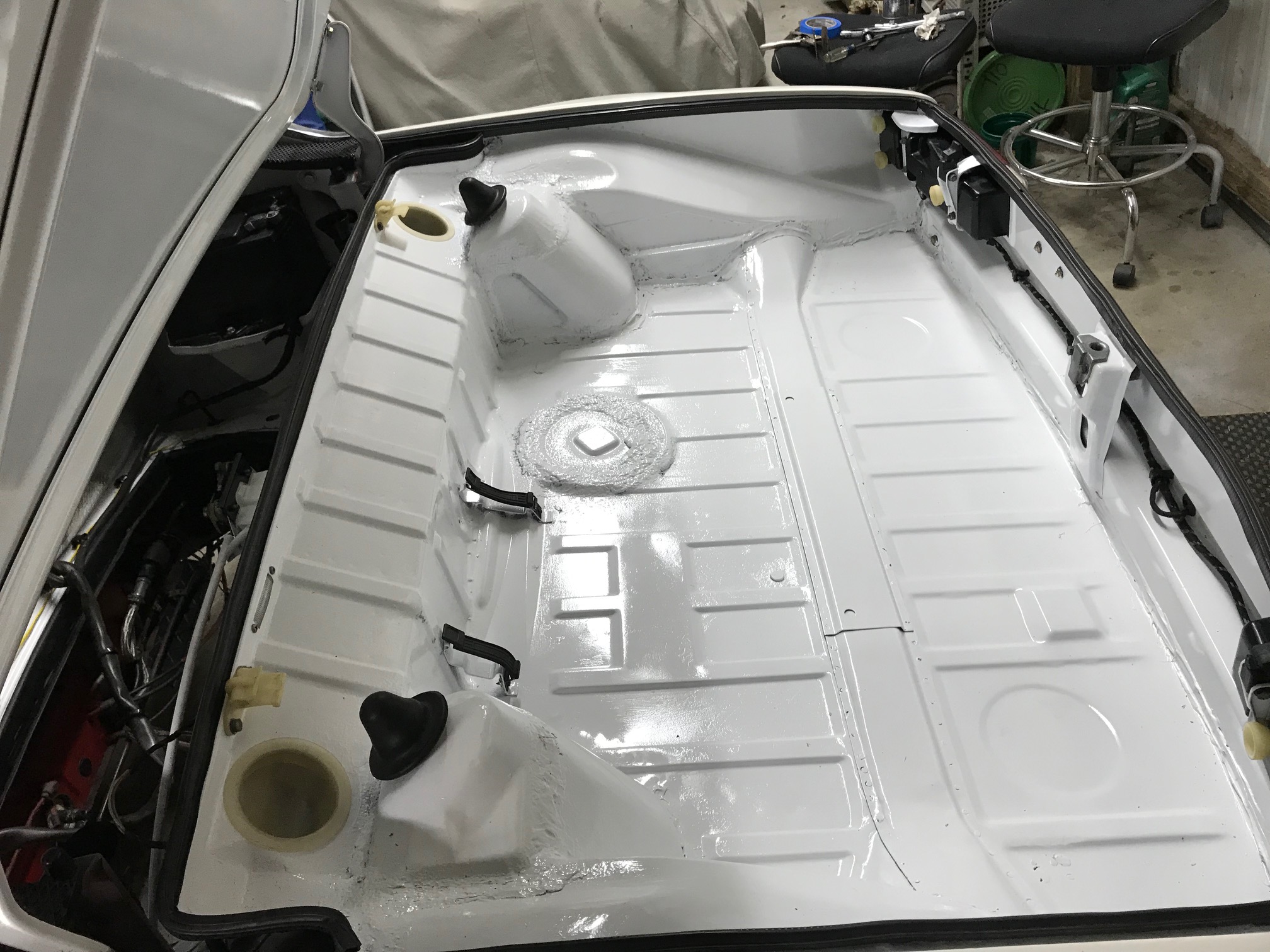

Painted the trunk, and engine bay. Took 2 days.
