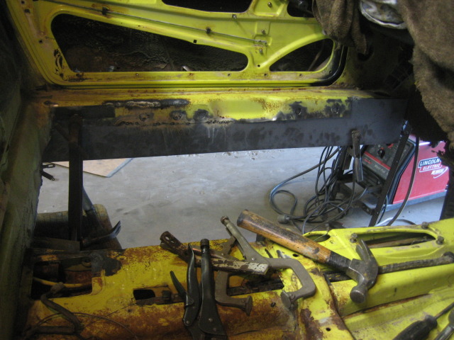

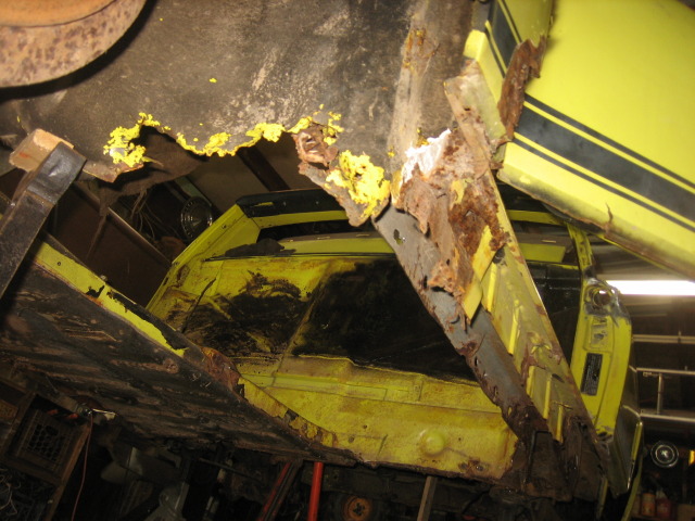

a few hours of welding and my car wont fold in half any more (IMG:style_emoticons/default/biggrin.gif) got the driver side inner all done and started on the outer its almost ready to weld in. I also welded a reinforcment piece onto the inner one up front so that it actually does something. Ill post pics of that eventually
(IMG:http://www.914world.com/bbs2/uploads_offsite/i2.photobucket.com-13819-1341279007.1.jpg)
(IMG:http://www.914world.com/bbs2/uploads_offsite/i2.photobucket.com-13819-1341279008.2.jpg)

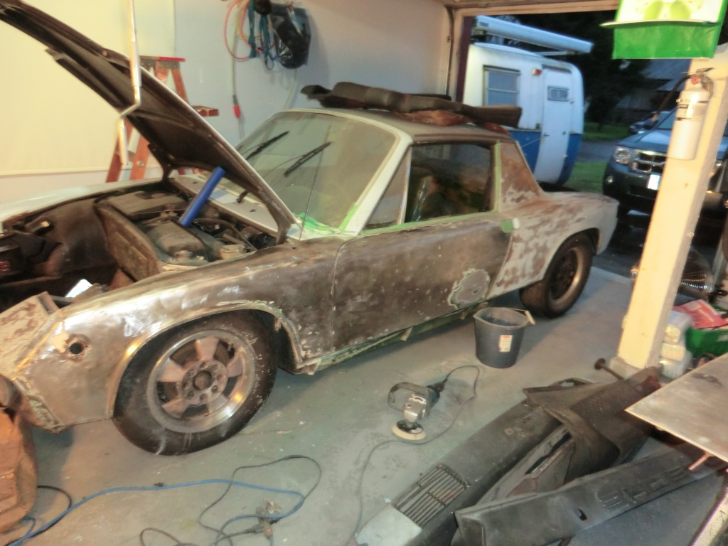

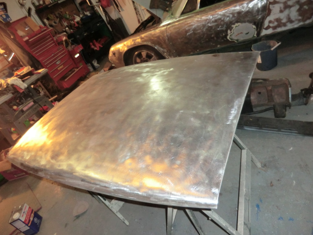

Finally had a day to work on the teener, stripped the paint on rear trunk, driver fender and door. Did a little on the rear sail and 1/4 panel but it was getting a little late. Car is in fairy good shape expect rain channels under the front hood.
Anyone know how to take the sail trim off having issue with the lower ones? use to new cars with plastic pull pins can't figure these ones out. Also any tricks for the windshield trim as well.
(IMG:http://www.914world.com/bbs2/uploads_offsite/i156.photobucket.com-14477-1341292293.1.jpg)
(IMG:http://www.914world.com/bbs2/uploads_offsite/i156.photobucket.com-14477-1341292293.2.jpg)

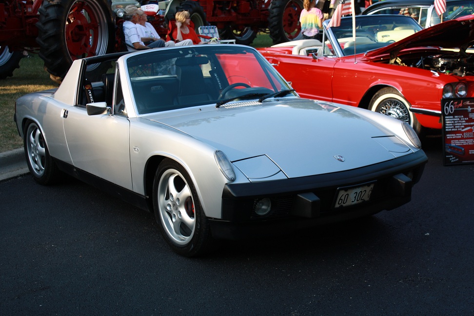

Took mine to a local family festival 4th of july celebration that had small classic cars display. The 914 drew as many looks as the other cars and seemingly more questions. A lot of compliments and nice stories of the love for these cars. (IMG:style_emoticons/default/wub.gif)

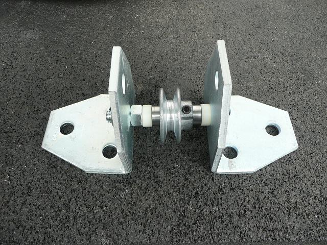

I needed to devise a method to keep the winch cable from digging into the rear threshold when pulling a car up the ramp of the new trailer.
I picked up a 2" dia. pulley from the local hardware store, rooted around and found bushings, spacers, a 1/2" bolt, nuts and a couple of unistrut angle brackets in my stash bucket, and constructed a guide device (sheave) that I'll mount to the floor at the threshold. The cable will 'ride' in the pulley groove until the car is high enough on the ramp to lift itself out of the pulley and continue winching unabated (IMG:style_emoticons/default/mueba.gif)
Still need to trim a little off the top of the brackets (IMG:style_emoticons/default/sawzall-smiley.gif)

There is a nut securing the trim under the fender, jack up the car, (or take the back wheel off) and look up, you will see iit, 8mm I beleive.
