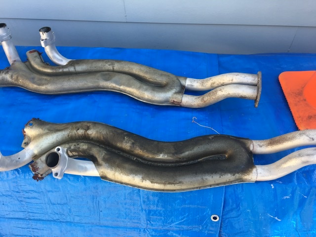

Was a busy weekend on the 914, will get my tank expansion tank back on tonight, pulled it to replace heat tubes and the air tubes up front and finished reinstalling all the trim on the sail panels after redoing the vinyl, big job, hard to get it perfect this is my 3rd time (IMG:style_emoticons/default/blink.gif) (IMG:style_emoticons/default/headbang.gif)

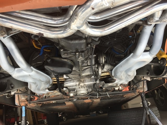

Thanks to Keith Hully (914Toy), he helped change out the heat exchangers. Lots of small stuff got fixed and everything is sound

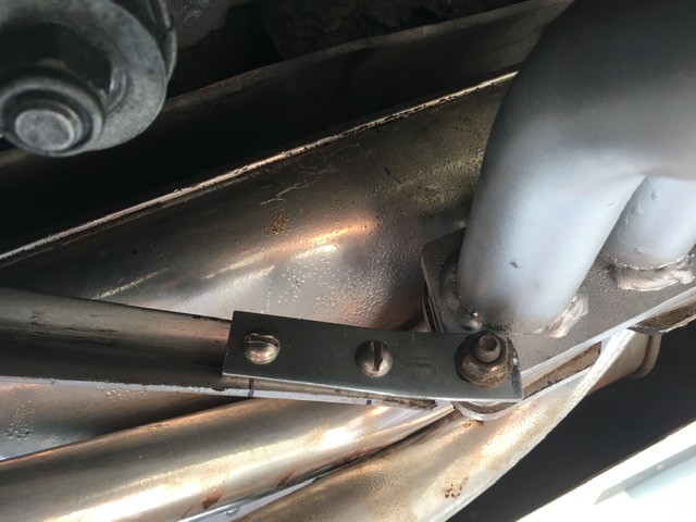

The muffler hanger end was broken, Keith fabricated a new end from a shelf bracket

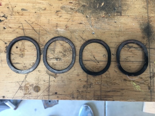

New copper gaskets were installed too; two of the old ones had a lot of soot on them...

Jim, I think I have a couple of good spare 1.7/1.8L muffler hangers laying around ... I'll dig one up and give it to you at the next G&R

QUOTE(raynekat @ Feb 19 2020, 10:56 PM) *
QUOTE(DRPHIL914 @ Feb 18 2020, 05:15 AM) *
Dr. Phil....those heater tubes look much, much better.
Well done!
thanks! it really does look so much better. The original clamps actually were yellow zinc plated, but have some overspray on them etc. i will try and clean them up, and have not been successful in finding identical ones so silver will do for now. i was surprised at how the Mequire's plastic polish and cleaner made the diverter boxes look like new!.
bits and pieces here and there. Its not perfect or concours but it sure is an improvement.

QUOTE(jim_hoyland @ Feb 19 2020, 04:47 PM) *
so all that soot!! obviously you were getting blow by due to not being sealed tight, i had that happen once,didnt get them in place correctly. i am sure things will sound much better now too with your new stuff and new gaskets.

QUOTE(DRPHIL914 @ Feb 20 2020, 07:01 AM) *
so all that soot!! obviously you were getting blow by due to not being sealed tight, i had that happen once,didn't get them in place correctly. i am sure things will sound much better now too with your new stuff and new gaskets.
Always anneal the exhaust 'gaskets' before installing them ... it softens them up so they'll adapt to the mating surfaces better (IMG:style_emoticons/default/idea.gif)

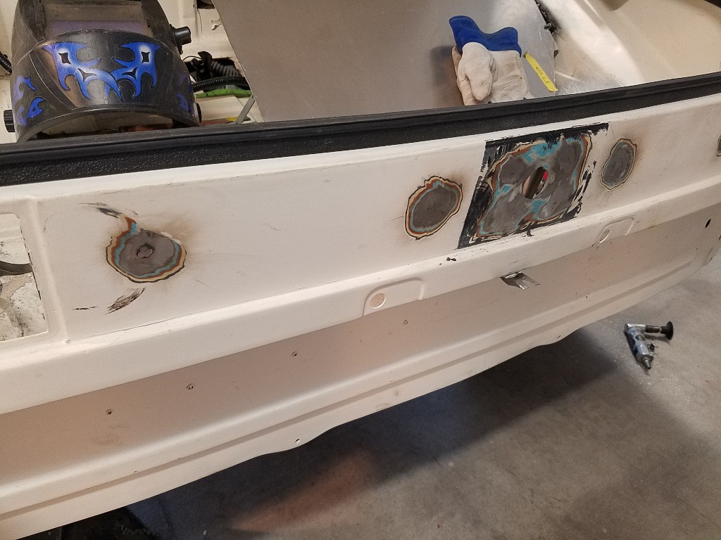

Welded up all the holes associated with rear reflector delete.Attached Image (IMG:style_emoticons/default/welder.gif)
