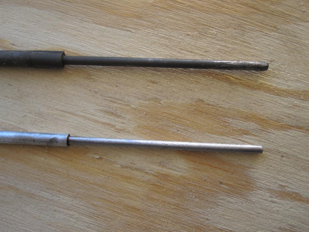

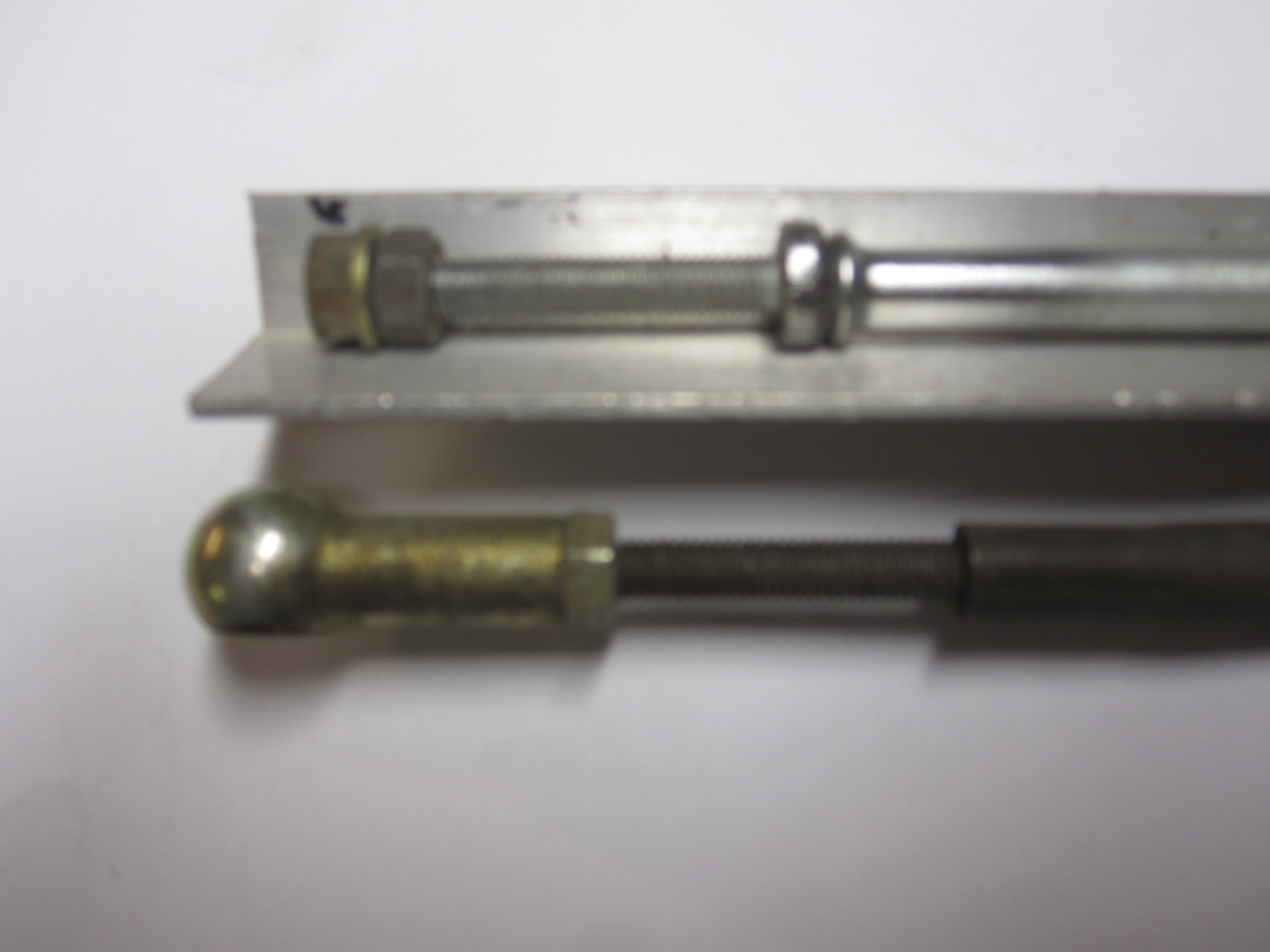

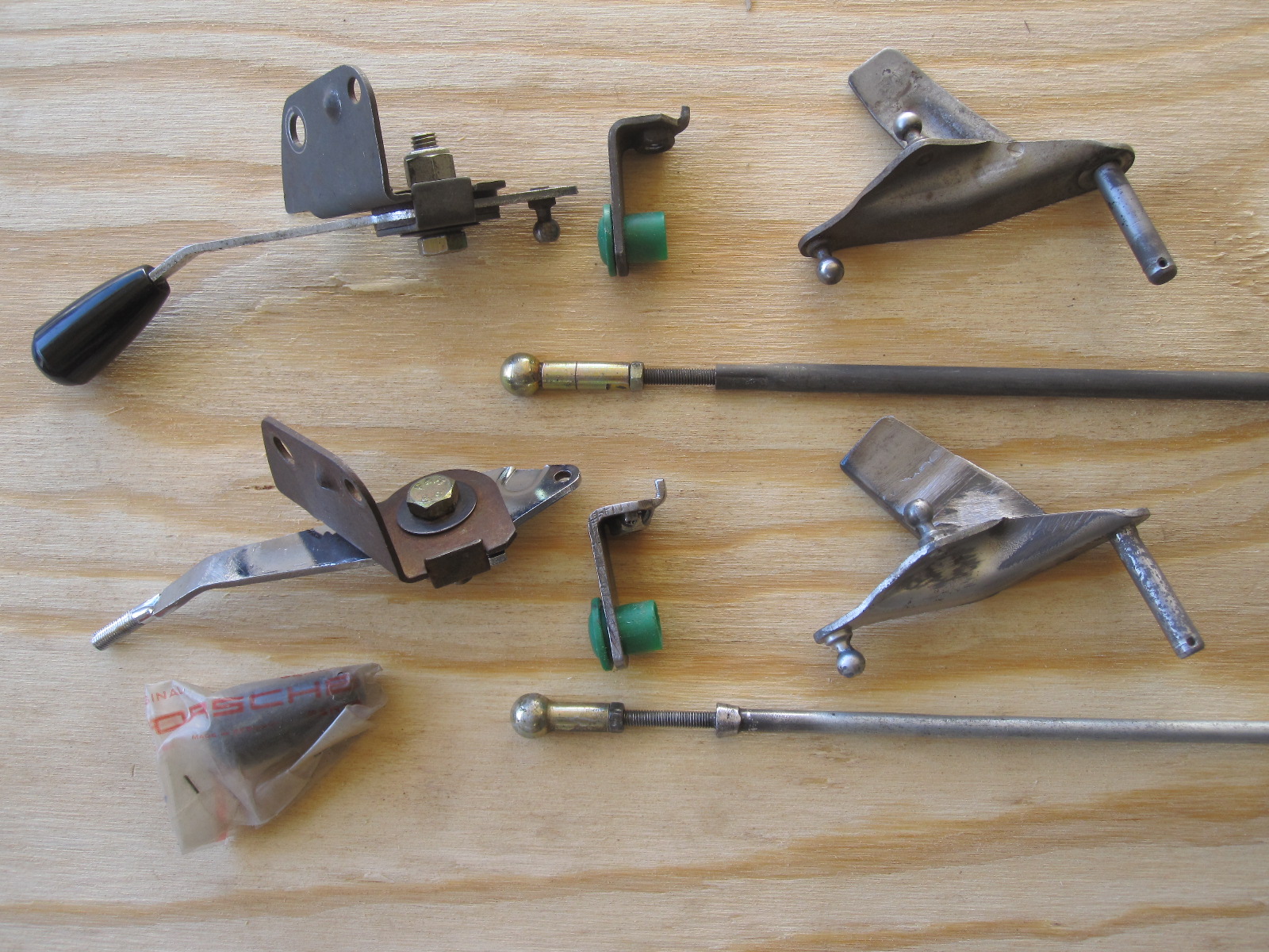

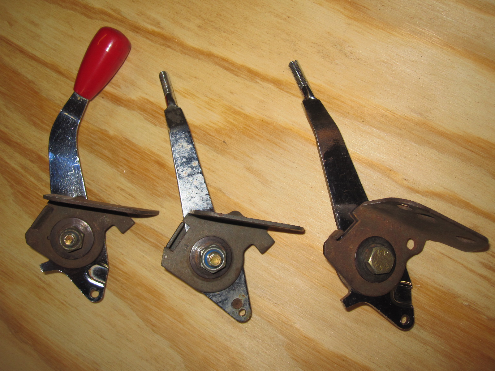

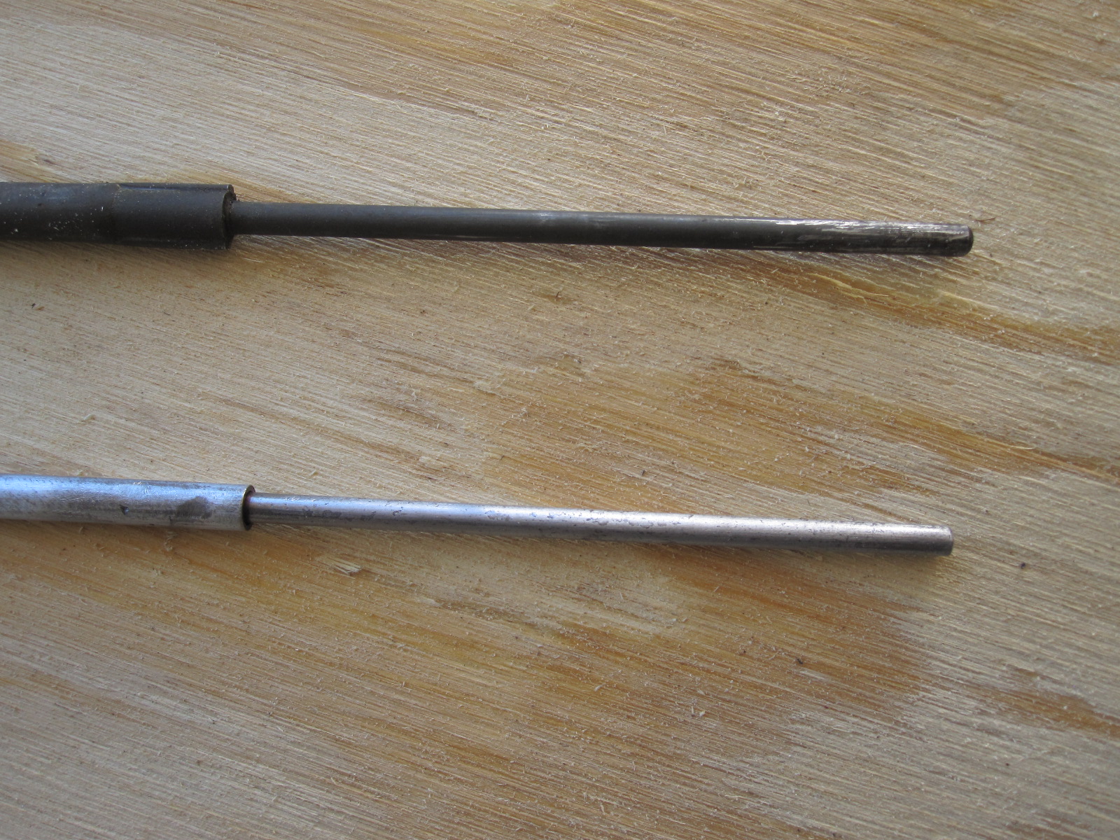

Copied factory parts to fabricate a hand throttle for my GT project.
Cut up a heat control lever and welded it to copy shape of throttle lever.
(temporary green plastic for bushings)
Welded long 4mm bolt to length of brake tubing, welded solid rod into other end.
Fabricated rod support from small piece of 90 degree scrap.
Welded 'wing' onto throttle belcrank at pedal cluster for rod to push against.
Still need to find a ball to weld to new throttle lever.
First photo shows reshaped lever on right
Almost done

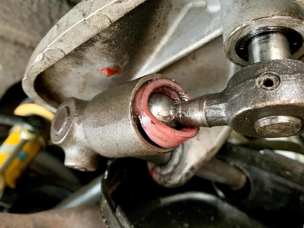

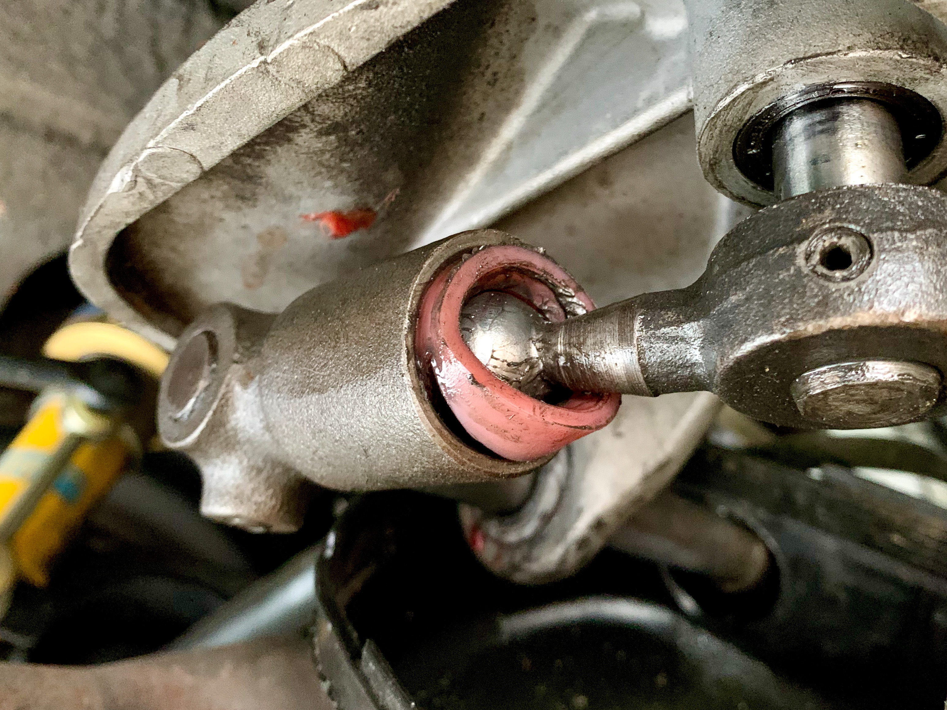

Well I haven't done squat with my 914 in quite some time other than gingerly drive it to a few local events. I'm trying to get back into gear (pun intended) and make further progress before summer.
During my last couple track events I had tremendous difficulty with shifting, mainly 2-3 but it was not consistent. Now I know why.
First I found a seal/bushing in the base of my ancient 1st-gen Rennshift had slipped out of place and partly jammed the shift lever itself. I've had several issues with this Rennshift unit so it's not going back in the car, can't trust it.
Then I found a totally destroyed bushing at the trans end. Chunks fell out when I removed the cover. Luckily the firewall and other rear bushing are good/newer.

QUOTE(campbellcj @ Mar 16 2020, 05:57 AM) *

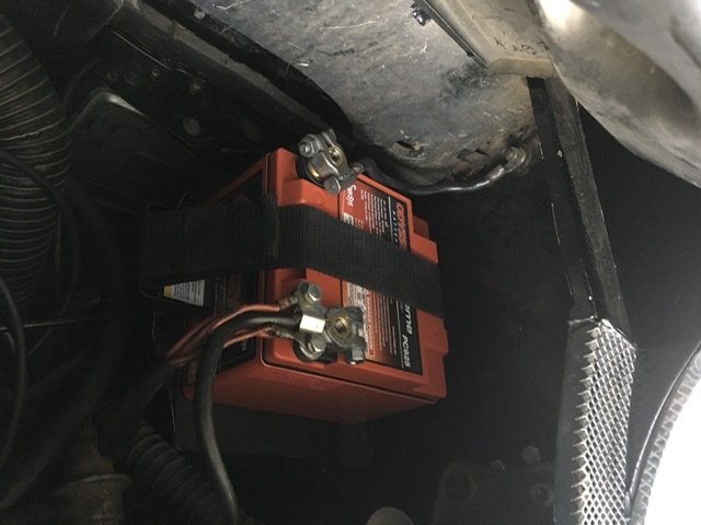

Installed a new Odyssey AGM battery today. Had to make a custom hold-down for it as it’s much smaller than the old school battery it replaced. Hopefully it lasts a good long time.

QUOTE(campbellcj @ Mar 16 2020, 04:57 AM) *
Hmmm ... that cup bushing looks like it's made from a pliable rubber, not hard plastic (IMG:style_emoticons/default/confused24.gif)

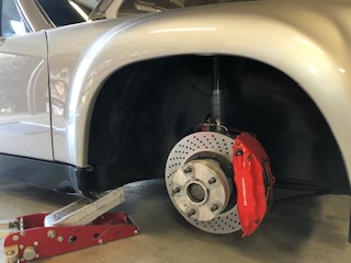

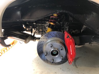

Replaced some rubber stuff, took the wheels off to check out the brakes and see what I had going on in there, front's have brake ducts I didn't know about
Attached ImageAttached Image

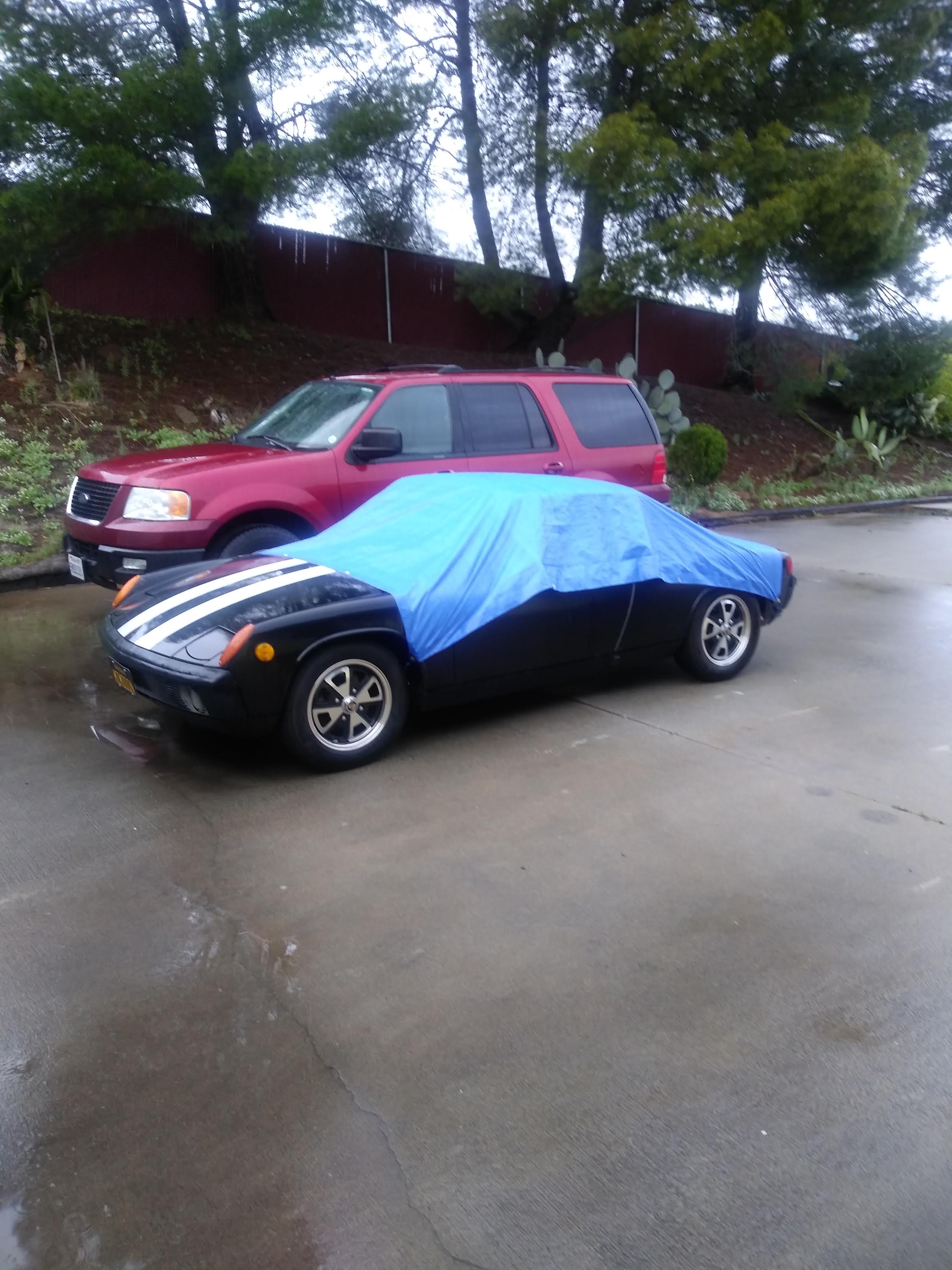

I've only been able to watch the '74 get rained on for the past week or ten days.....

QUOTE(mmichalik @ Mar 19 2020, 08:22 AM) *
They do make bigger tarps... (IMG:style_emoticons/default/poke.gif)
mmichalik
post Mar 19 2020, 12:28 PM
Post #12698
MikeM
Posts: 804
Joined: 27-January 16
From: Valley Center, CA
Member No.: 19,600
QUOTE(rjames @ Mar 19 2020, 11:23 AM) *
(IMG:style_emoticons/default/smile.gif) It only leaks into the cabin. The rest is solid (I get the joke btw, just being a smart a$$)

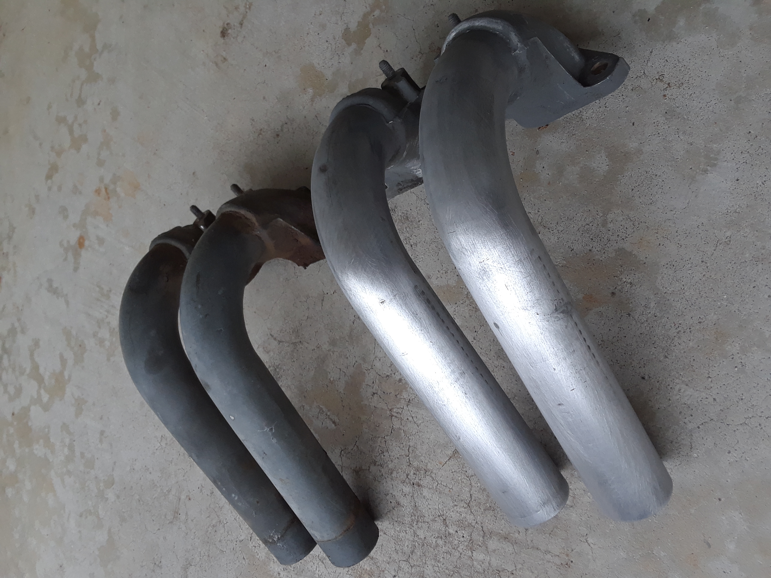

Hit one of the runners with some 80 grit. Kind of like the look. Thinking of clearing the runners and painting the base matte black.
