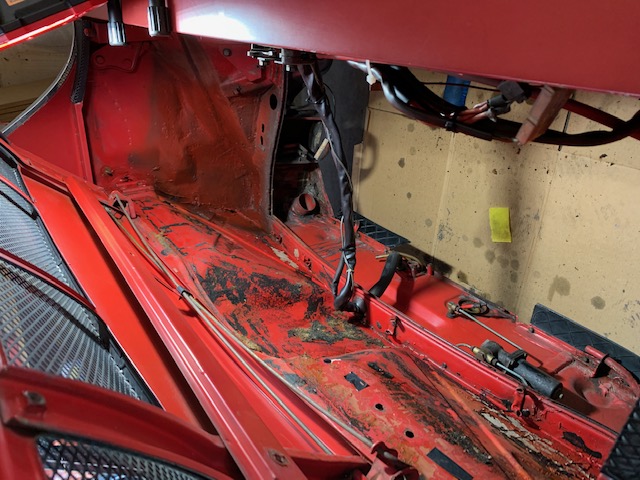

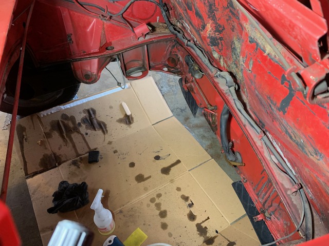

QUOTE(ndfrigi @ Apr 9 2020, 09:36 PM) *

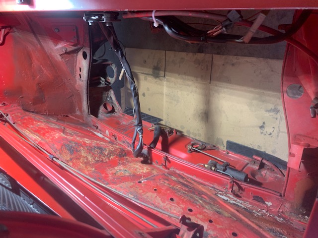

Finally after many months of not doing anything with it. Today raining but able to pull out the boxster and wife verano out of the garage and did several to the project.
1. Opened the box from 914rubber to check the visor. Beautiful piece!
2. Pull the 914 from the corner using the 4 wheel dollies.
3. Try fitting the triad that I bought from a member
4. Removed old clutch cable, trottle cable and speedo cable
5. Removed the 3 pieces engine bay/tin seal
6. Test fit the dual carb velocity stock
More cleaning done today and waiting in the mail my Googoo cleaner if I can remove those firewall adhesive or tar.

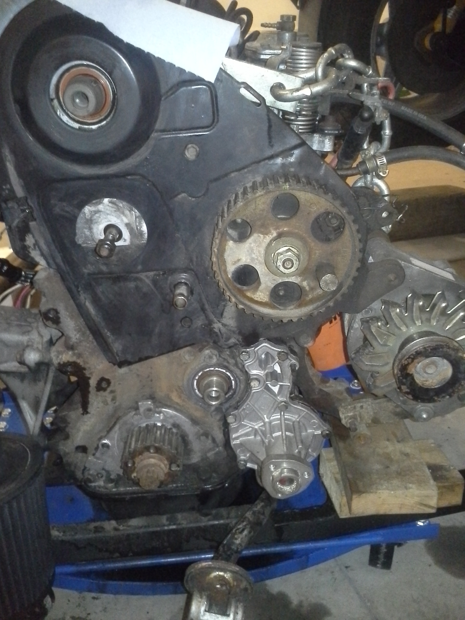

Changed a water pump and came to a halt, parts store got me the wrong timing belt /tensioner pulley..... (IMG:style_emoticons/default/confused24.gif)
Engine came with two different tensioners and belts depending on year. NOT interchangeable.

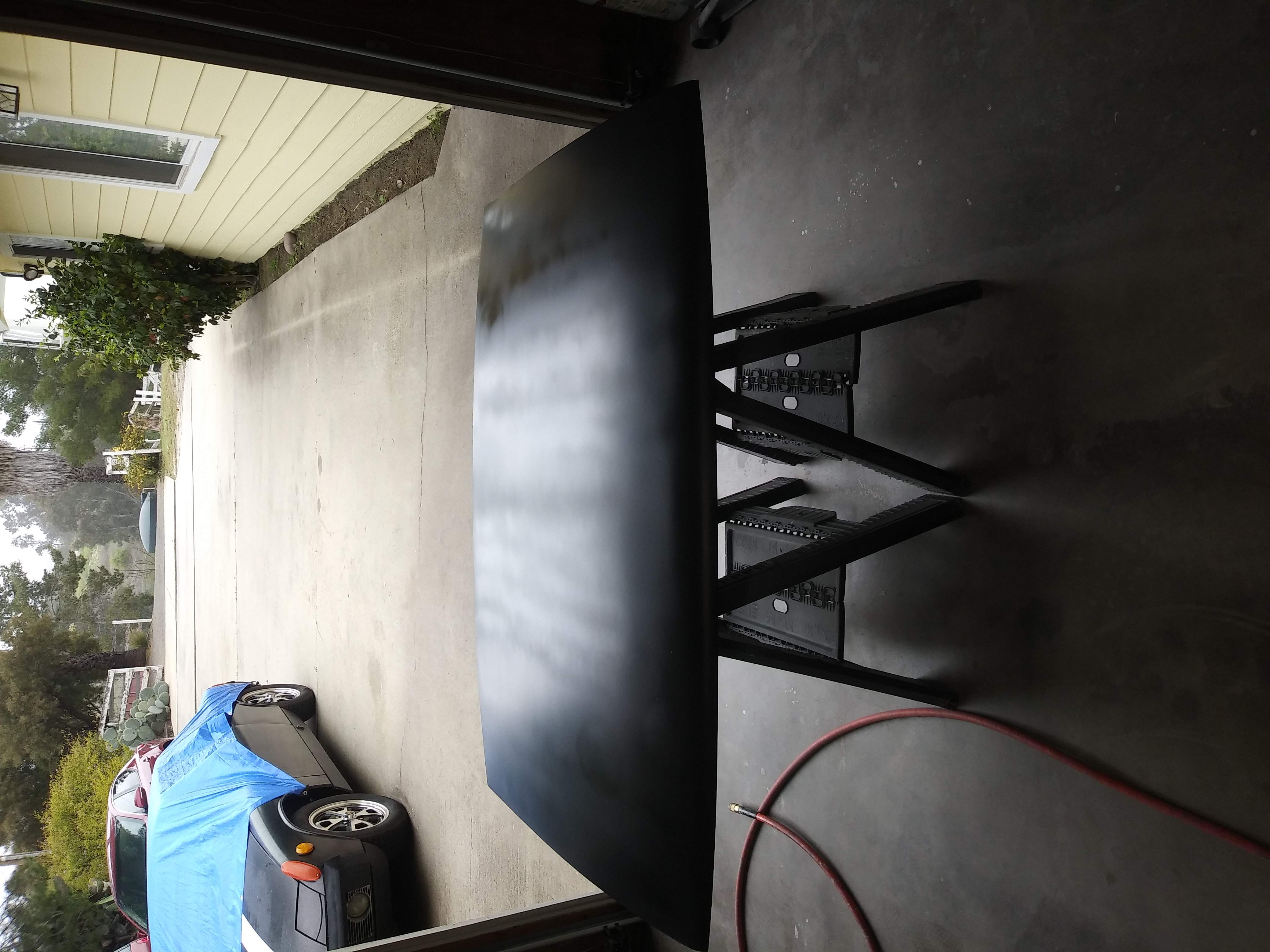

put the first coat(s) of catalyzed primer on to the new deck lid for the '74. Using PPG Shopline, in black for this one. Used white on the '75.
It's only up to 80grit right now, this coming weekend, I'm going to cut it back with 150g, do the final touch up with some polyester and then prime it again.
Gonna jam the underside as well, if I have time. The black paint is just itche'n to be sprayed somewhere. (IMG:style_emoticons/default/smile.gif)

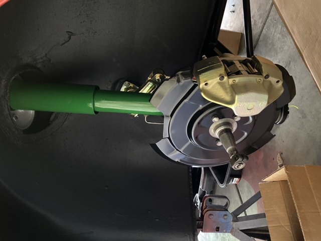

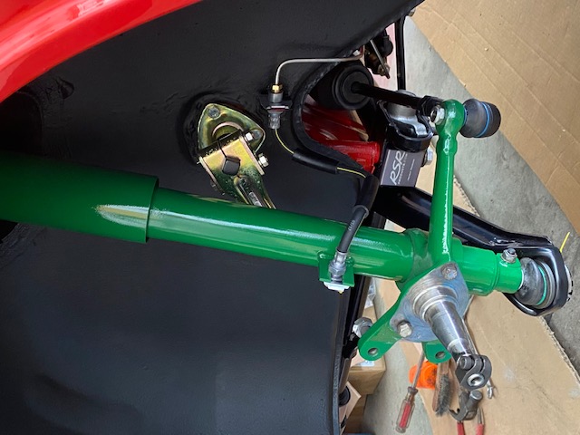

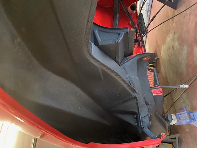

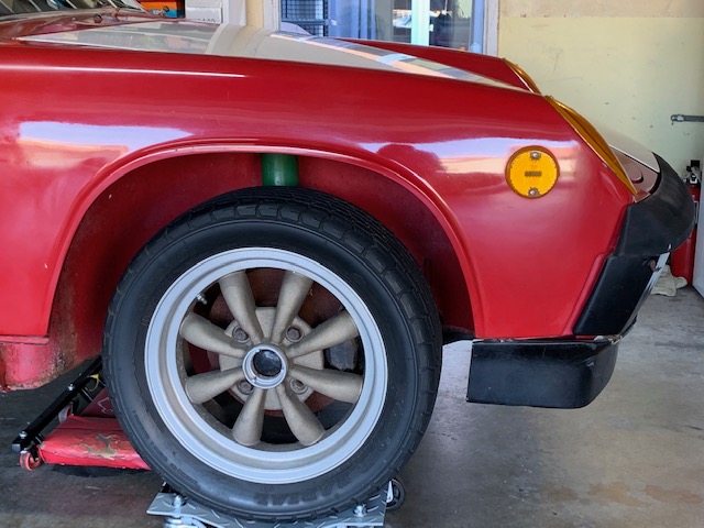

Finally getting some time to work in the garage.
Got the windshield installed, undercoated the car and installed the front suspension.
The engine long block is arriving later today. Hoping to get the car done before the lock down is over.
Attached ImageAttached Image Attached Image Attached ImageAttached Image

QUOTE(yellowporky @ Apr 14 2020, 02:48 PM) *
@yellowporky That looks really good. Well done there.
That is beautiful! Do you mind following your style? But for sure not that beautiful, probably if yours is 10 in scale of 1 to 10 rating, mine maybe around 1 and 2 only. hehehe

QUOTE(ndfrigi @ Apr 14 2020, 04:29 PM) *
Looks like you need to reset the angle of the drop links so that they are nearly vertical rather than horizontal on the rear anti-sway bar.

QUOTE(914Toy @ Apr 14 2020, 06:37 PM) *
Thank you Keith! Those are already installed when I bought this project but I might remove them since I will be using the car for street driving/cruising. And maybe the orientation now looks like that because there is no engine weight now.

QUOTE(ndfrigi @ Apr 14 2020, 08:14 PM) *
Aftermarket swaybar, doesn't mount to the arms at the shock but on the other side of the axles. Find the Addco install manual.
