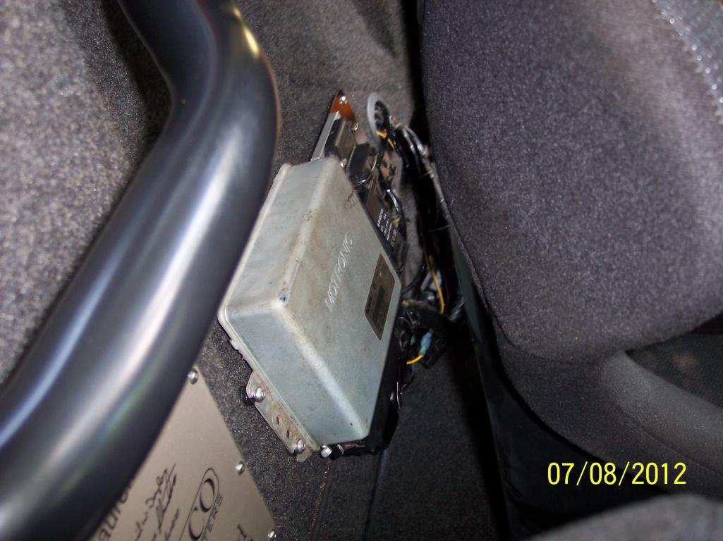

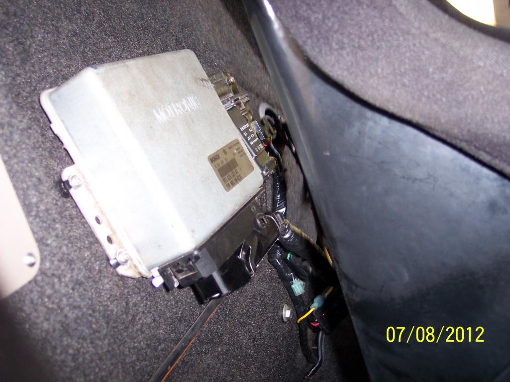

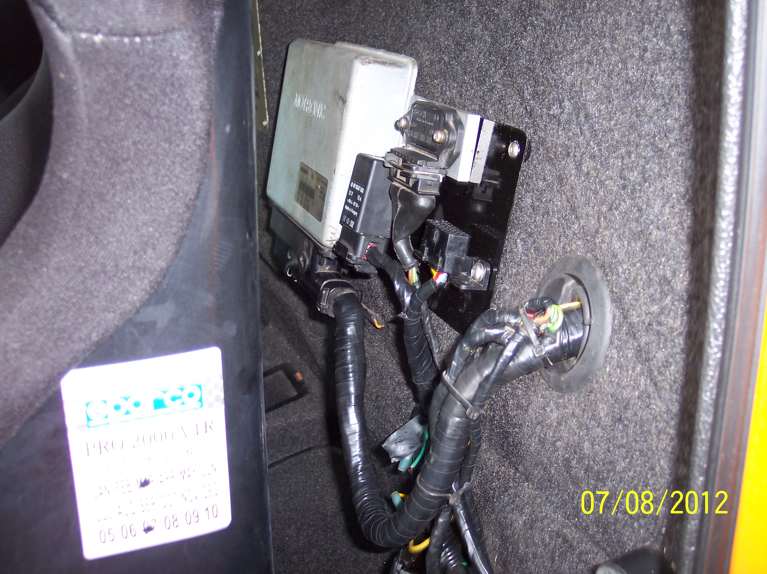

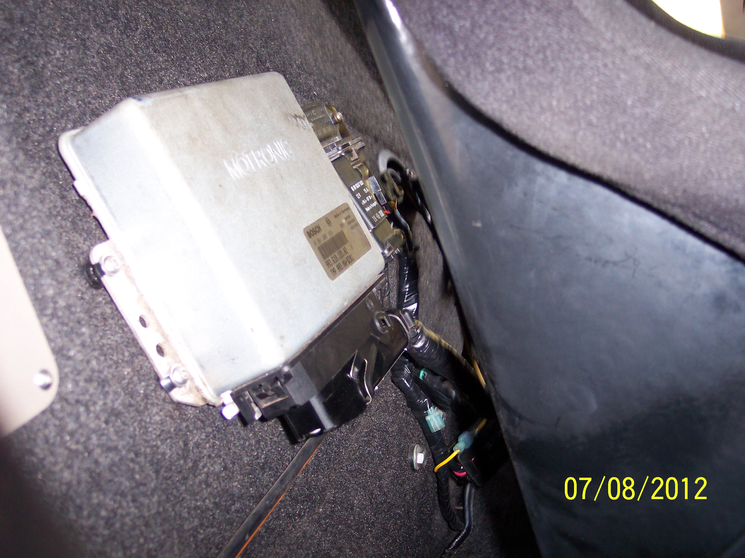

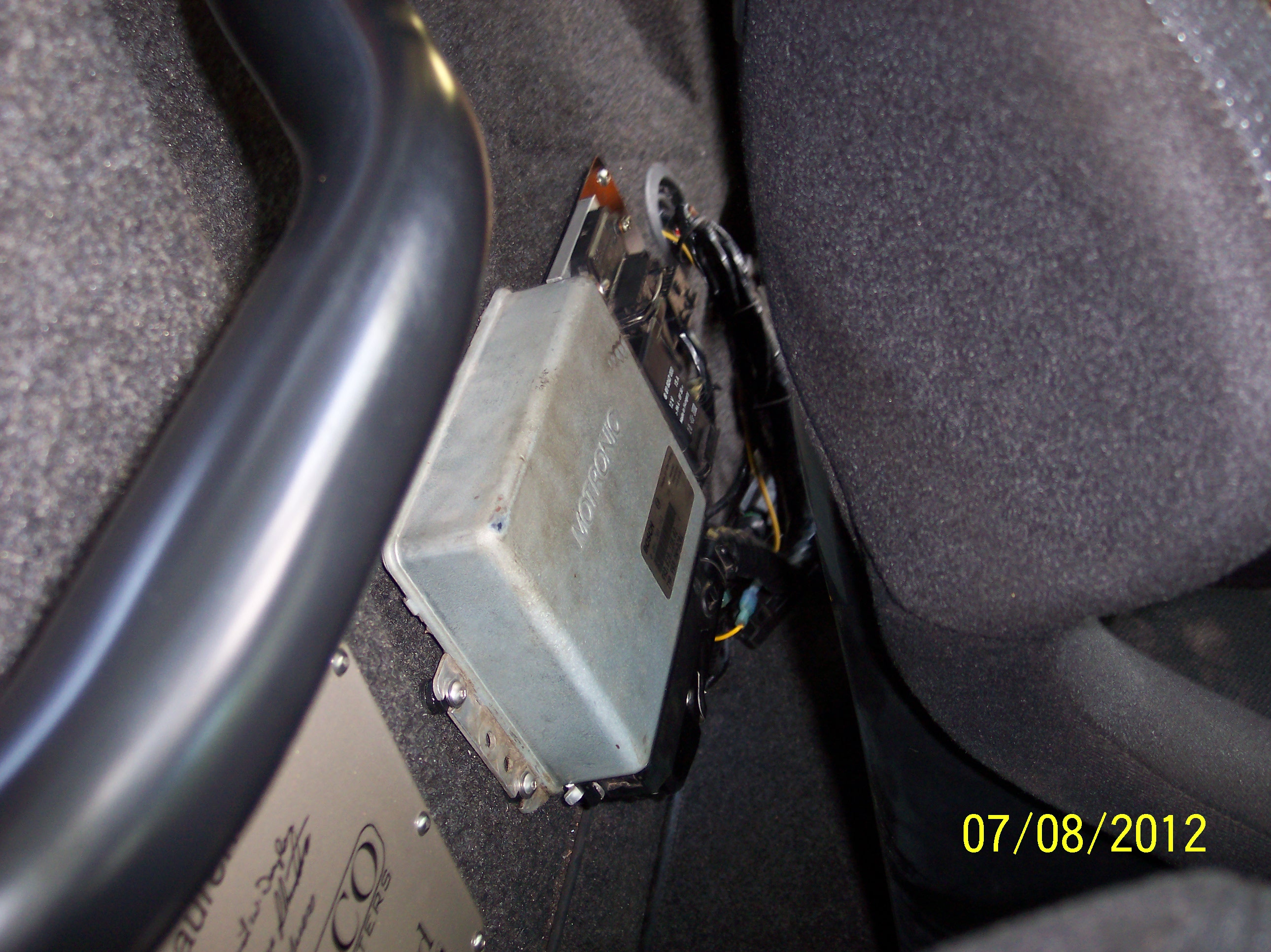

I relocated my ECU, Ignitor, Fuel Pump Relay, and OBDII connection from the engine compartment to the firewall behind my drivers seat..
It was a dumb idea on my part to mount the electronics in the engine compartment in the first place. The recent heat wave has convinced me to relocate them for better longetivity..

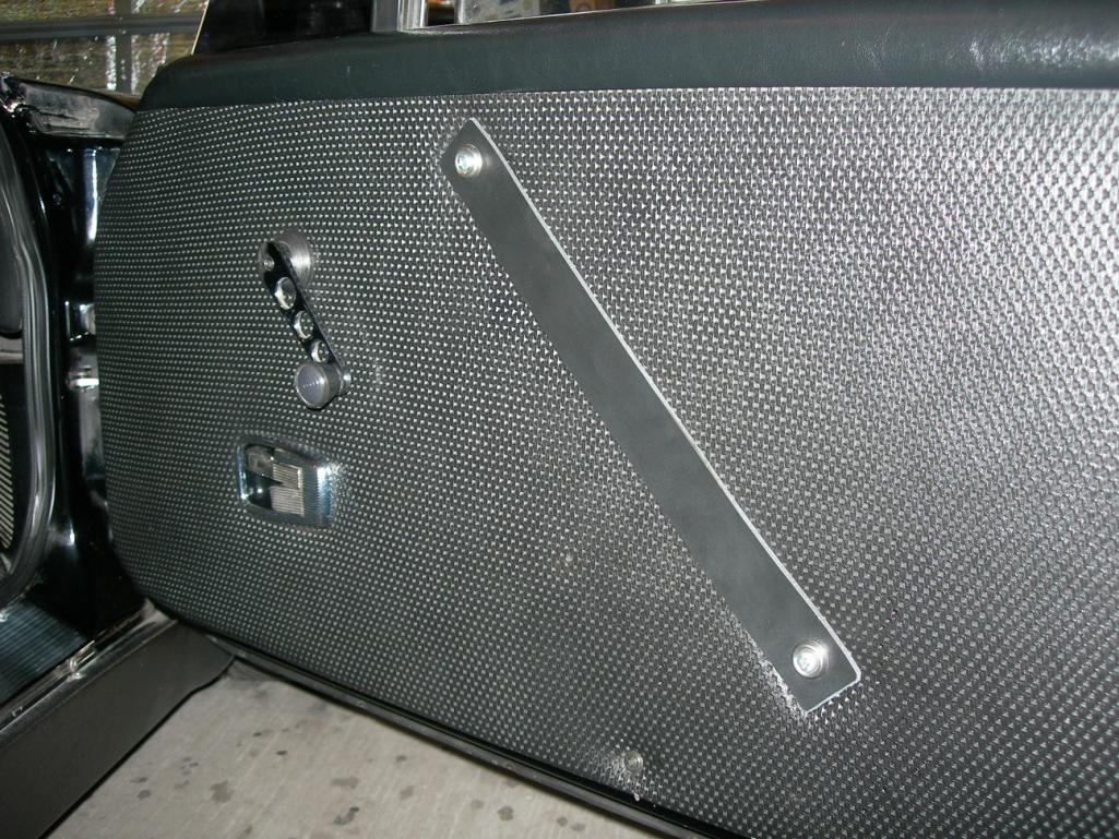

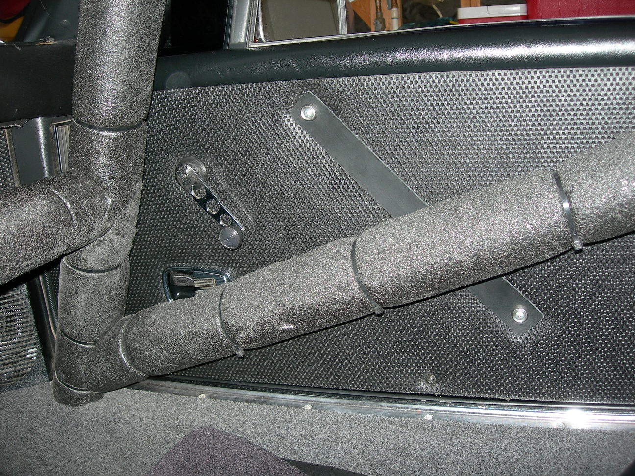

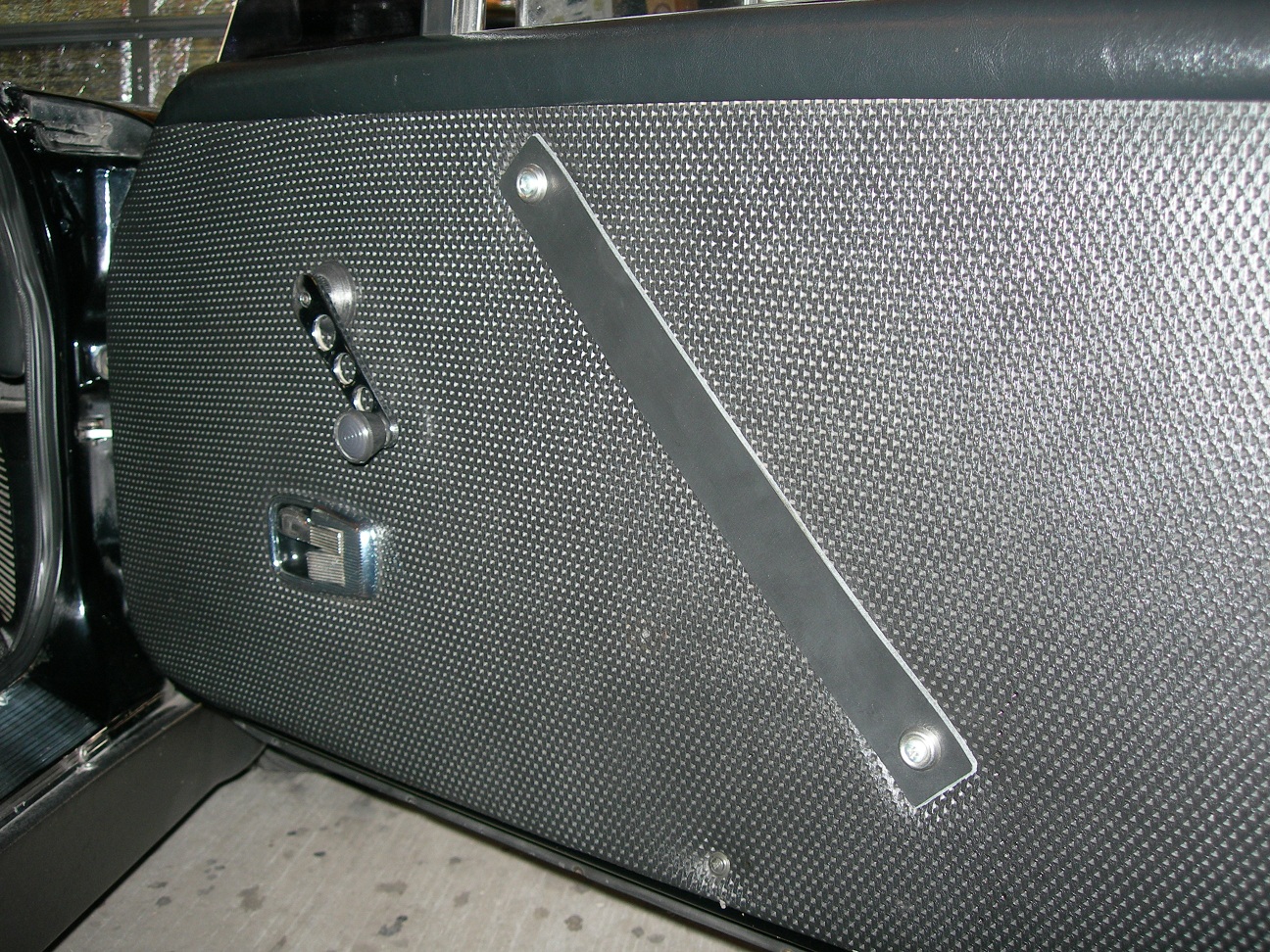

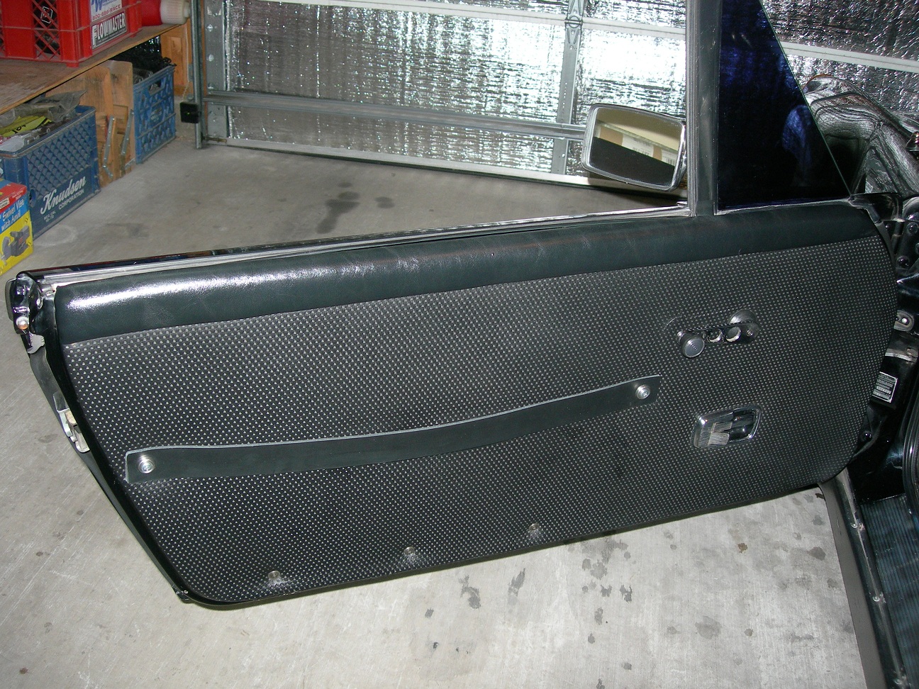

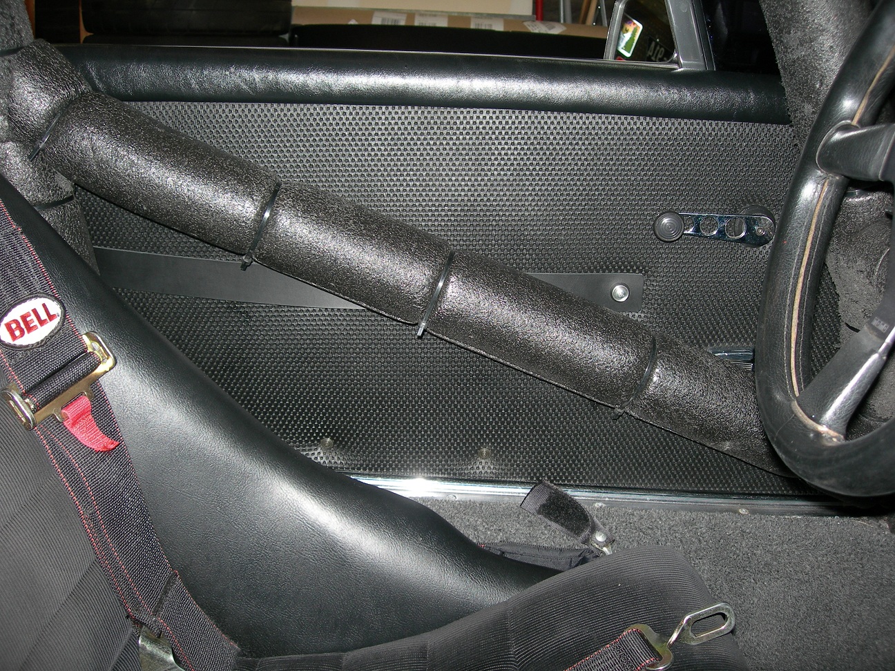

Made a pair of leather door pulls. (IMG:style_emoticons/default/smash.gif)

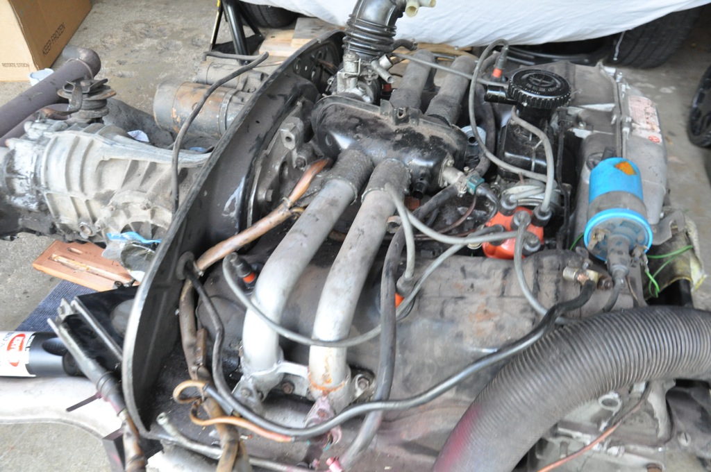

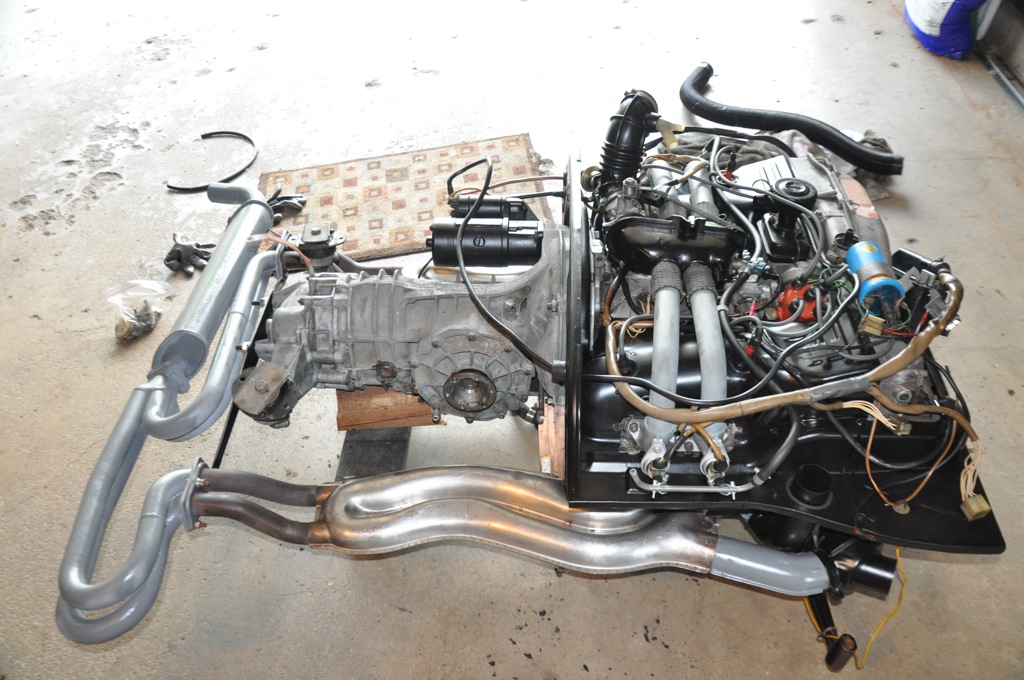

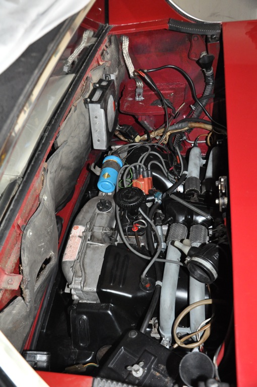

Took my 75 914 1.8 for a 30 mile drive today south of Minneapolis. It is the first time in 2 months I have had it out since May while I did the following;
Removed the engine, degreased, located and installed new uncut engine tin on the passenger side where the dealer installed tin was hacked up for the AC (and previously removed).
New engine bay seals-should be much cleaner in the engine bay now, with cool air coming from the top as designed versus the bottom of the engine!
New FI gaskets, intake gaskets, muffler gaskets installed.
New transmission ground strap, new plugs, air filter.
More degreasing and painting of engine tin ***tip Krylon sells a semi-gloss black grill paint that looks like factory paint and looks awesome from Ace Hardware.
Repainted the muffler in factory grey
Repainted the intake headers factory grey
Replaced 1st gear and synchros
Oil change to 40W oil, transmission oil change to 75-90W
Degreased and painted all of the heater elbows factory grey.
Degreased cleaned and painted the flapper boxes.
Reupholstered the seats in factory bone white material (PO painted the interior black, originally white!).
Removed black vinyl paint in the interior.
Sent clock to be repaired at Palo Alto speedo-awesome job.
New clutch cable and adjustment.
It was almost 90 degrees today, and the temp gauge only got to "M" in "Temp" which means the cooling tin is doing its work now!
*** It is now for sale-PM if you're interested in purchasing-I am selling to spend more time with my kids, 2 1/2 year old daughter, and 2 month old baby boy.***
Ran awesome, it was a great time. Now just need to replace the O ring on the side shift transmission that is leaking. Attached ImageAttached ImageAttached Image

Wow! What a punch list! Congratulations! Need pictures of your painted engine.

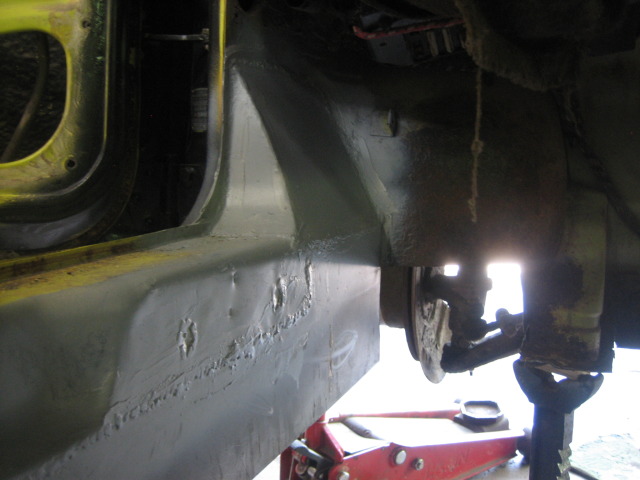

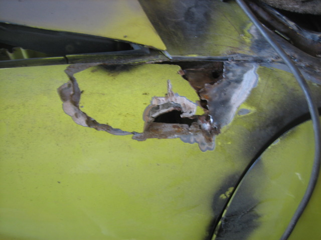

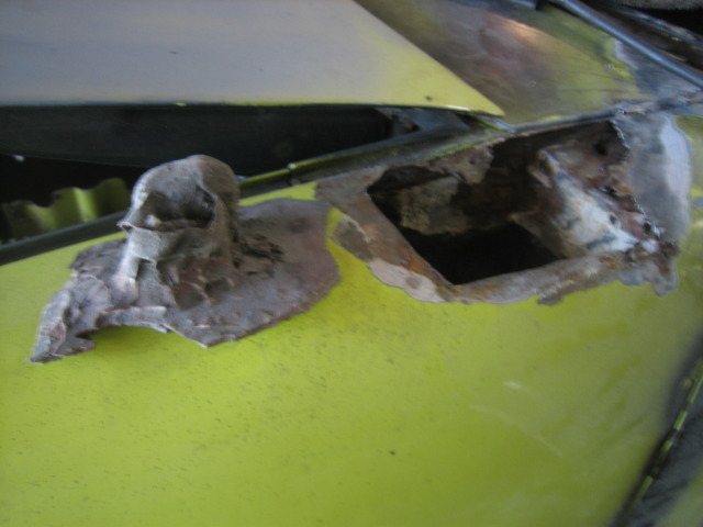

welded in some strenth and started welding in the outer long. Also picked a nice chunk of bondo out of the fender

Looks like someone didn't like the antenna in the drivers front fender.
I Welded mine shut. (IMG:style_emoticons/default/welder.gif) Then "skim" coated it. But the term "skim" is relative I guess. (IMG:style_emoticons/default/biggrin.gif)
Keep up the good work!

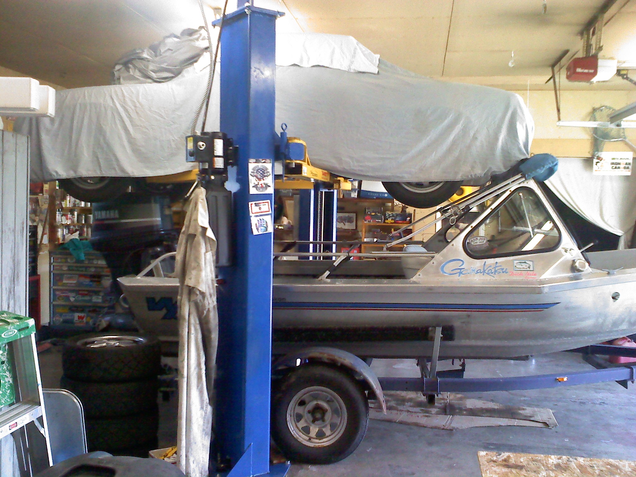

tryed to put it in my boat

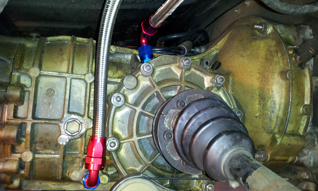

I've updated the Paddock thread that followed my transaxle cooling system.
This link will take you to page 3, which I just updated with some photos. If you want to follow the system design discussion go to page one and start there.
