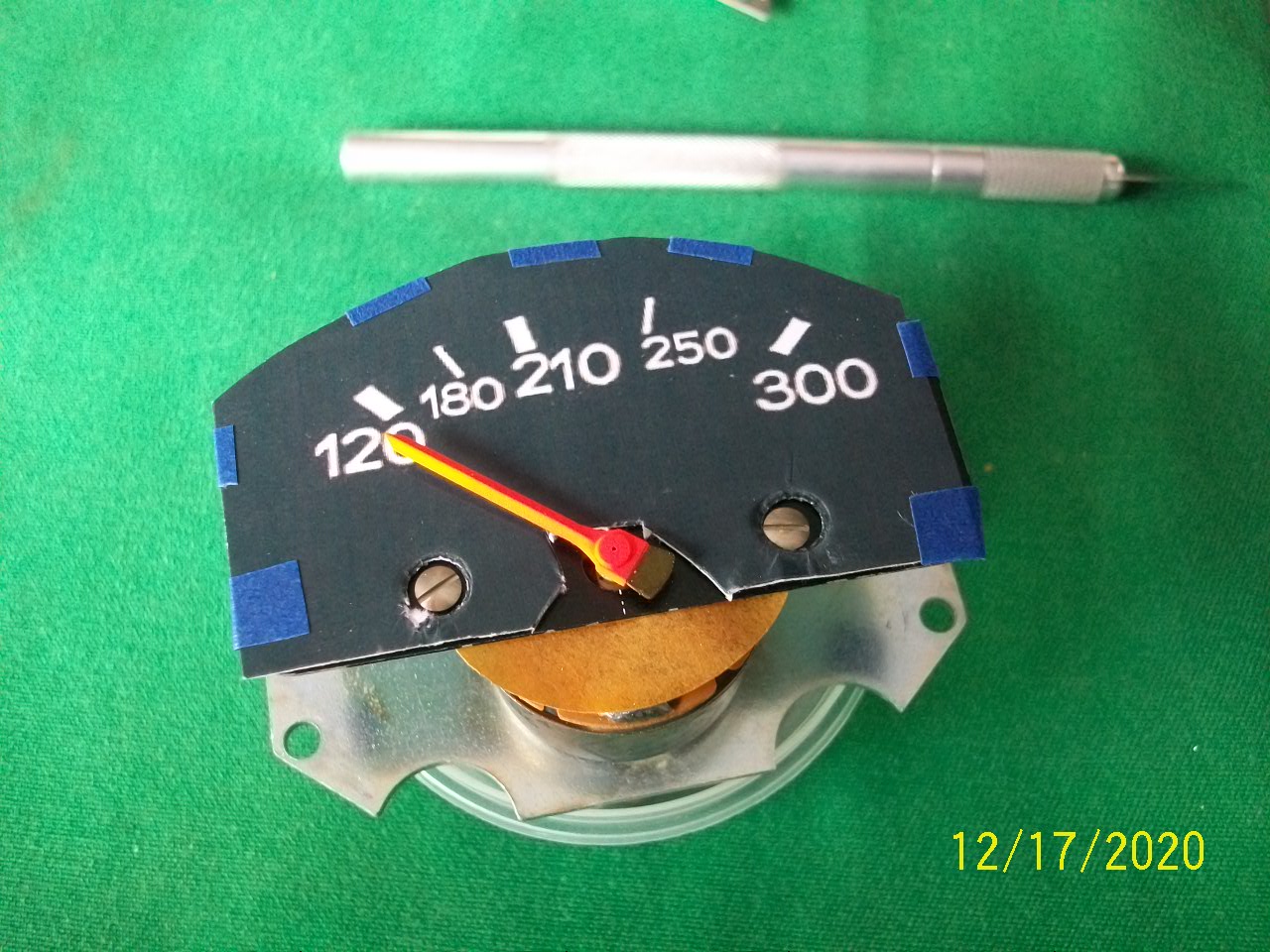

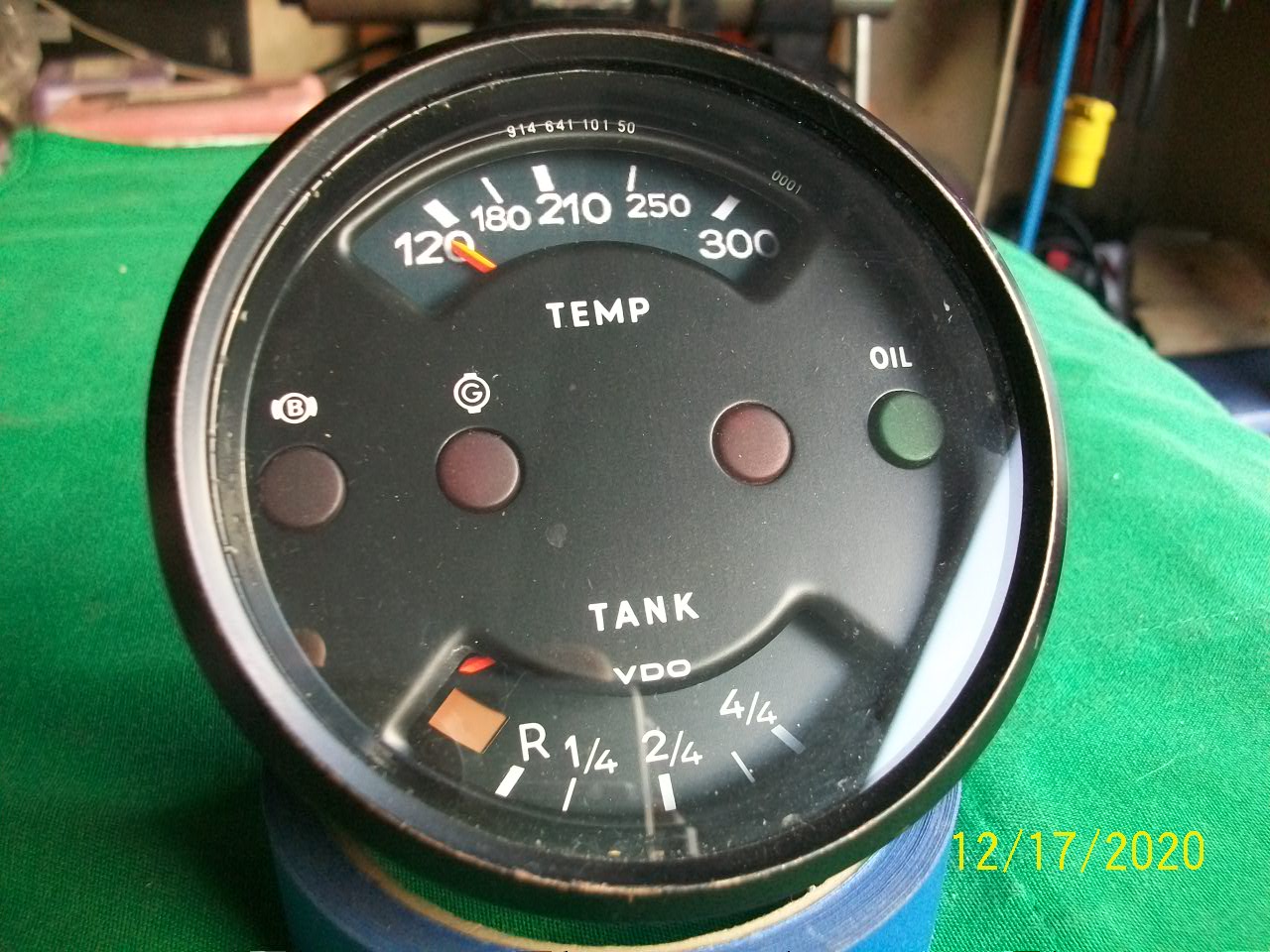

gauge numerals refreshed. I have one of those Manley dipstick temperature dipsticks as a point of reference, so I know my gauge needle in the cluster roughly matches that of the temperature on the dipstick.

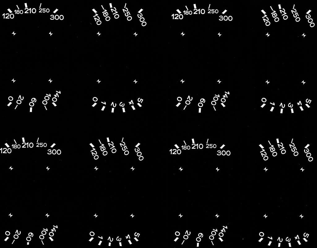

thanks 914forme for the graphic

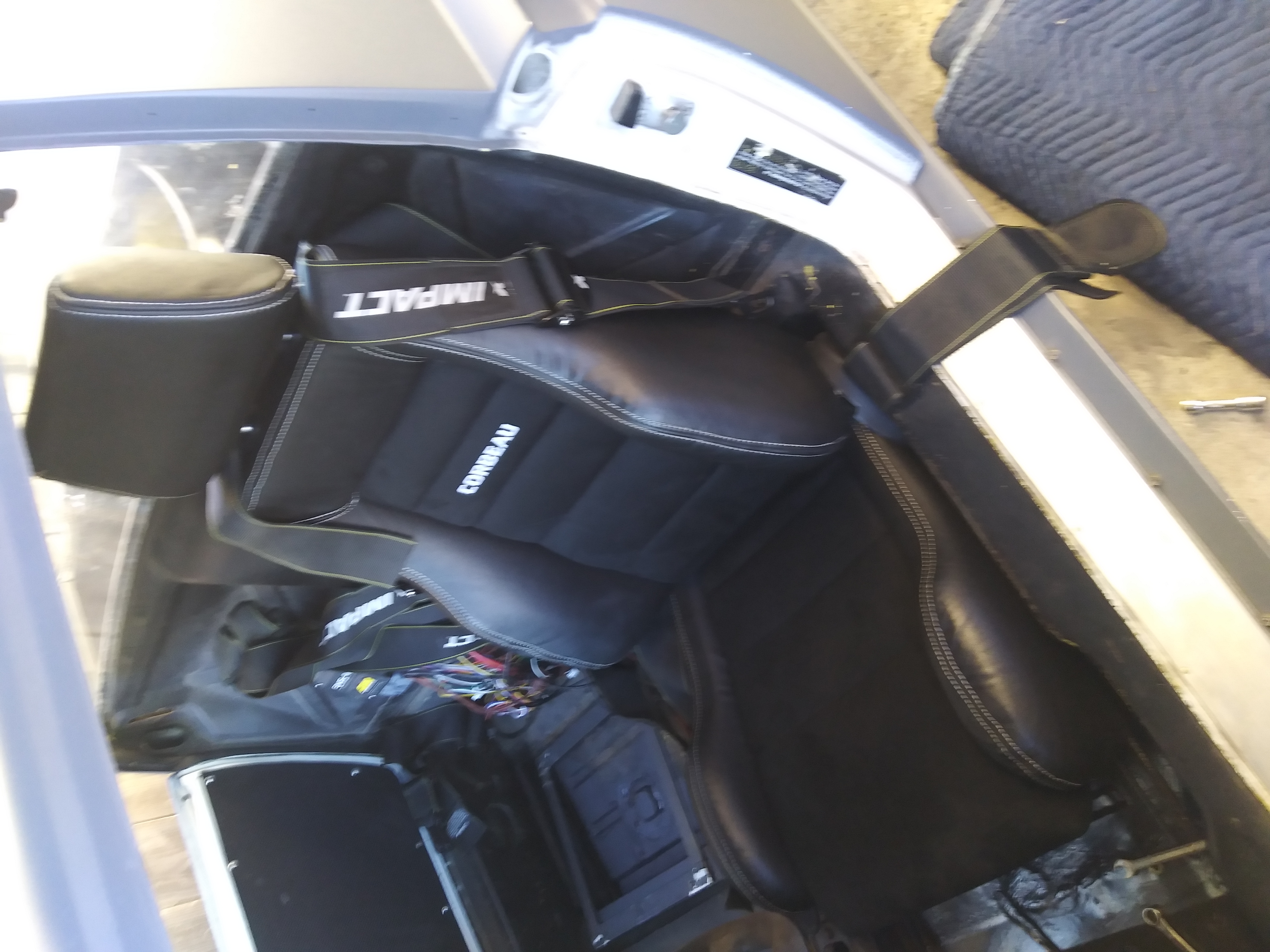

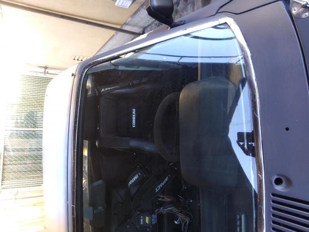

Mounted one of my new seats today. Attached Image

Where did you get the number printout for the temp gauge?
Is it a file I can download somewhere and print out?
Is it a laser printer copy will do or anything special to make it look nice.

I was just asking this same question and @dangrouche was kind enough to chime in. hope this helps. He suggests printing it on semi-gloss photo paper (vs. gloss) - black for white. You may also consider going to http://www.whitegauges.net - they can custom print.
you can also go here - I had this one (21a) made for me but I have yet to confirm the scale is accurate.

I take no credit for the graphic. WE can thank another member for making the graphic available. My temp scale was printed on 10-year old glossy finish photo paper on an old inkjet printer. If you have semi-gloss photo paper, that might eliminate any potential glare (my gauge is modded with LEDs) Make sure you reverse the image so its printing in reverse (white lettering on a black background). Took me a Google search to figure out how to print a photograph in reverse. You need to print an entire 8.5x11 page to get the one needed graphic. The attached graphic has already been modified for you to print without any further effort. The little "hourglasses" on the photo is where I used a leather punch to perforate and expose where the brass screws are situated at the base of the temp module. the holes aided as a reference to align and tape down the graphic.

@cali914 which model Corbeau seat is that, and did you use the corbeau mounting conversion plate and use the stock 914 sliders?
looks like it fits nicely! should provide excellent support for sporty agressive driving!
