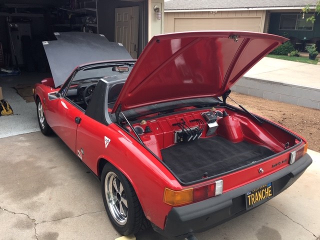

No big deal today. I took off the bumpers, lights lids, hood, hood pin plates and pins, trunk lid, deck lid, rubber seals all around, windshield and trim pieces, and everything that would get in the way of a paint job. Time to tune up the four year old garage respray.
In AZ, a two stage paint job with body prep, prime, three coats and a clear coat prior to flat sand and buff can run up a big number.... it gets into the low four digits!!!! The EPA has not yet figured out how to get that number adjbusted to the high four digits as in CA.... this is not a political observation. It is an unvarnished fact. Same products. Same application. Same labor hours. Different state,.... of mind.
Who knows? It may look better than the pics of my garage job from Laguna herein and it will drive even better with so much less air drag...... (IMG:style_emoticons/default/aktion035.gif)

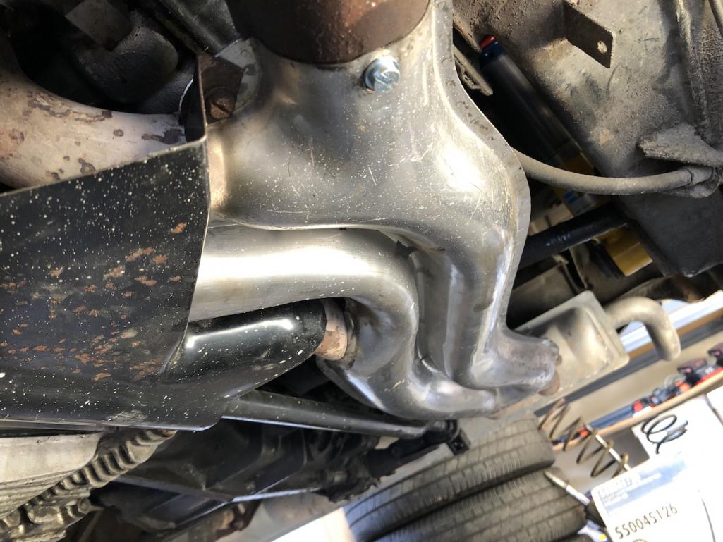

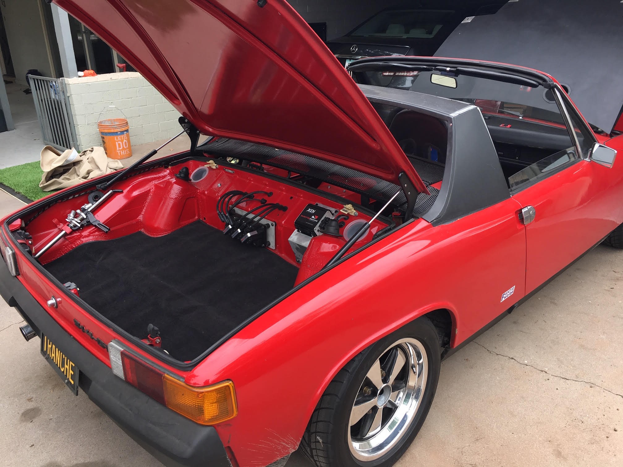

Inspired by Ian Karr and his video. thanks @Iankarr one down and 3 to g0!Attached Image

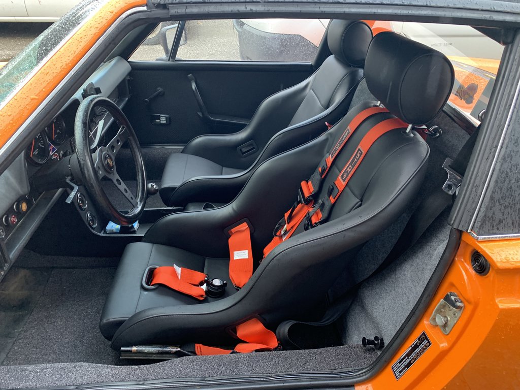

Finished installing new seats using factory subframes, and harness for driver ready for hillclimb events this year...
(IMG:http://www.914world.com/bbs2/uploads_offsite/i.postimg.cc-22846-1613490943.1.jpg)
Do your seats move fore and aft easily, like factory?
Or are they tough to slide?
Great looking seats!

They move just the same as stock as they use the factory seat rails/subframes.

Are your belt mount eye bolts above your shoulders? I was in a crash with a 4 point and because of the design of the roll cage, the belt mounted below my shoulders. When my vehicle came to a stop, but I didn't, the belts forced my shoulders down and tore my rotators.
They're about level - FIA and Motorsport UK regs say that the shoulder harness mountings must be no more than 10 degrees above or up to 45 degrees below the level of the seat. Ideally in the zero to 20 degrees below range.

In that picture the seat design keeps the belt from dropping down. I did not have that. Looks great.

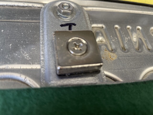

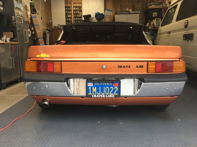

Made a license plate bracket that does not require holes in the bumpers.
Bought four 3/4 x 3/4 x 1/4 inch rare earth magnets from Apex Magnets.
These are countersunk.
Drilled 4 small holes on the license plate frame, tapped the holes, then screwed the magnets in place.
Covered the center piece with felt, and cut four small pieces for the magnets.
Just place the license plate with the magnetic frame to a hole less bumper and it’s on.
Takes a good 30lb pull to remove it; and, Ivan now clean behind the license plates (IMG:style_emoticons/default/smile.gif)
Apex: https://www.apexmagnets.com/magnets/3-4-x-3...eodymium-magnet

Now you need a different set of plates you can switch in when doing something you shouldn't be doing.

I have another set-up with a commutative plate from the Medford WCR.
Easy switch; I also made up a Euro frame for the front.

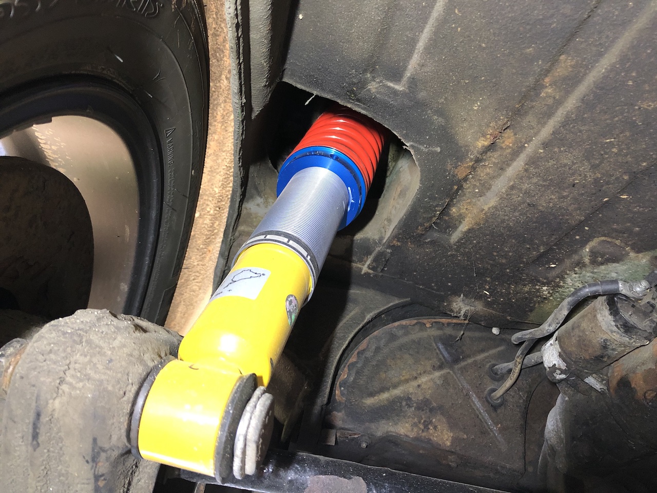

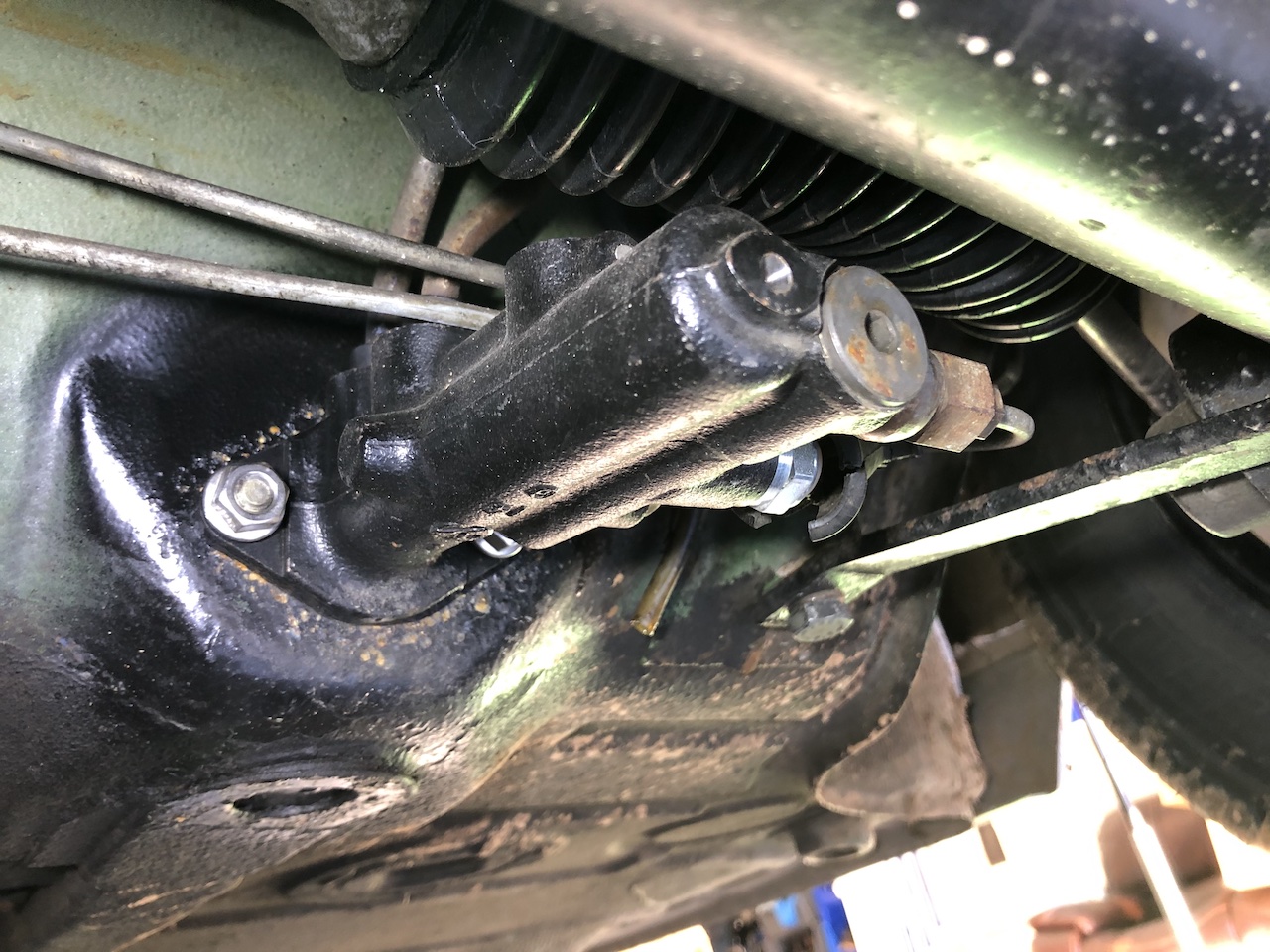

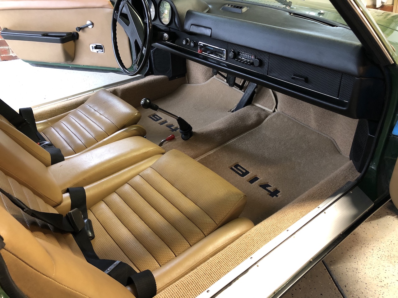

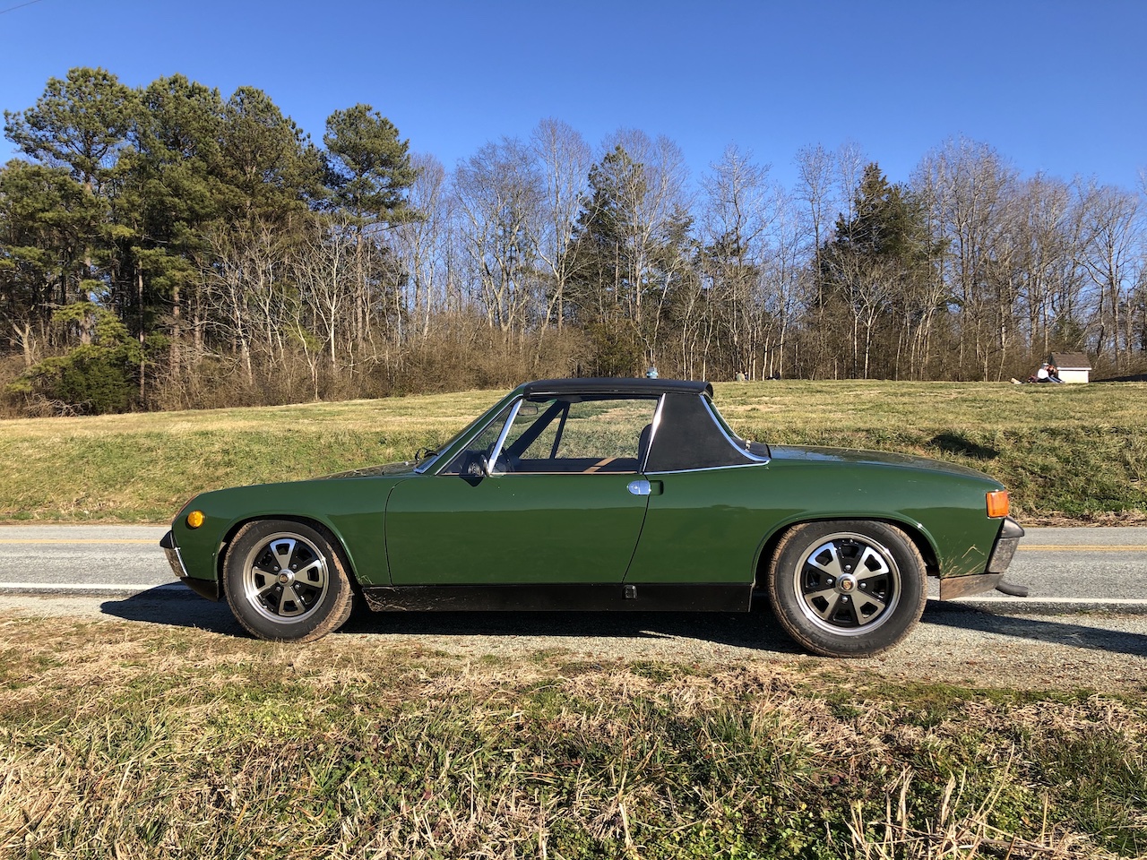

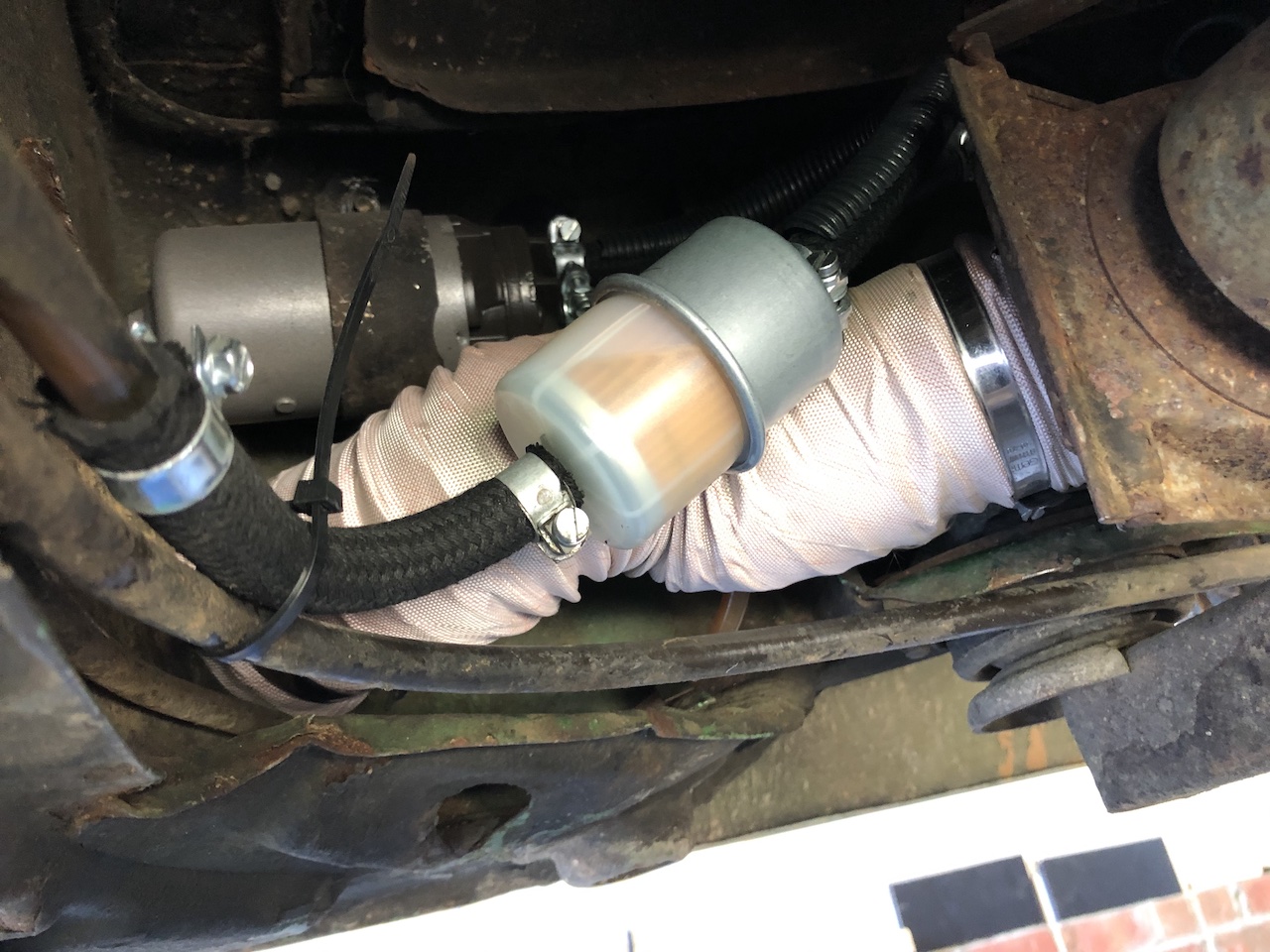

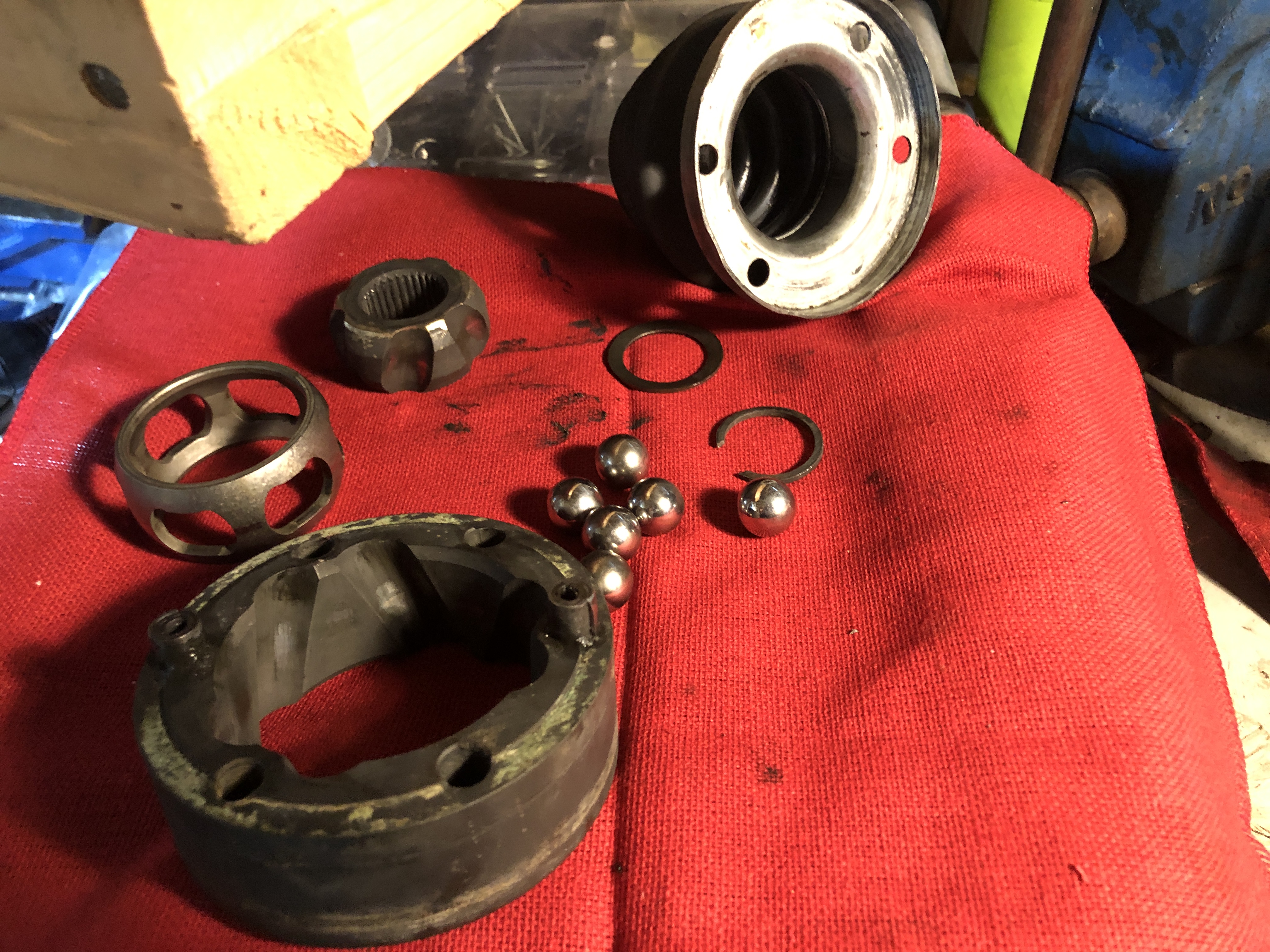

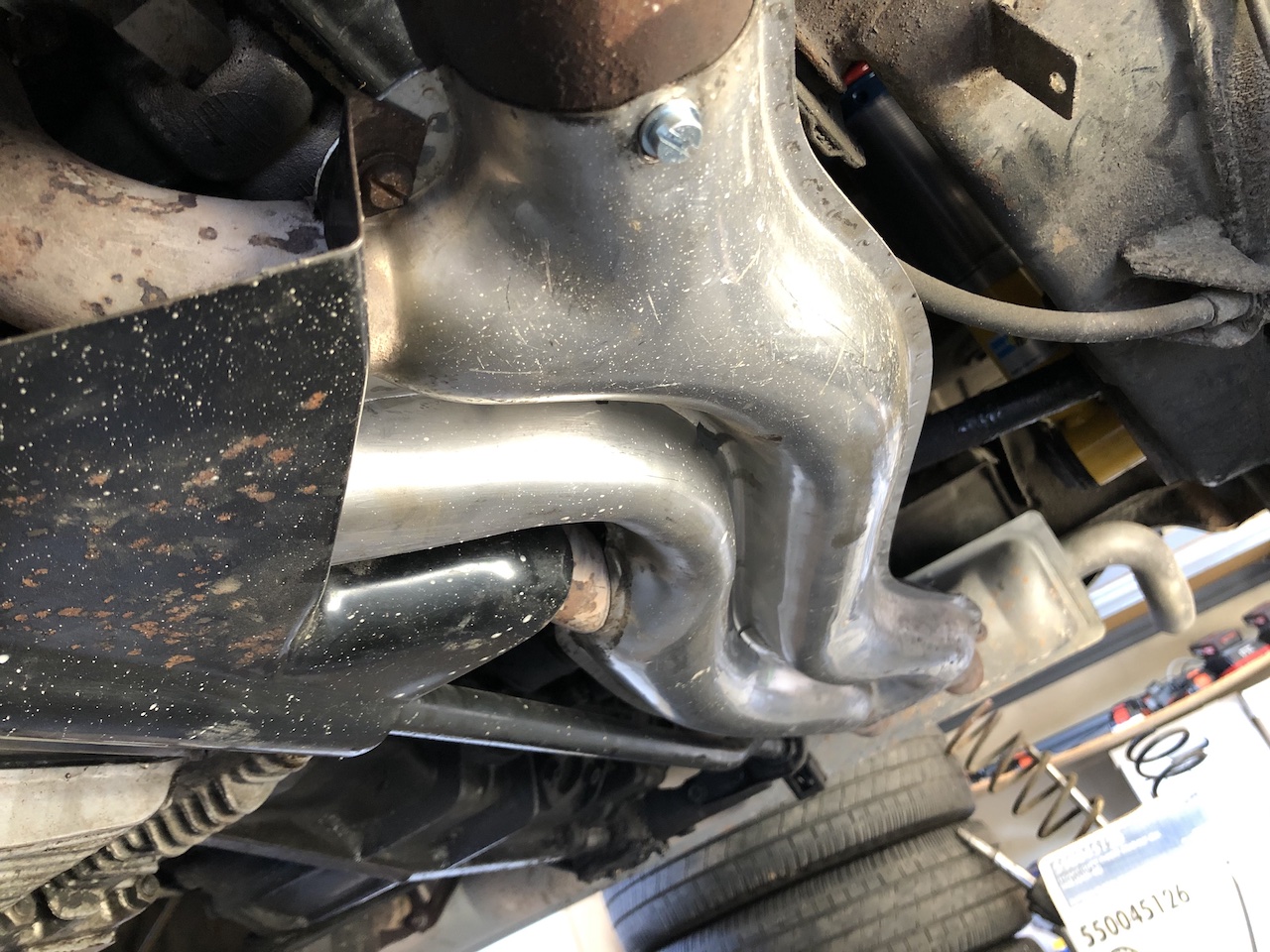

Over the past few months my mechanic Chuck Miller of Millersport in Hillsborough NC and I (he did most of the work!) have completed the following maintenance/upgrades to my 71 Irish Green/Biscuit 914:
suspension overhaul (bushings/bearings), Bilstein struts and Rebel Racing coil over kit with Eibach 100lb springs
Stainless heat exchangers
optima red top 25 battery
AA rebuilt fuel injector, fuel filter and heater hoses
PMB 19mm master cylinder and Rebel Racing Turbo Tie Rods,
Bruce Stone Rebuilt Pedal Cluster
Dansk muffler
ebay Rear valence with notch (I'm still looking for a period correct valence with a hole PM me if you have one for sale)
AA empi-fuchs wheels with 195/65R15 Michelin Premier AS
lloyd mats with 914 logo
AA german tan loop carpet kit
element fire extinguisher
Now I am waiting for the weather to cooperate so I can finally detail the car!
Needless to say I am significantly underwater based on it's value but . . .
it drives great!
And looks pretty good as is (need to repaint the rear valence. Jack point and rocker rust repair will have to wait a while)

Jim, those new chrome bumpers look great!! i like the deeper scoop rear valance in body color too. What did you do up front?
@jim_hoyland
