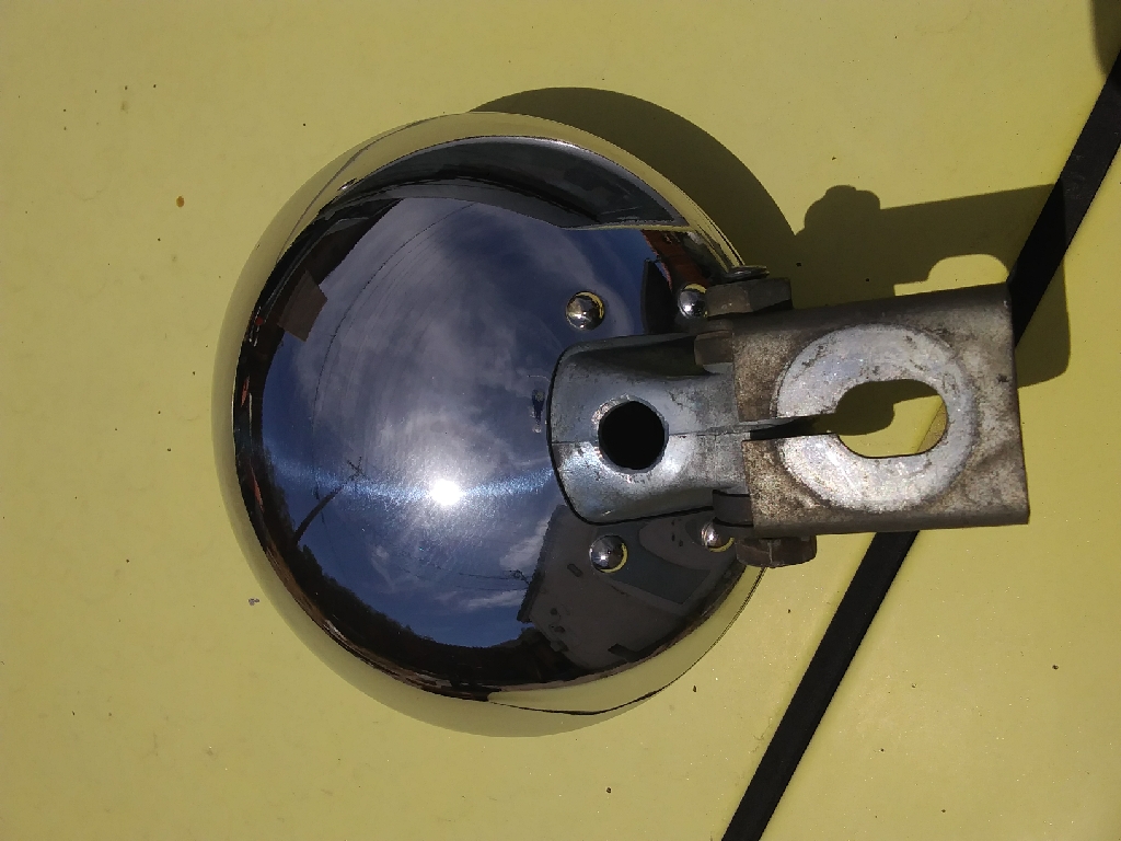

Pulled off the sand blasted driving lights, glass looks yellow from being pitted. Did one with the same wheel and compound I polished the plastic lenses with. Polished the glass too, only the larger pits stayed. Color is now coming from the reflector and not the sun. Had to do the other then. What else can I find to polish. ☺

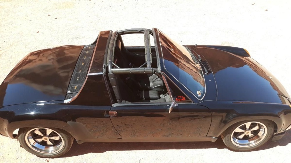

I brought the only 914 out of 50+ cars. (IMG:style_emoticons/default/first.gif)
But I was not the only Targa.

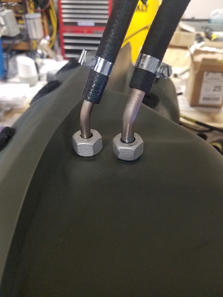

Bench tested fuel tank hose connections for leaks. Pressurized tank to 5 psi. Leaky supply line side fixed with Hylomar Blue General gasket compound recommended by forum members. Tank goes in tomorrow. (IMG:style_emoticons/default/piratenanner.gif)

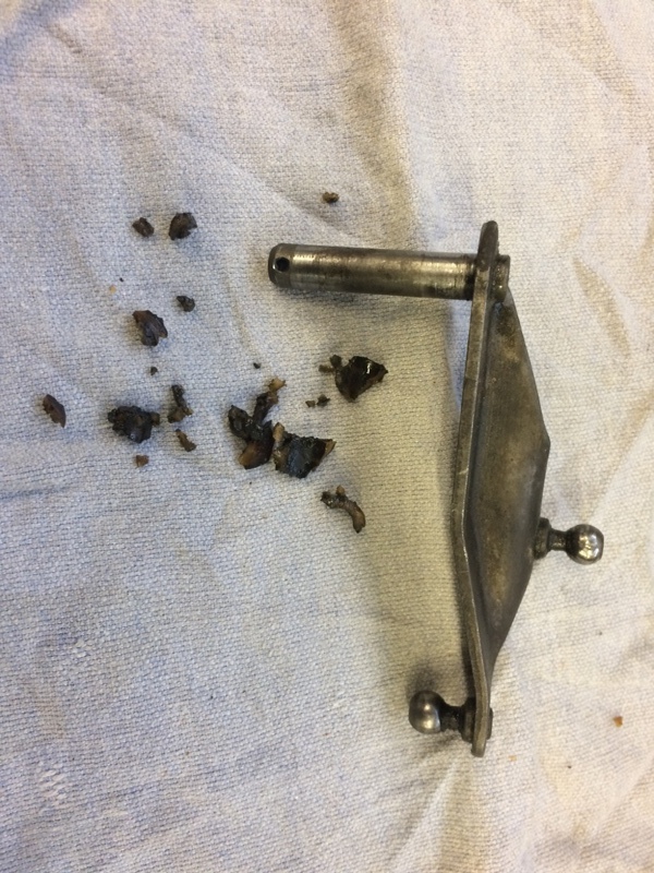

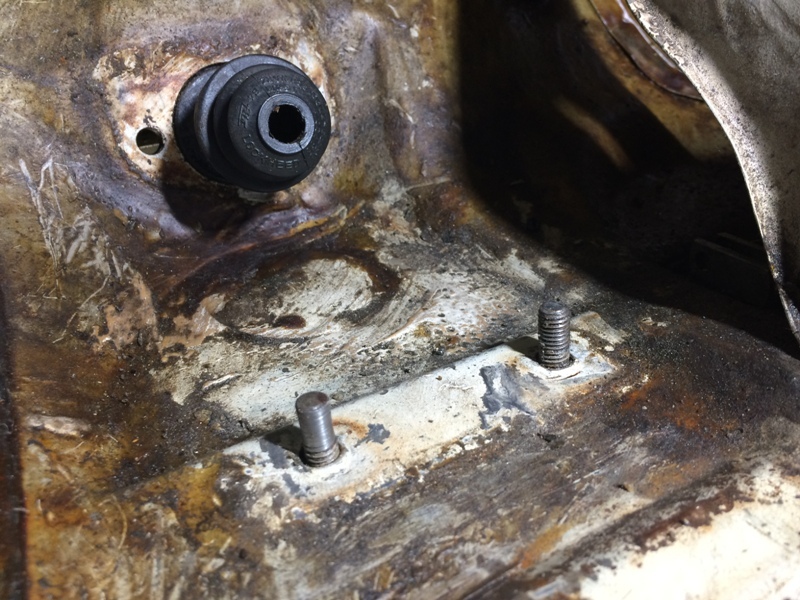

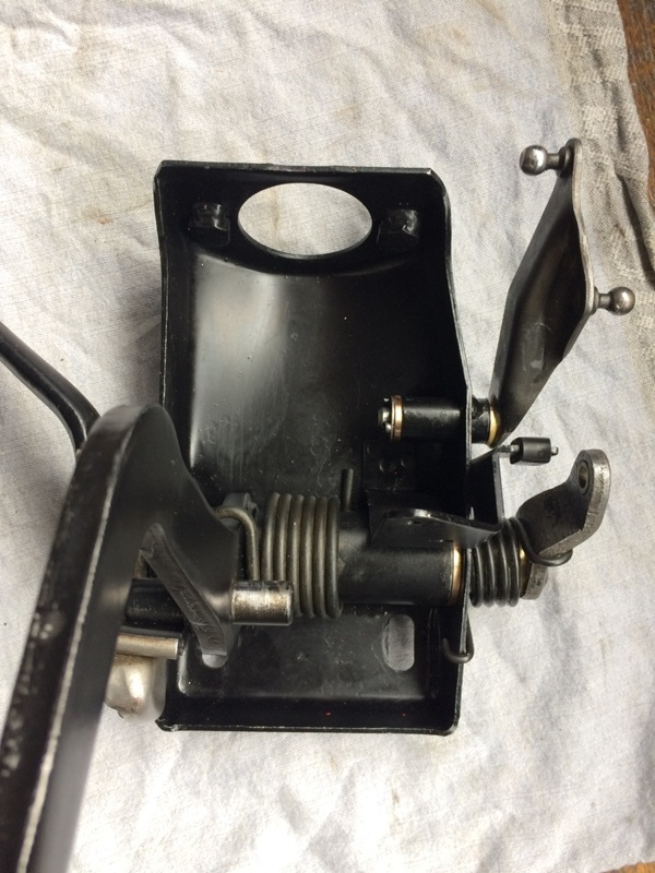

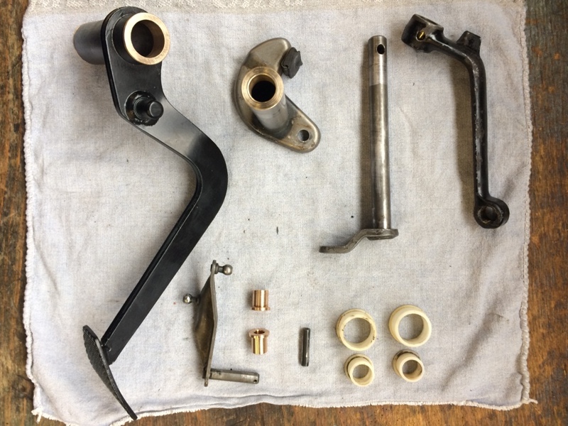

Took the pedal block out and replaced the worn plastic bushings with new ones made from bearing bronze. Machined them on the lathe for a perfect fit with minimum play.
Had to deal with a stripped thread on one of the fasteners that go through the floor pan. Drilled it out.

Will last far more than 50 years, great looking work

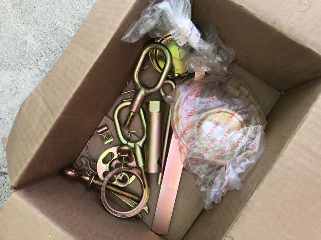

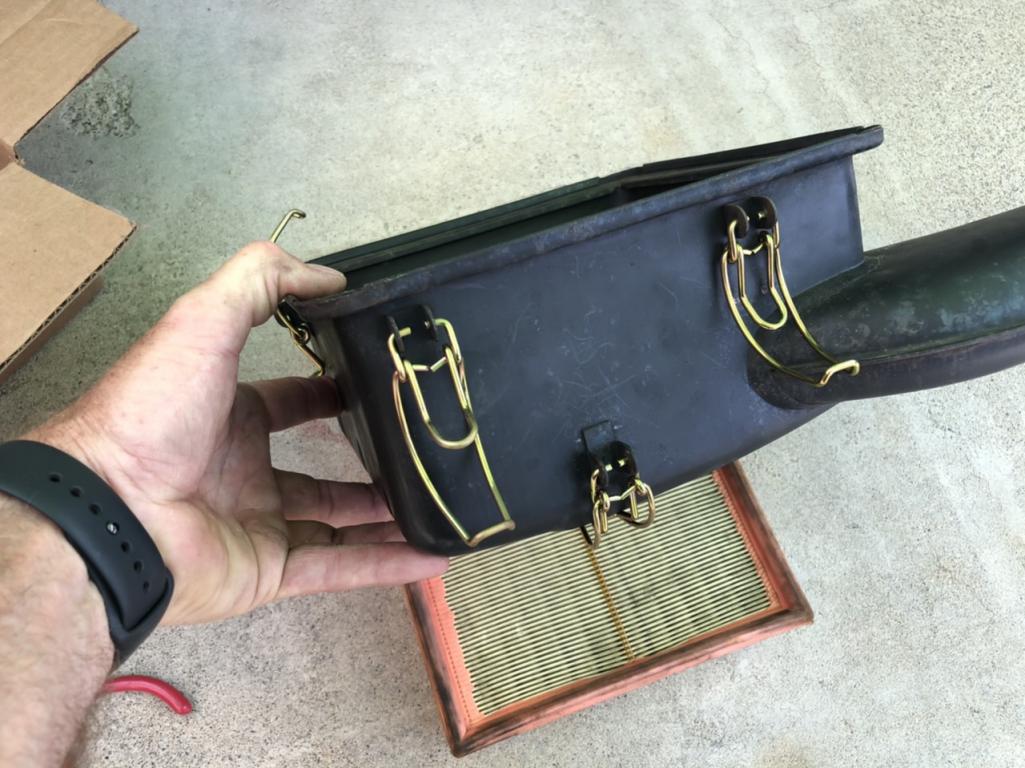

I pulled out the bailing wire clips for the 2.0 L FI airbox and sent them out for cad plating. Receive them back and proceeded to install the renewed clips.
