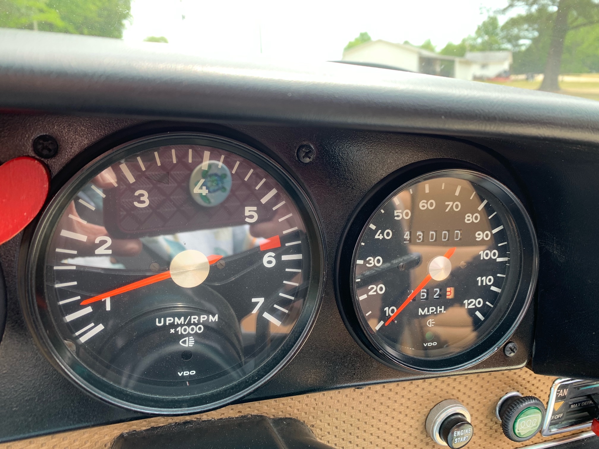

anderssj
post May 23 2021, 12:42 PM
Post #14421
Dog is my copilot...
Posts: 1,784
Joined: 28-January 03
From: VA
Member No.: 207

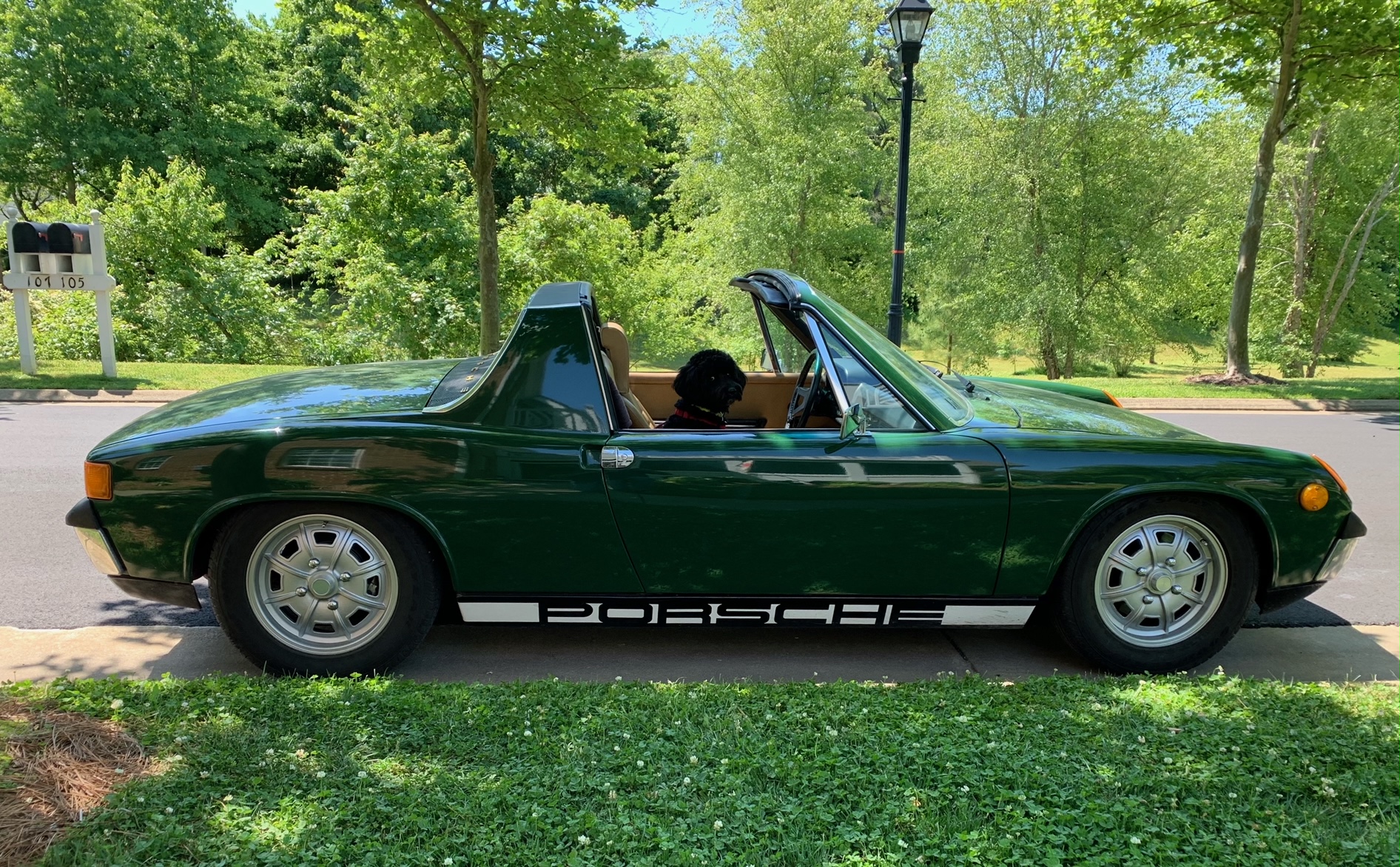

Celebrated 49 years of ownership with a doggie dawn patrol (he's really happier than he looks):
Drove about 70 miles on the local back roads before it got too hot. While we were out, the car rolled over 243,000 miles (IMG:style_emoticons/default/piratenanner.gif)
Never thought it would last this long or go this far! (IMG:style_emoticons/default/wub.gif)

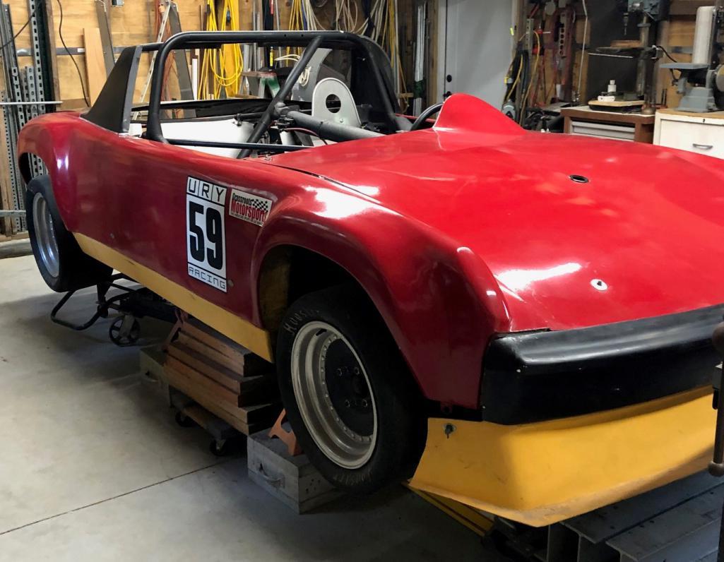

warpig
post May 23 2021, 02:11 PM
Post #14422
Posts: 290
Joined: 2-August 10
From: Portland OR
Member No.: 12,002
QUOTE(Jett @ May 23 2021, 07:55 AM) *
QUOTE(warpig @ May 22 2021, 05:46 PM) *
Parts have started arriving for building the engine in my red car. (IMG:style_emoticons/default/piratenanner.gif)
Took them over and put them on my rack at Middle Motors.
2270cc build to commence shortly. (IMG:style_emoticons/default/evilgrin.gif)
Who’s Delphi car on the hoist?
Not sure who's car that is. Cary and Ben are very busy of late. Seems like there is always a different car on the lift when I stop by.
Going to try and start putting the motor together next week.
Parts Porn to follow. (IMG:style_emoticons/default/w00t.gif)

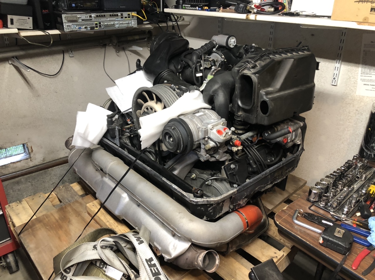

Bought a new project!! 1995 993 3.6 motor.

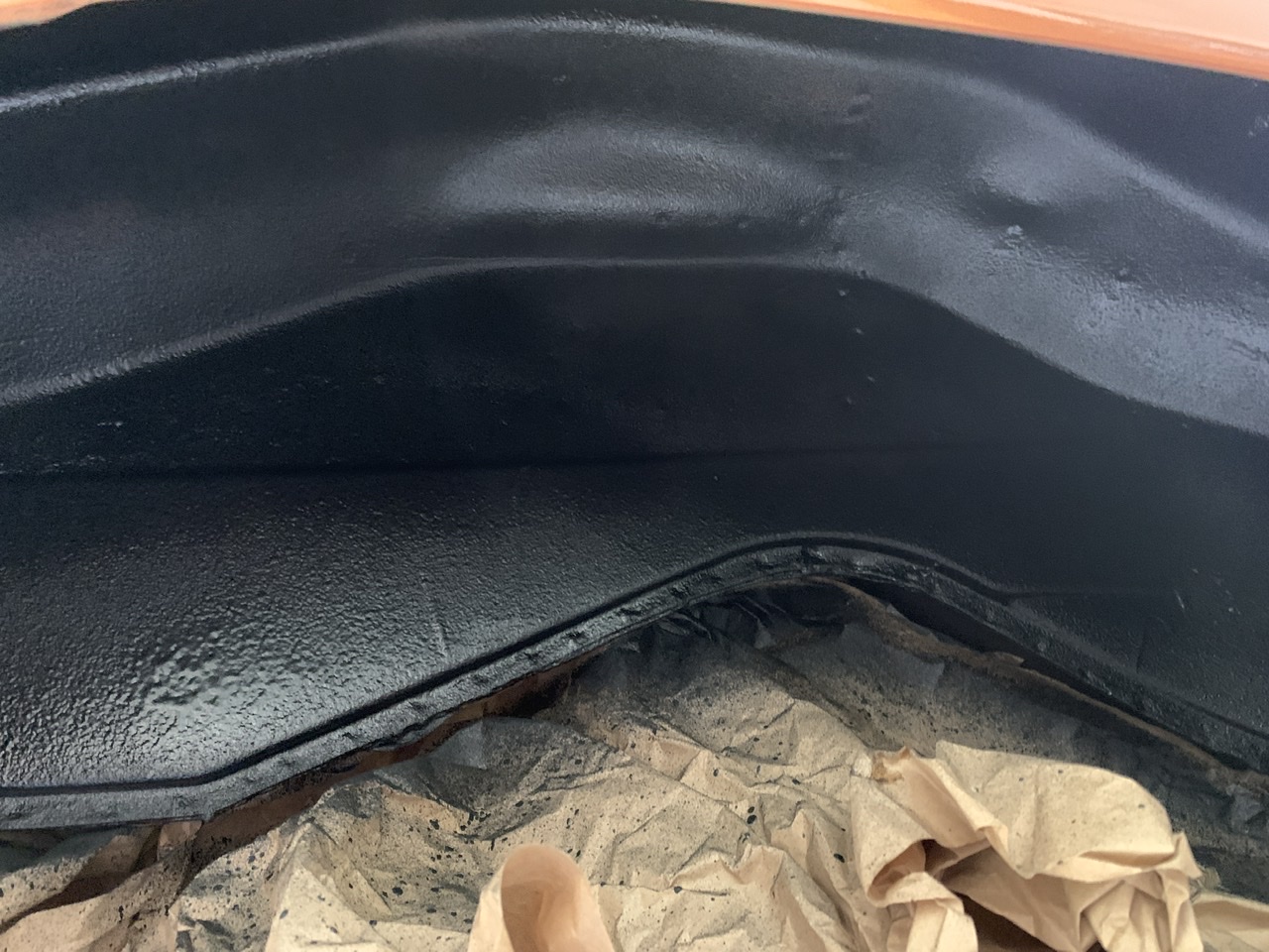

DRPHIL914
post May 23 2021, 08:11 PM
Post #14427
Dr. Phil
Posts: 5,920
Joined: 9-December 09
From: Kennesaw, GA
Member No.: 11,106

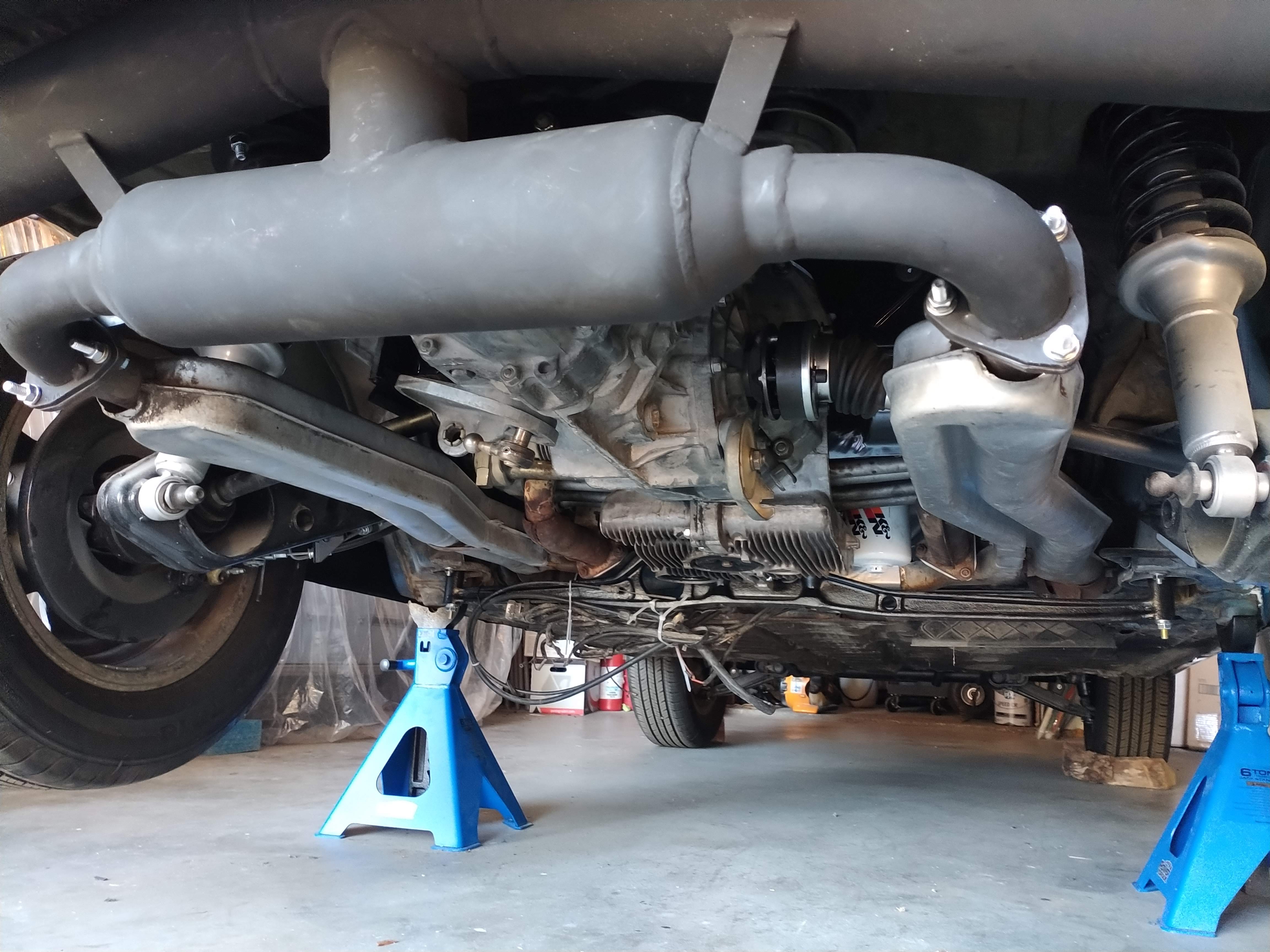

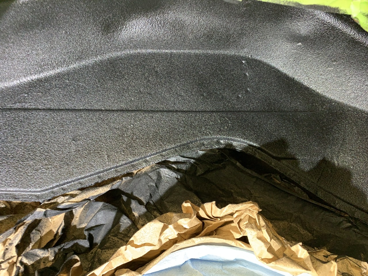

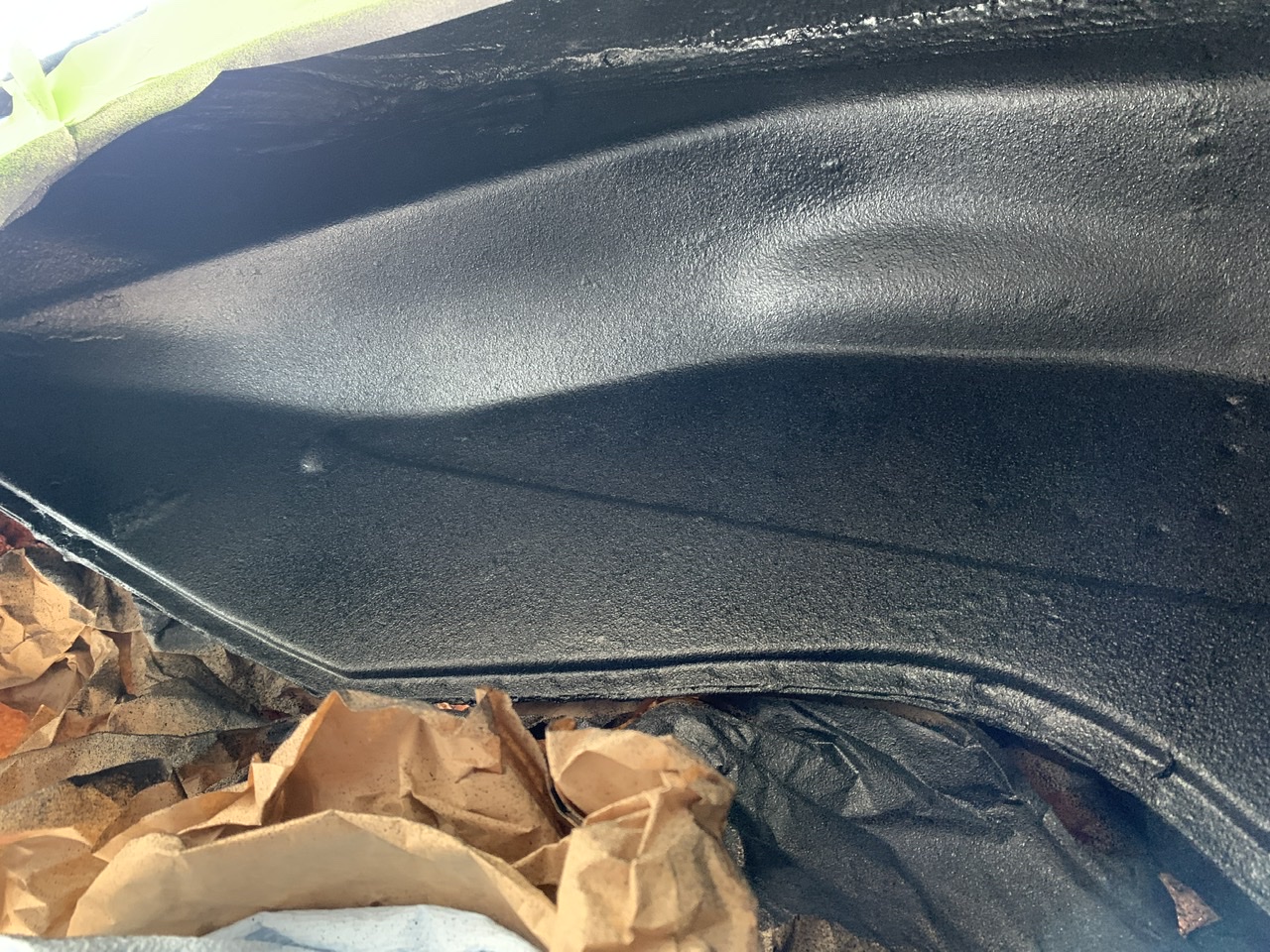

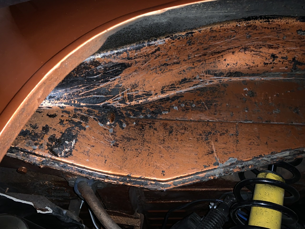

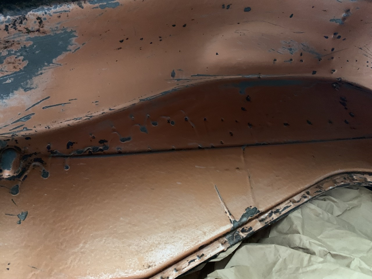

with motor being down, i turned my energy to something else, the rear wheel wells were not stripped properly back 3 years ago , since it was peeling, cracking anyway- btw you can’t put other stuff over 40 year old dealer Duracoat, Pro-tip, it won’t work - so all that had to come out.
stripped properly and prepped for new coat of Wurth Stone Guard. i like the results.
next weekend the motor comes out - ugh i can’t believe just a day after Werks Reuning show i am pulling the motor for a dead cylinder! (IMG:style_emoticons/default/headbang.gif)
Attached Image Attached Image Attached Image Attached Image Attached Image Attached Image

90quattrocoupe
post May 24 2021, 03:26 PM
Post #14430
Posts: 208
Joined: 4-November 16
From: Long Beach, CA.
Member No.: 20,561
QUOTE(DRPHIL914 @ May 23 2021, 07:11 PM) *
Did you use the spray can product? Did you use the self etching primer to prep the paint?

QUOTE(Steve @ May 23 2021, 07:58 PM) *
QUOTE(930cabman @ May 23 2021, 05:33 PM) *
QUOTE(Steve @ May 23 2021, 03:13 PM) *
Very cool, will it be shoe horned into a 914?
Of course!!
I can help with the wiring if you want, as I have been there, done that.

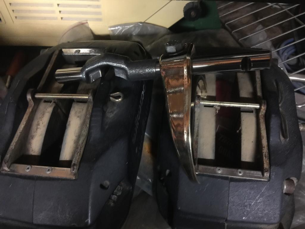

Shivers
post May 25 2021, 11:53 AM
Post #14432
Posts: 3,363
Joined: 19-October 20
From: La Quinta, CA
Member No.: 24,781

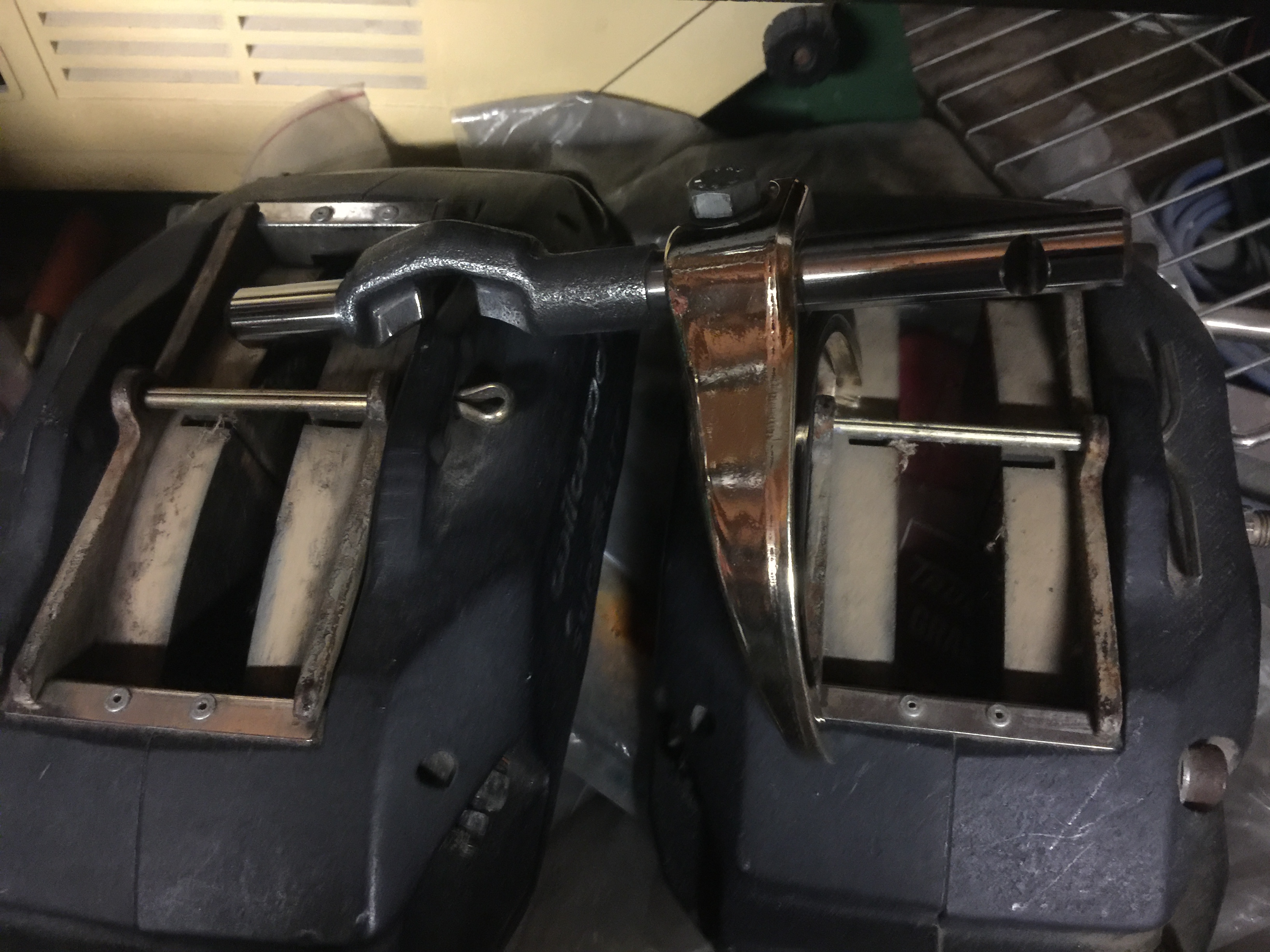

I polished the shift rails and forks for my side shift conversion. I didn’t need to polish the whole fork, but while I’m in there. Attached Image

QUOTE(DRPHIL914 @ May 23 2021, 08:11 PM) *
Our 1974 and 1975 914's have the same stuff. I have been removing the asphalt based stuff and am considering repainting the inner fender wells with the paint color. Ours will probably never be driven in the rain, and NEVER during the winter months

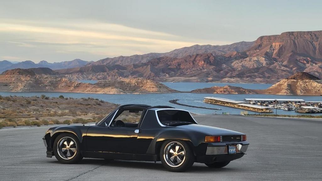

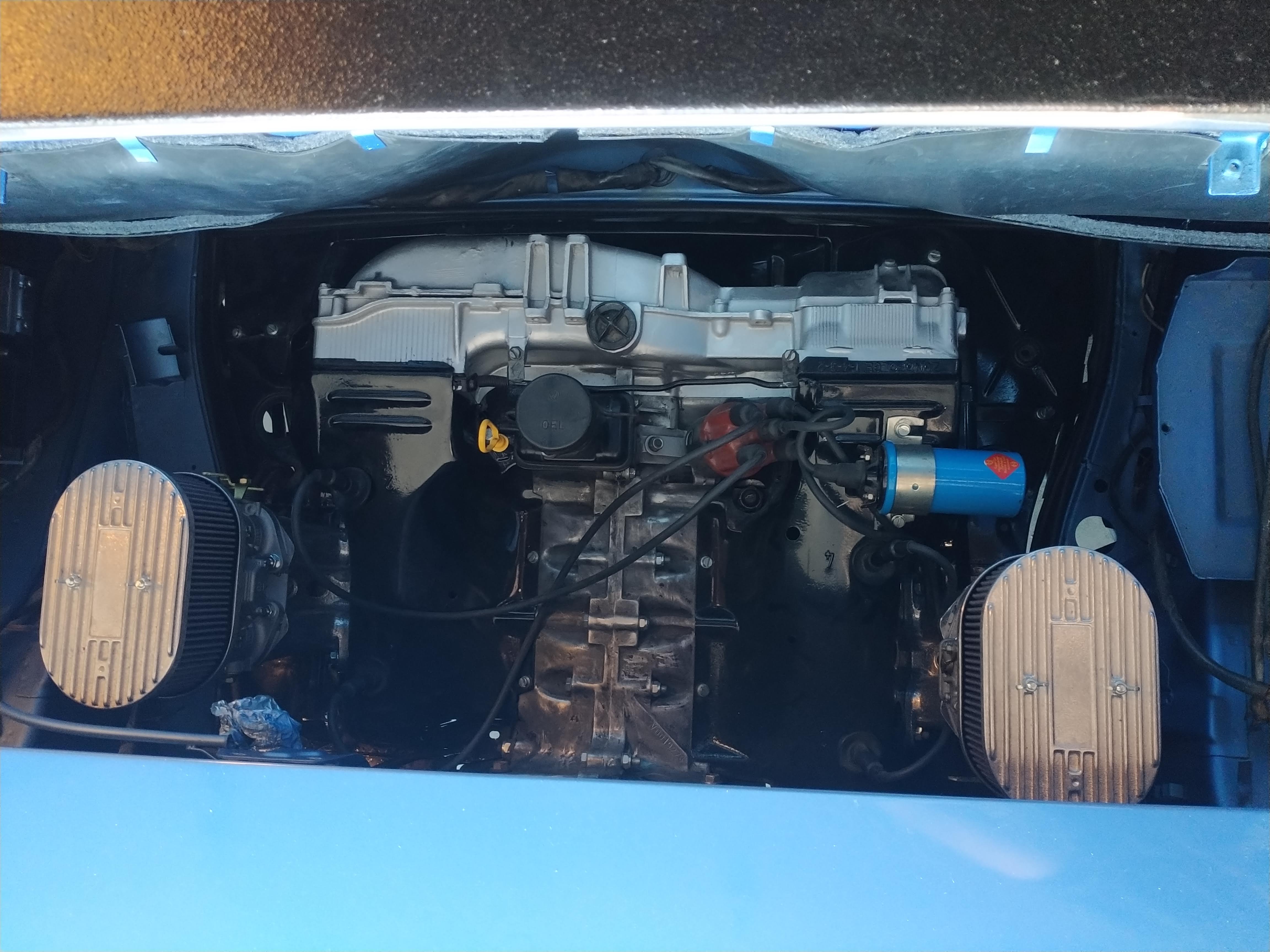

post May 25 2021, 10:59 PM
Post #14434
ELVIRA
Posts: 8,935
Joined: 27-March 03
Member No.: 481
Went for a drive around the lake . . .
. . . and watched the sunset.
Clay
Thanks Clay!! I’m not worried about the engine compartment side, but the DME side will take some work compared to my 3.2 DME wiring. I just noticed there is no DME relay and I’m missing the ignition control unit. Fun fun fun

QUOTE(Steve @ May 26 2021, 01:53 AM) *
QUOTE(ClayPerrine @ May 25 2021, 08:45 AM) *
Clay
The DME relay on a 964/993 is part of the chassis wiring harness, as is the diagnostic plug. Do you still have your /4 relay board? If so, you can use the D-Jet relays in place of the DME relay.

QUOTE(ClayPerrine @ May 26 2021, 04:42 AM) *
Clay
Clay
I dumped the relay board when I installed my first six back in 1986. I can make a dme relay out of two separate relays. I can figure it out. It’s just time.

QUOTE(90quattrocoupe @ May 24 2021, 05:26 PM) *
Greg W.
Yes i used the spray product. i sided it foe the rear valance too.
i prepped it after getting all the undercoat off , i used the pre-paint de-greaser and sanded it with a 400 grit paper, cleaned it etc, it should adhere well. i am going to do the other side rear next weekend.

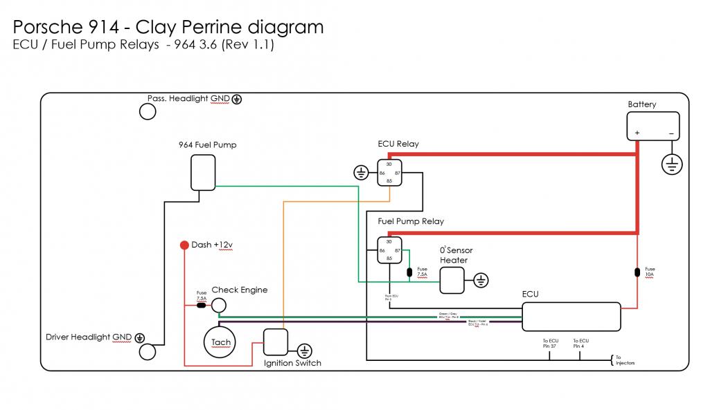

ClayPerrine
post May 26 2021, 11:30 AM
Post #14440
Posts: 16,542
Joined: 11-September 03
From: Hurst, TX.
Member No.: 1,143
QUOTE(Steve @ May 26 2021, 07:26 AM) *
Clay
Clay
This should help....
(IMG:http://www.914world.com/bbs2/uploads/post-9478-1609882576_thumb.jpg)
