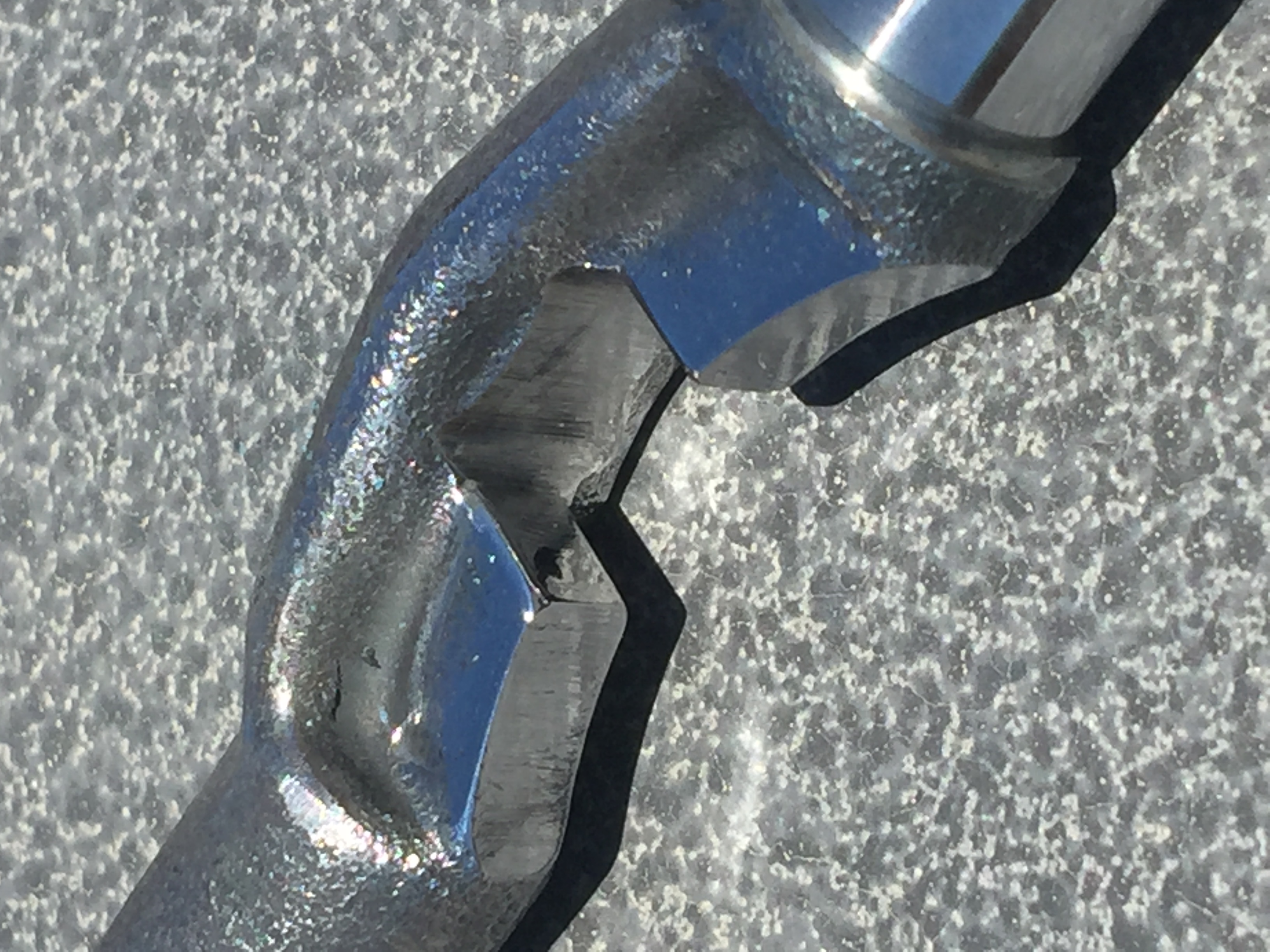

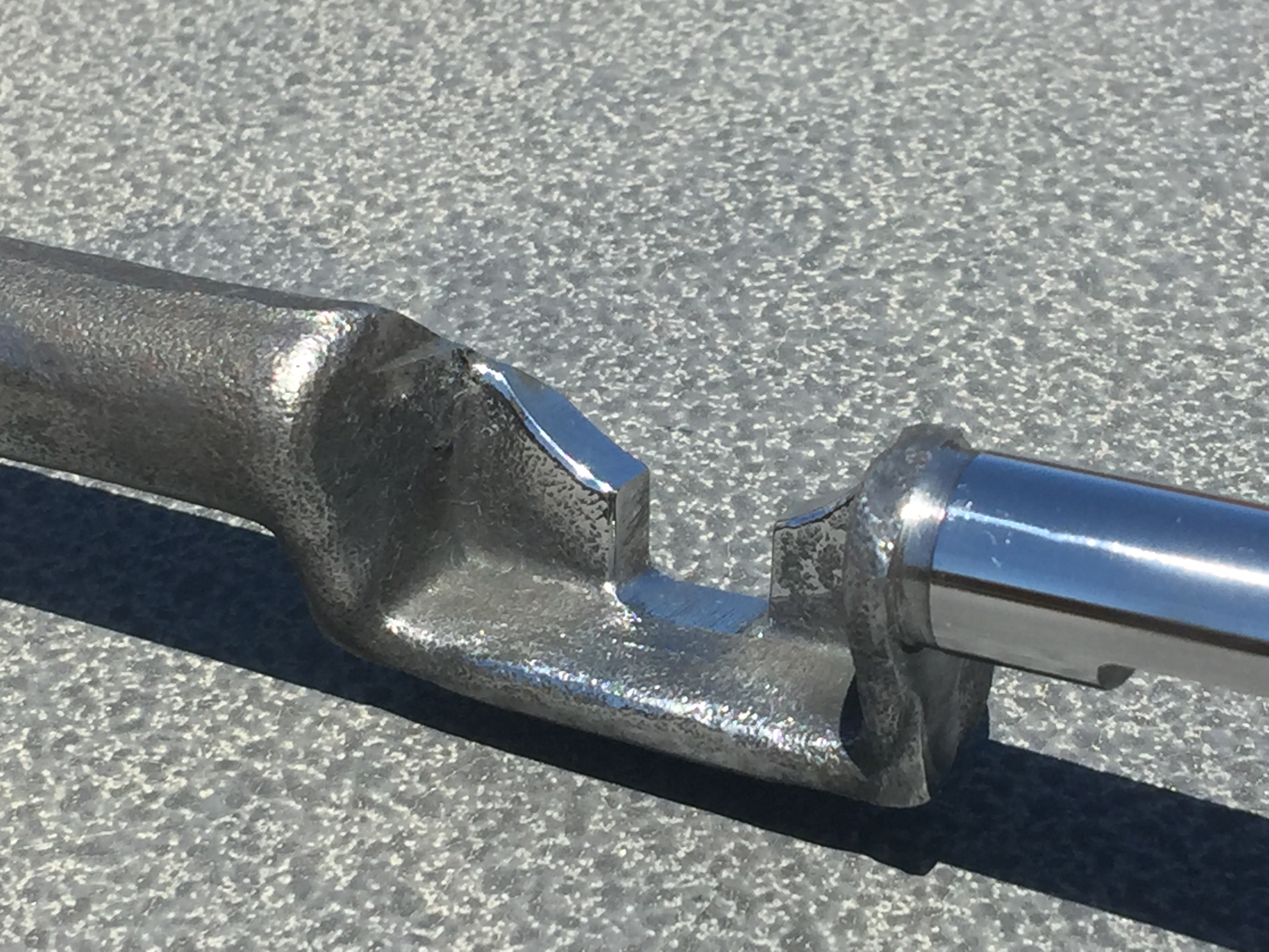

I was reading an interview with an old transmission builder for a Porsche team. Talking about the 901. One of his suggestions for smoother shifting was where the factory ground a bevel on the shift rails, round it off and polish it. So I did. Attached Image. Attached Image

I also read about this fella that worked for Cadillac that developed “slick shifting”. Anyone ever do this mod or know if the dog teeth are strong enough for the mod? Thanks

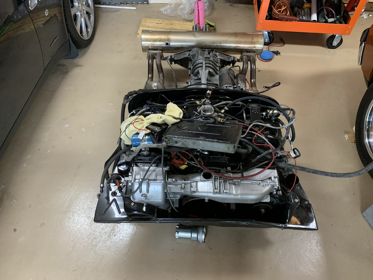

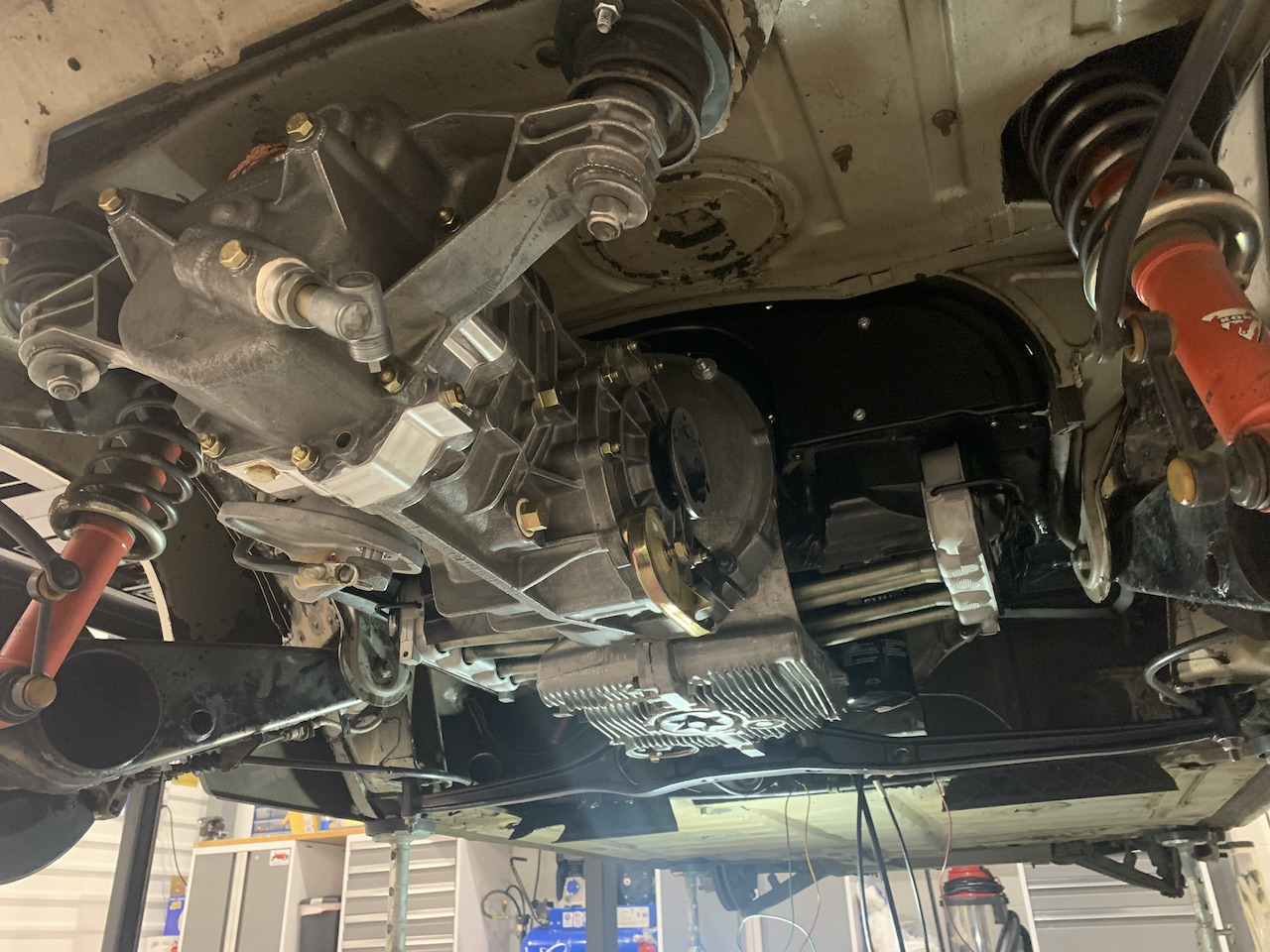

With the help of another Porsche friend, we lifted the engine up in place... Chris' (tangerine) engine lift tool helped as well.... now lots of cables, etc to hook up. As soon as I replace the front rotors it will be ready for a road test.

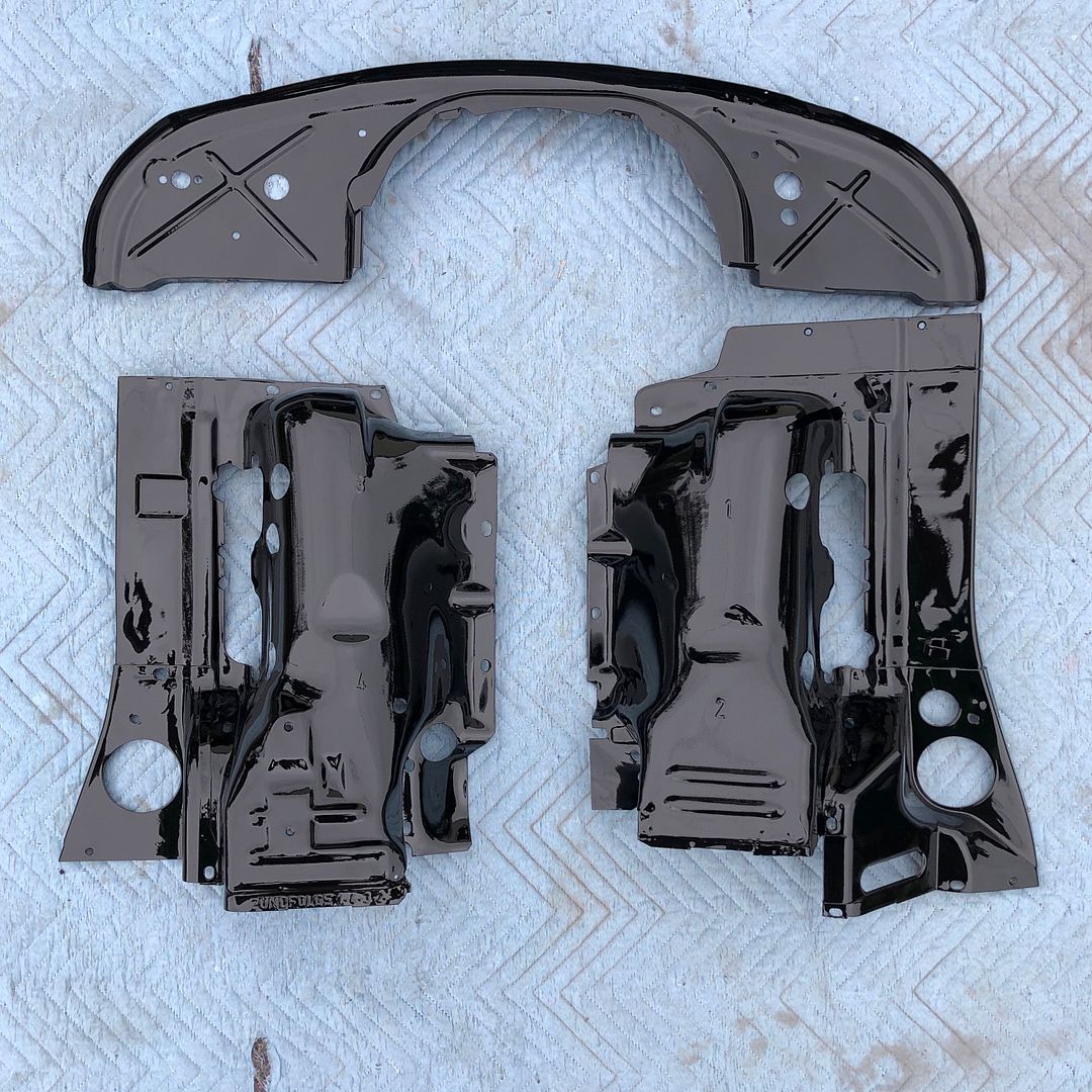

At the end of three days, the color is finally on. It has been baking for four hours at 100 degrees, paint is curing nicely. @euro911 Thanks so much Mark, I stripped it to bare metal, it is in great shape. Hope you had a safe drive from here.

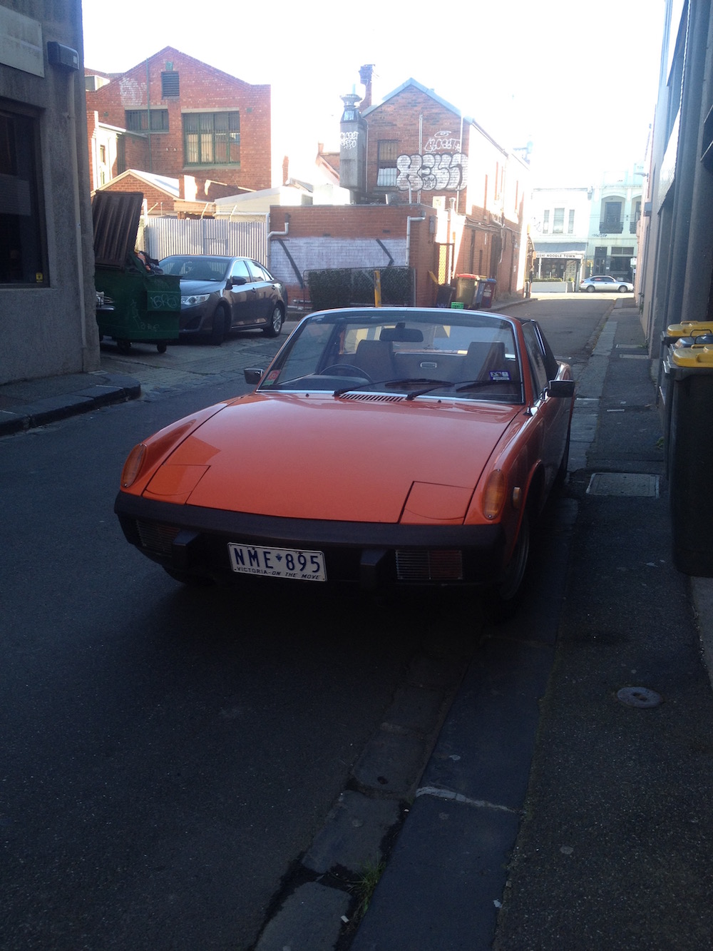

got up, got to work, cracked all three cars out of my restricted linear parking arrangement in inner city lane way japan scale batcave. fanged around in citroen xm for an hour and a half just to loosen it up and me too. got its hydraulic juices flowing again. puddles of green LHM liquid on floor where its been parked for 6 weeks. (IMG:style_emoticons/default/sad.gif)
then......... busted out 914 and flogged it around here locally.
deserted streets. won't say how fast i had it wound out, you never know what the authorities are scanning for evidence. but lets just say it was responsible where i did it.
stayed within 5k of home - within the law (i was exercising (IMG:style_emoticons/default/dry.gif) ). deserted inner city streets. heaven.
waiting to get pfizer or moderna option as i am 60. no way am i sticking astra zeneva junkyard dog vaccine in my veins. i want german/american tech in me. have to wait.
meanwhile, take your opportunities when they are offered for (IMG:style_emoticons/default/driving.gif) .......the emoticon is not quite up to speed. (IMG:style_emoticons/default/beerchug.gif)

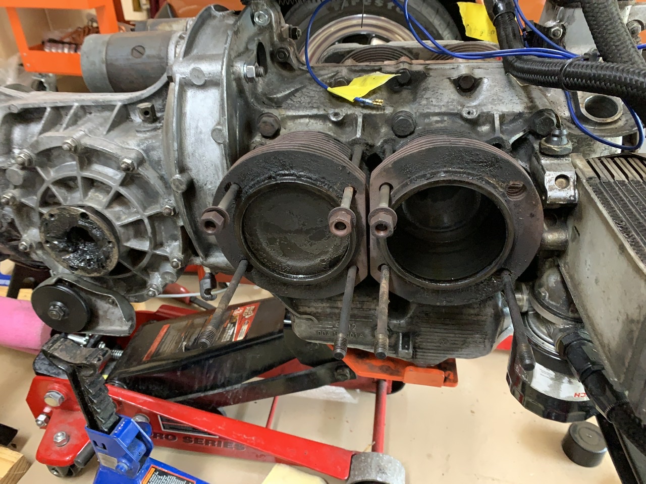

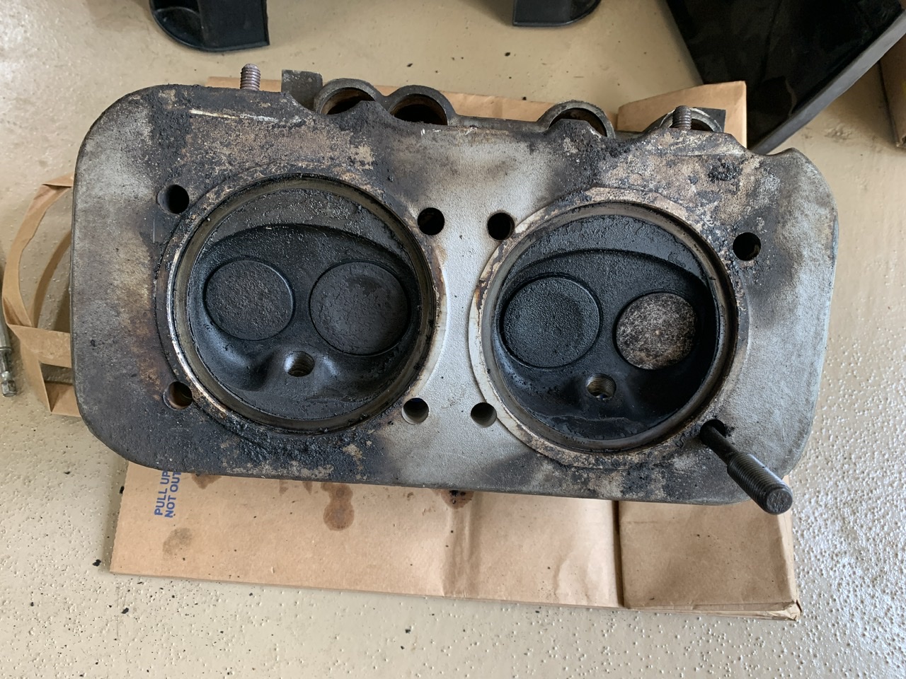

pulled the motor yesterday, removed the tin and pulled the head due to finding loose valve seat on #3 intake valve. no head or piston damage , i think the valve is ok too, but
but that loose seat will need to be repaired. Can anyone recommend an aircooled head specialist on the south east coast?

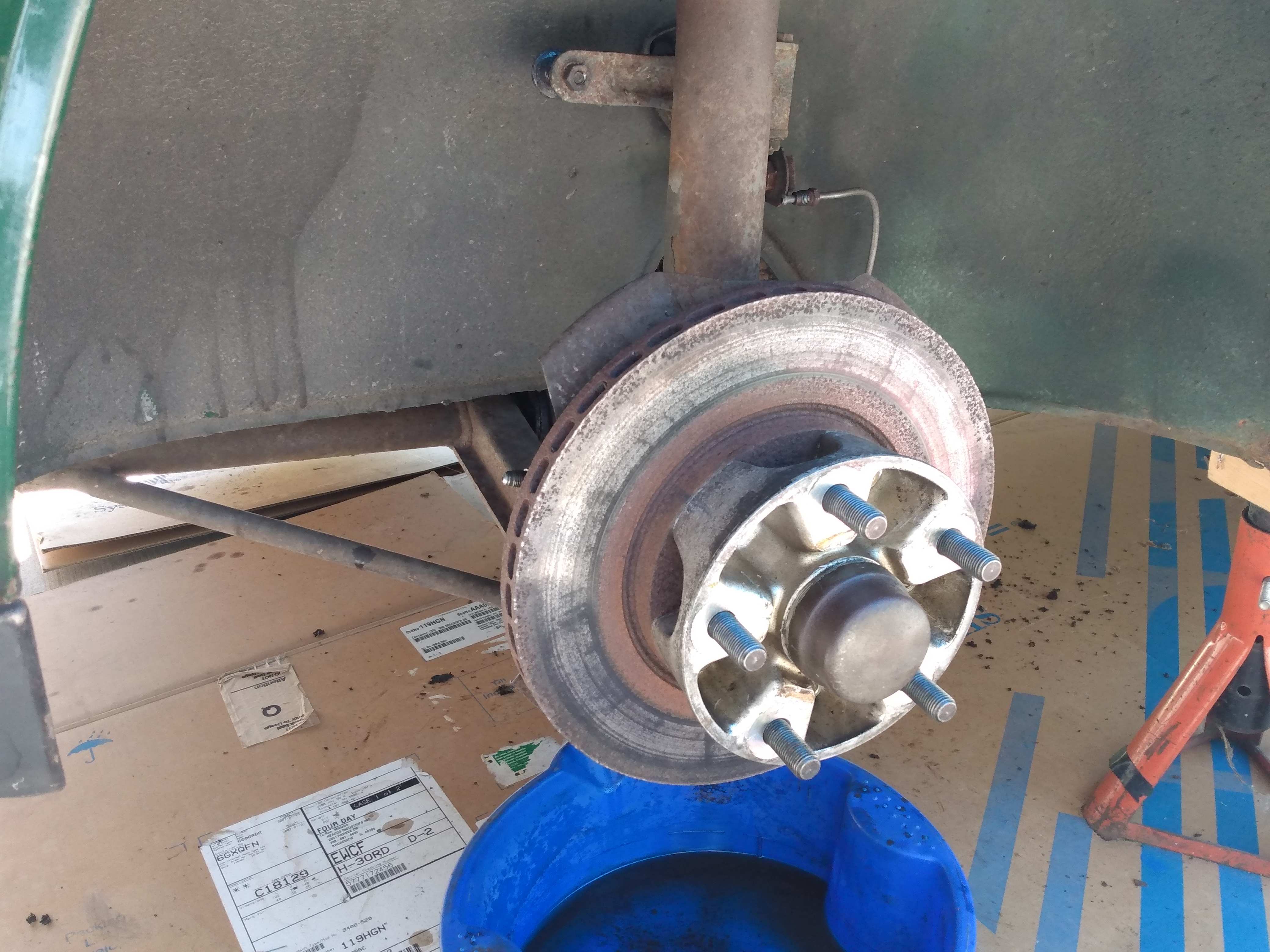

Turned my running/driving -6 into just a running one. Brake pedal just about went to the floor when I put it away for winter last November. Finally got the time to wheel it out of the garage and get going on swapping out the master cylinder I bought from 914Rubber 4+ years ago. While I was at it, figured I might as well pull all the calipers and send them to PMB. Amazingly enough, just about all the brake line connections came loose even though I know they haven't been touched in 25+ years.
Did start and run her for about 15mins and carefully pulled back into the garage.

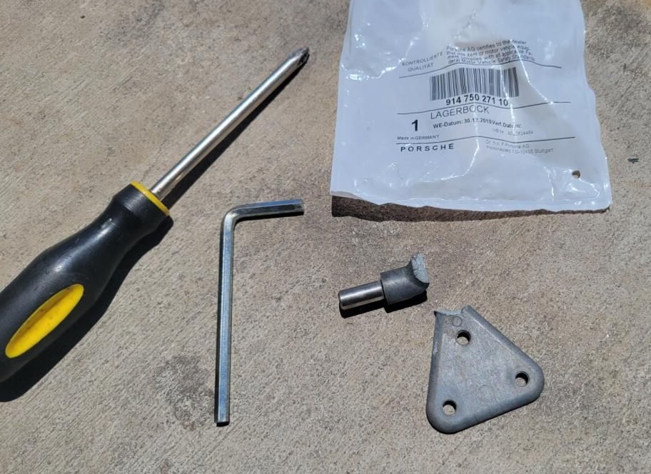

Completed a 914 repair without needing a 10mm wrench or socket. (IMG:style_emoticons/default/smash.gif)
Replaced part # 914 750 271 10. Headlight Pivot.
