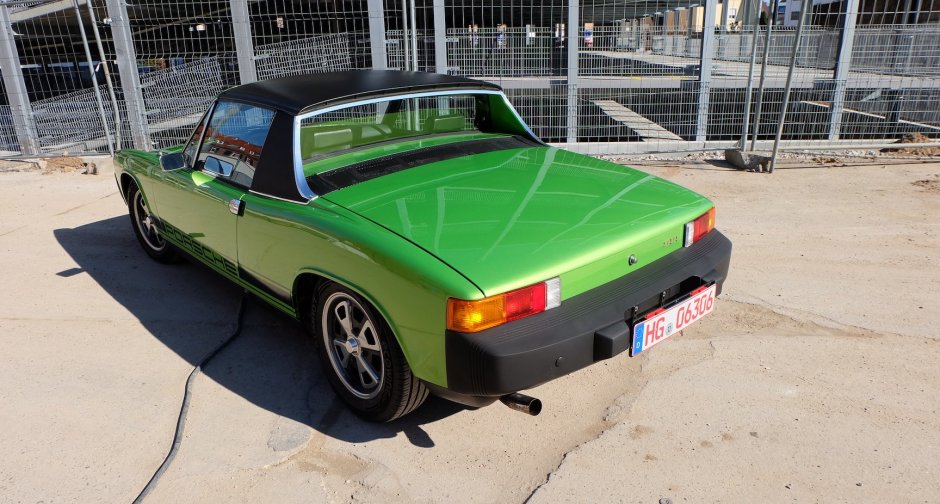

So far in the New Year, Elvira has been a work commuter and domestic errand runner. (IMG:style_emoticons/default/driving.gif)
Today was our first opportunity to take a nice long drive, exclusively for the enjoyment. (IMG:style_emoticons/default/biggrin.gif)

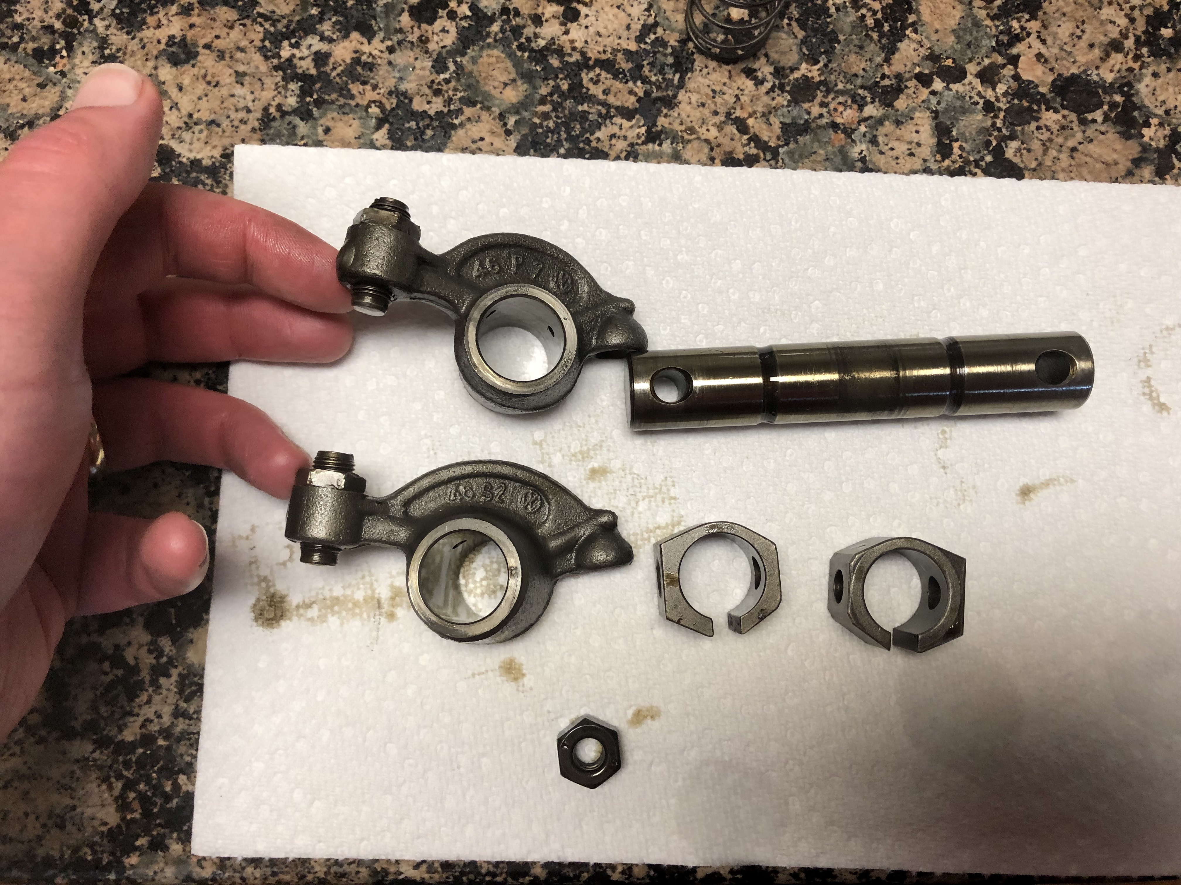

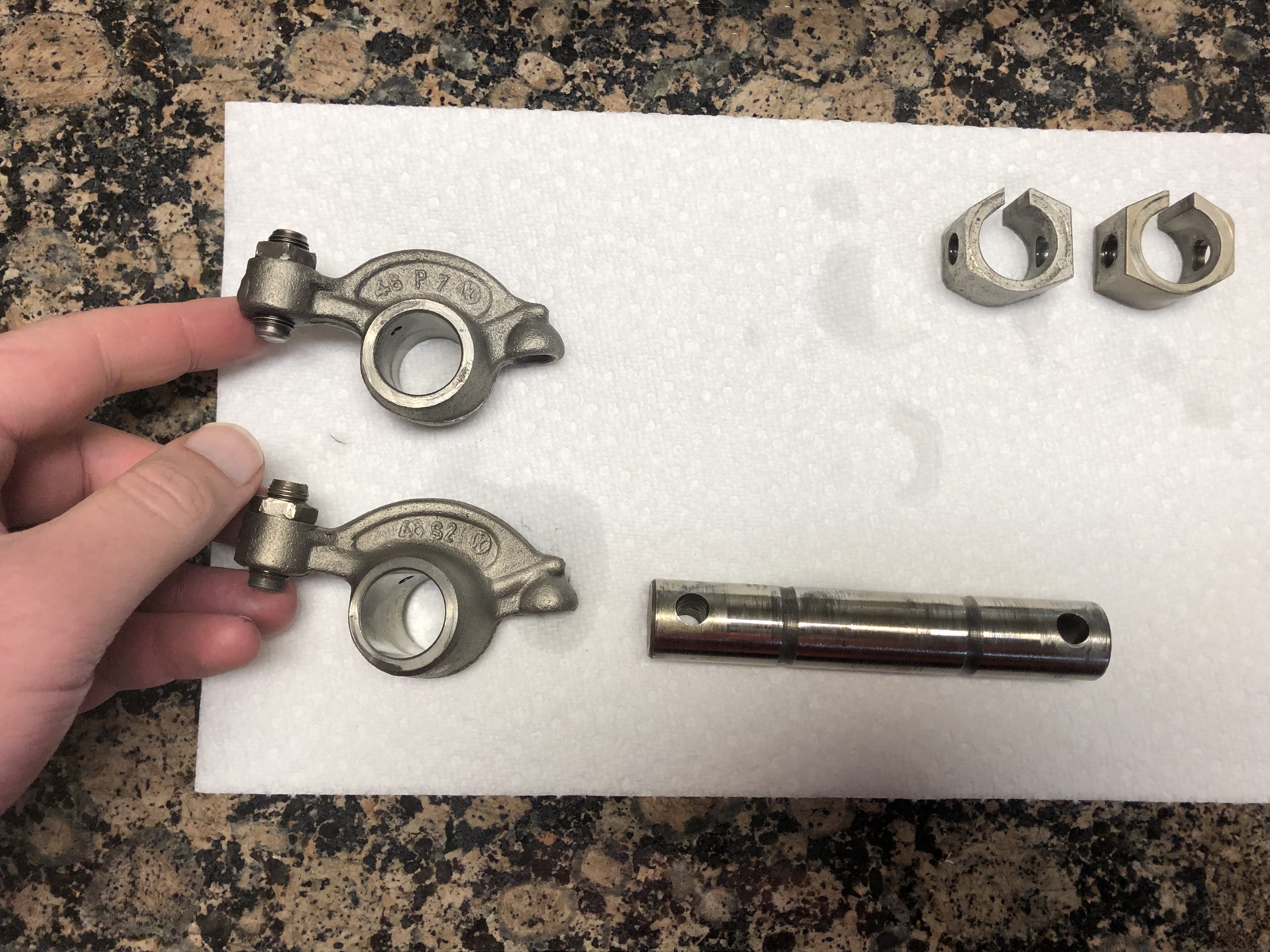

Working on the valve train geometry, Ian's youtube with input from Jake is very informative. I am taking my time with things.

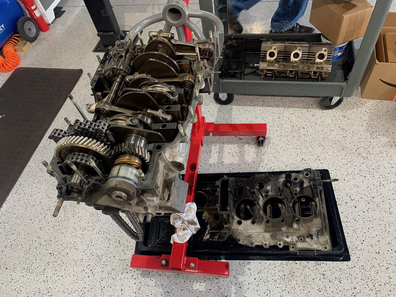

Split the case on the 2.4 going in the '71...
Case, heads, etc will be on their way to Ollies in Lake Havasu for some prep!!Attached Image

Got my 2.7 case back from Ollies a week ago. They are somewhat back logged, and not cheap, but I am expecting good results when things come together.

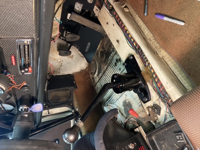

Working on RennShift and pedal board install.Attached Image

Heard good things about Ollies- stopped by there last year when I dropped off a transaxle at California Motorsport, about 2 miles from them. A friend with me had his 356 case and heads there and he wanted to check on them.
I've heard from many people they do great work... looking forward to finding out myself.

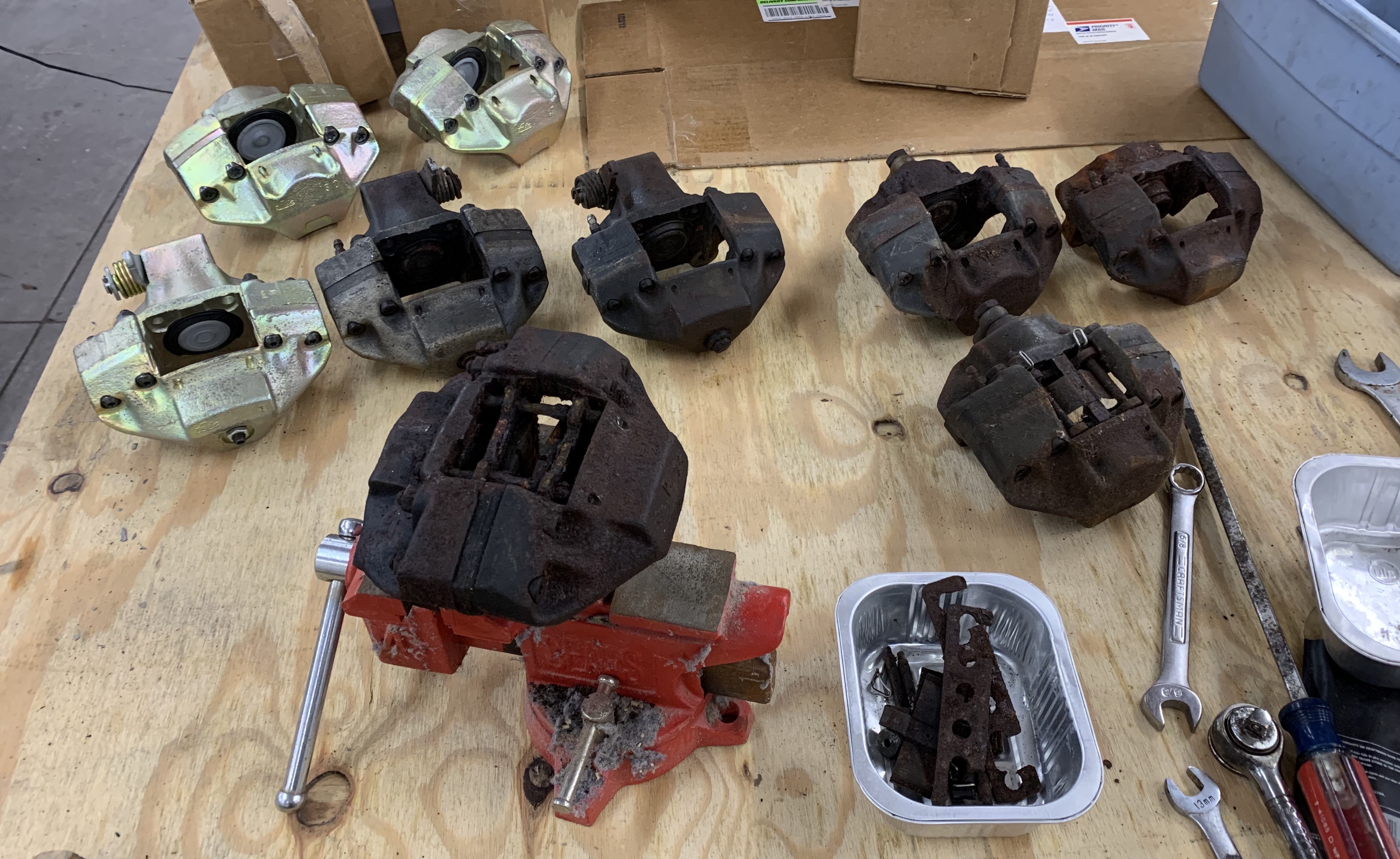

Sorting through my collection of calipers preparatory to sending some off to PMB for my six.
We've got two rebuilt front at the upper left, they should be ready to bolt on.
The three rears right below them should be enough to get me a matched set of GT spec calipers suitable for vented disks.
The other four are a pair of A's and a pair of M's, and they're cores or hardware donors.

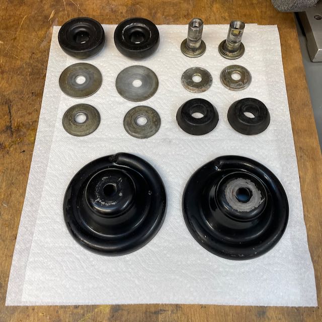

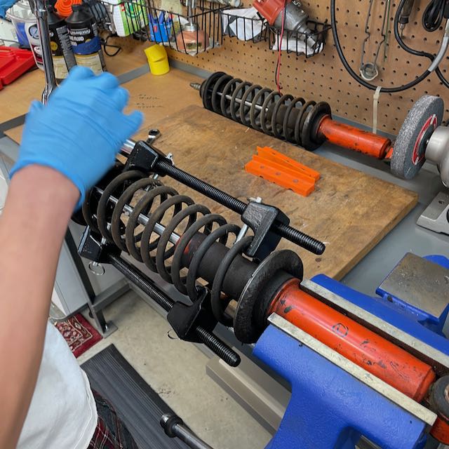

Disassembled the old struts and cleaned up parts to migrate to the new setup.

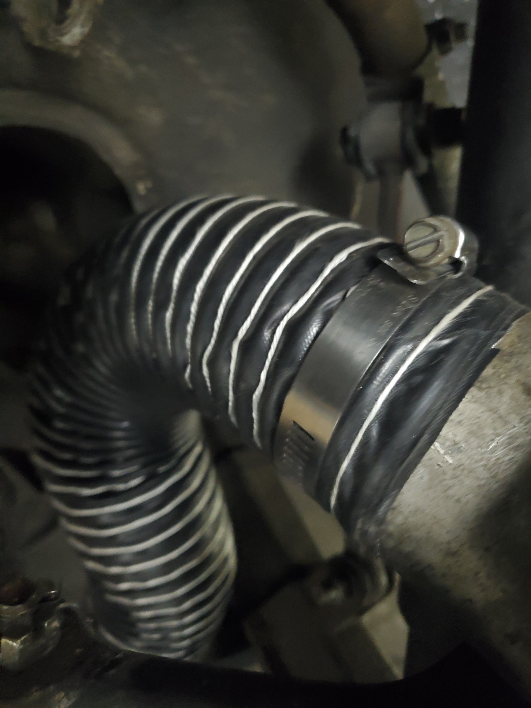

Starting to layout the aim system (pdm08), ordered two more custom bars for the cage, and installed new hoses on brake cooling kit.

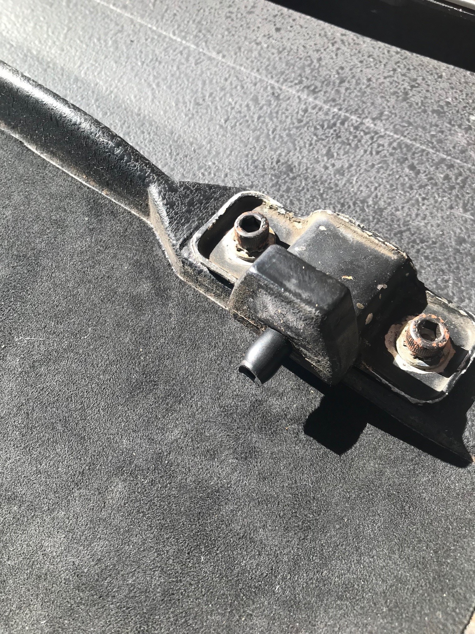

Thanks to this forum, found some easy fixes to a squeaky roof. Bought some $5 velcro and installed fuzzy side over existing seal (which the fuzzy had worn down). Also put some rubber hose over the latch.
