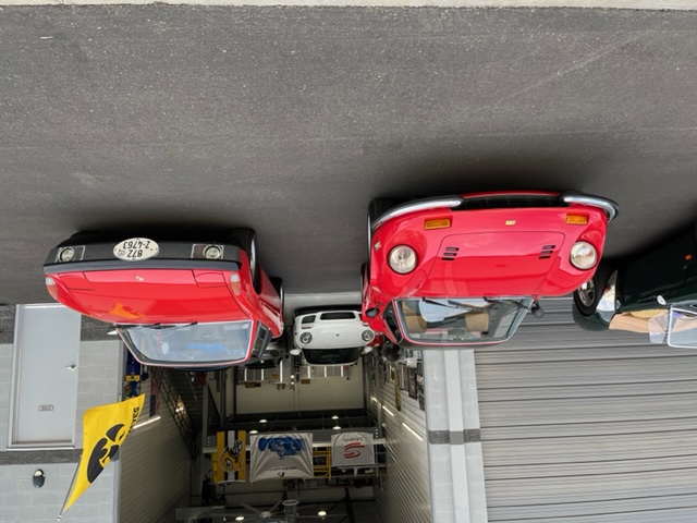

Great turn out today for cars and coffee at our toybarn community. A good friend parked his rare "chairs and flares" Dino next to my '73- figured we'd put the bastard children from Porsche and Ferrari together for a photo op.Attached Image Attached Image
GO HAWKS!

Good eyes Brian!! Yes, once a Hawkeye always a Hawkeye!!

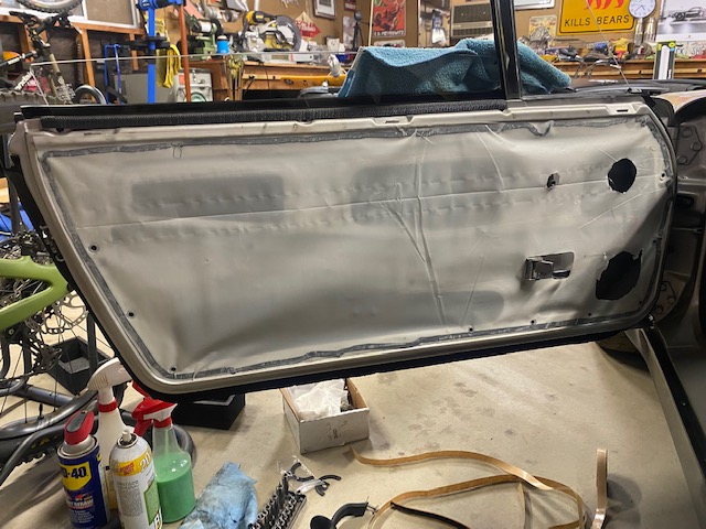

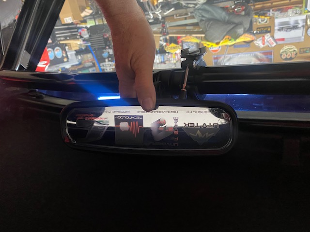

Installed a rear view mirror finally--used one made for a side by site UTV and it mounts on the rollbar, kind of cool, I was able to mount it way up high and out of the way without having to bond anything to the windshield at all (the other clip in the pic is the GoPro mount):

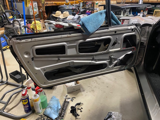

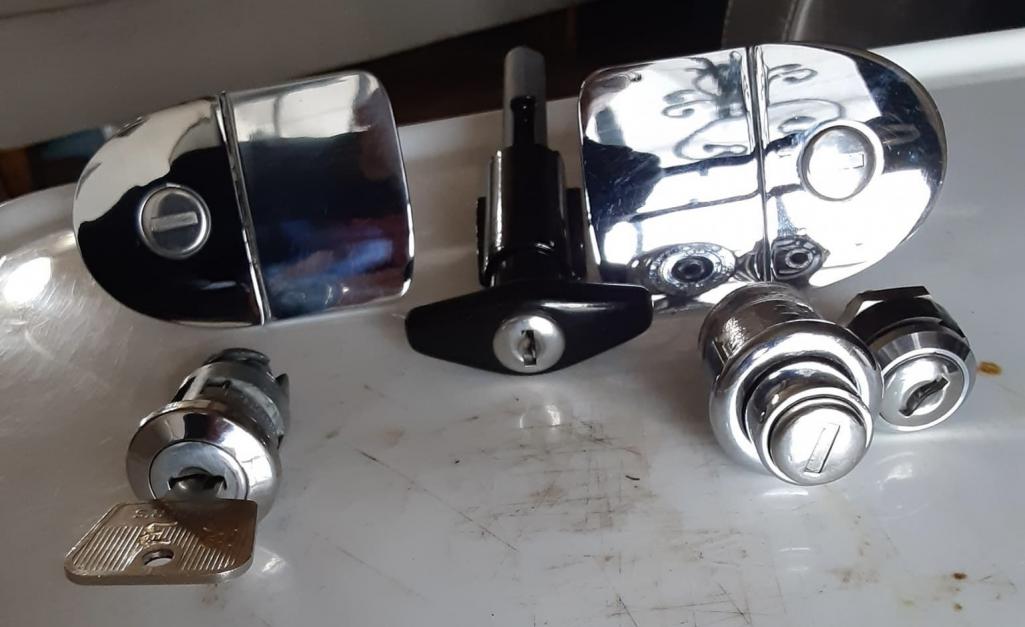

One of the things that drove me nuts about my car was that the only locks that matched (and I had a key for) were the ignition and drivers door.
Bought a full set of locks from @TheCabinetmaker (IMG:style_emoticons/default/beerchug.gif) and started the swap out
Managed to get the rear trunk, ignition done, then got into the drivers door for some "while I'm in there" work--man, cleaning and relubing up the mechanisms made a *HUGE* difference... Also took the opportunity to install the 914rubber vapor barriers to replace the trashbag version that was on there underneath:
Attached ImageAttached ImageAttached Image

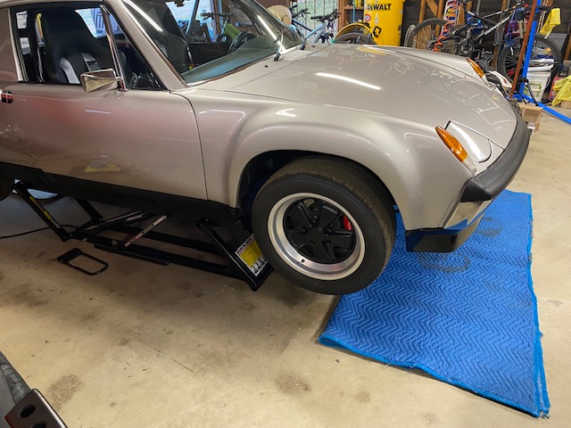

Buttoned that back up and then put the car on the quick-jack in preparation to drop the front bumper to get to my front trunk, to fix the cable and then swap out that lock also...
Then ran out of time... Still need to get in there then finish up the passenger door, I have a new main window glass piece for that door so I figured I'd save it for last... (IMG:style_emoticons/default/smash.gif)

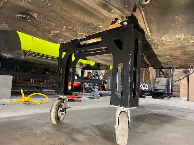

I have a 914 in the shop getting a full resto and I needed a cart to move the bare chassis around the shop. These ended up being more like stilts than a traditional cart. I got them back from the powdercoater last week and I finally had time to get them mounted. They put the car at a great working height in order to tackle some of the preliminary rust repair, flare install, etc.

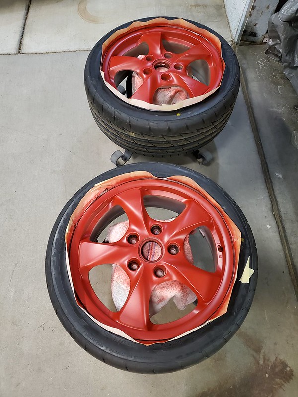

(IMG:http://www.914world.com/bbs2/uploads_offsite/live.staticflickr.com-431-1648713644.1.jpg)
Started painting the new wheels. Went back to square, 225/45 on 17x7 from the staggered 16s. Heavier than the 16" 205 fronts, lighter than the 16" 225 rears. 21mm spacer front, 21+5mm spacer rear.
