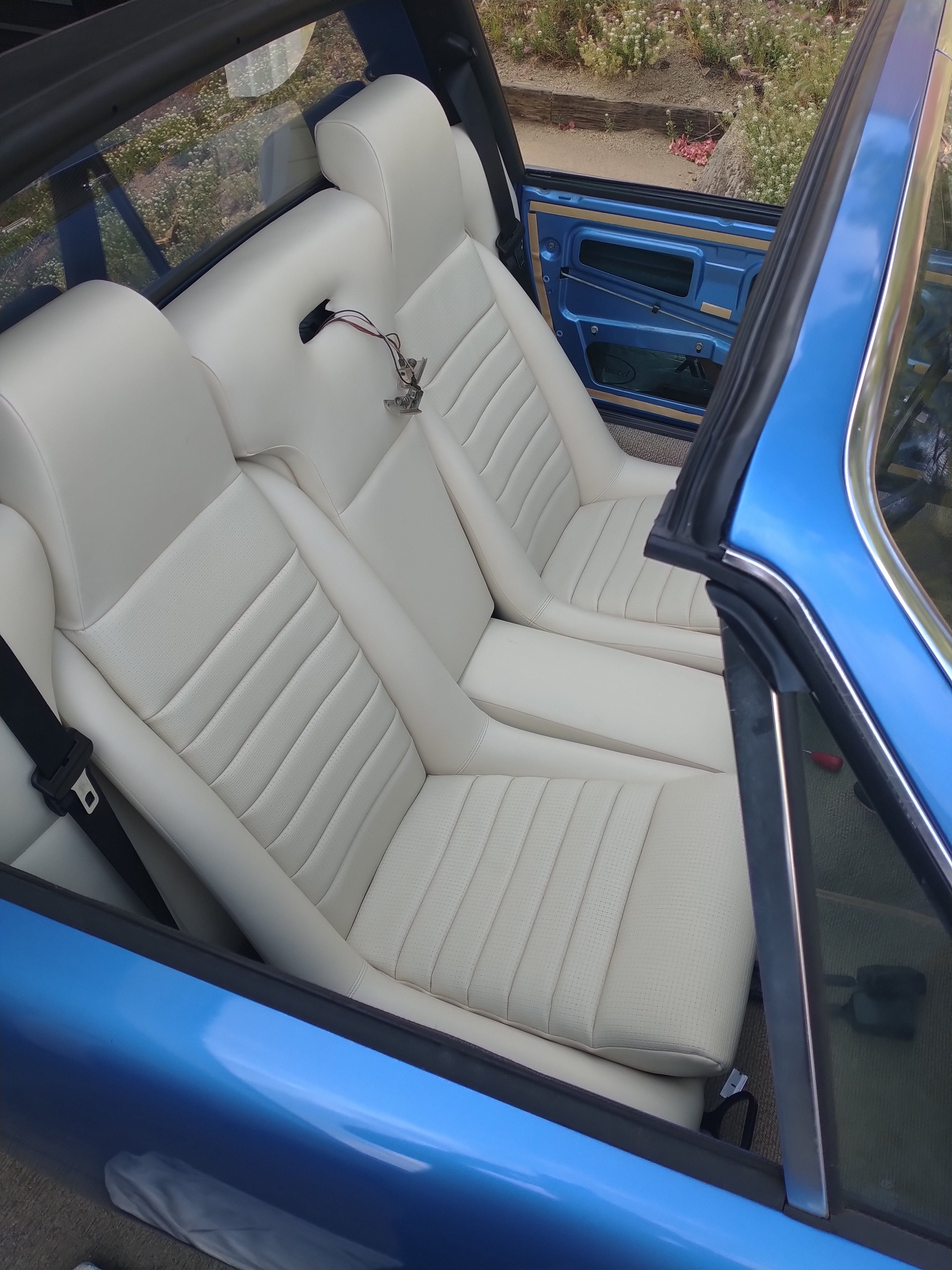

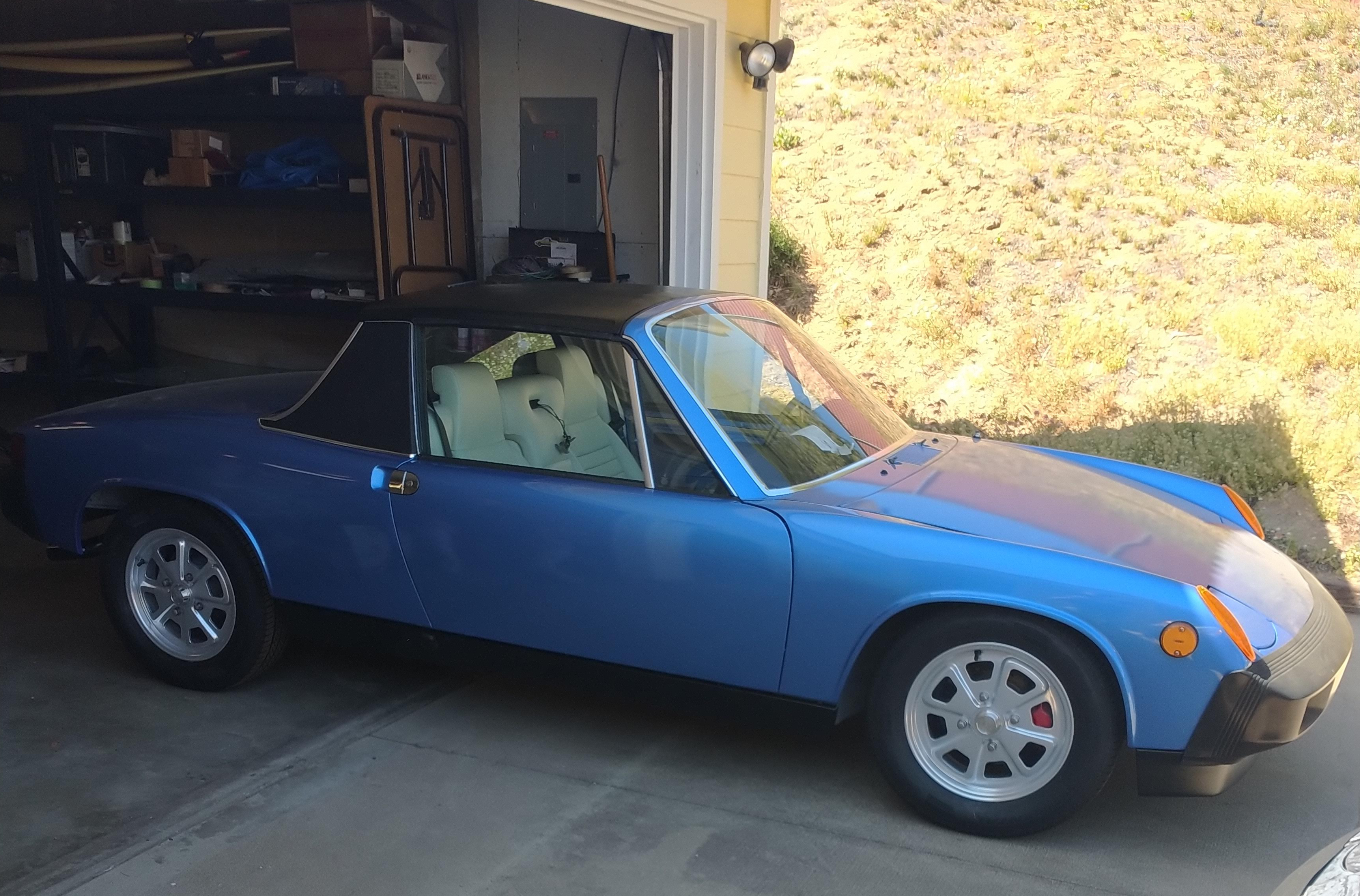

Put in the seatbelts from seatbelt planet, installed the back pad, and put the seat rails into the car today
Have to screw in the back pad on the bottom, install the center cushion and base and the slide the seats on the rails.
I'm missing one seatbelt anchor that I need to purchase and the I can get the door panels installed, the roof and windows lined up and we'll be good to go.

Such a great color combo! (IMG:style_emoticons/default/drooley.gif)

QUOTE(rjames @ Apr 11 2022, 12:52 AM) *
(IMG:style_emoticons/default/agree.gif) wow, i have always liked the white interior, have seen acouple, one was in a copper metallic car and looked awesome, one was in a white car , ddidnt like that as much, and one was black, that alsow looked great, but this might be one of the best color combos ever! (IMG:style_emoticons/default/aktion035.gif)
930cabman
post Apr 11 2022, 08:44 AM
Post #15204
Posts: 4,322
Joined: 12-November 20
From: Buffalo
Member No.: 24,877
Agreed, Blue/white looks great.

Thanks guys! In the beginning, I had to convince myself of the color combo but, over the years it grew on me and I really like it now. Funky 70's sort of thing.
It's been a long time coming to get here and we're almost done!

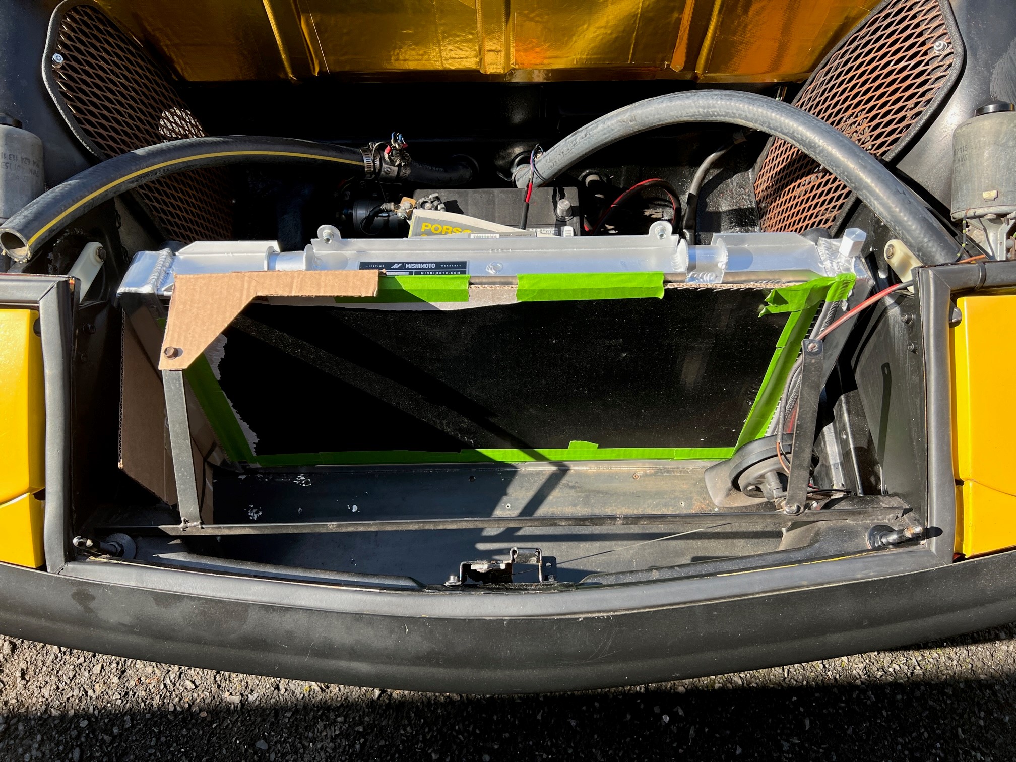

Upgrading the radiator from an OEM MR2 Turbo unit (1.8T swap) to a slightly larger 3 core unit and slim fan with shroud to see lower temperatures during commuting. Not exactly a drop in affair. Mocking up replacement brackets which should look nice. The OEM rad has foam surrounding it, I'm trying to find a good thick and dense foam to use but I'm struggling to find something fitting the size and heat durability requirements.

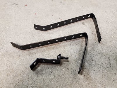

Spent most of the day making brackets. Well, technically it was making things fit nicely.
1 for the VW Deathstar. 2 for the oil cooler.

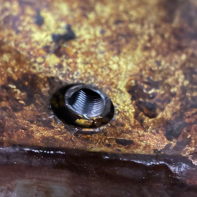

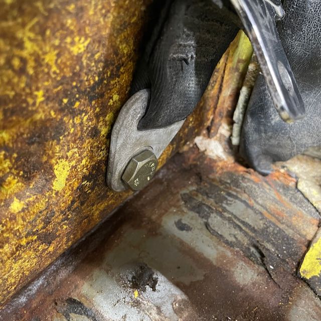

Finally got the passenger seat belt bolt back in. At the start of winter, I had broken the bolt when trying to tighten it (it was not seated). After much cussing and fussing, I got the old one out but thoroughly trashed the threads in the receiving nut.
Ended up tapping and helicoiling. Worked like a charm - although I was worried about getting the tap started at that angle and without being able to use the tap wrench that close to the floor.

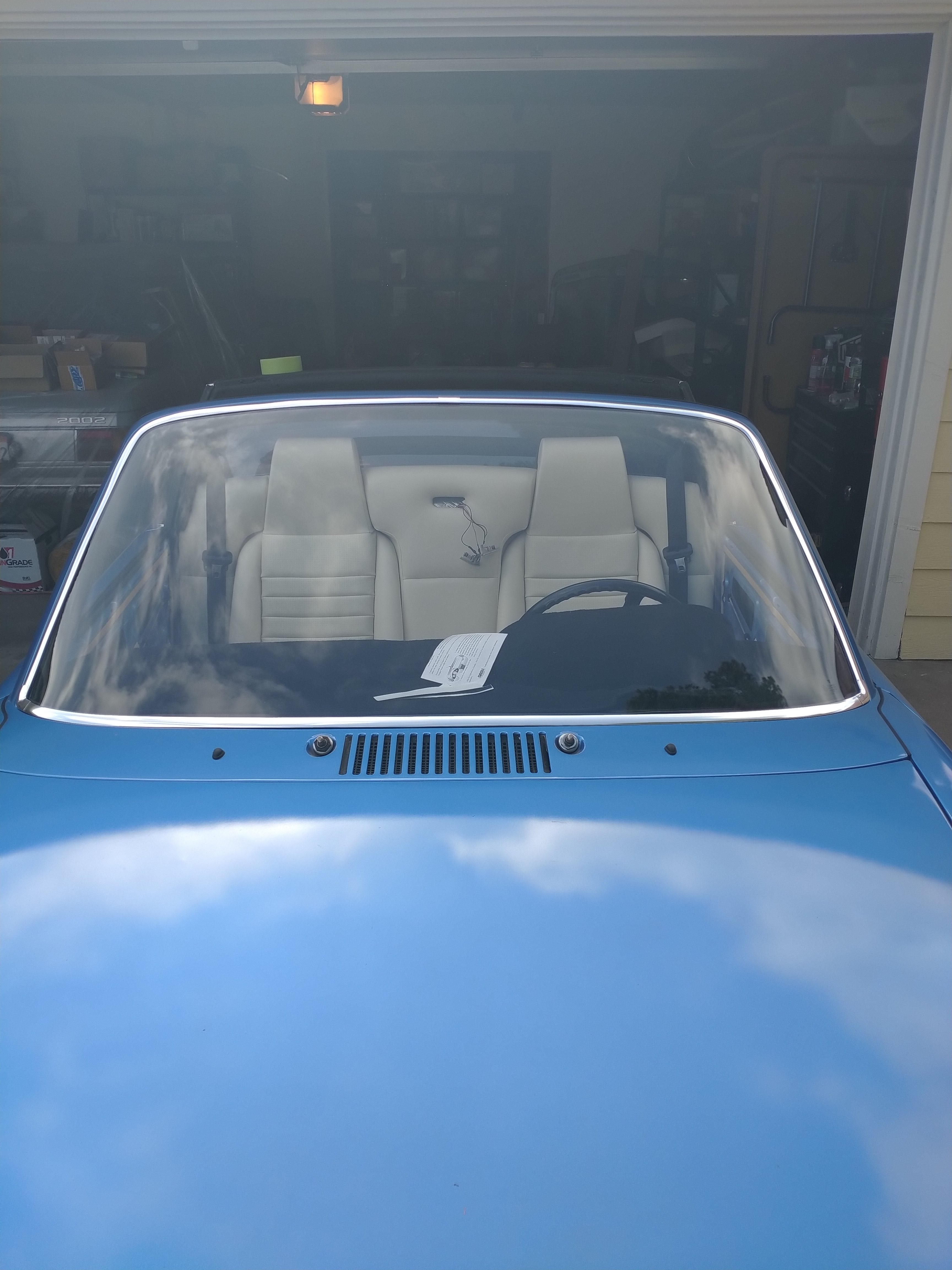

Aligned the roof and the door glass today.
We're almost there. Just have to get the door panels on, seat belts in, new center console light and the rear valance painted and put on. (we had to make a second hole on the right side for the triad exhaust.)

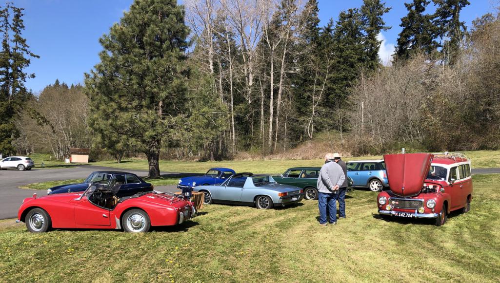

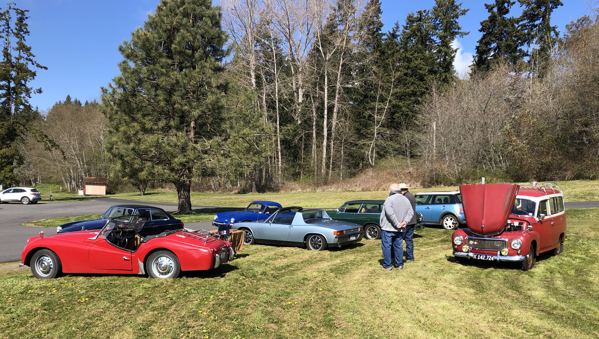

Actually yesterday. Drove the 914 for only the second time this year to a meet-up of foreign car enthusiasts for breakfast. Interesting group of folks with English, Swedish and one German car (mine).

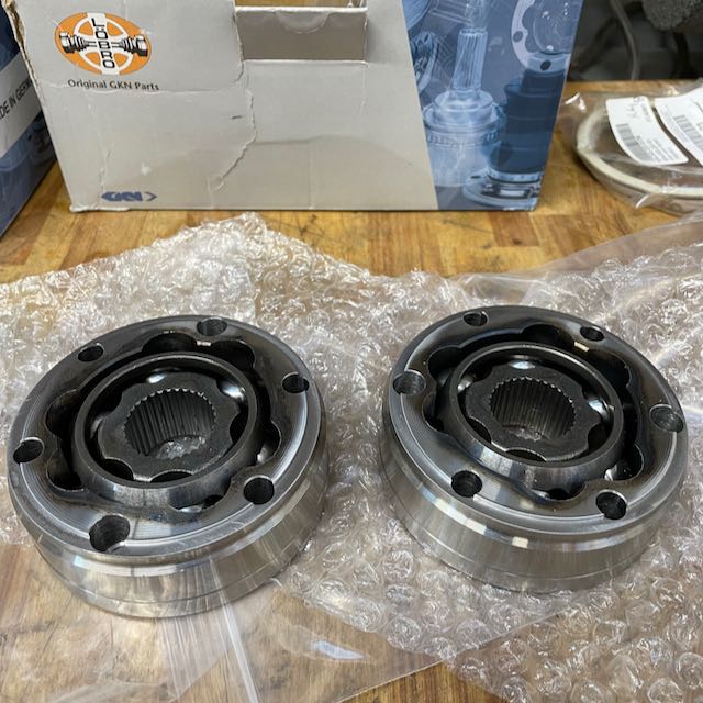

Received a package with *NEW* Lobro CV joints, machined to fit by Rich at @914Werke . Had no idea that was an option ...
We will be rolling before long!
@Chaznaster
what was machined in order to make them work?
Phil
Chaznaster
post Apr 20 2022, 04:39 PM
Post #15219
Posts: 325
Joined: 22-November 15
From: Concord, MA
Member No.: 19,389
Hi @doctor Phil
I believe the shoulder for the gasket and 2 opposing holes enlarged for the roll pins. @914werke could confirm ...
