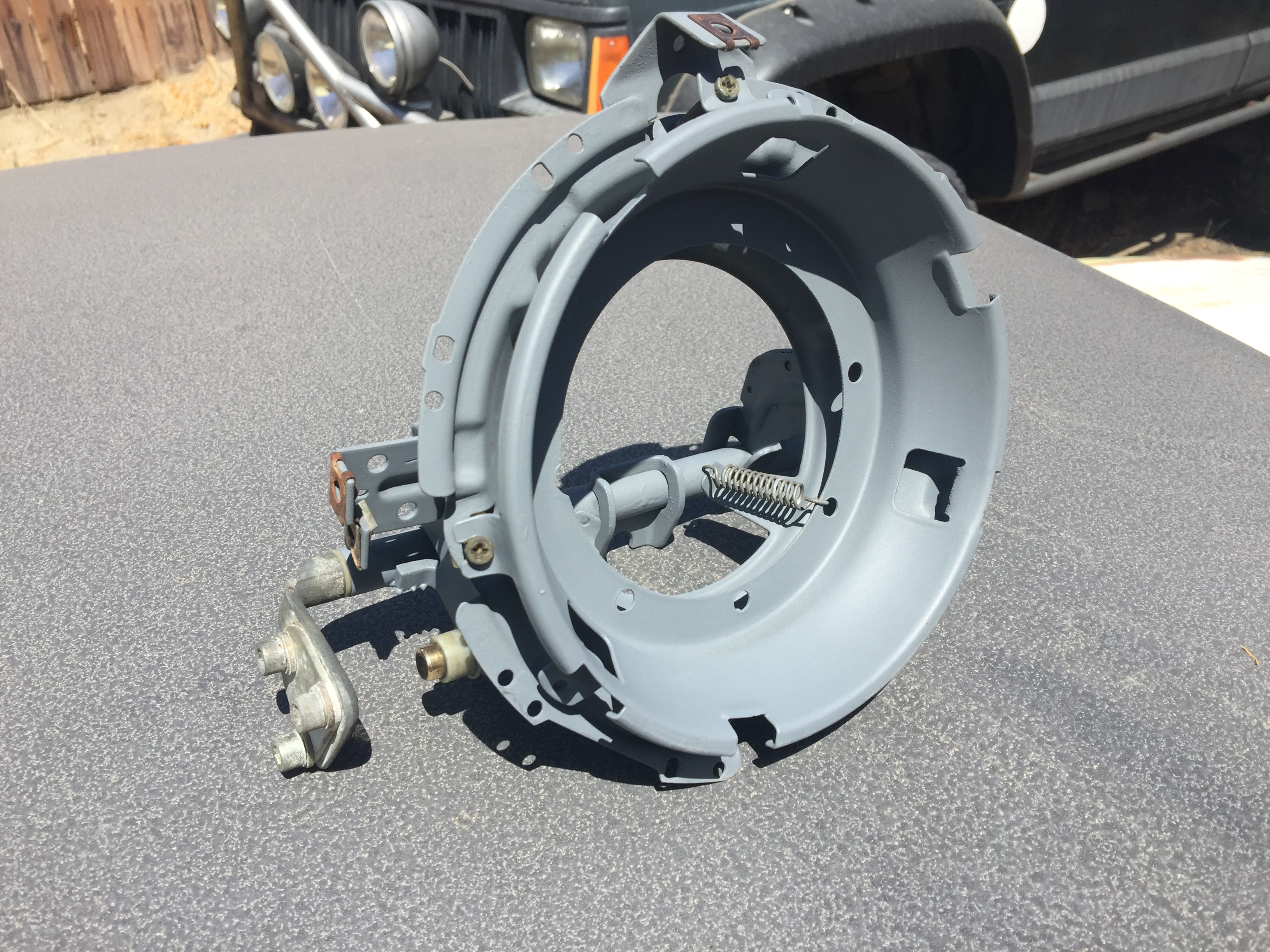

Did my best on color and finish.

I bake my paint so back together.

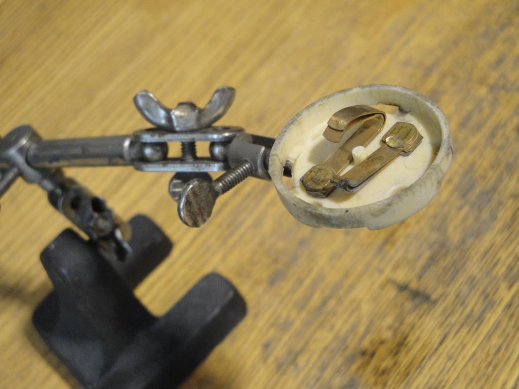

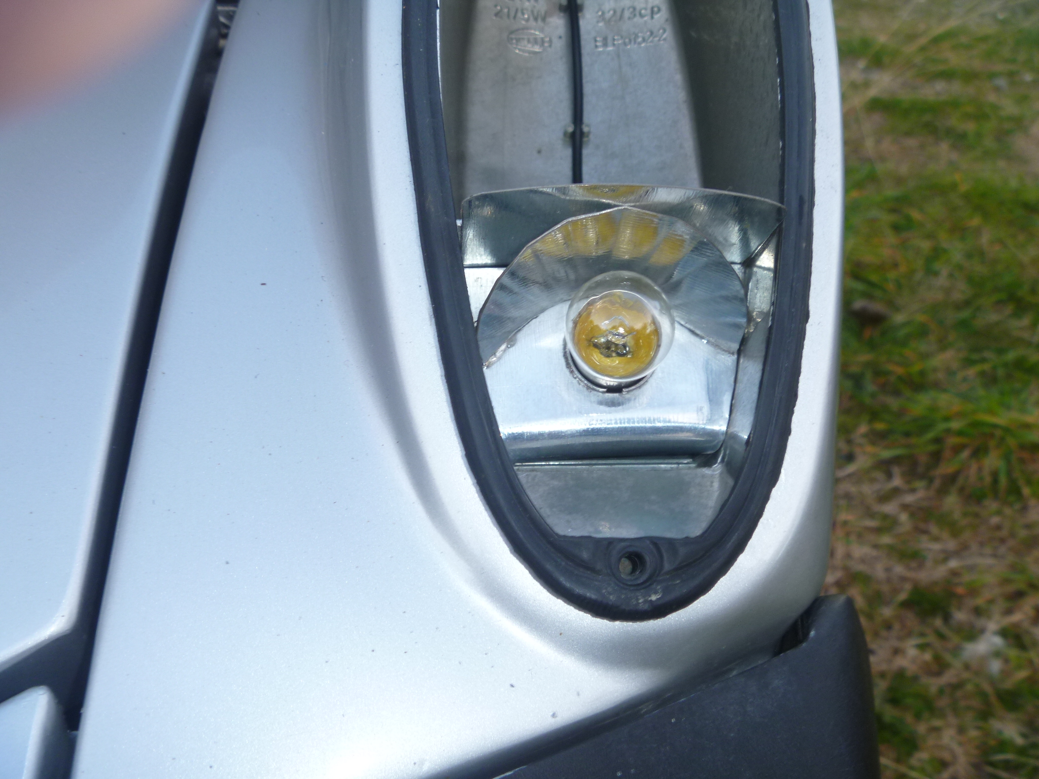

Been real busy sorted out some "must finish jobs",got my pilot driving lights working as mentioned in a separate thread,got my euro front indicator conversion finished with the DIY kit a bought a long time ago from member Martin Baker,had some fitment issues as the reflectors had no holes drilled to locate them,sorted that and soldered/wired up from dual top filament holder down to power lower lamp holder for parklight as per euro spec.
One thing I noticed was because you have to cut off the contacts on the 5 watt side on the top dual filament holder, the lamp has less contact and tends not to contact as well leading to a working not working issue ,replace both lamps and sorted as the lead contacts on both old lamps were worn down.

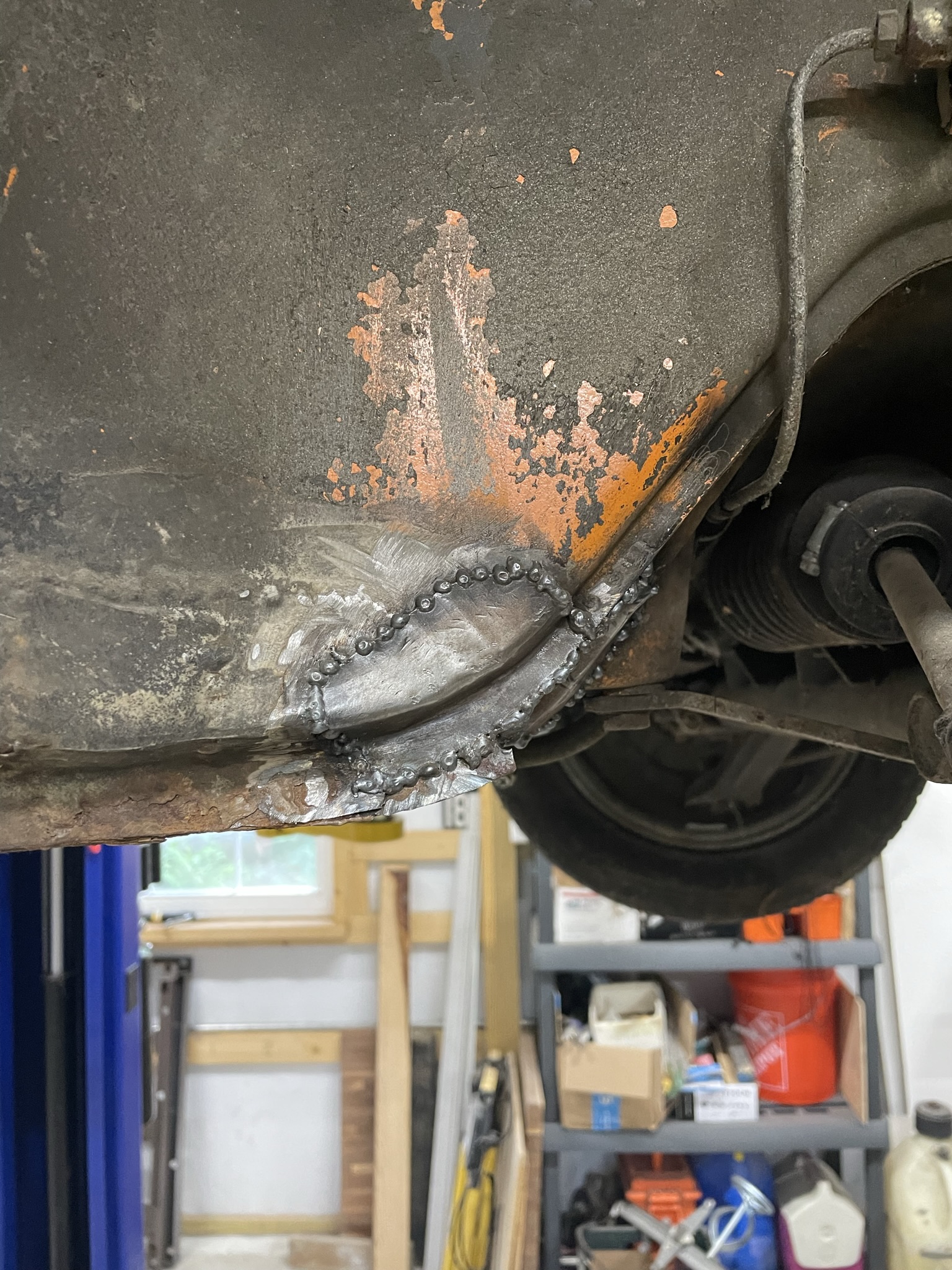

Making rust go away

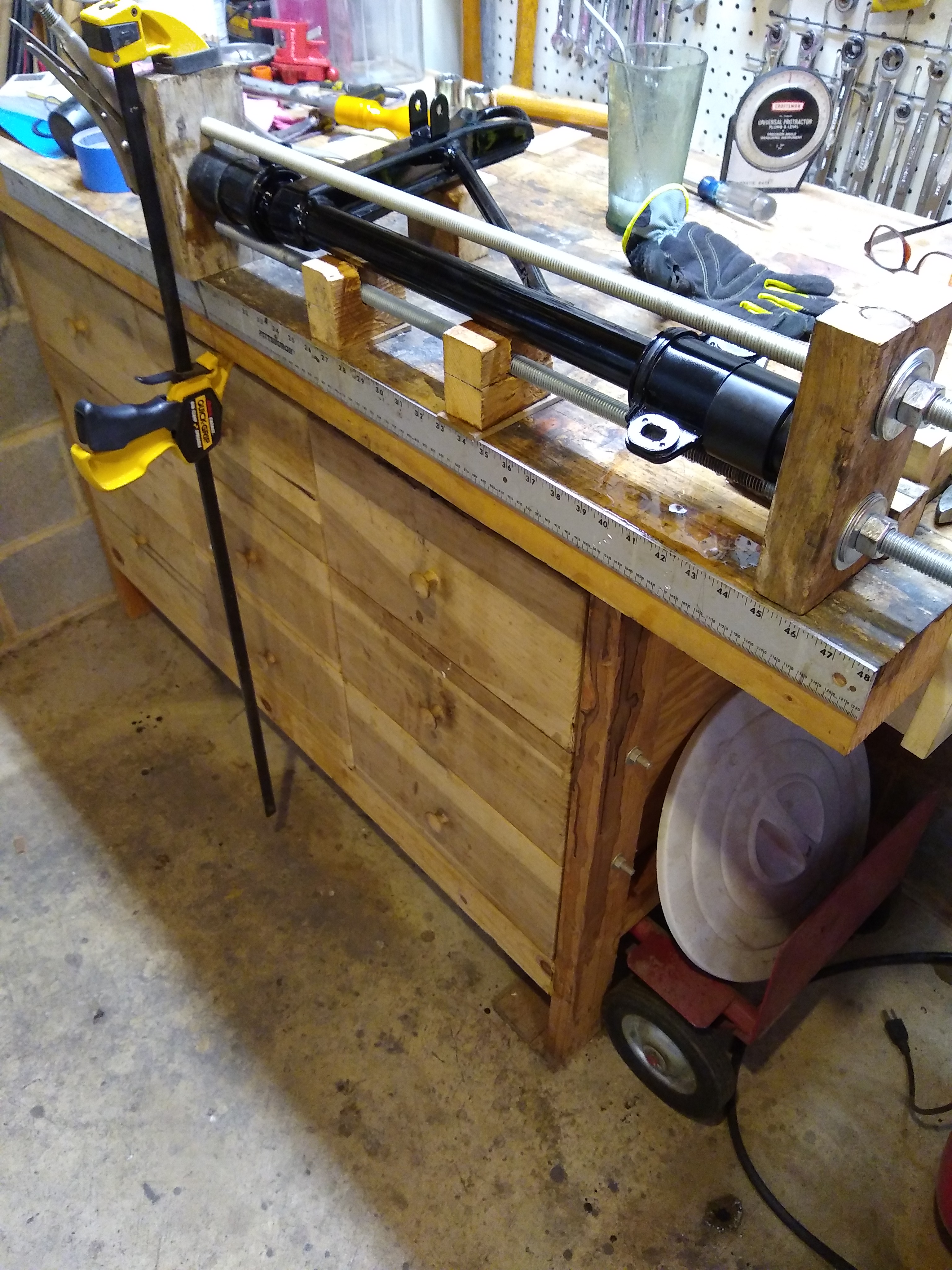

I'm probably an idiot but I built this press to install new bushings in my front control arms.
I know I could have threaded the rod through where the torsion bar goes, but I powder coated the cap in place.
Anyway, it worked.
George

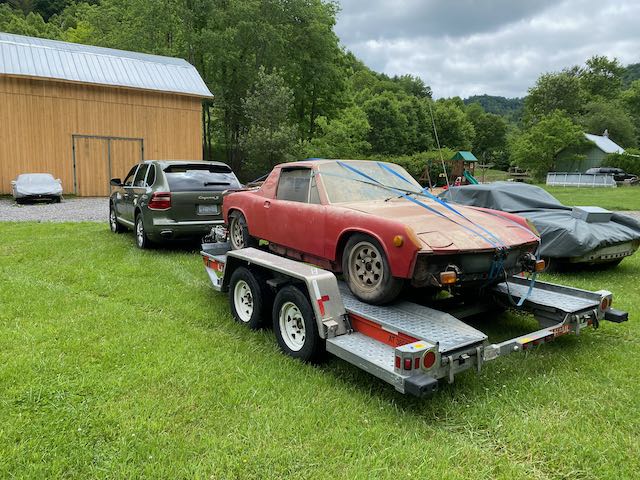

Dragged another one home. No idea what I'm going to do with it. (IMG:style_emoticons/default/blink.gif)

QUOTE(GeorgeKopf @ May 28 2022, 01:50 PM) *
Anyway, it worked.
George
That's some great "engineering" there for sure.
If you're an idiot....you're the smartest, most resourceful around.
Nice job.

QUOTE(Shivers @ May 20 2022, 10:12 AM) *
This is worth a couple of "attaboys" at least.
Nice job on cleaning up that headlight surround.
