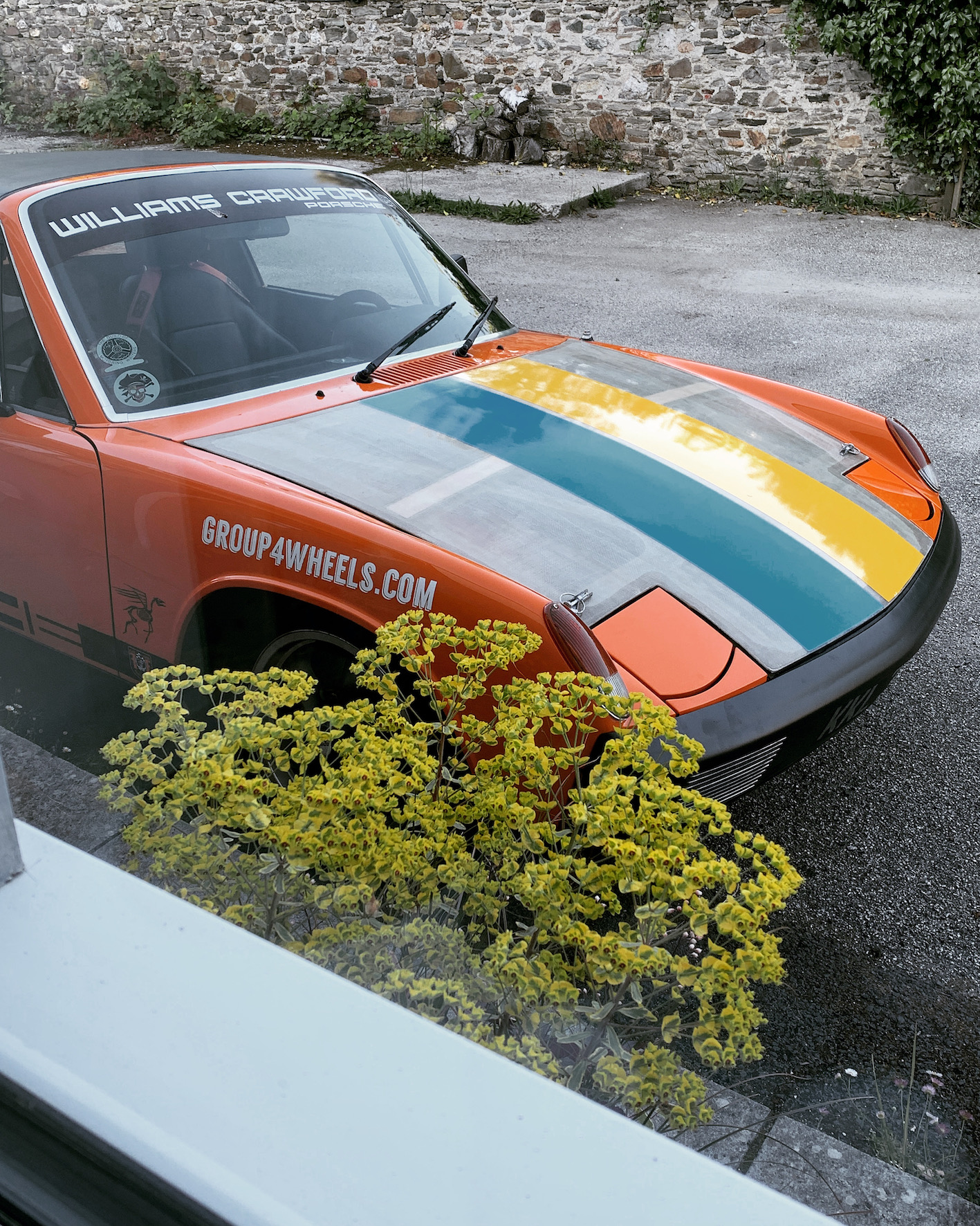

Got my baby home this week, after six months and one week out of action...

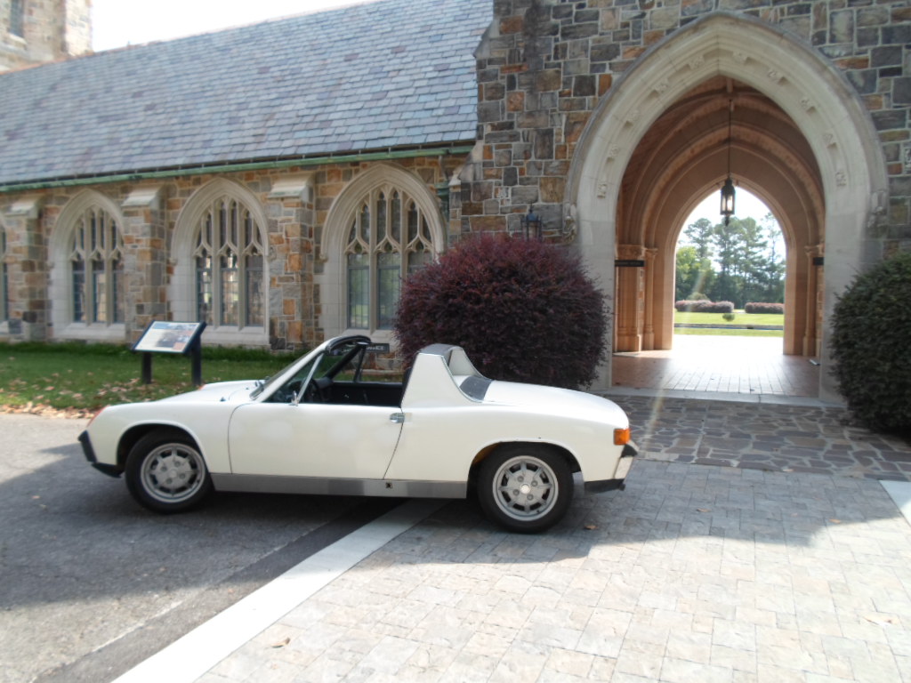

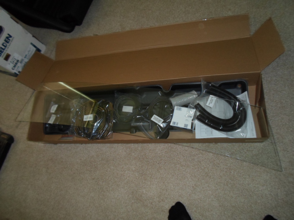

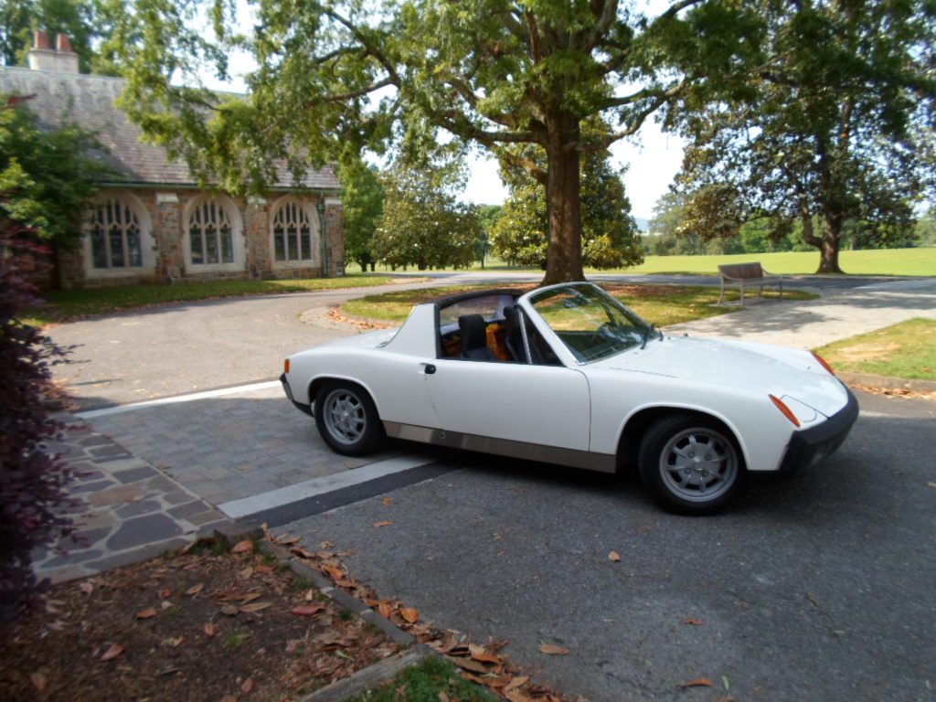

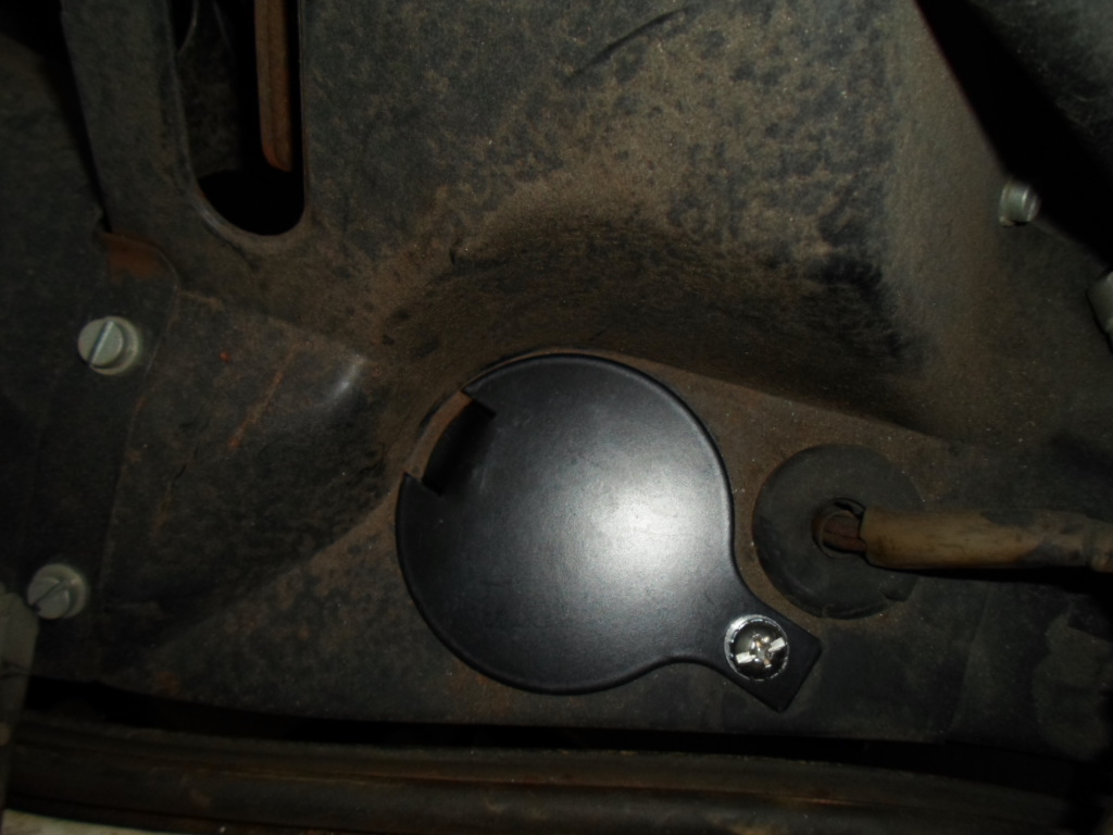

Installed Bruce's J-Tube Block Offs....

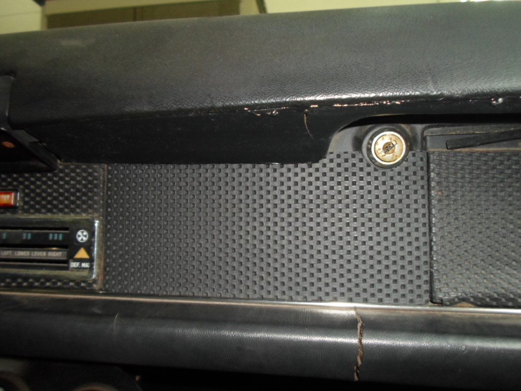

Installed 914 Rubber's Radio Delete..... Still need to replace the material on the Glove Box and Dash Face.... Needs a new knee pad and full dash as well....future projects.
Drove it about 40 miles.... This car used to belong to one of you West Coasters.... that person did a great job on the engine....runs very strong!

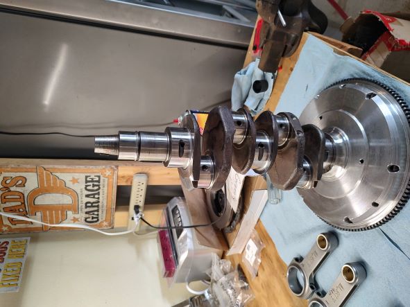

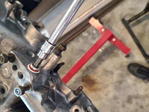

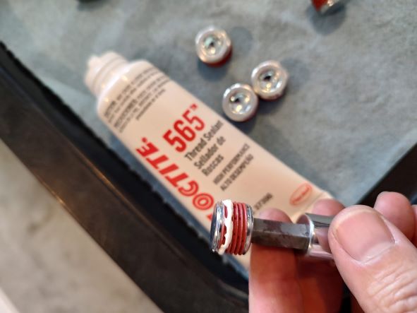

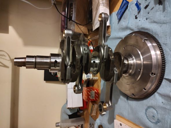

I tackled a couple of the beginning stages of my 2056 rebuild:
Zinc plated NPT plugs with sealant from McMaster Carr for the oil galleries. I added some Loctite 565 for good measure:
The original crank, freshly machined and ready for a new life with a new, lightened flywheel:
And then mated with new H-beam rods with ARP fasteners:

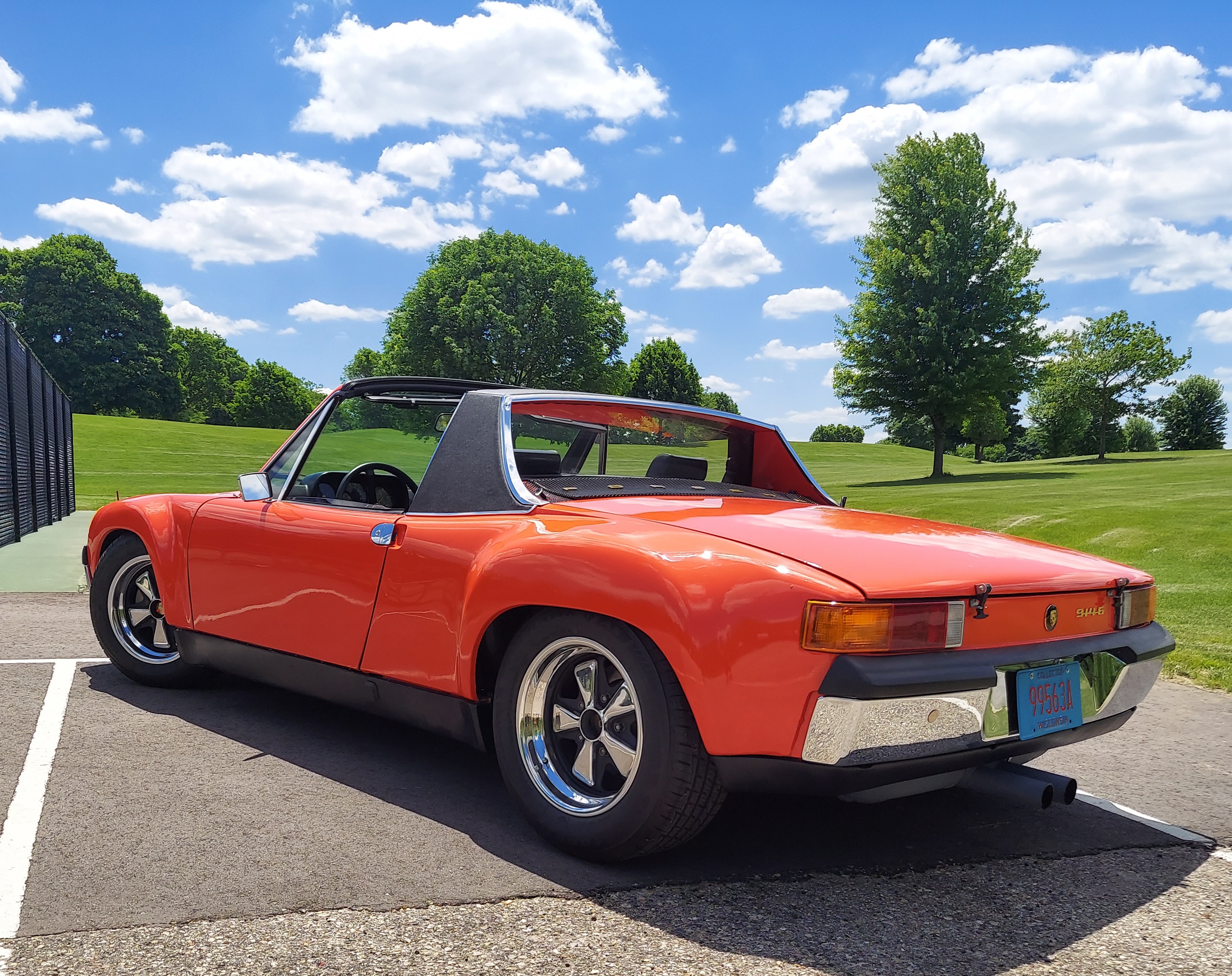

Drained oil again and removed lower valve cover to find a leak. It was another rocker shaft the migrated in the bore. Super frustrating. Not sure why it is doing this. I am not a novice on the 911 based engines but wtf.
Picture is of the day prior. Attached Image

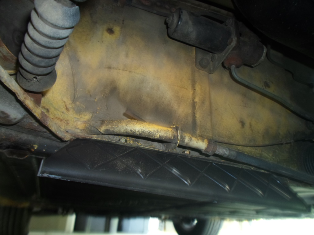

Added 914 Rubber's air deflectors to underside. I'm not hopeful that this will reduce oil temps, but I guess they can't hurt.

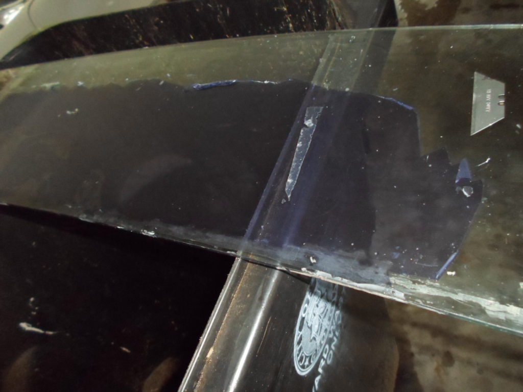

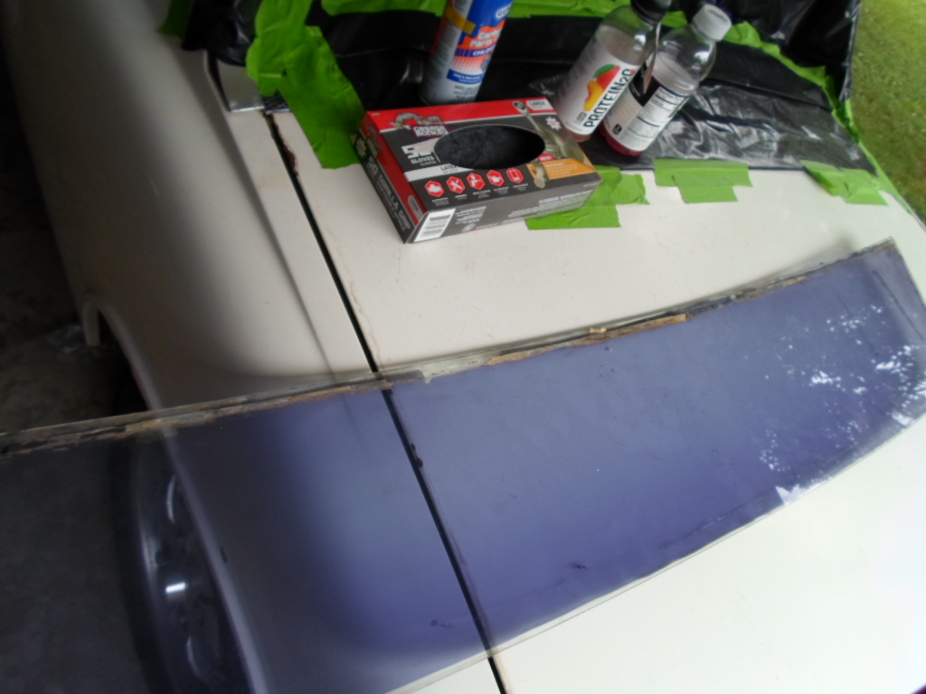

Removed back glass.....it had some dark tint on it, along with a bunch of old caulk that needed removal.
This was the toughest back glass I've ever cleaned off......the tint would not peel... mostly had to use the razor blade
A couple hours and a ton of Windex and Carb cleaner later....
Should install later this week.

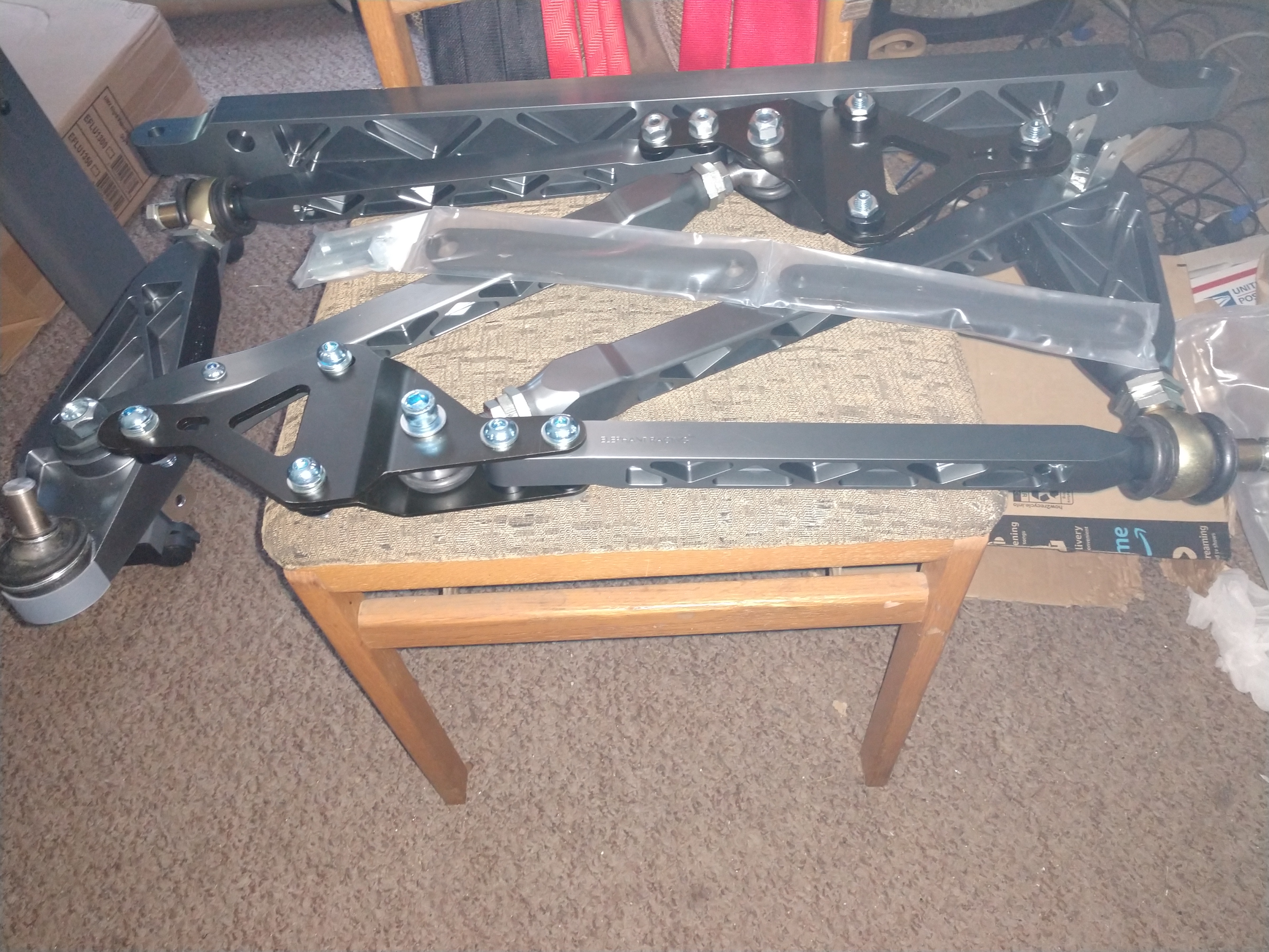

I took a picture of the new front suspension from Elephant Racing,
Elephant sure makes some nice stuff,

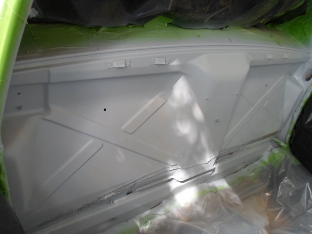

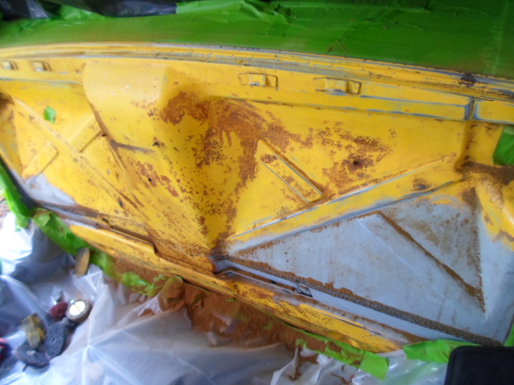

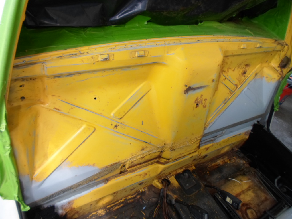

Sanded off a bunch of what I think is spray on adhesive...and hit some bad spots so that when I install the window it seals well. Looks like there was already some patch work done on the firewall, so I went ahead and put down a first coat of primer after lightly sanding.
Hopefully tomorrow I'll finish the priming and rattle can some yellow on there.

@mb911 your car looks stunning!

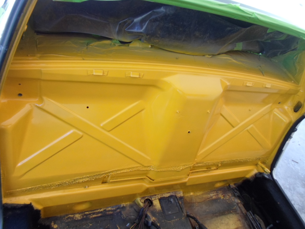

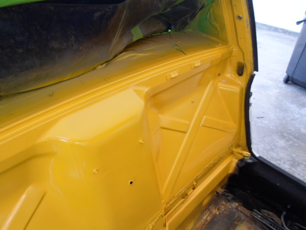

Hit it with 3 coats of Rust-Oleum 2X Ultra Cover "Golden Sunset" ...I know....it's rattle can, but it's all gonna be hidden behind the back pad....so what the hell.

Thank you. It is definitely a driver car not a show car but it is very nice for a garage paint job.

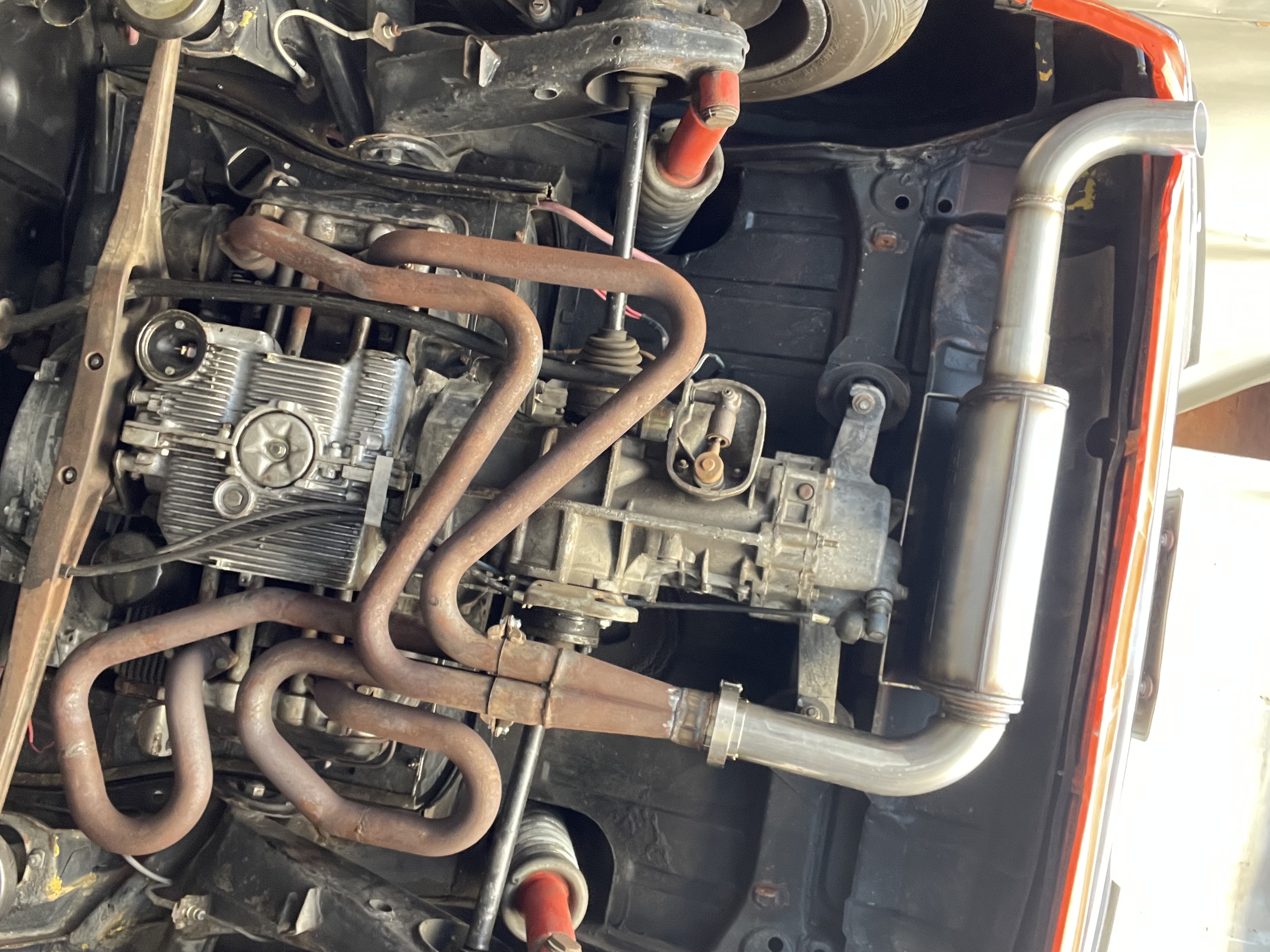

Got rid of the old collapsed turbo muffler and 3 bolt flange on the merge collector. I went 2.5” instead of 2.25” stainless with a flanged V band coupler. The muffler is a free flow packed flowmaster FlowFX. I also bent up some door bars for my “cage” that allow for easy access since this is predominantly a street car
Does anyone recognize the header? It’s pretty bitchin. I’m debating on recreating it in stainless or sending this one out to have blasted and coated.
