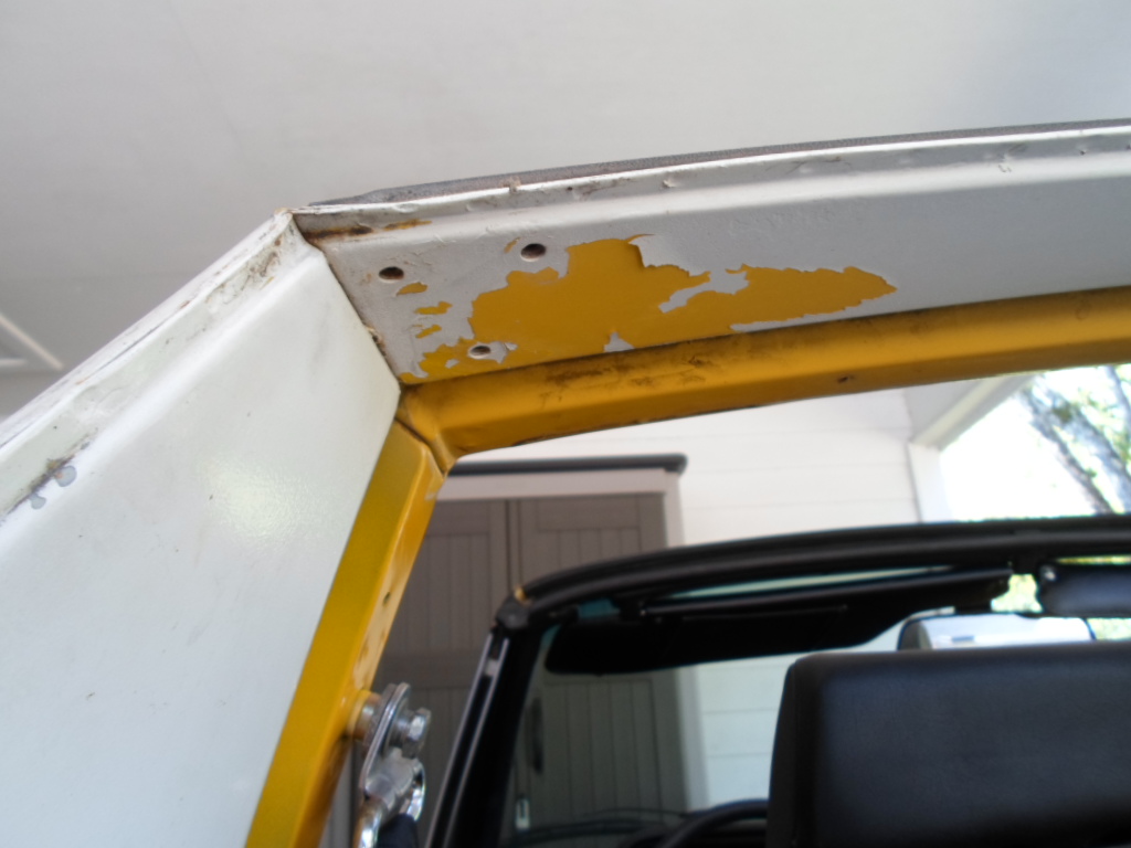

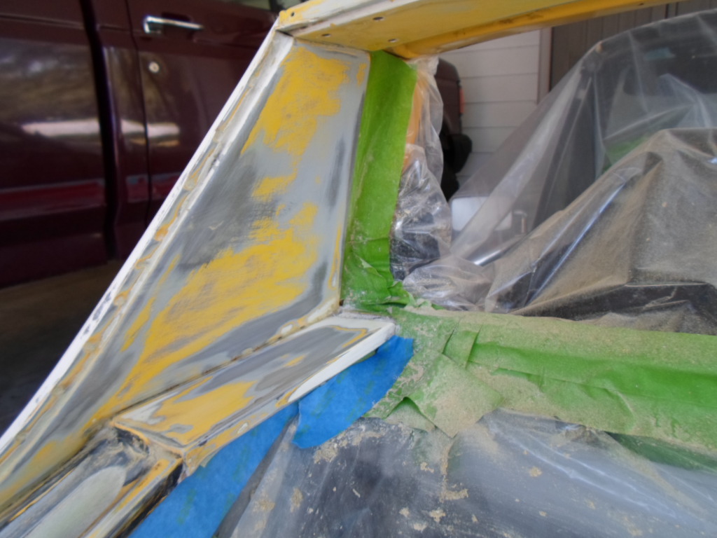

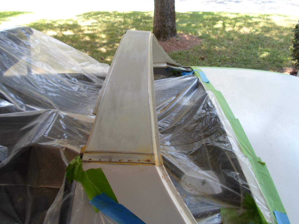

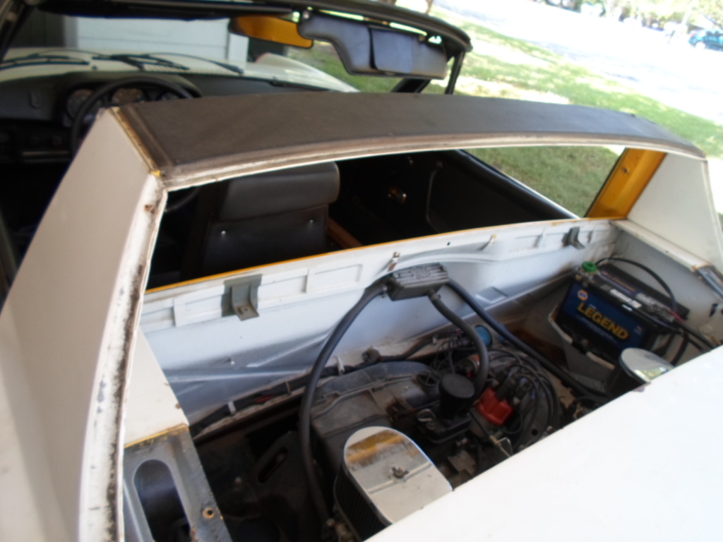

Removed the sail panel trim and old roll bar vinyl. Started sanding the roll bar and inner sail panels so I can get them painted before I install the new vinyl, roll bar pad, and GT Lid.

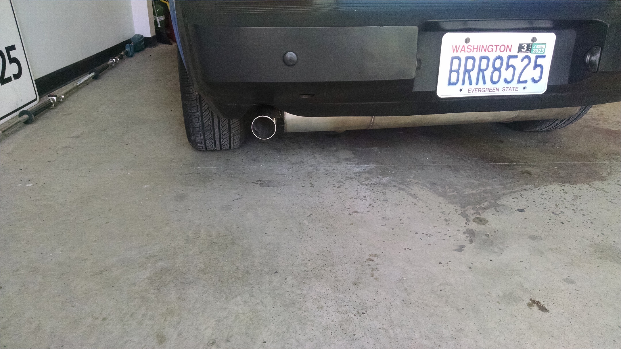

Was able to score one of Ben's early "quiet" 914-6 mufflers, but the tailpipe was oriented for a valance without cutout:

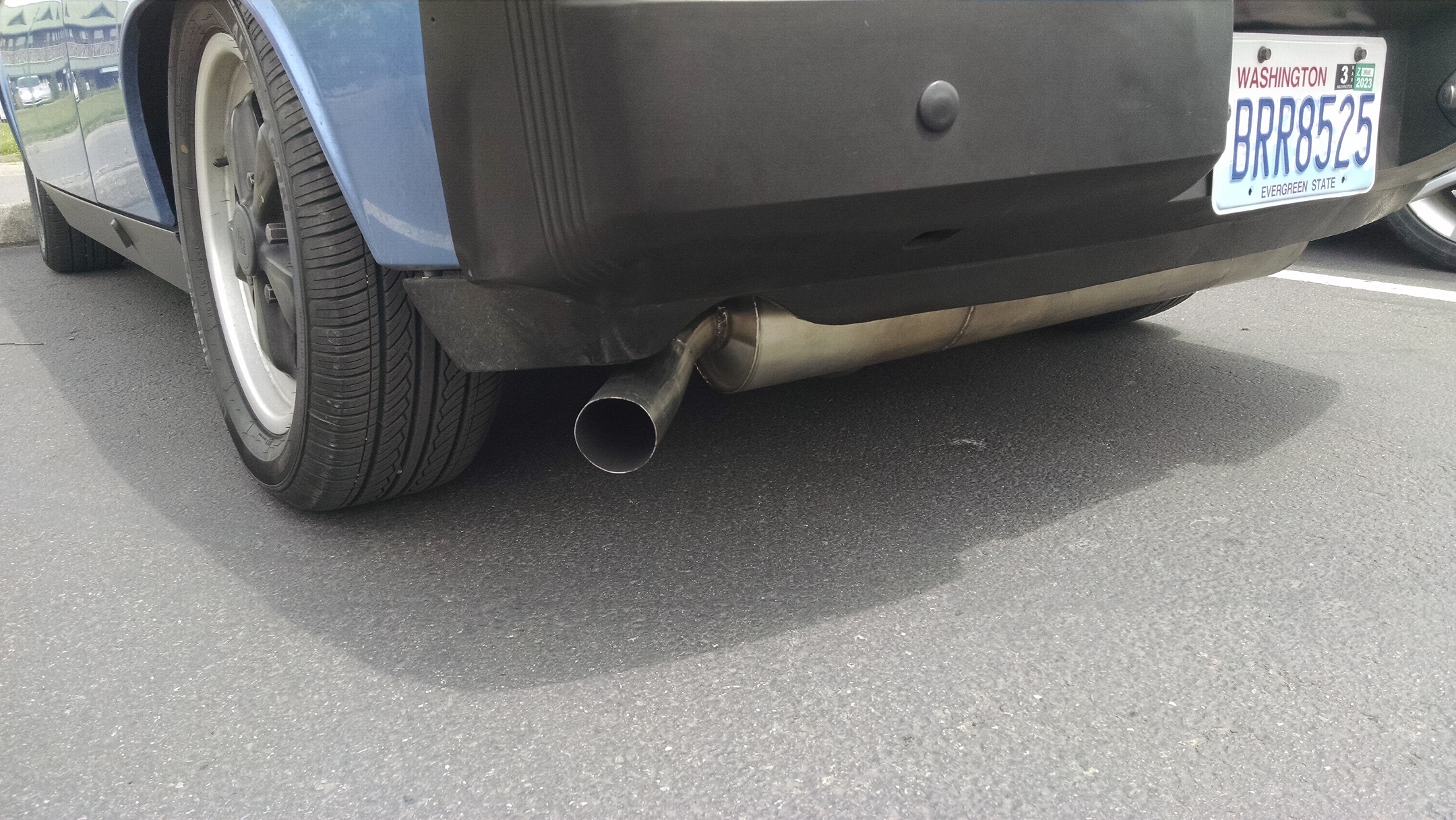

Ordered up a 90bend 2.5 SS pipe, cut and welded on. Used my little flux core welder with SS wire. It did okay, my welds mostly cleaned up. Can't see them anyway. I didn't want to buy wire and bottle for my regular Mig welder so the flux core seemed the best option.

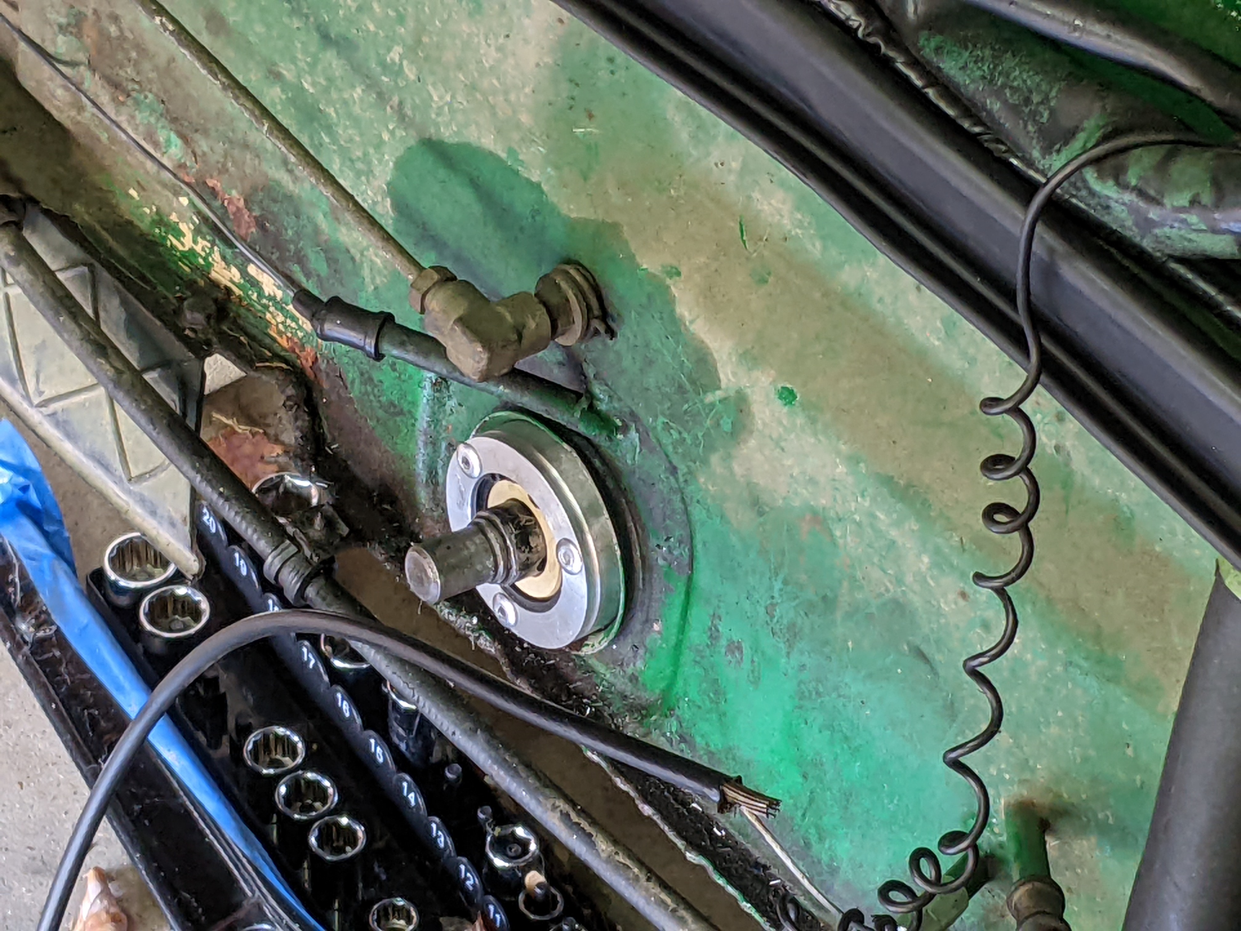

I've been trying to get a car started that hasn't run in 7 years. First found the fuel pump seized. Managed to get the motor unstuck, then it pumped fuel out every orifice. Must not have been a seal that wasn't shot.
Installed an Airtex E8445 pump, but twisted off one of the studs when connecting the wiring to the pump. The screw never got anywhere close to tight, so I have no idea what kind of playdough the brass studs were made with. Really disappointing. I was able to get the pump to run long enough to verify I had the pressure and return lines reversed up top.
If it's not one thing, it's another...

I have been running airtex pumps for years with no issues.
The airtex pump has different size studs on it. Did you use the right nut for the stud size?

You could have used your reg 75/25 mix and SS wire on the tailpipe. Good job. That looks much better with the tailpipe in the correct spot. I just did that myself but it was with the old crusty steel. (IMG:style_emoticons/default/beerchug.gif)

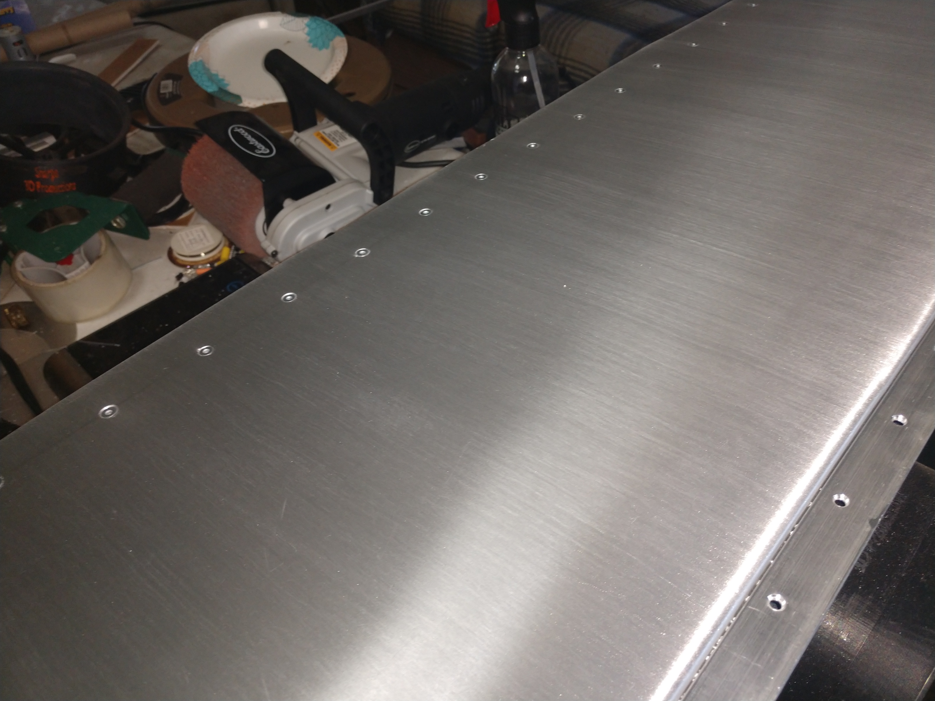

Now that the box is almost done I went over the top again to clean up the scratches on it. It turned out really well. The tool I used is in the background.
Then I did some work on the electrical of the fan box. Getting ready to run wires to the switches on the dash.

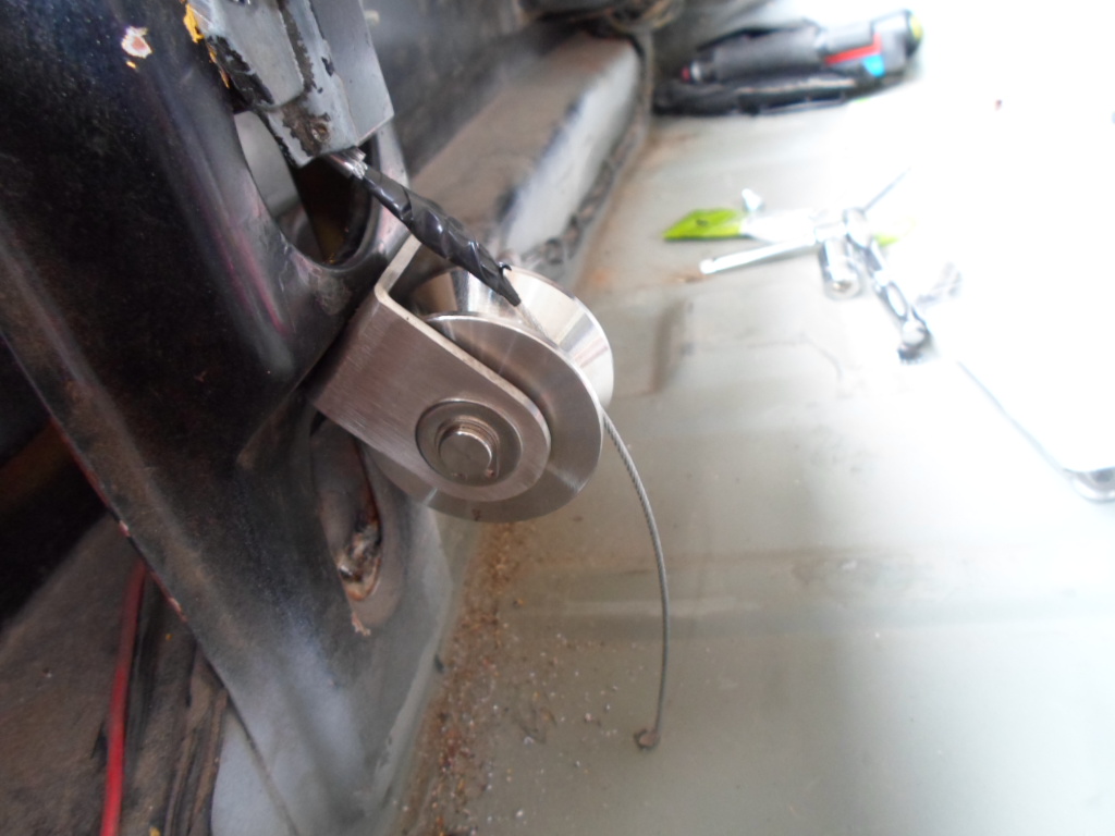

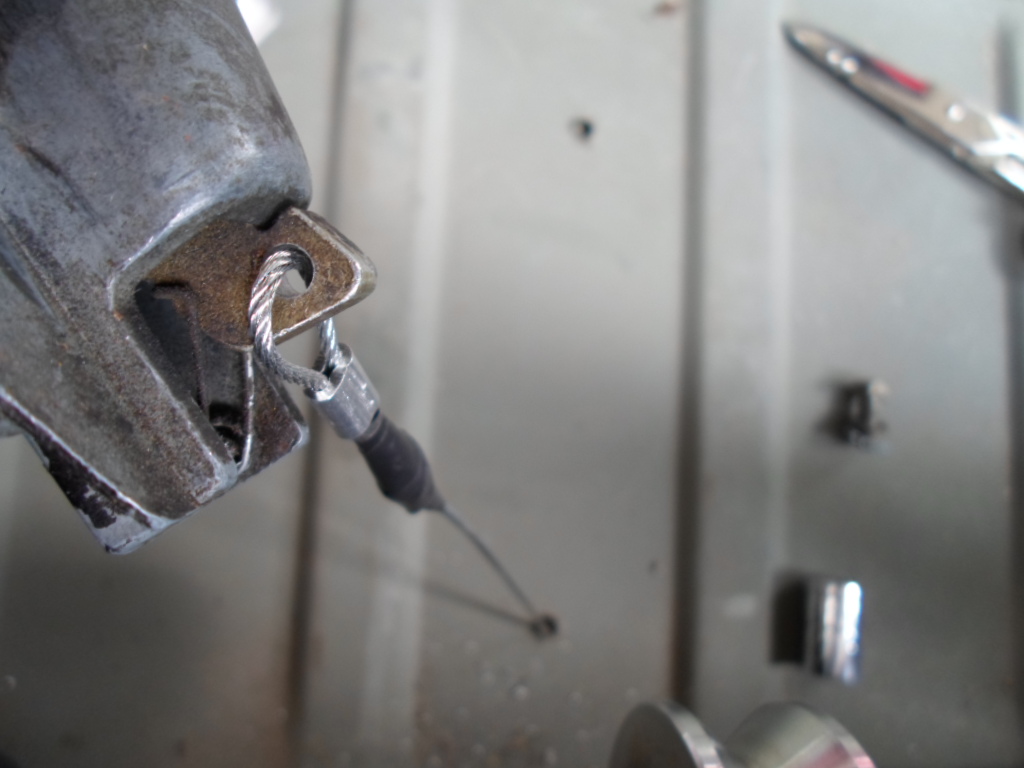

Finished mocking up my rear trunk latch "manual pull". I have an inoperable solenoid and a Porsche Reflector where the trunk lock should be. I don't want to fool with a solenoid, and wanted to make it as easy and full-proof as possible.
I need to clean it up a bit, and redo the ferrules, get rid of the black tape, etc., but it works great.

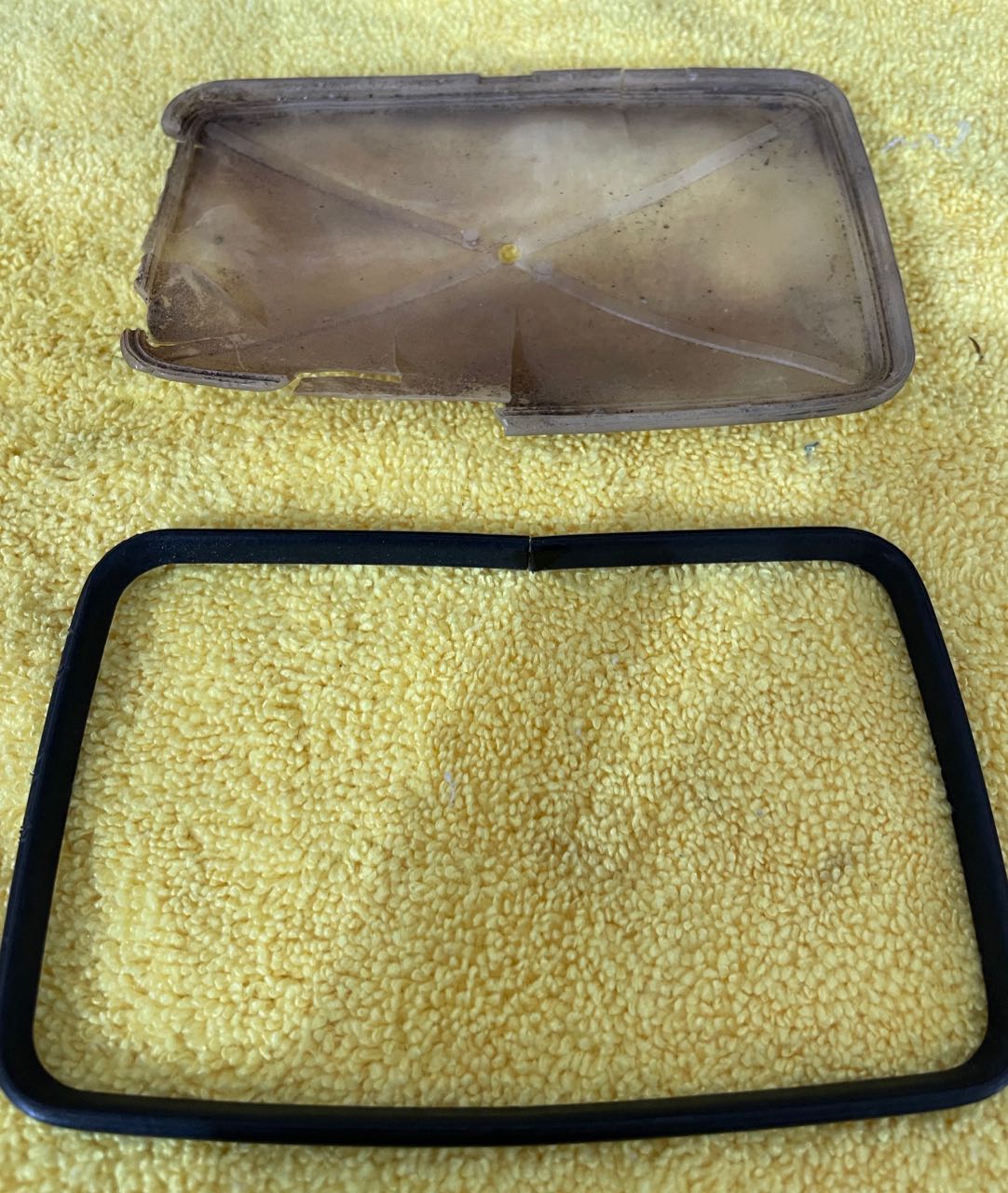

My driver's side mirror was loose and images blurred when driving. So I ordered the 914 Rubber kit and replaced both pieces and the mirror is nice now. Here is a pic of what was in there.

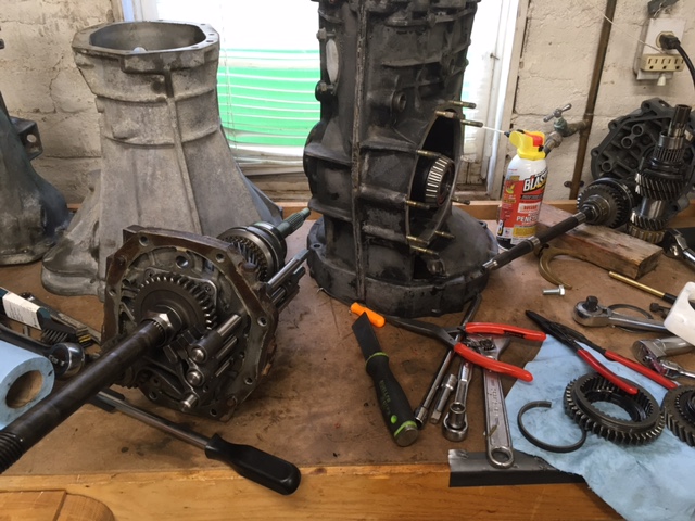

I'm both working on the 914 and not working on it at the same time.
I'm rebuilding the transaxle on the 914 and the transmission for my son's 280z. I'm pretty sure I can't mix up the parts.

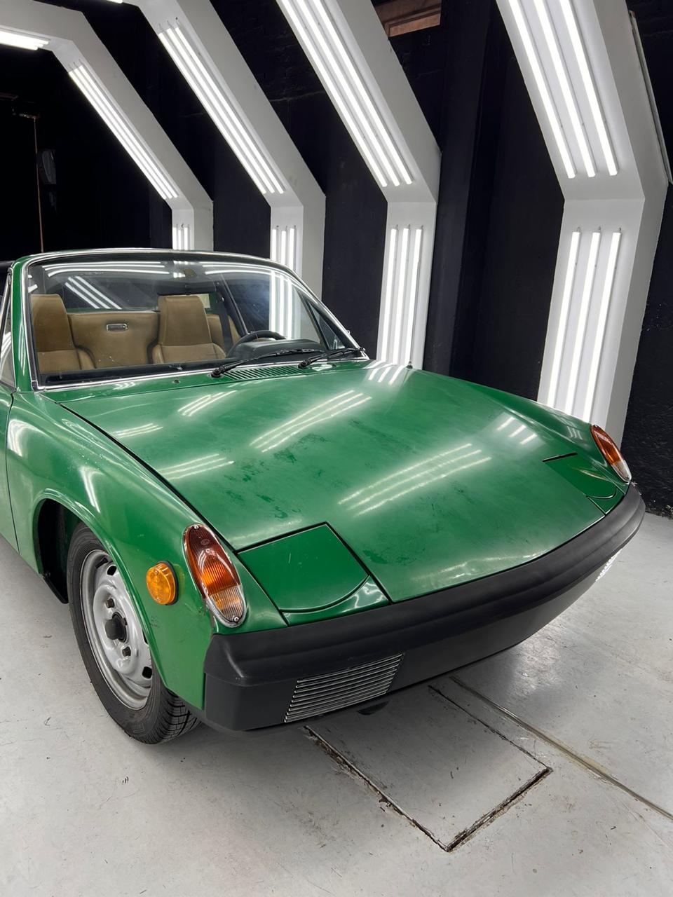

Off to paint correction and mostly interior cleanup. See you in 8 days…

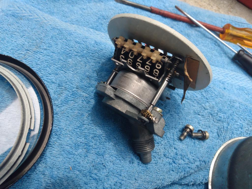

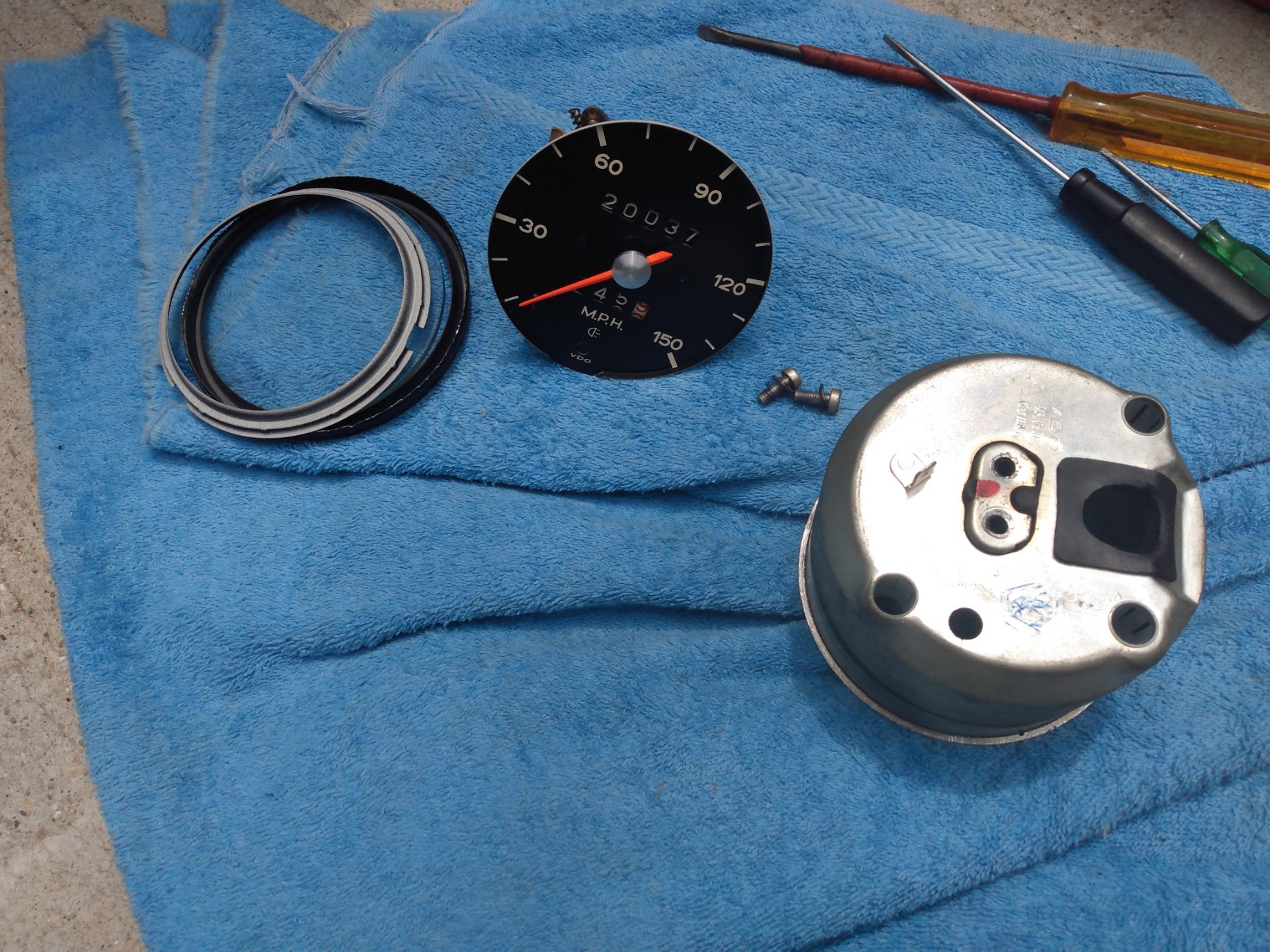

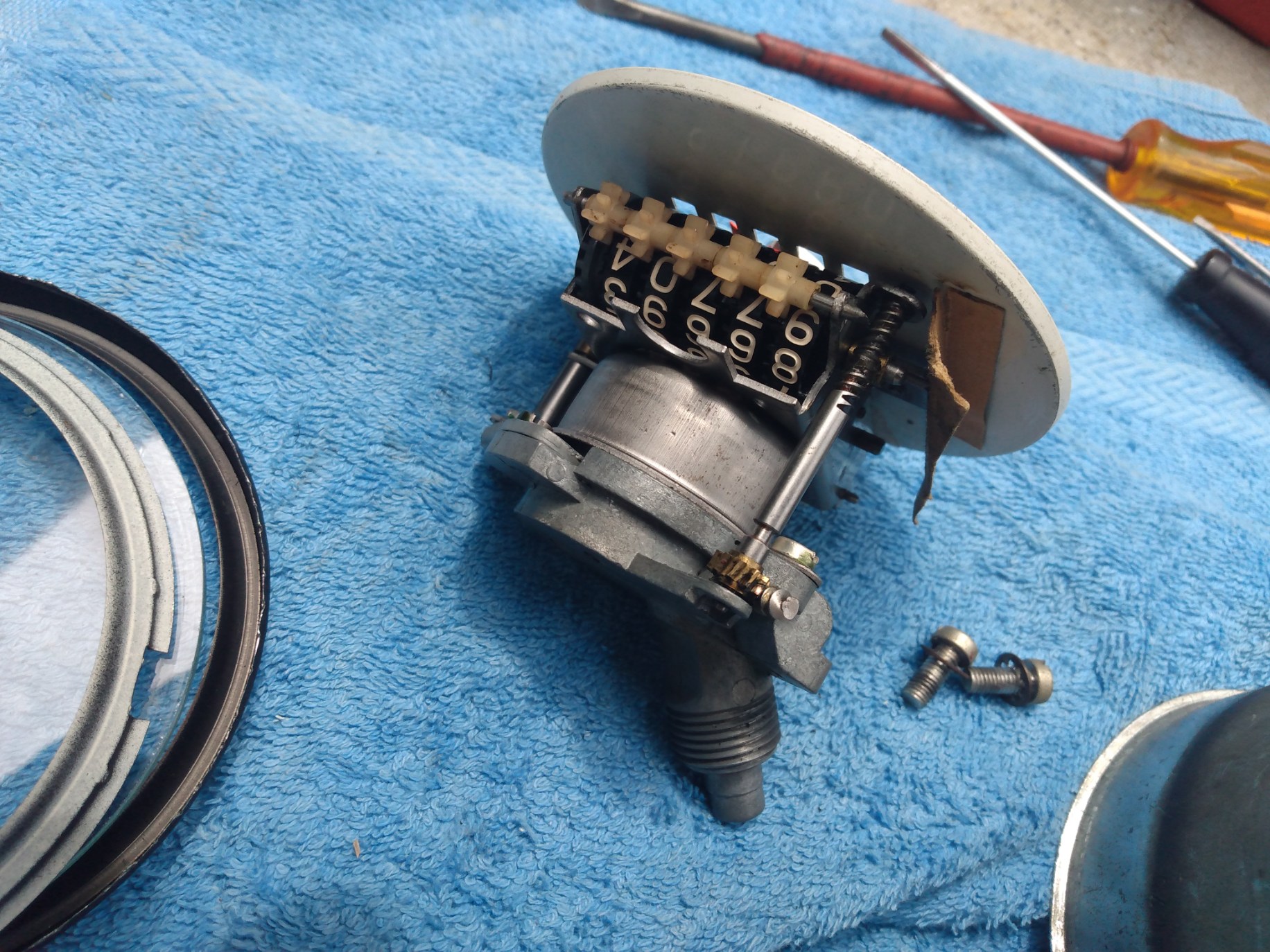

A little odometer repair. Hung up rolling from (1)19999 to (1)20000
