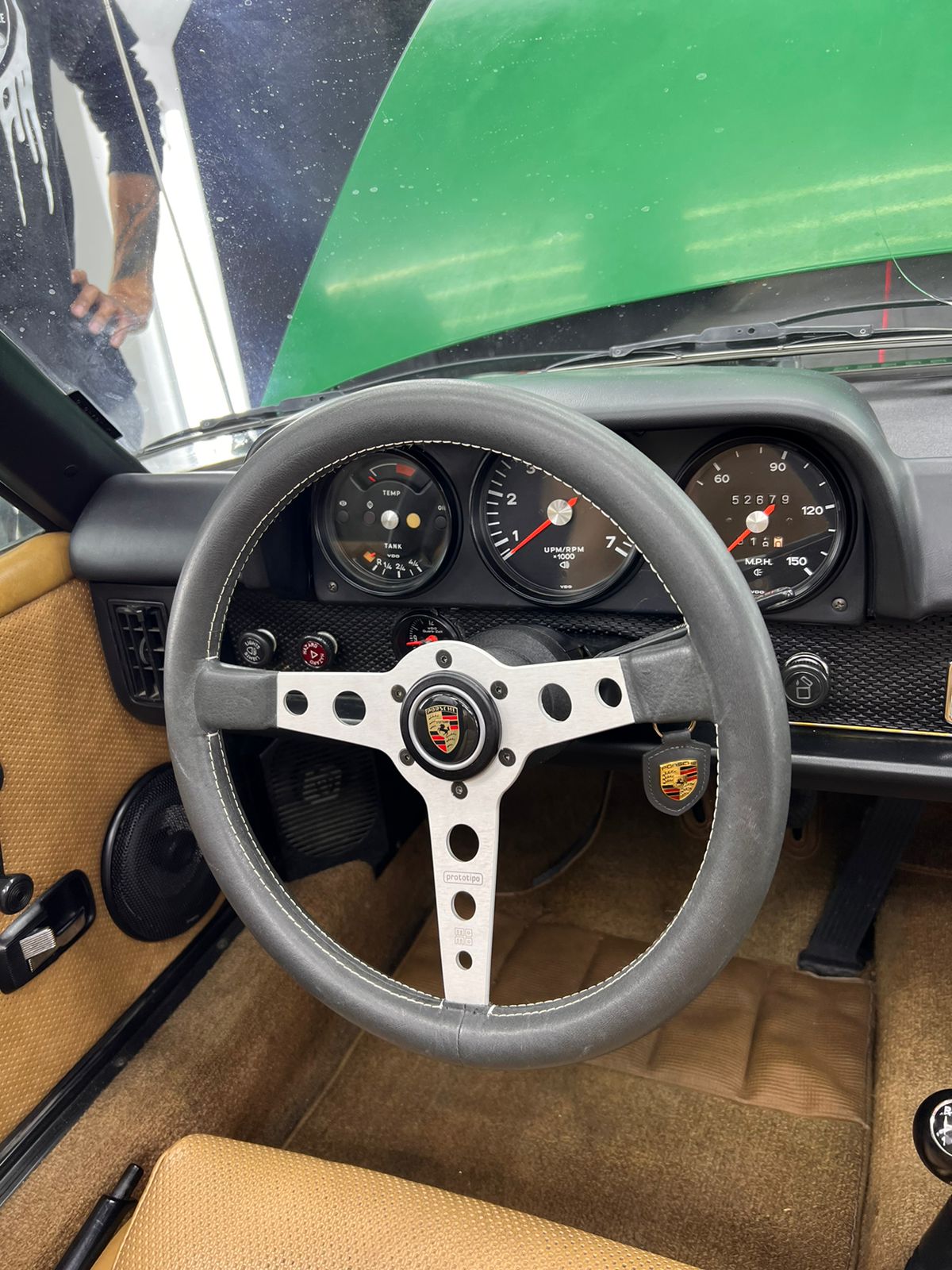

QUOTE(cali914 @ Oct 8 2022, 09:37 PM) *
my new dash
@Cali914 - Harry, that looks GREAT! Can't wait to see this in person. Any idea when it'll be on the road?

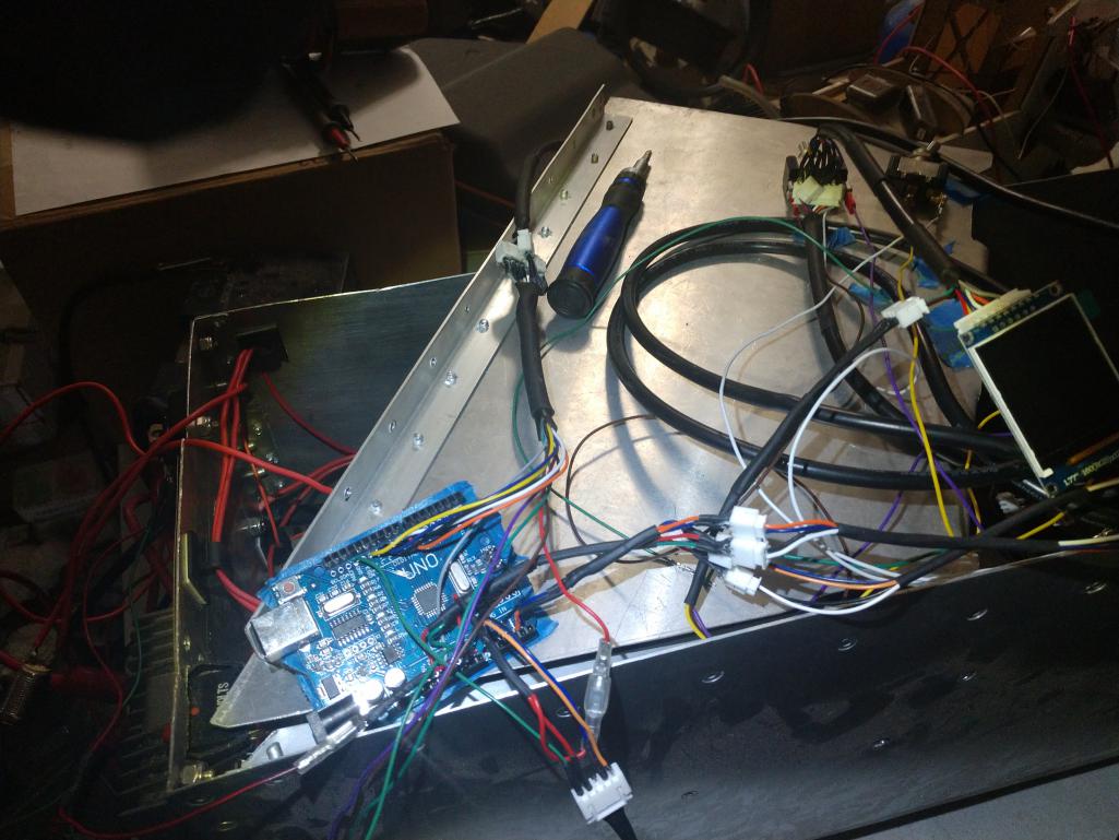

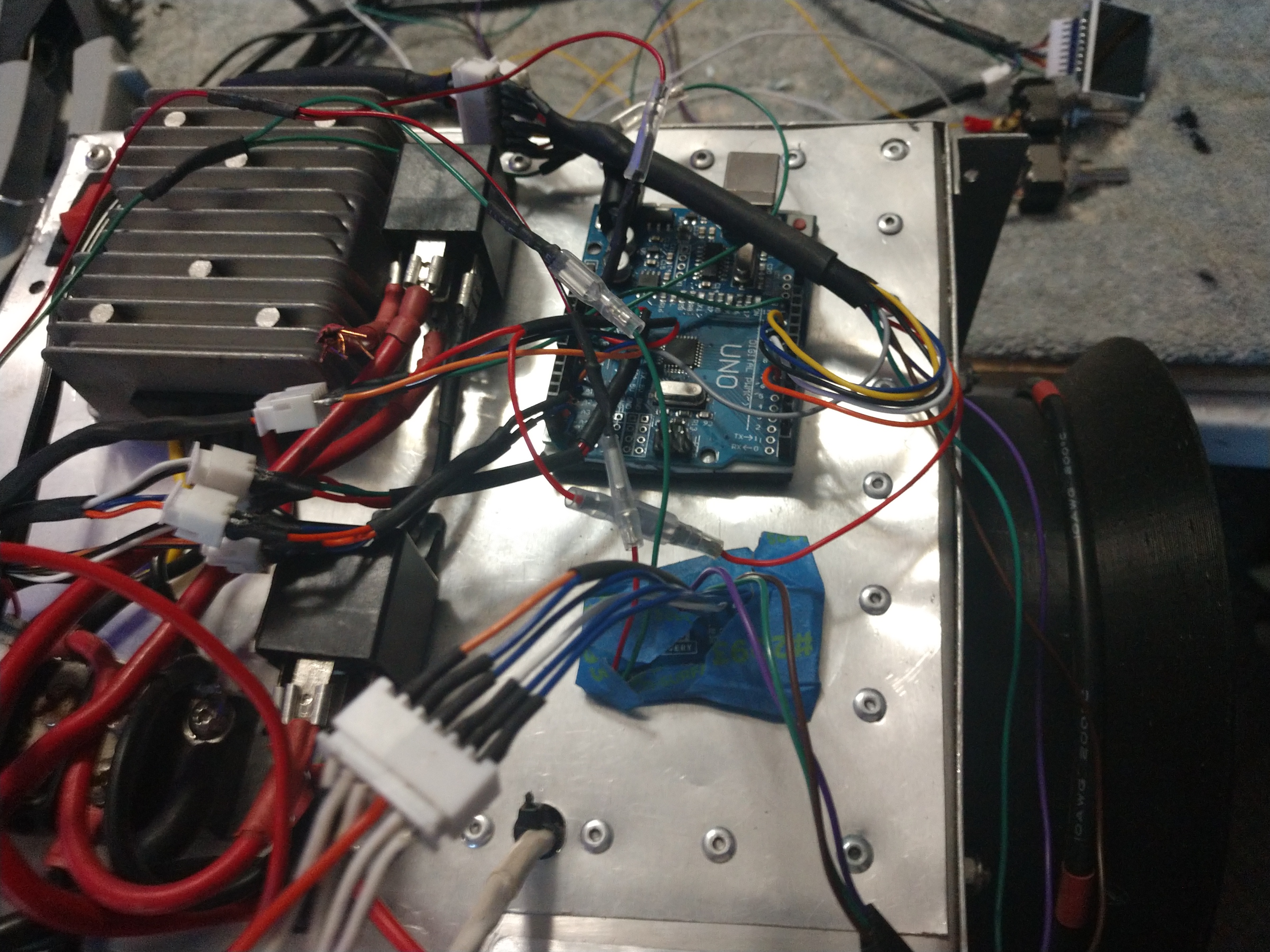

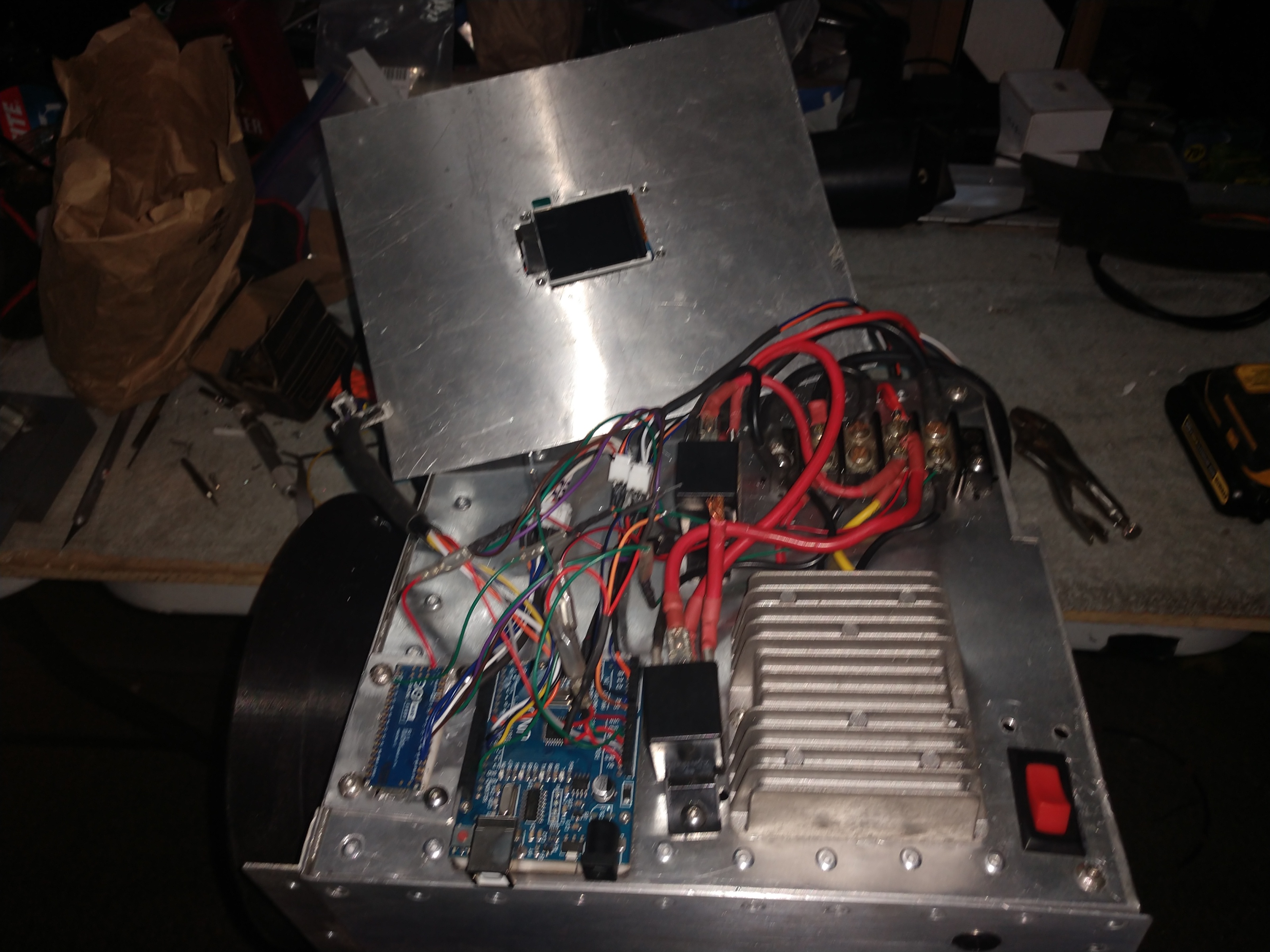

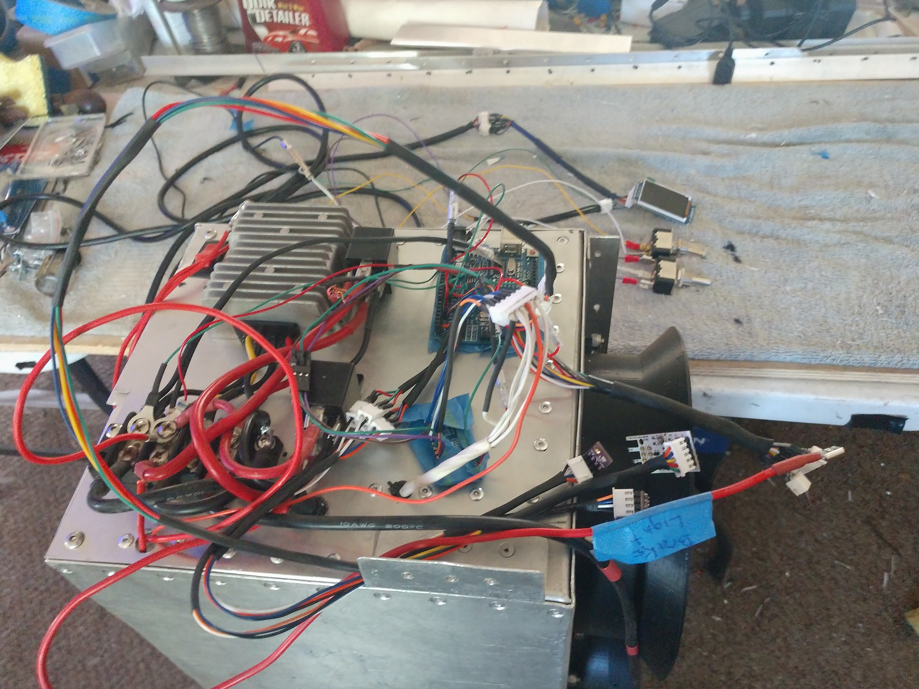

The Arduino board is here, I watched Josh assemble the hole thing and test the circuits except for the flap. The motors sound bitchen. Lots of work in front of me but it's all installation and will be very gratifying.
The motors roar. I got an air flow meter, 2 biometric pressure sensors with temperature and humidity. The Arduino board also controls the Gurney Flap It puts the flap in full up during breaking.

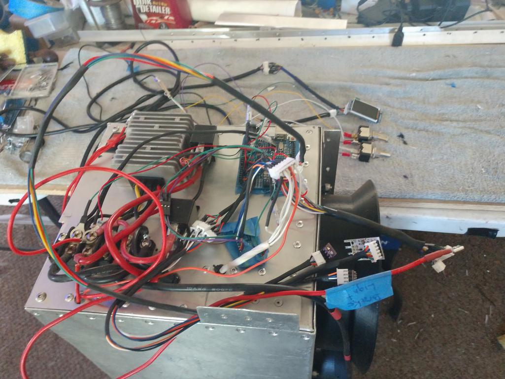

Going Digital. If I get everything working it will be posted here first. I think that this thread is responsible for over half of the over 42,000 viewers on my build thread. I almost feel like I am bogarting this thread...
I'm moving stuff back to the car, the wing is in place although I know it has to come back out for cleaning and centering of the servo.

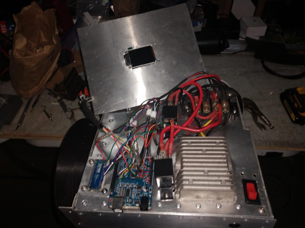

Getting some more stuff done. Now I know where everything goes.

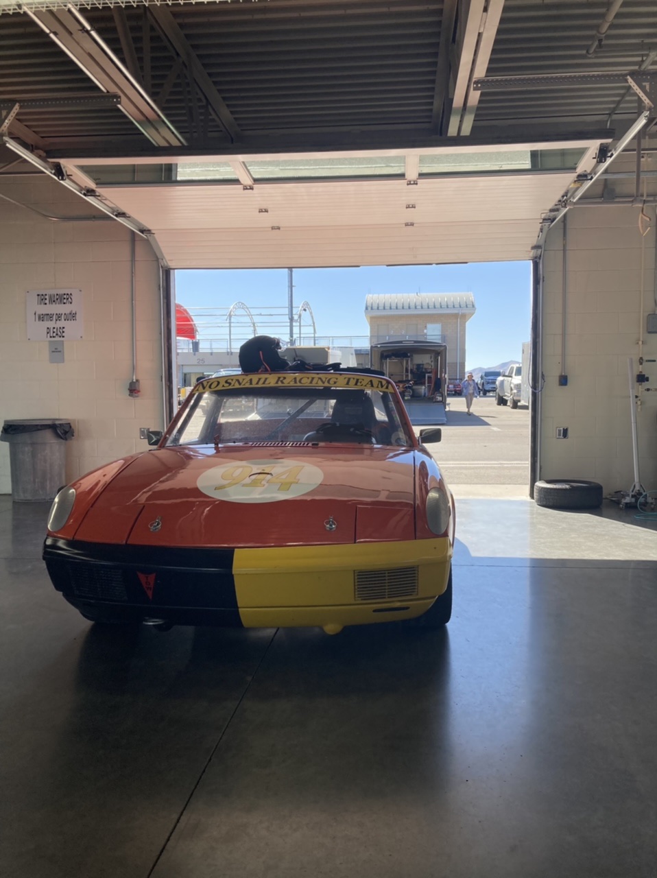

Raced it for three days in salt lake

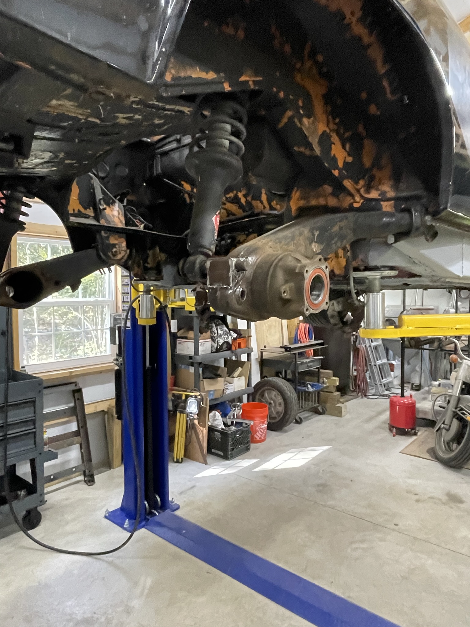

Got #3 on the lift, building a new 2056 (with big valve heads, Elgin cam and twin Webers) for it and going after a bit of decay in the hell hole area. With 4 in the stable I have my work cut out.
Plan is one for each grandchild

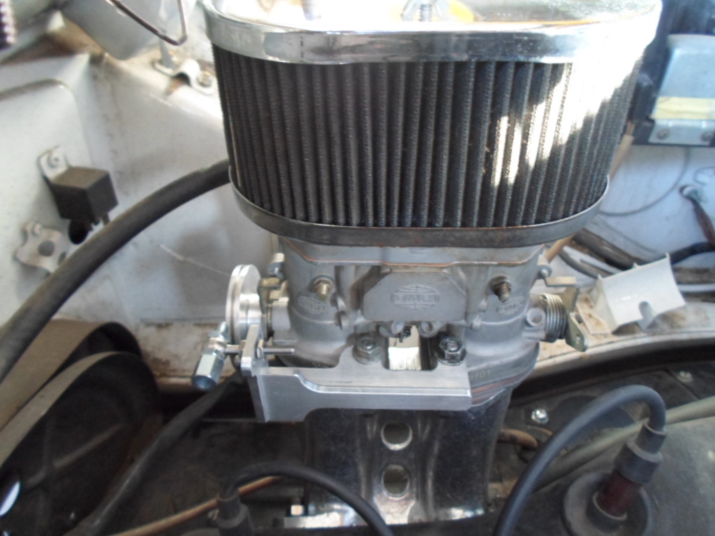

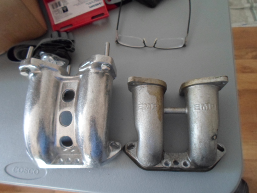

Got my new taller intakes from CB Performance and installed one of them. This is going to offer about an inch of extra clearance for the new carb linkage. The other side will tell the tale.

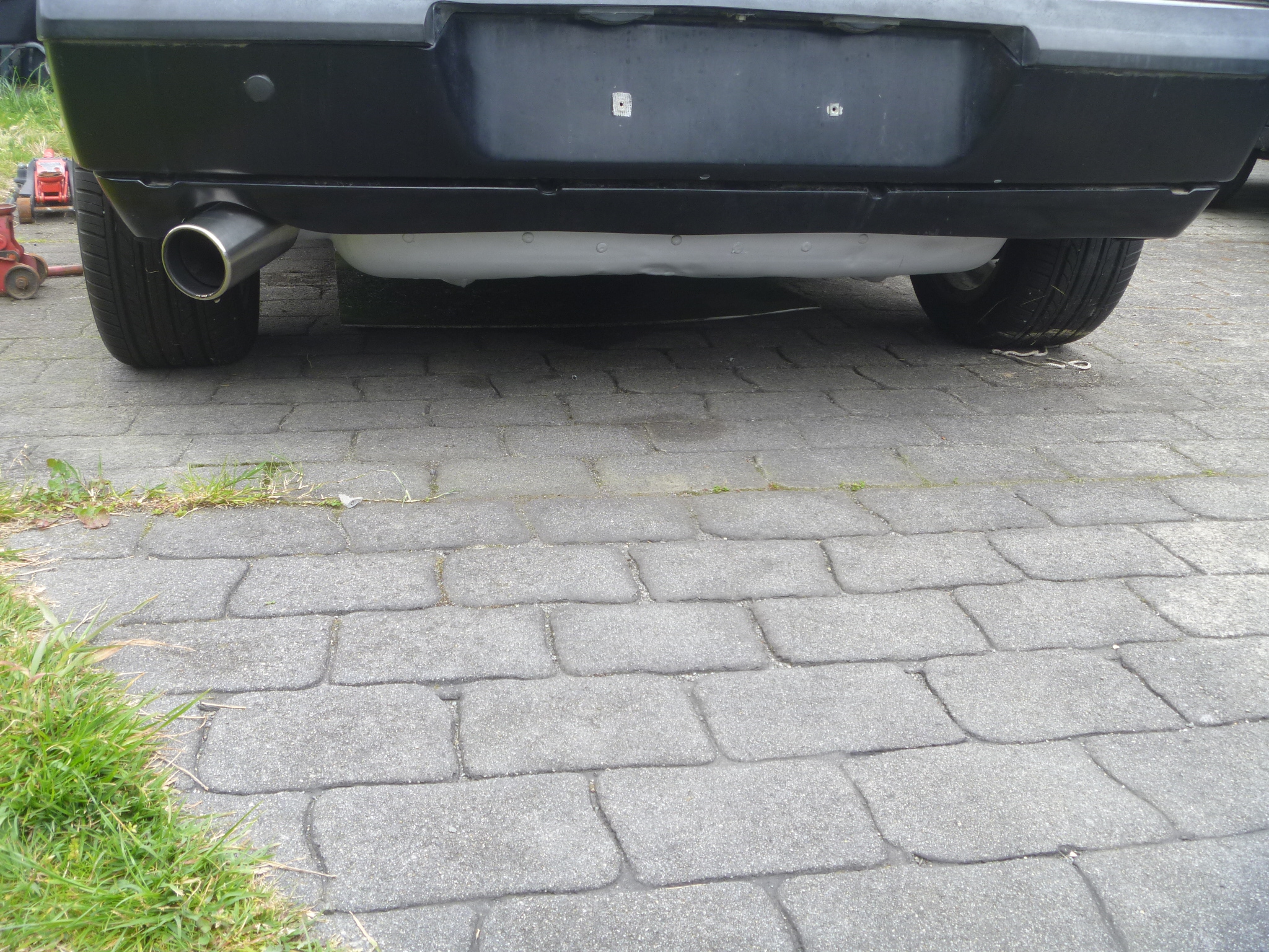

Been working on the rear of the car namely sorting tailight leak and fixing the resulting light surface rust as the OP's painters touch up was less that suitable in the trunk,now topcoated after using high zinc primer and POR15 for the worst area's which luckily were little.
Constantly looking @ my rusty muffler that is a bit of a dented mess underneath as came from a 911 but very sound otherwise,when fitted before first start after the engine conversion I give it a rough coat of zinc weld thru primer,rather surprised how long most of it lasted.
Selected Rust-oleum 2000F rated high temp exhaust paint for new coating but need to get all the surface rust off and that's not a quick job (IMG:style_emoticons/default/dry.gif) .
After lots of prep work got the muffler clean enough to apply new high temp paint and happy even it is flat silver and not grey because that is all I could buy (IMG:style_emoticons/default/dry.gif) .
Reset tail pipe for more even clearance on the rear valance before baking the whole thing @ 150C twice ,will run it up final "cook" as now installed.

Very nice- your tailpipe looks perfect. (IMG:style_emoticons/default/beerchug.gif)
