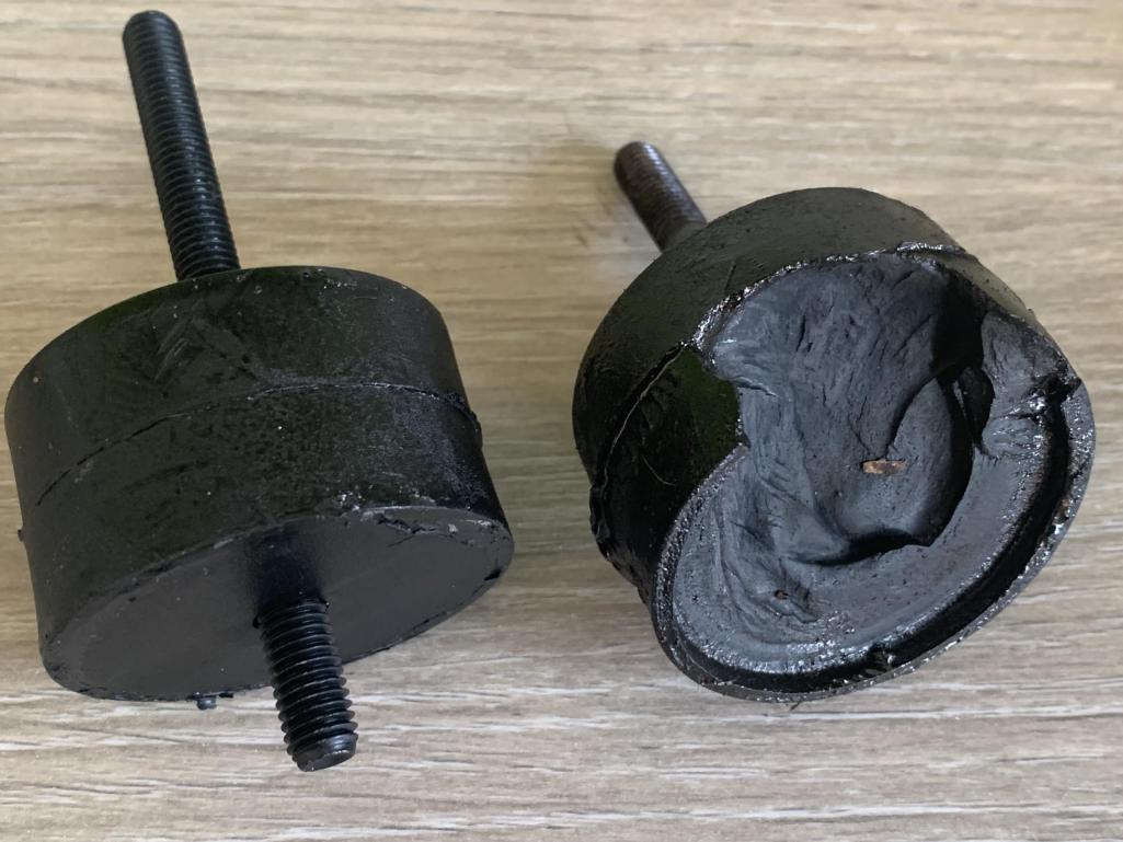

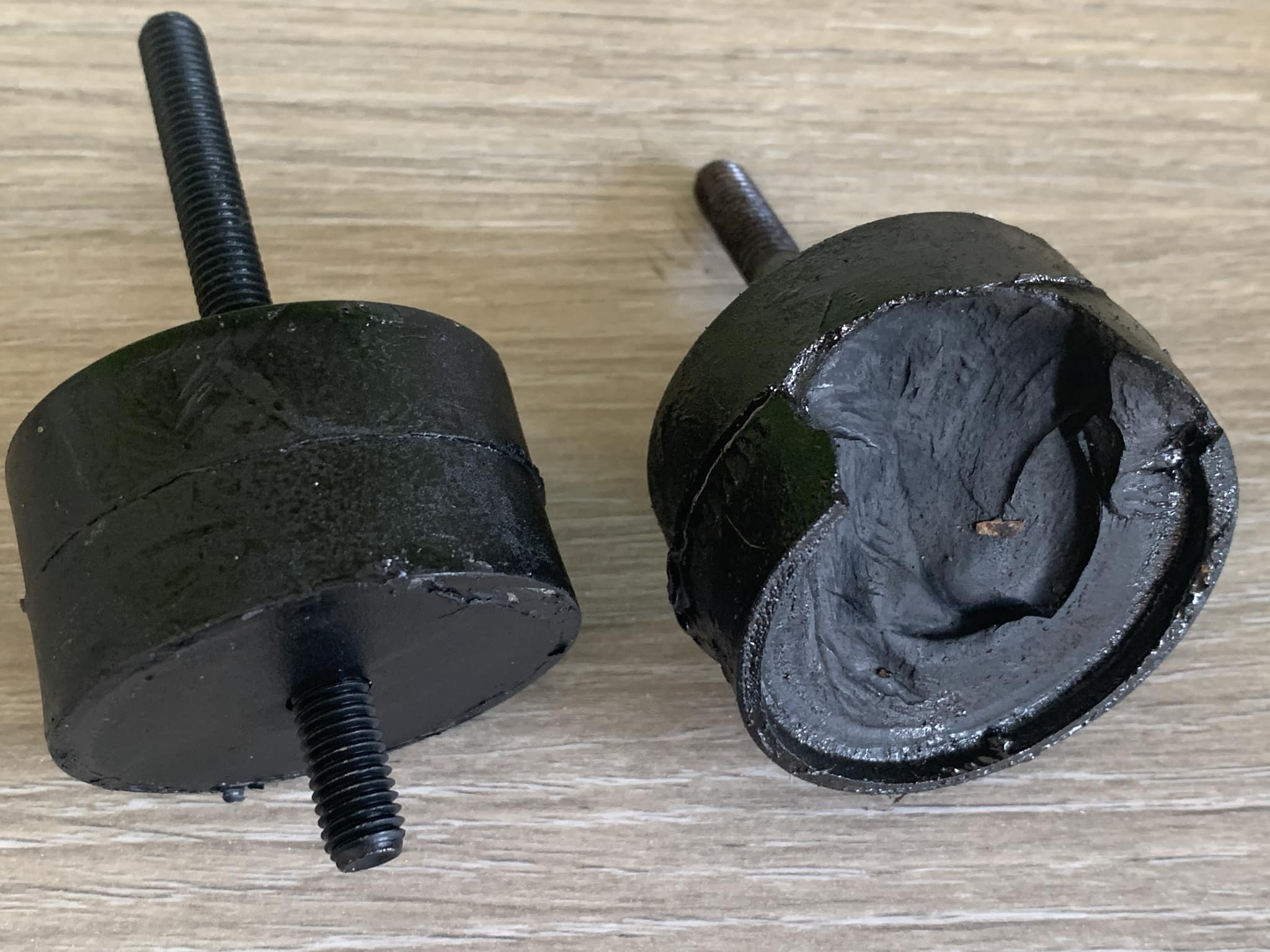

Replaced both front engine mounts... Three seasons of 5000rpm launches had taken their toll! (IMG:style_emoticons/default/av-943.gif)

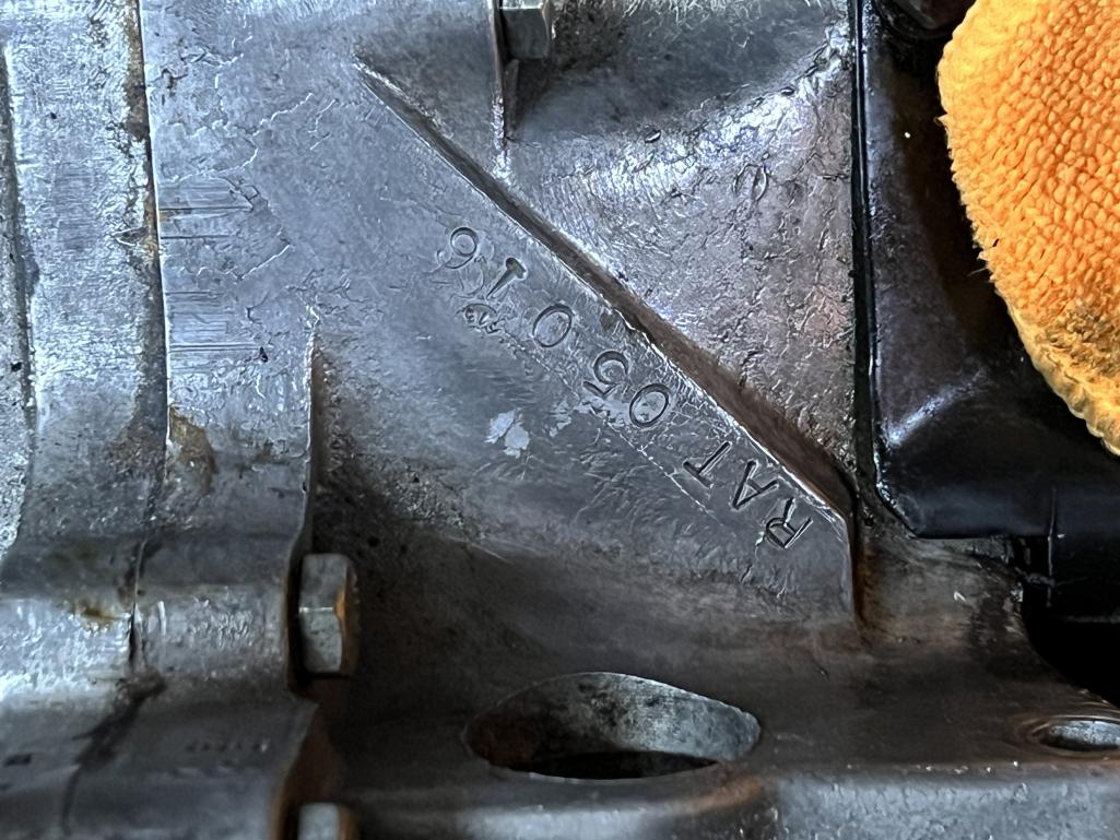

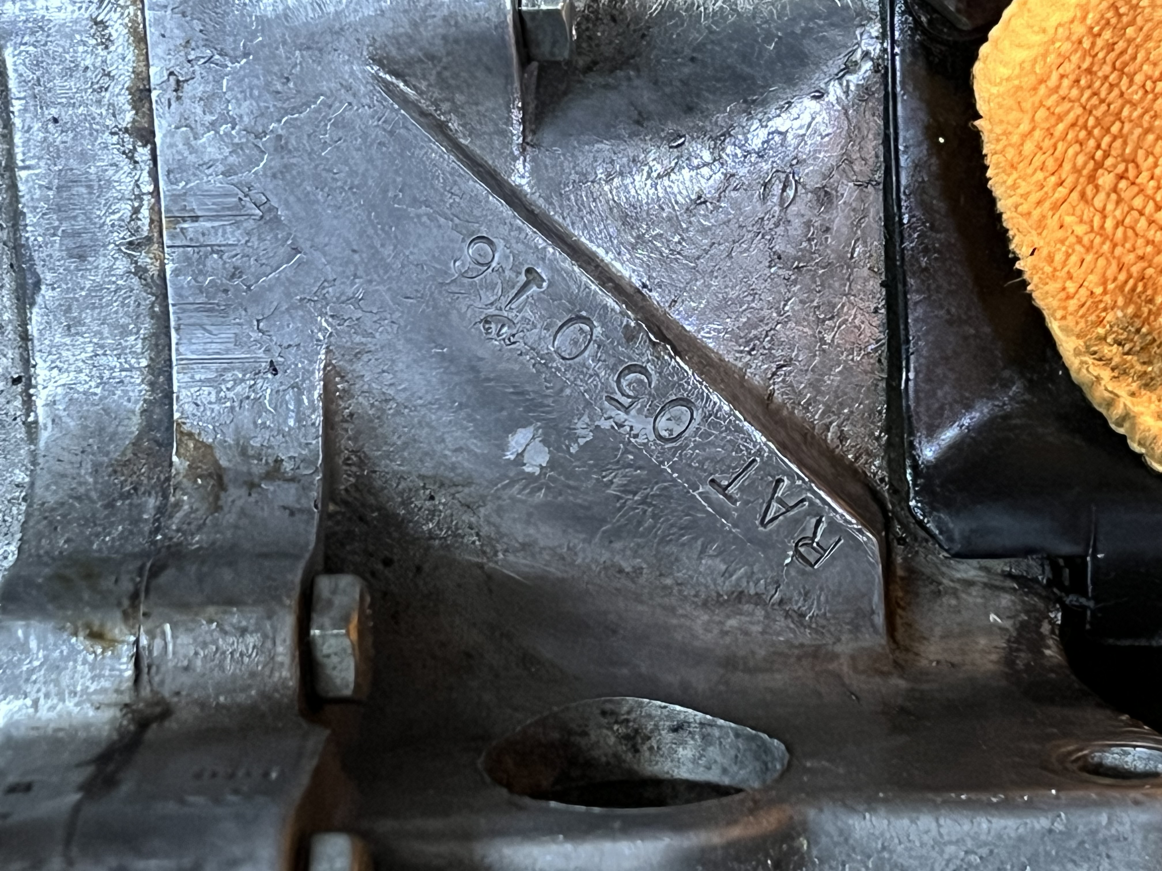

This Eng was in Oscars blue 914 with the big Frog lights on it and flairs on it. Going into the 74 blue 2.0 that I had inside my shop for 12 years.
Mark Sonners and I are doing the work on this used RAT built eng. Trying to find out why there was oil starvation and the ticking sound. Who knows what the hell the ticking sounds is from. We are taking it down very slowly looking for witness marks. Some stuff doesn't look exactly right there's no wire to the thermostat flaps. We will post pictures and ask questions as we have a RAT Jake DVD

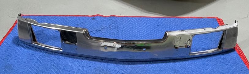

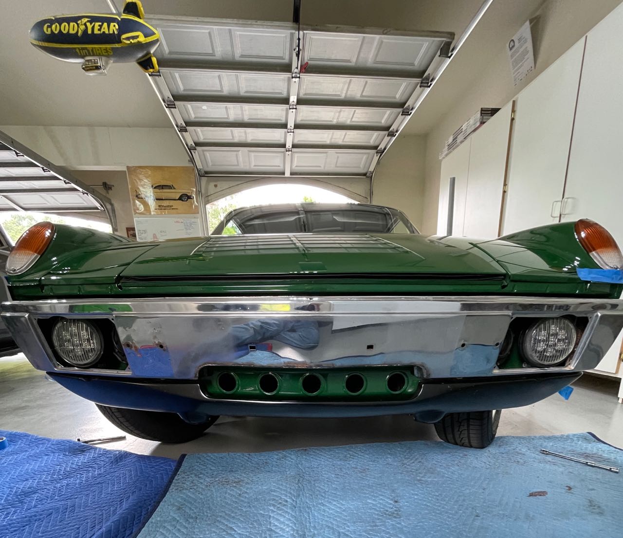

After driving her for about 9K miles I decided to open up the front GT oil cooler opening more like a standard GT opening to allow more air flow. Previously I just had the GT valance opening and the bumper was stock; it blocked about 1/3 of the top of the round body openings I use for air to enter the cooler. In traffic and at slow speeds the temperature would creep to about 200 degrees.
So I bit the bullet and sourced another bumper from @DRPHIL914 and had it shipped to Ben McFarland @MB911 along with a template for the opening I wanted on the bumper. Ben did a terrific job and at my request shipped it to Ogden Chrome for the chrome work after I called and spoke with them and they gave me a "as much as $1,500" quote for their chrome work. OUCH! But I wanted it to be nice so I said OK.
Ogden received the bumper and emailed me the work would be $2,700!!!! OK, I love my car, but $2,700 for a front bumper that is in pretty good condition to start with is just other world crazy. I had them ship it to me.
The bumper is now en-route to another chrome shop that saw a bunch of pictures I sent and gave a much more reasonable quote and promised a triple-chrome show finish. We shall see how it comes out.
For now, here is a picture of that modified bumper mounted to my car to check fitment before it went to chrome:

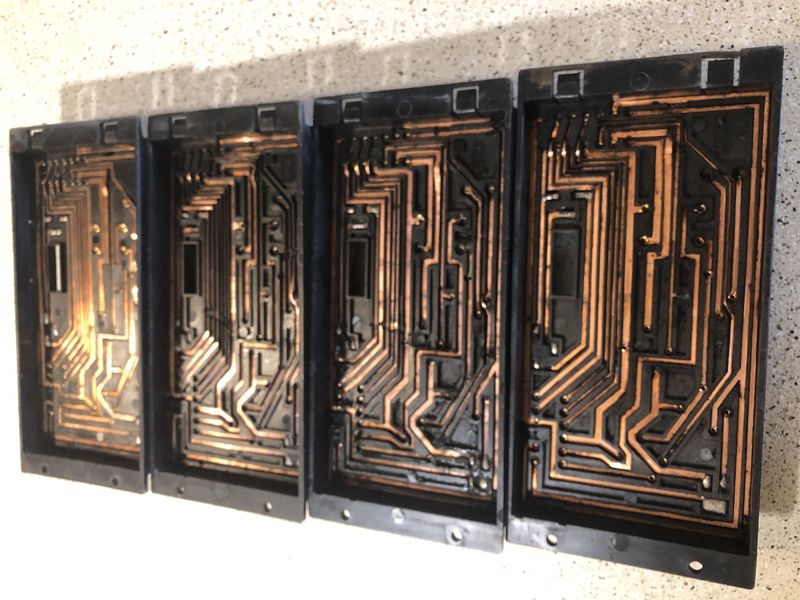

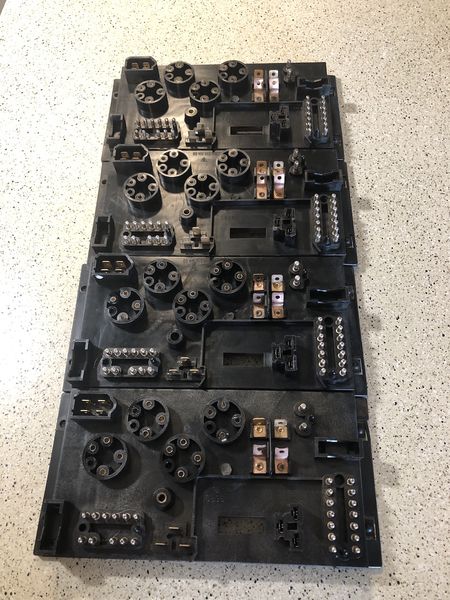

Got with it and did some relay boards. Lots of nit picking (IMG:style_emoticons/default/sunglasses.gif)

He did a real nice job. I did one of these and it was not easy to get it right.

@Shivers I agree; Ben is one heck of a fabricator. (IMG:style_emoticons/default/beerchug.gif)

wow that looks great! good work from Ben on that, and it will clean up nicely. that alignment and gapping above and below look really good, glad it stayed true and straight thru all the shipping etc.
I had a similar one to this that needed about the same amount of work and it cost me $750 for the triple chrome that was 4 -5 years ago, so i guess $1000-$1500 wouldn't be bad, mine was done by Tri-City Plating in Elizabethton TN . Who ever Oscar was using back when he was doing a bunch of bumpers was doing some nice work too, not sure who that was but maybe check with him and see if they are still doing this work.

Wow 2700 is crazy. Glad you found someone else. I have now done over 100 of these GT bumpers so I have it figured out. That said Michaels was 100% custom to his pattern.
Just shipped another bumper out this morning to another client.

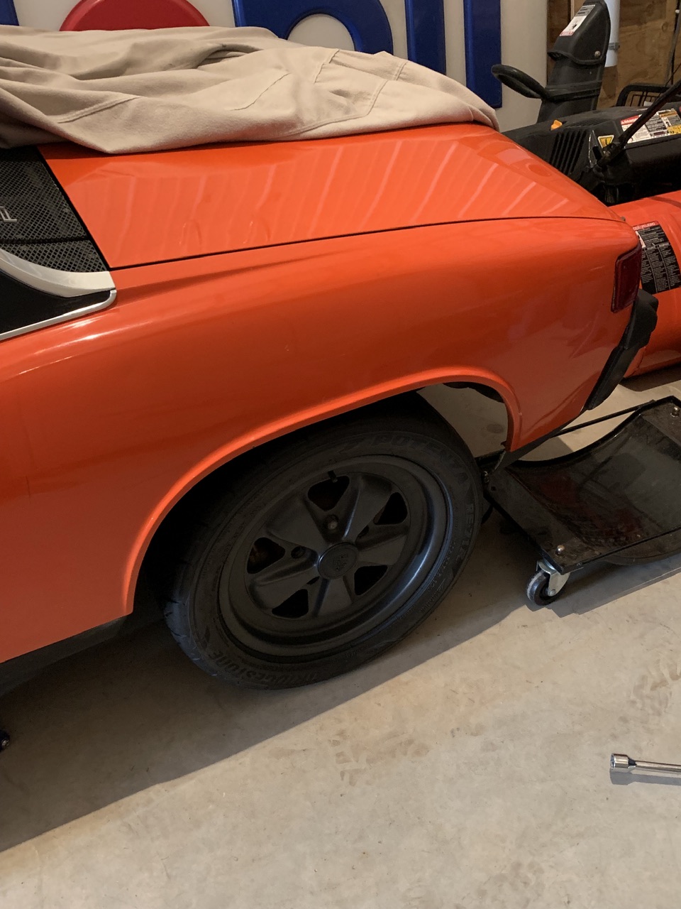

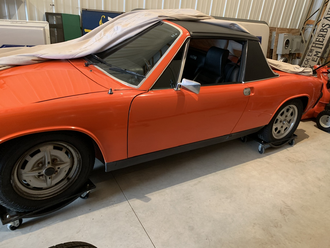

Played around with wheels, steel (way I bought it) to Fuchs 2.0 to 5 Lug Fuchs, just fun to experiment I guess.

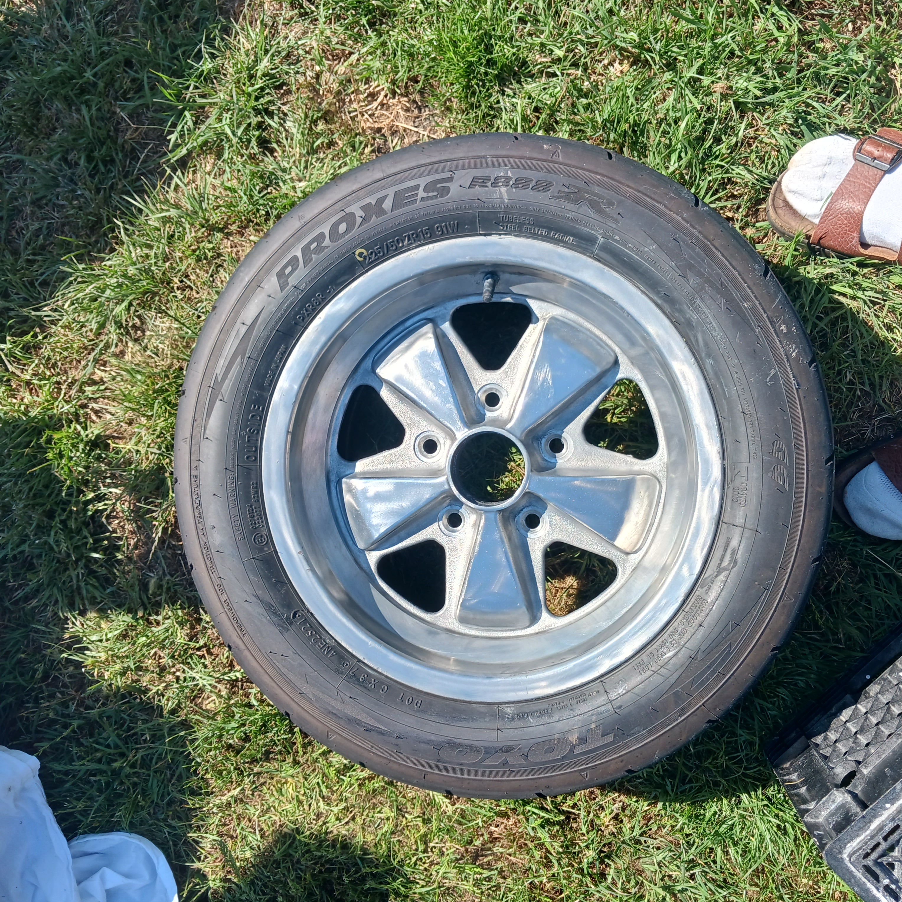

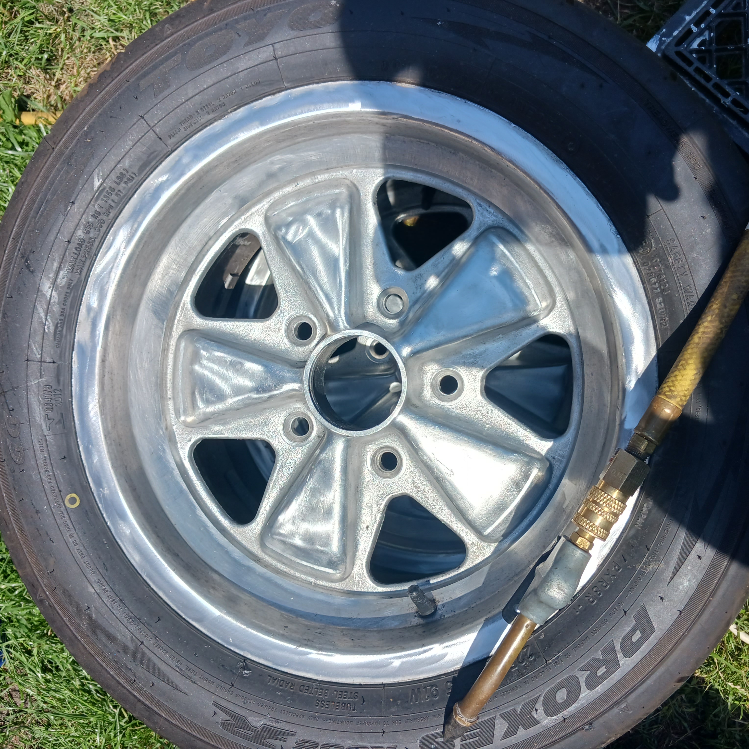

trying my hand at polishing my rims.
