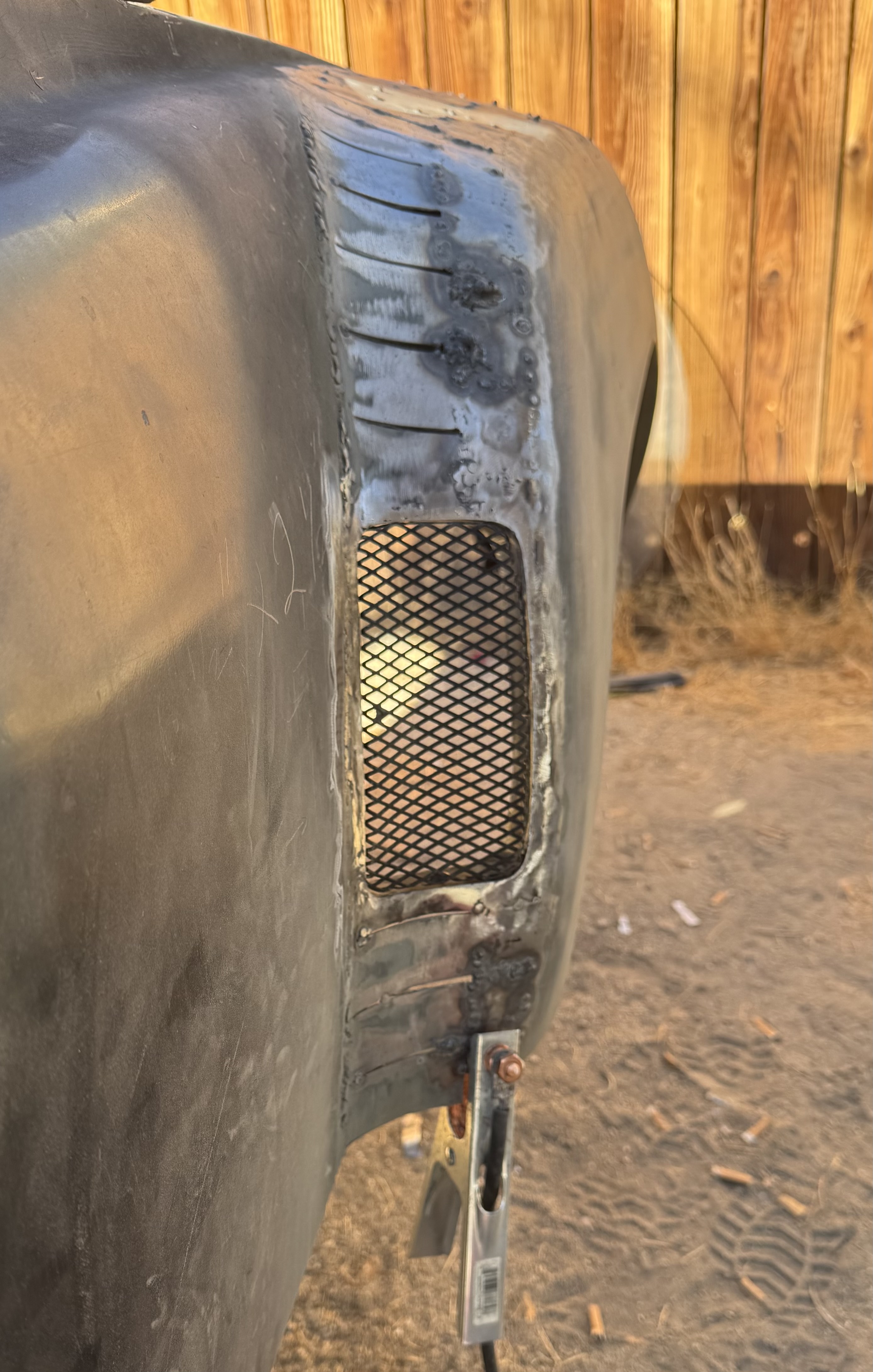

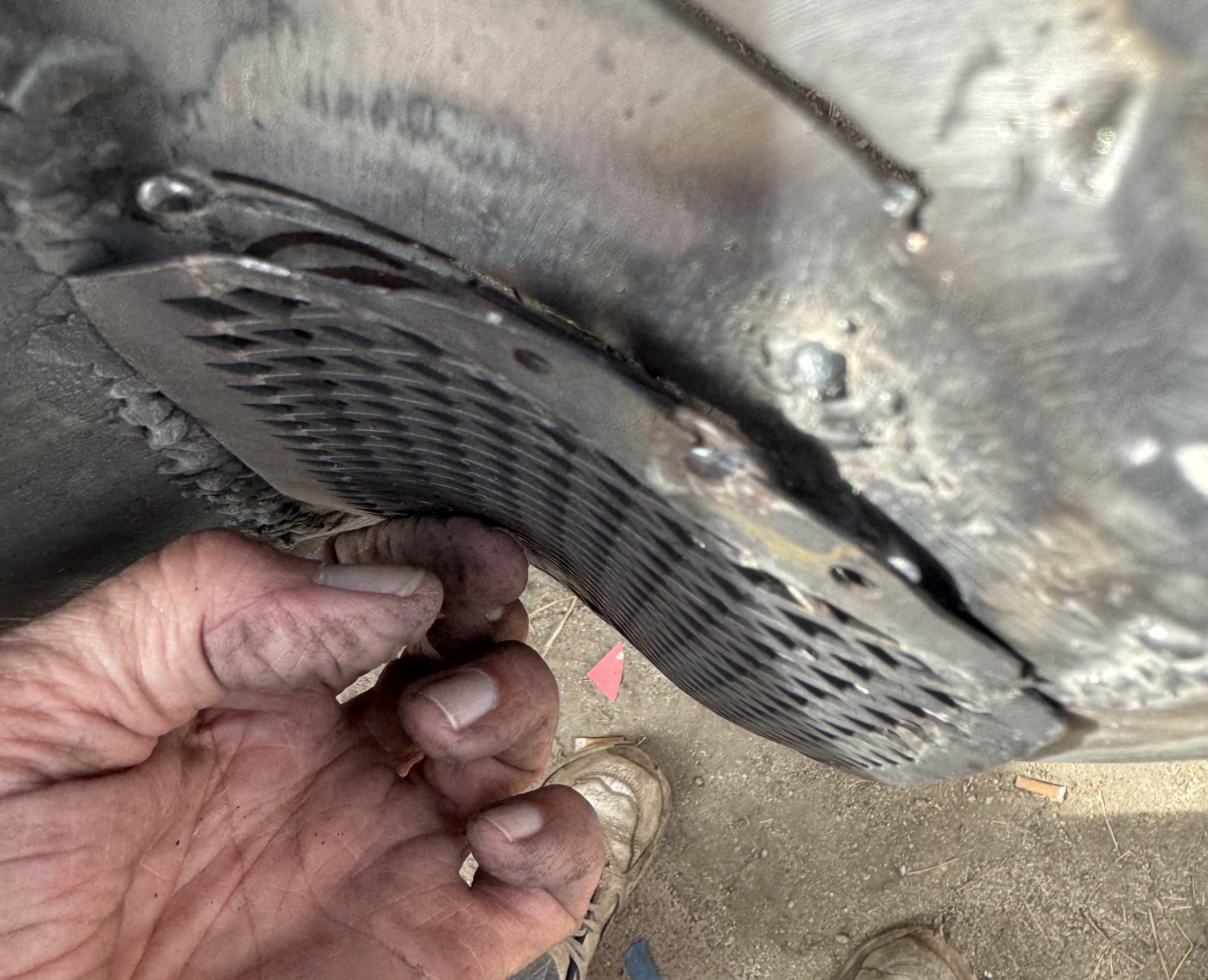

Shaping the grill material to fit the flare

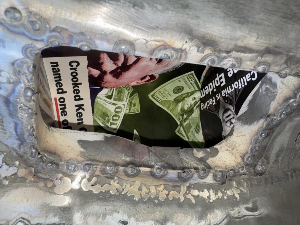

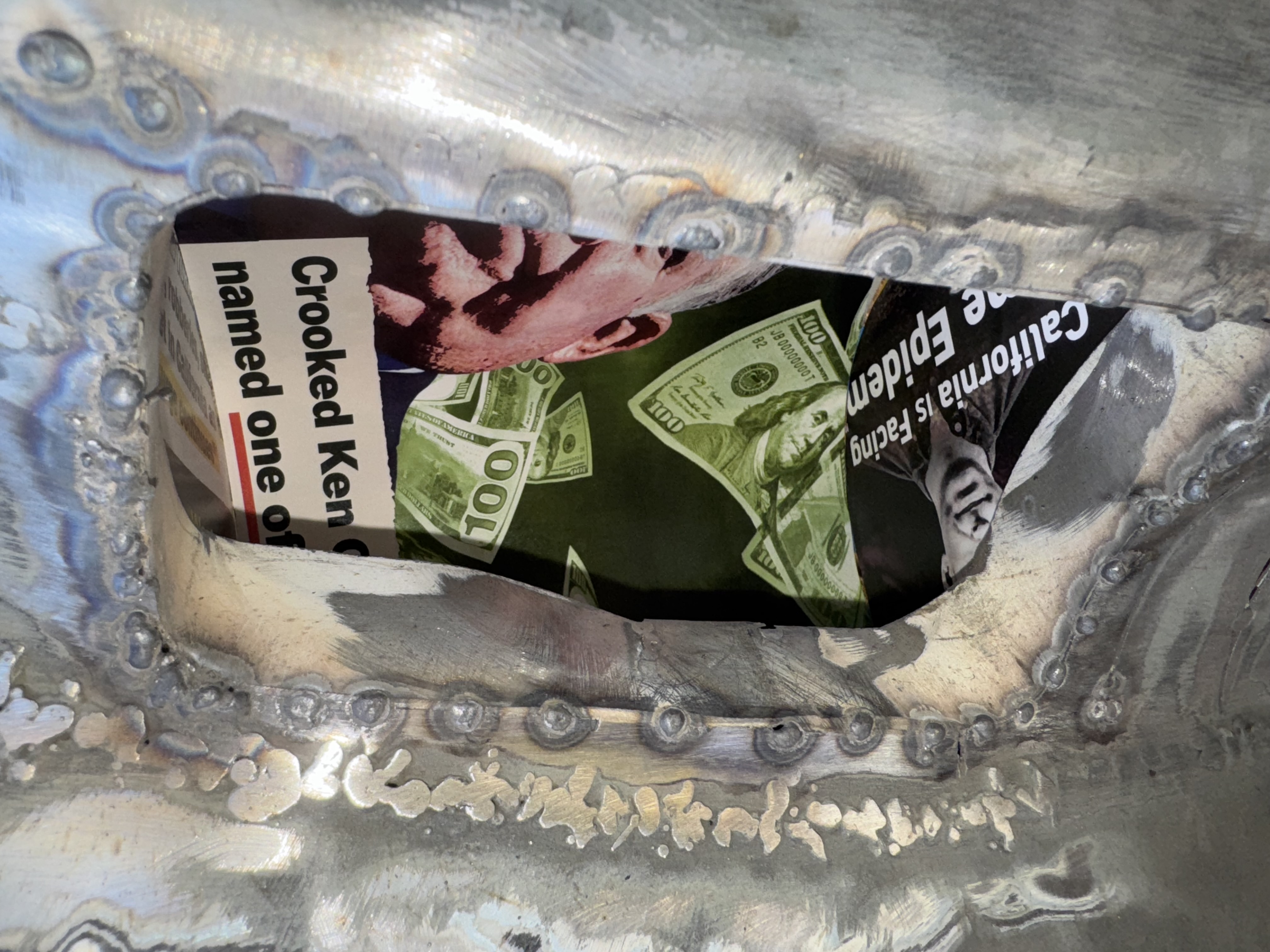

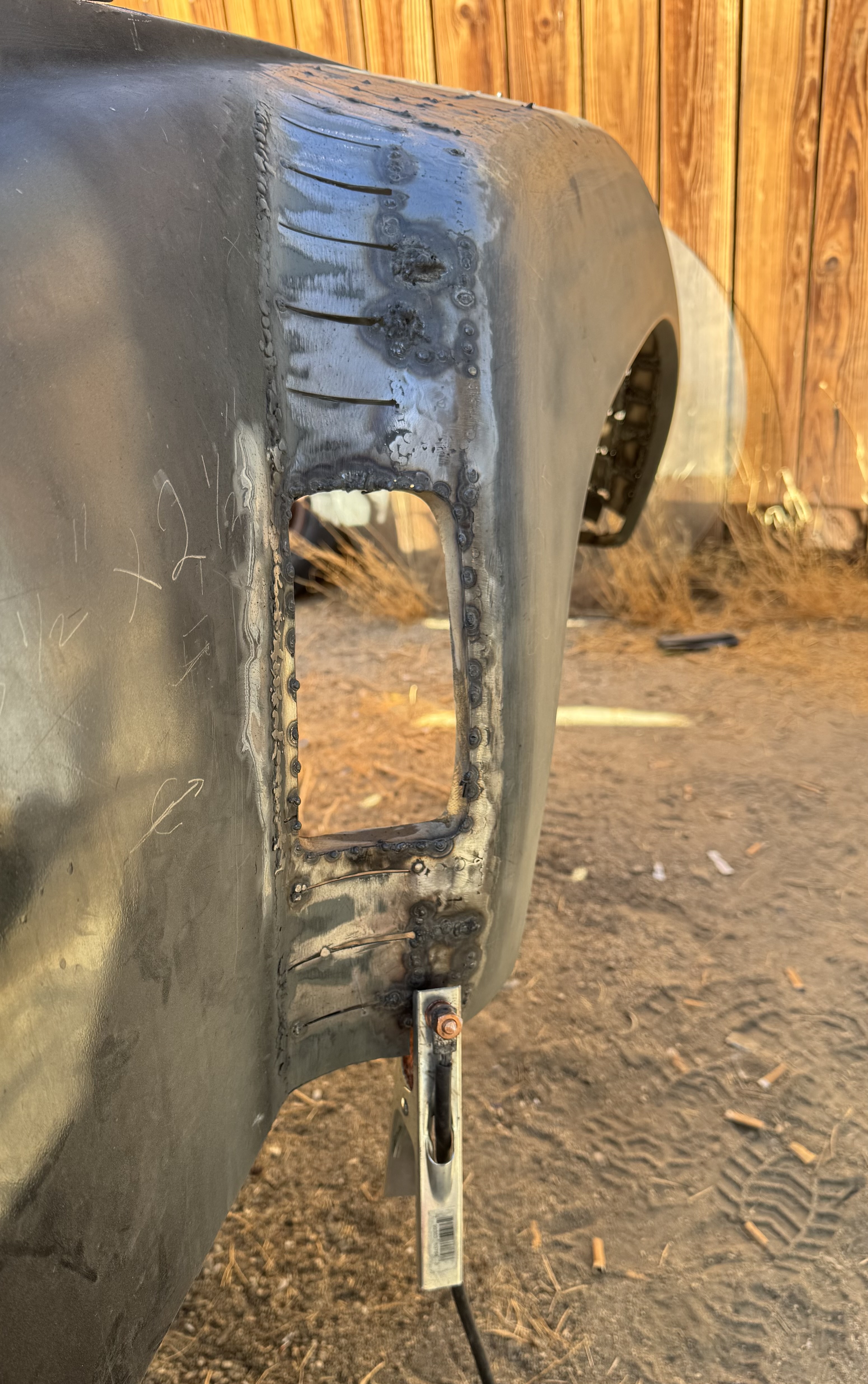

Still lots of tack welding and grinding.

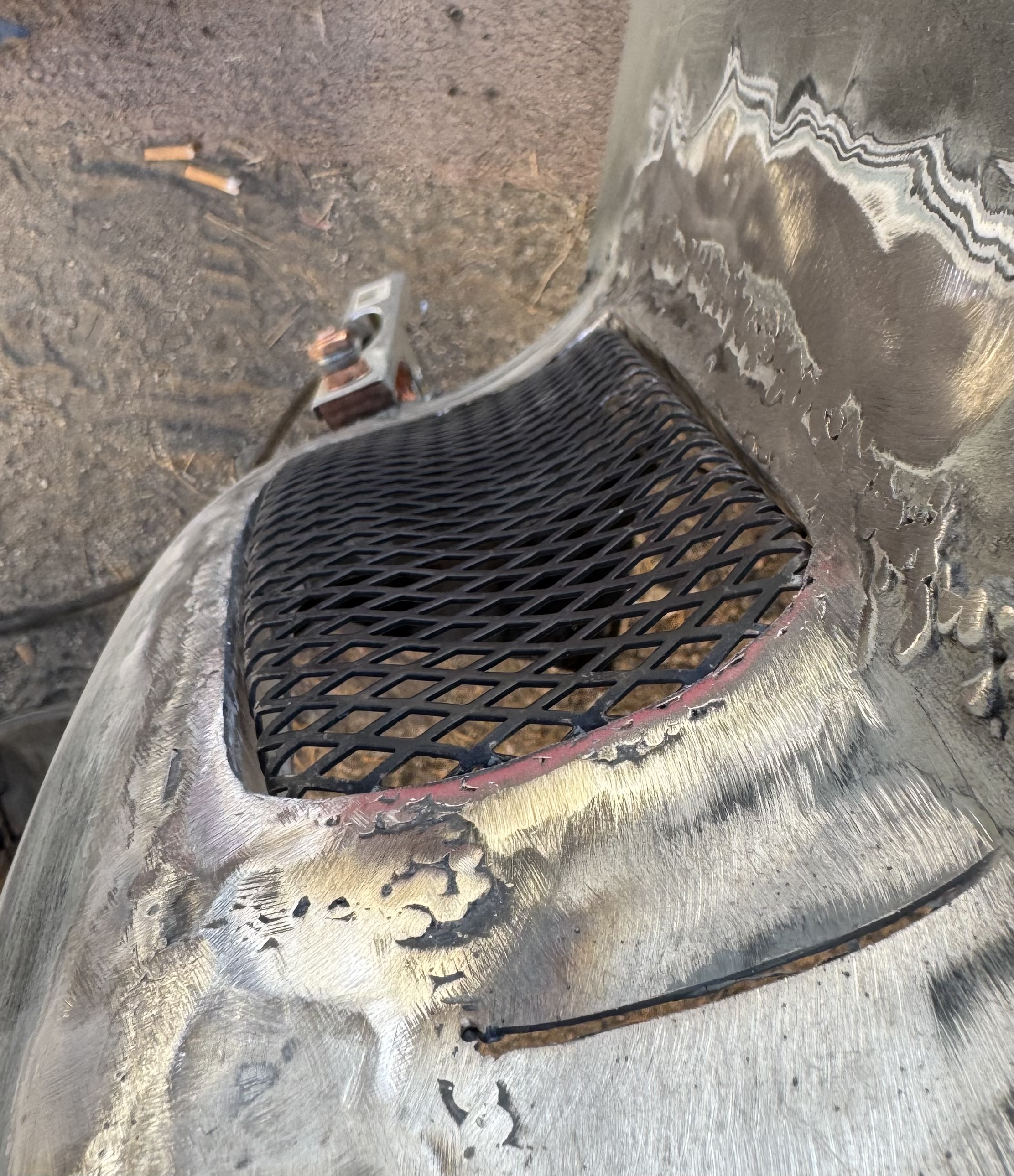

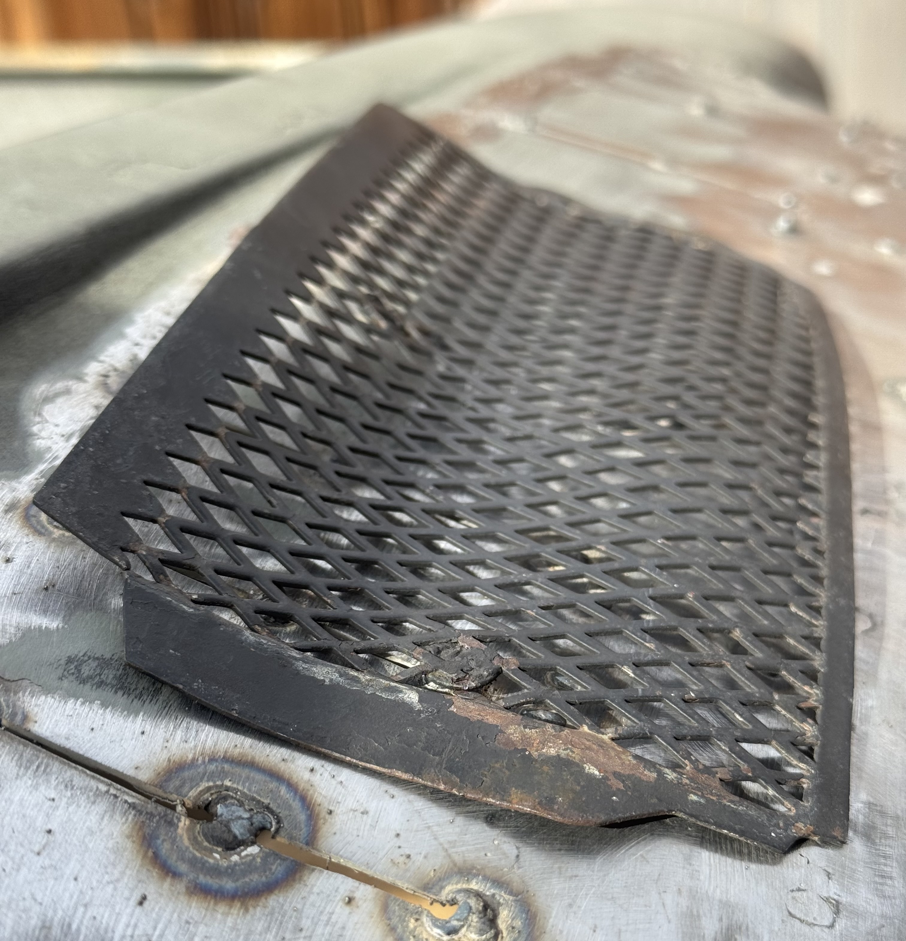

I was going to use a grill on the outside but it was pointed out that
the airflow would be cut down. He is right. But I spent so much time shaping
I had to share. (IMG:style_emoticons/default/smile.gif)

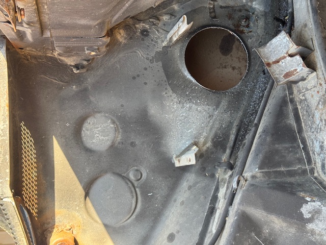

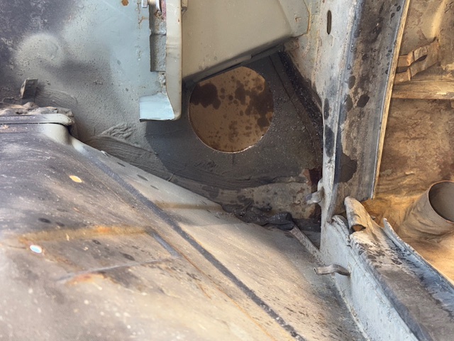

This was a little spooky, but both ended up in the same place. With some luck they should blow at the cooling fan intake first, then share with the intake. (IMG:style_emoticons/default/smile.gif)

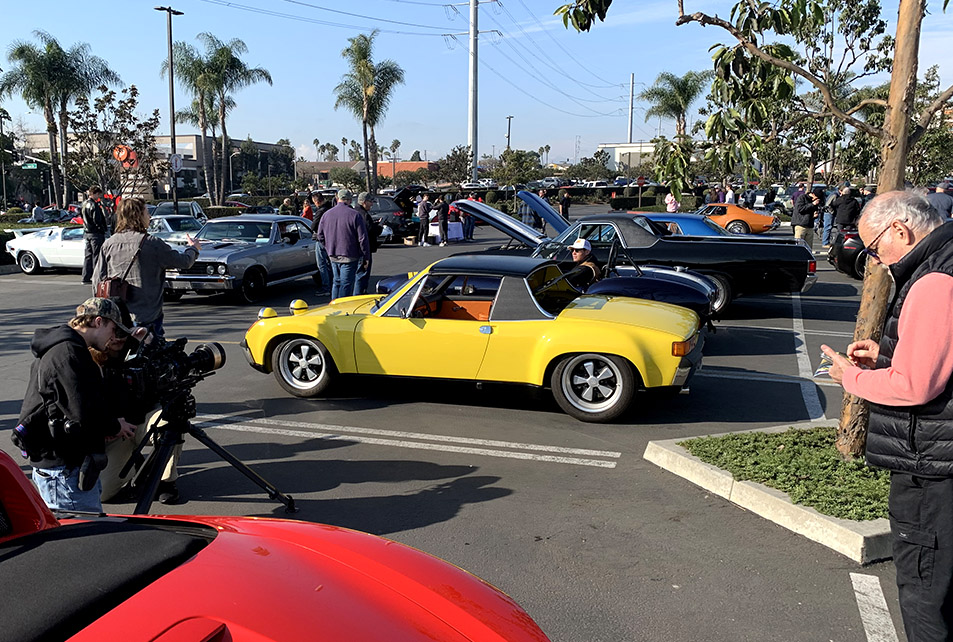

Went to Cars and Coffee at a place called the Point close to my home. It was a beautiful day got down there by 7.15 Alan @914 drove with me and we where a group of buds that live within a block from my home. Note the Cobra and the BK El Camino with a 700-horsepower engine and finished in a level equal to my 6.
The bees where out and they love the Canary Yellow color of my 6

Looks bad ass Shivers!!

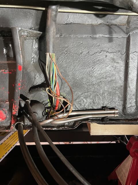

New fuel lines today--thanks to Chris at Tangerine Racing. I struggled with the install until I noticed that a seat harness bolt was impeding progress. I will use only one line, but I installed two for future set up with carbs that require return to the tank. The stainless steel lines are quite rigid--an added bonus that they provide a great zip-tie support for my wandering clutch cable tube. It was loose near the front end.

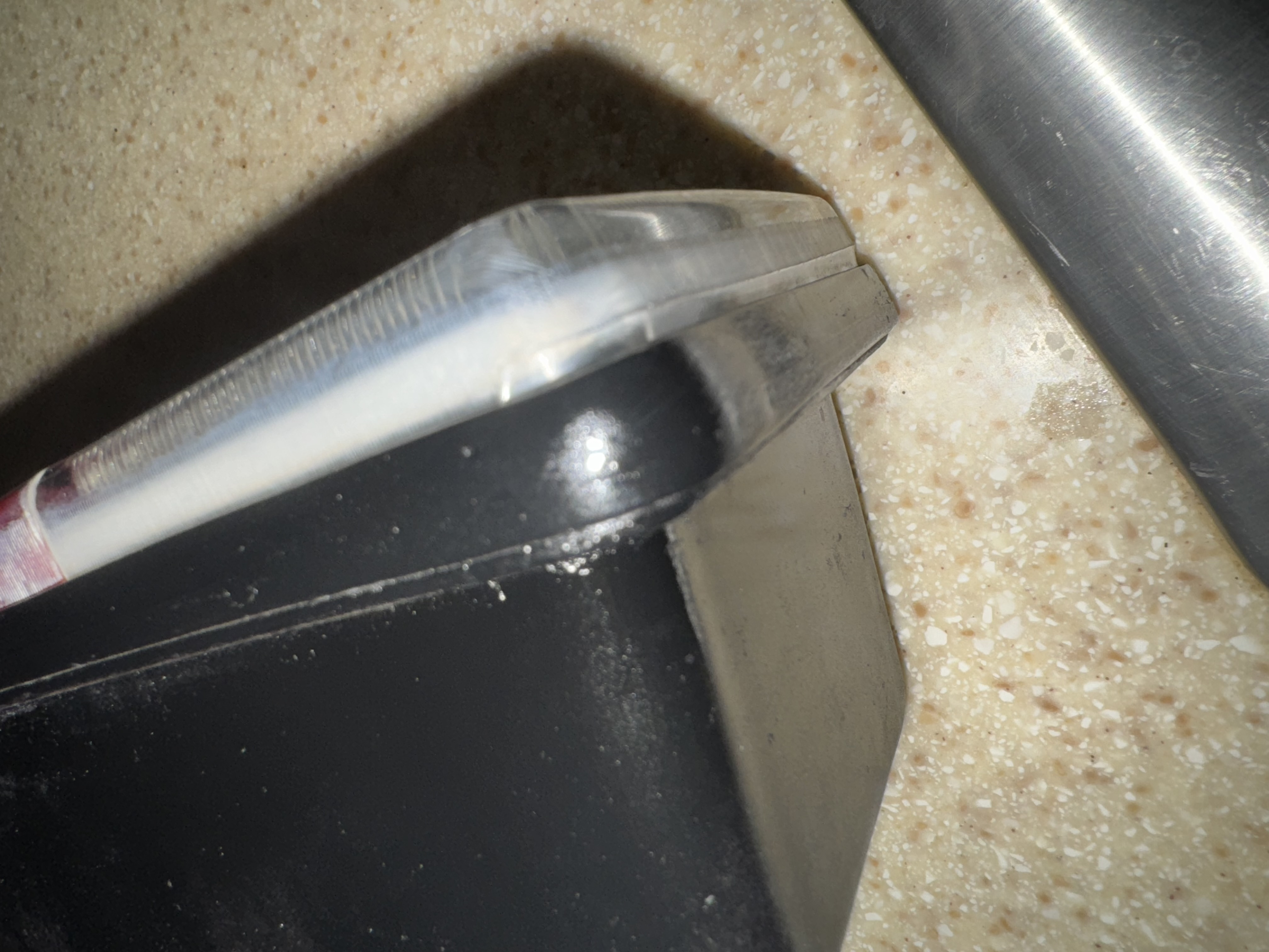

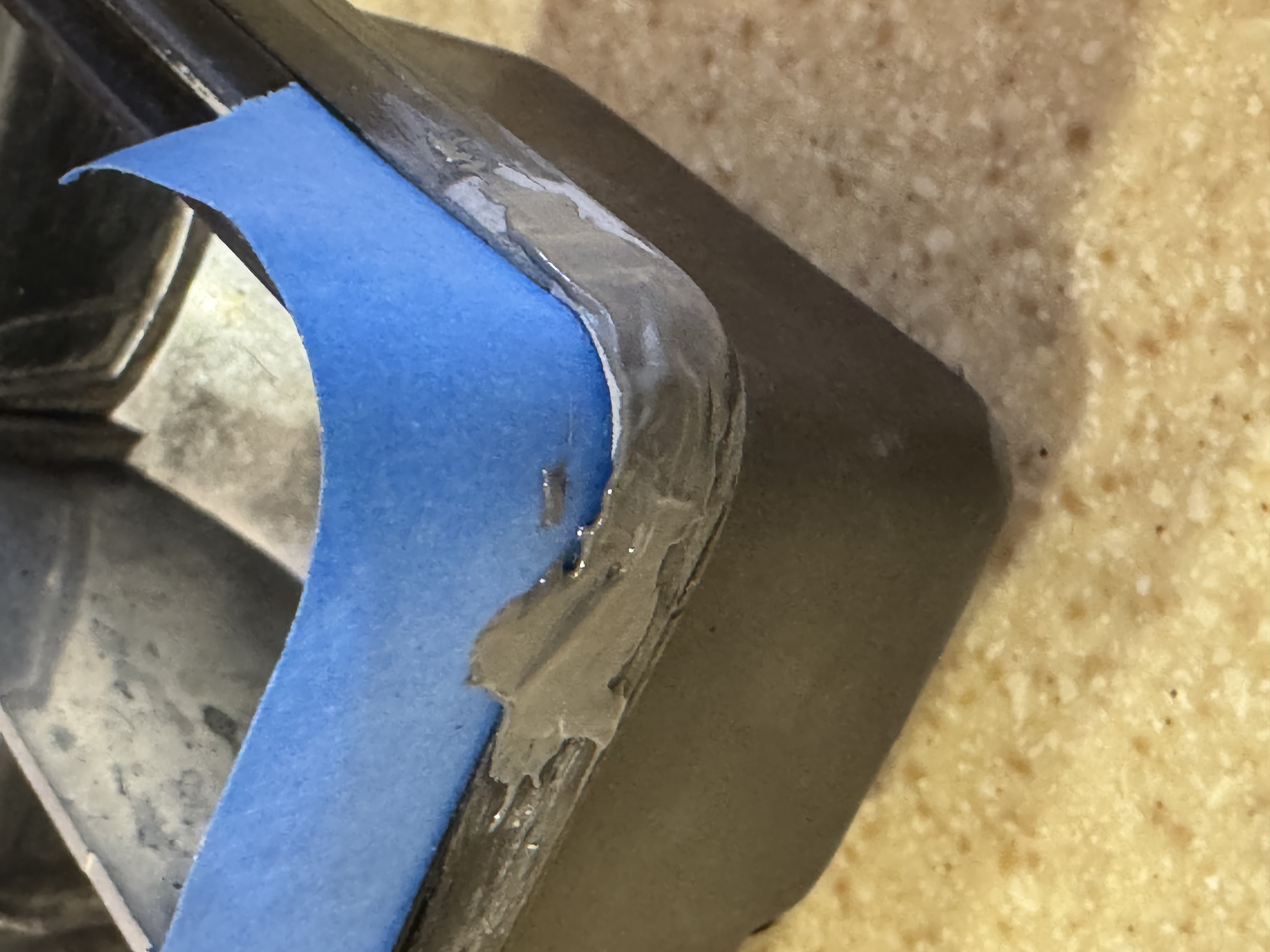

Received a passenger side tail light assembly. Mine is in multiple pieces, this one just needed some love. Thanks @barefoot It also had the other end broken but JB weld is the best for plastic repair.

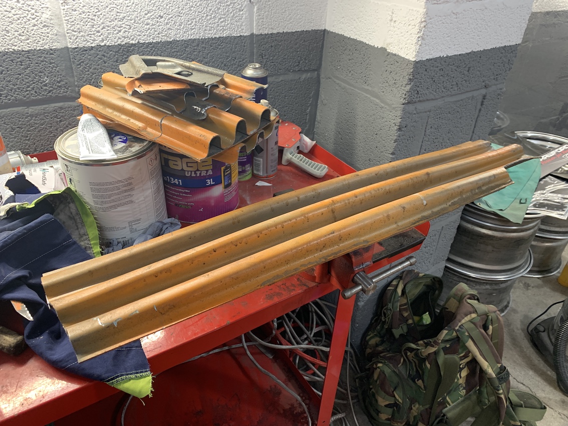

Removed approximately 24 pounds from the doors...

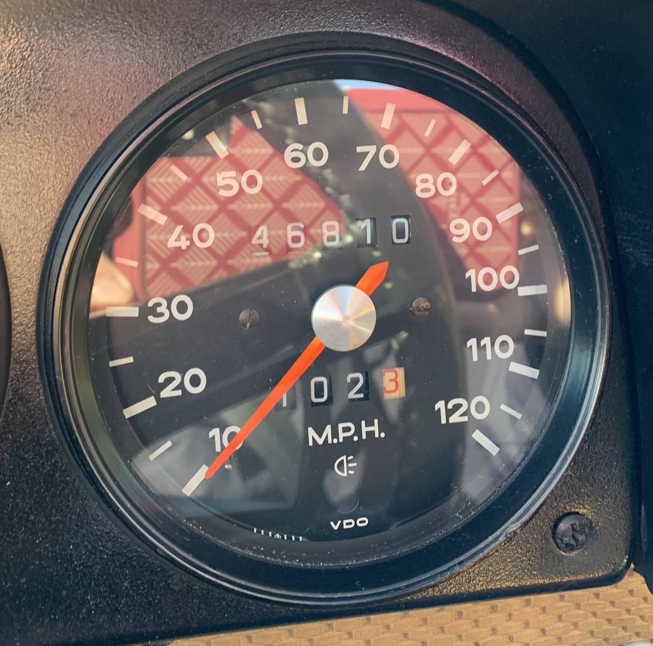

Drove it, rolled over 2, 4, 6, 8, 10 (246,810 miles), and promptly released a little smoke from behind the dash (IMG:style_emoticons/default/headbang.gif)
Going to be a busy weekend (IMG:style_emoticons/default/dry.gif)
