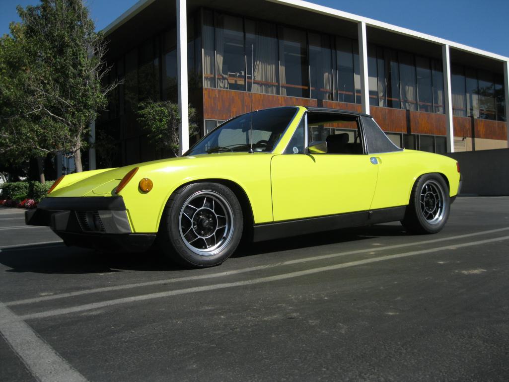

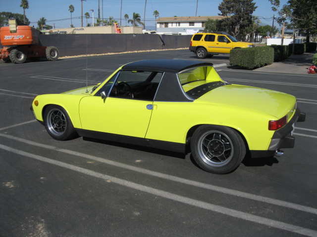

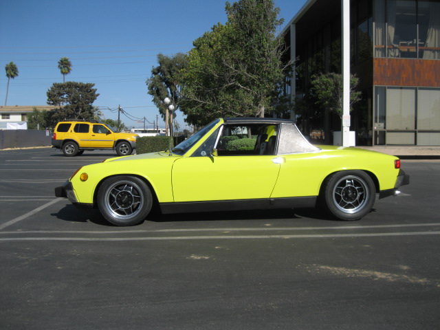

OK, twist my arm! I love Ravenna Green, but mine's actually Saturn Yellow. It never photographs the same way twice.
I really like the way the exhaust turned out...single tip in the stock location, and a cheater "dump" pipe that's hidden behind the valance. The "2.0" badge stays!

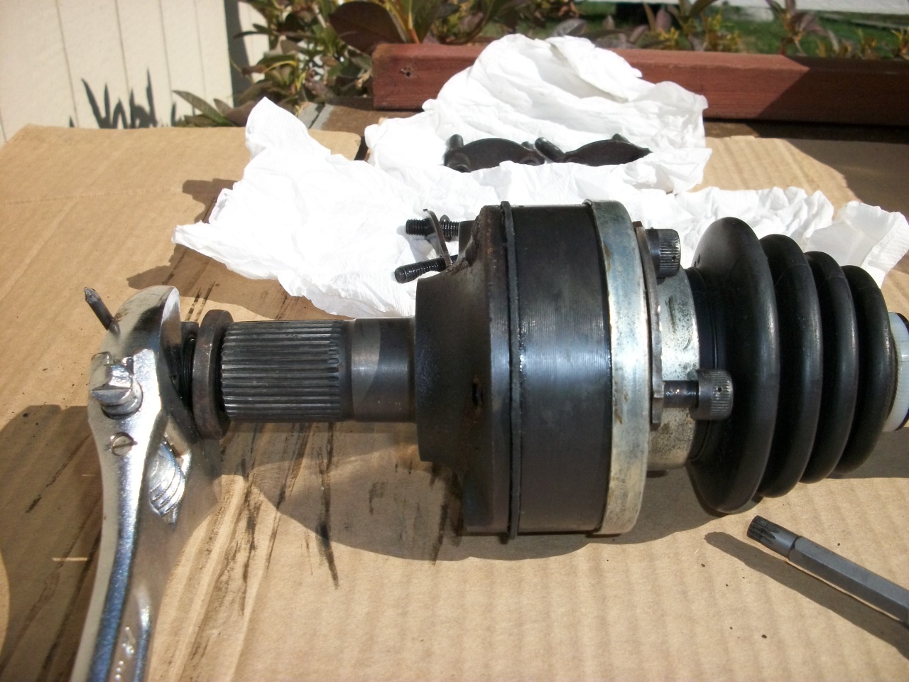

Finished cleaning the CV's and putting them together dry. Just need the new boots and grease now.
So, the axle is off and you are by yourself and the cv bolts are tight. How to get them broke loose? No vise to use! My solution was putting the nut on the axle and putting a nail thru the cotter pin hole and using a large crecent wrench on the nut. That worked really well. (IMG:style_emoticons/default/smile.gif)

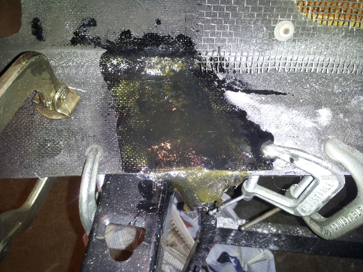

FG bumper repair... got tired of the black racer's tape. Spoiler next... Not a body guy. This is really messy. (IMG:style_emoticons/default/beerchug.gif)

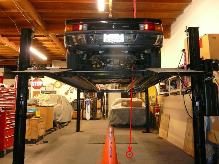

Yesterday, as I was getting ready to go to AutoShop class, the school called to let us know the instructor wasn't in ... so I went to my shop.
With the 'BB' up on that nifty new lift, I tackled some oil leaks. Torqued the strainer bolt and installed a new gasket on the passenger side rocker cover. The strainer stopped leaking (which was massive), but I still have a little more than a dribble from the rocker. Need to find some better covers.
Also, adjusted the front suspension (sits more level from side to side now). Got to drive it around the block a few times, but the red idiot light in the gas gauge came on and spoiled my fun (IMG:style_emoticons/default/dry.gif) ... so I rummaged through some boxes of spare parts to see what else I can sell off.

QUOTE(Tom @ Sep 19 2012, 04:51 AM) *
Tom
if those boots are in good shape and your just changing them cus youve got them out .I recommend not changing them. new rubber is hit and miss . Atleast keep the old ones around if the new ones dont last.

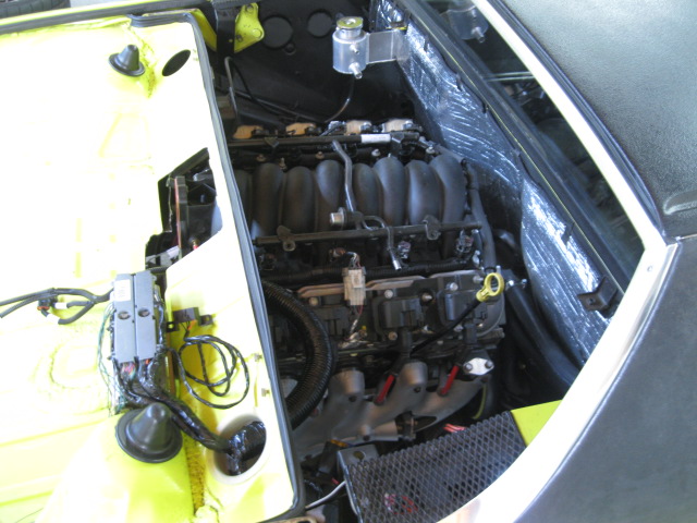

Installed FATMAT on the inside of the firewall, underside of the engine lid, and underneath the targa top. All of which helps make the car barely bearable on freeway cruise with the Webers. Back at school now though, which mean the 914 has to take the back seat for a while.

Here's some pix from earlier in the year - shortly after a new drive train was installed and getting ready to leave for the Route-66 Run ... complete with a beautiful tan summer top (IMG:style_emoticons/default/drooley.gif)
It still has a few issues that need straightened out (IMG:style_emoticons/default/smash.gif) (IMG:style_emoticons/default/sawzall-smiley.gif) (IMG:style_emoticons/default/welder.gif)

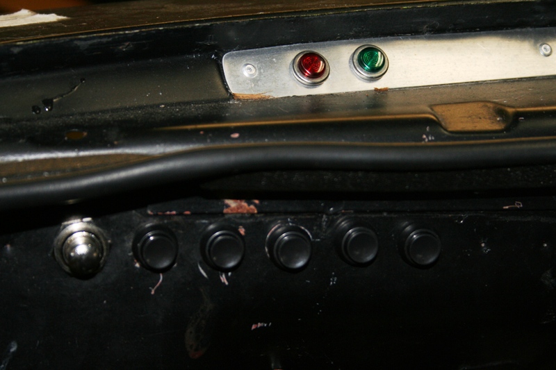

More wireing. All I need now is the headlights and the switches.

I put the switchs in today.
From right to left.
Horn, left turn, right turn, driving lights, low beams and high beam.

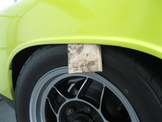

I didn't use a fender roller, just a jack handle with a piece of wood duct-taped to it to spread the load. But first, I used a hammer and dolly to flatten the inside lip. This step will certainly crack and flake the paint off, but mostly from the portion that's rolled underneath, so it's not all that visible. Fenders will require a bit of touch-up paintwork, though.
Then, with the car jacked up a bit, I levered the fender out against the tire with the jack handle. I worked slowly and evenly, doing it in several passes. It takes more effort than you might think, but be careful and the result is a very smooth bulge that's hardly noticeable.
The left side was very tight still, so as a final step (with car off the jack), I stuck a piece of 1x4 wood between the fender and tire, toward the front of the opening. Then, I rolled the car backward, and the friction of the tire sucks the wood nicely between the fender and tire, pushing the fender out in a nicely uniform way. Continue rolling until the wood pops out the back of the wheel opening. I may do this once more with another 1/8" to 1/4" of material for a little more clearance.
