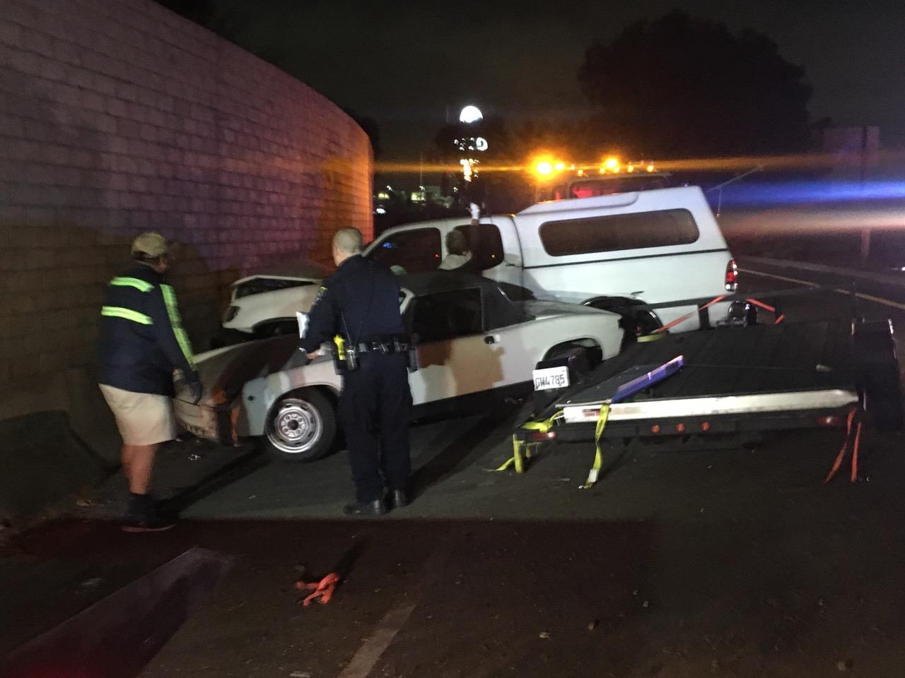

maybe a dumb question. How would one go about bending a trailing arm?

QUOTE(930cabman @ May 10 2025, 05:15 PM) *
Long story ...

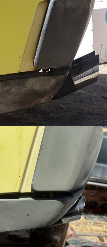

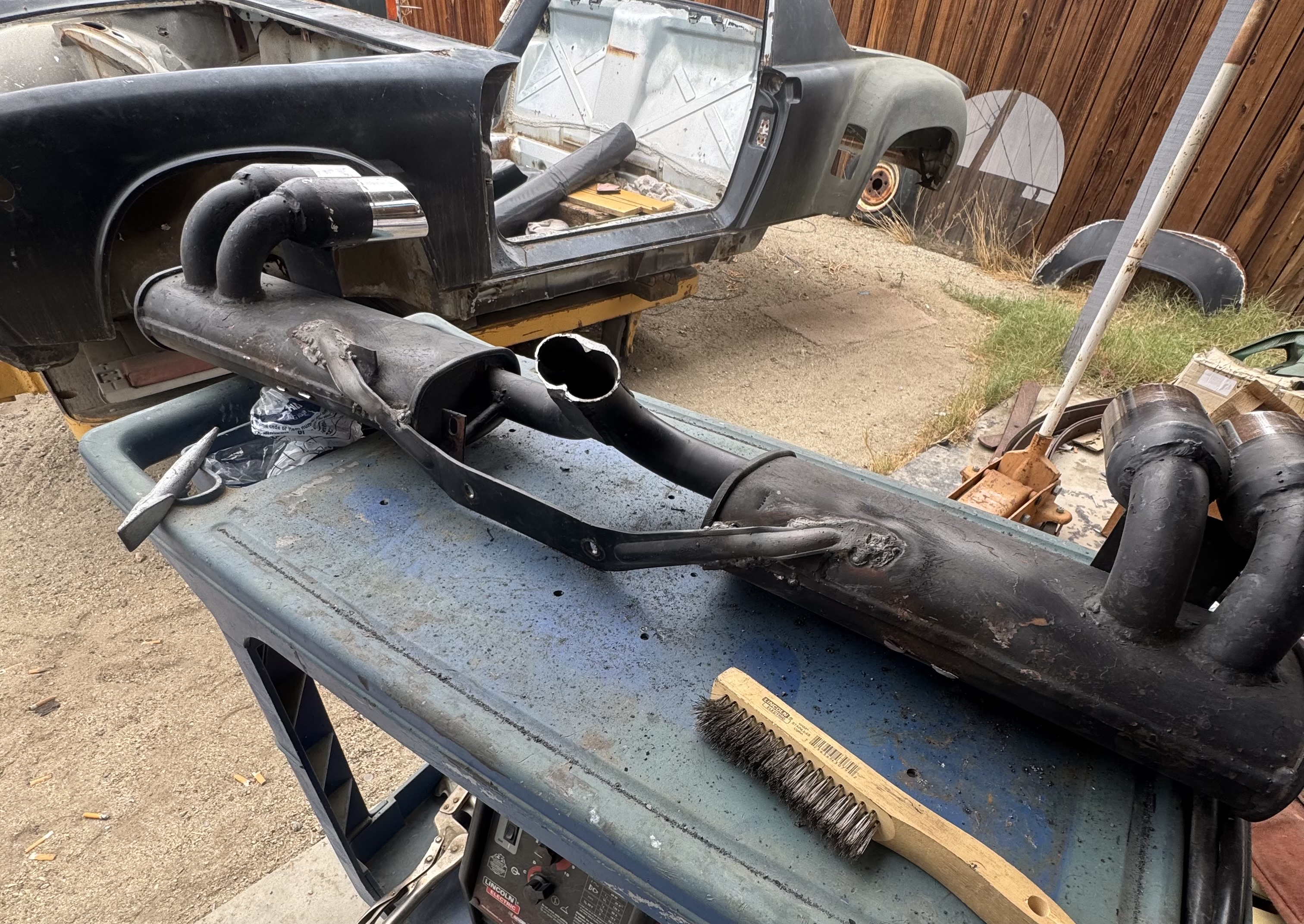

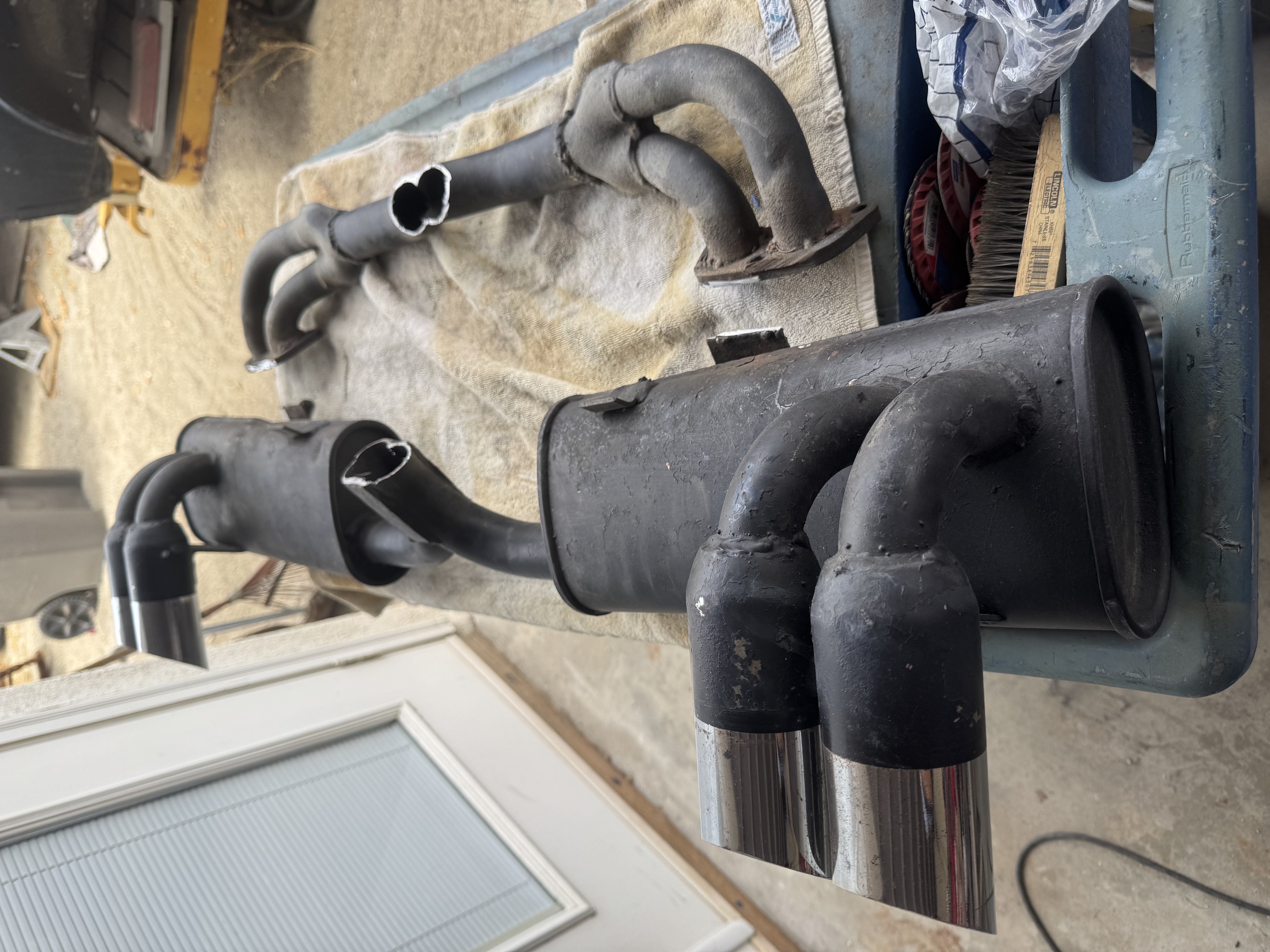

Modifying the exhaust for the header I ordered. It will be interesting hanging this thing in back. No longer have to settle on where the tips ended up with the heat exchangers in place. I’ll be able to move them in for a cleaner reveal.

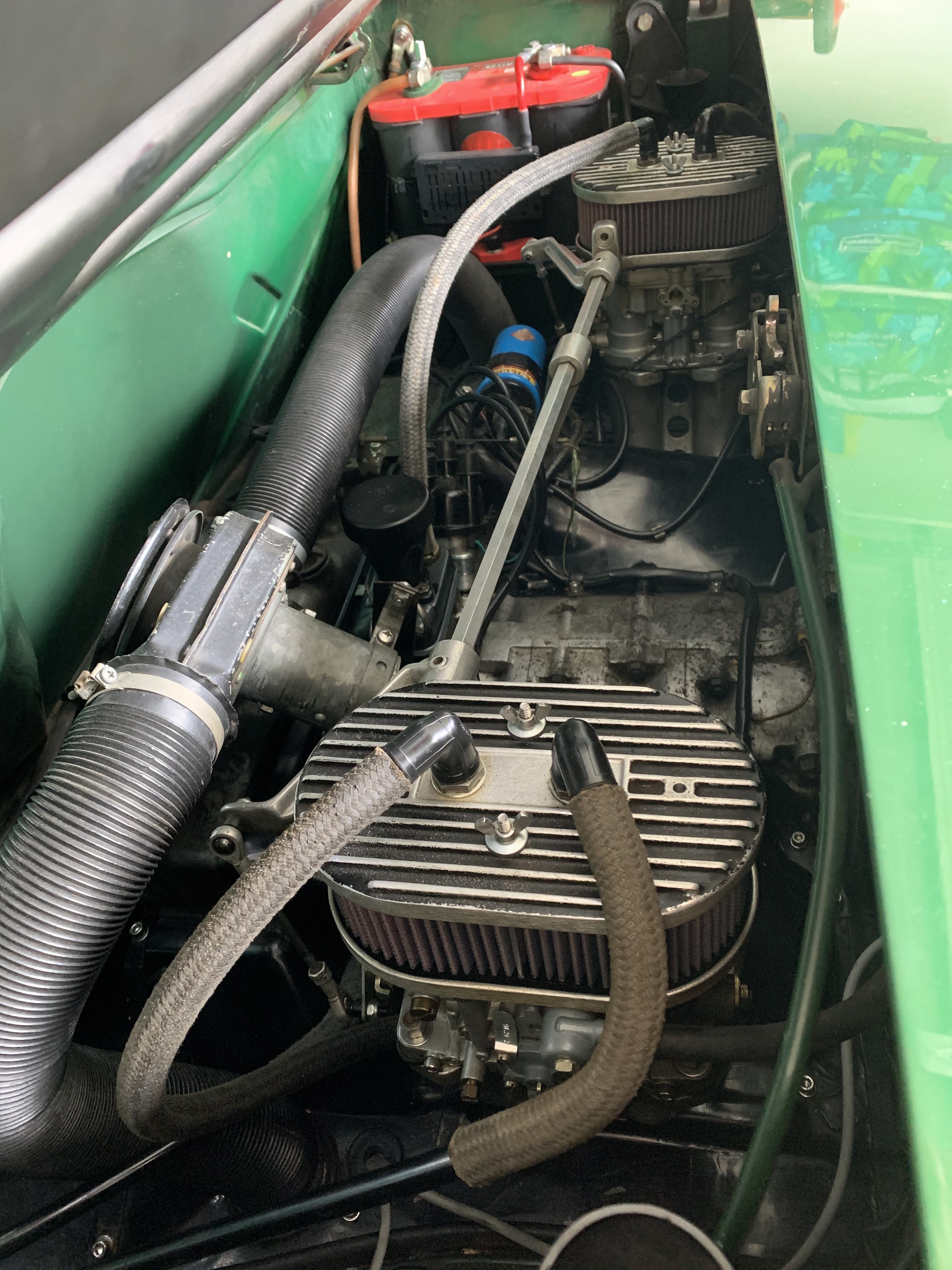

Doing a little "anniversary" spring-clean to celebrate 53 years. Cleaned up the engine bay, replaced the air filter elements with new, and did a little top-side maintenance.
Checked carb jetting too, as I 'd been getting some popping when downshifting. Current set up was 2 x Dellorto DRLA 40, with 30mm vents, 55 idle/135 main/180 air correction jets.
I looked back at my records and found that when I was stationed in Seattle (~ sea level), the car had larger idle jets ("65") and still passed emissions testing (HC = 239 ppm, Max CO% = 4.87, Min CO2% = 12.91). I ran that same set-up for the Pacific NW Region's DE events at SIR with good results.
So, being back at sea level here in SE VA, I re-jetted the carbs with the "65" idle jets and adjusted idle mixture; the car seems to run better in mid-range and no more popping. FWIW, I would have tried a size "60" idle jet just to compare, but that set of jets appears to be lost to the ages...or to my age anyways. (IMG:style_emoticons/default/biggrin.gif)

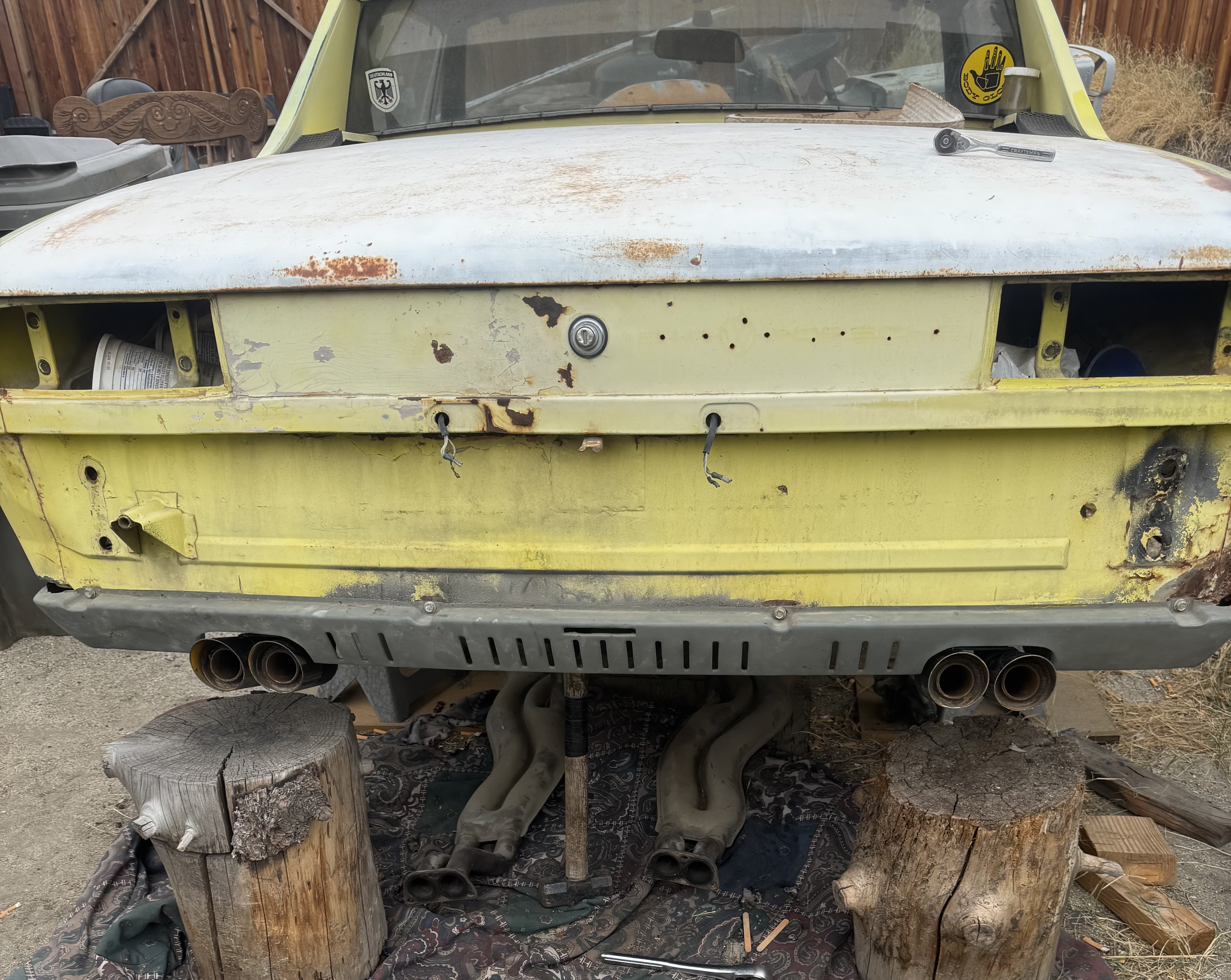

The yellow one is my og 1972. It has an un-touched front.
Black has freakishly little rust in back. So those are the two
I’m using to make one good one. A few years still with the tub
and engine. You know how money is.

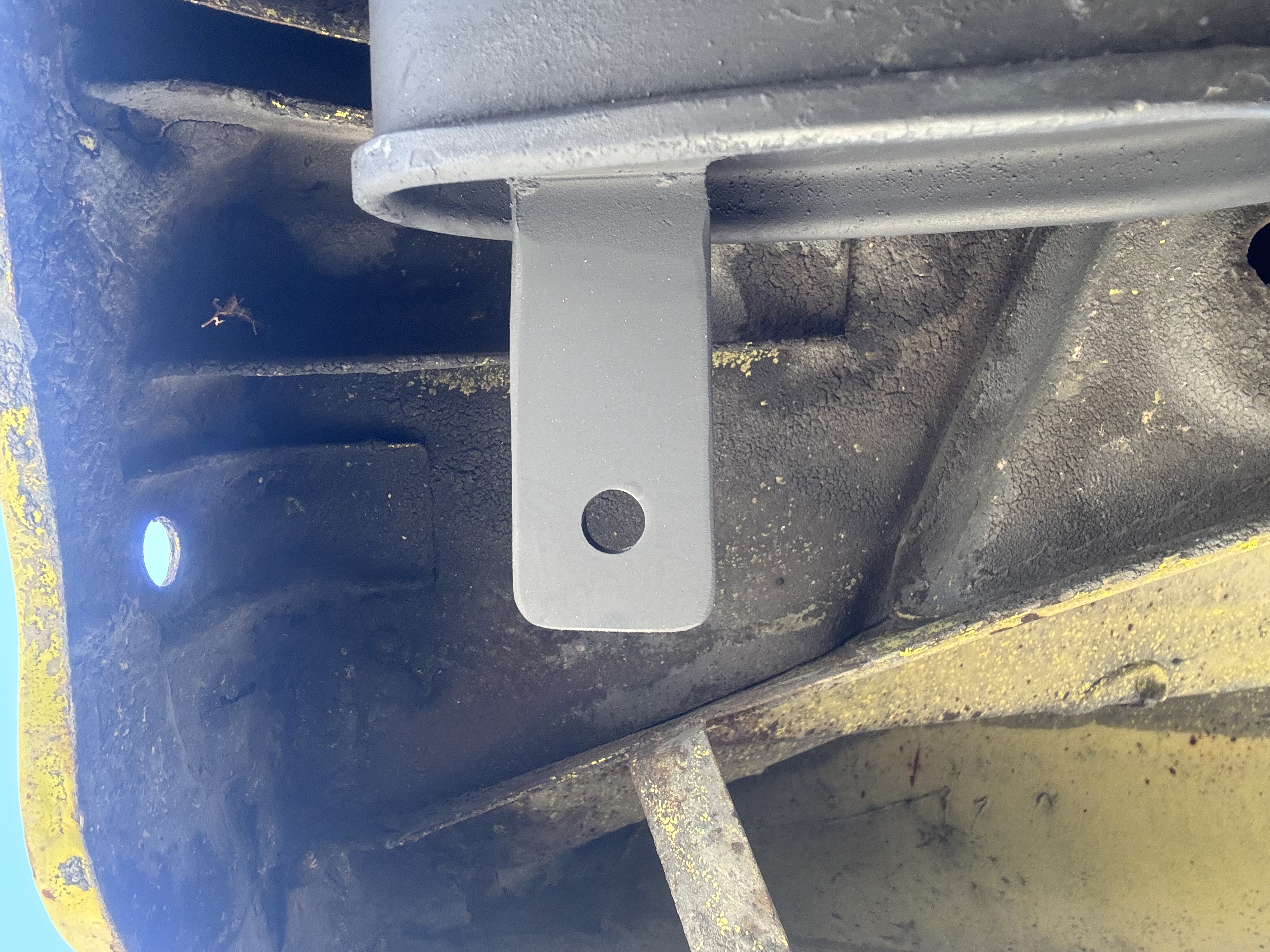

Added a tab to either side to pick up the weight in the rear.

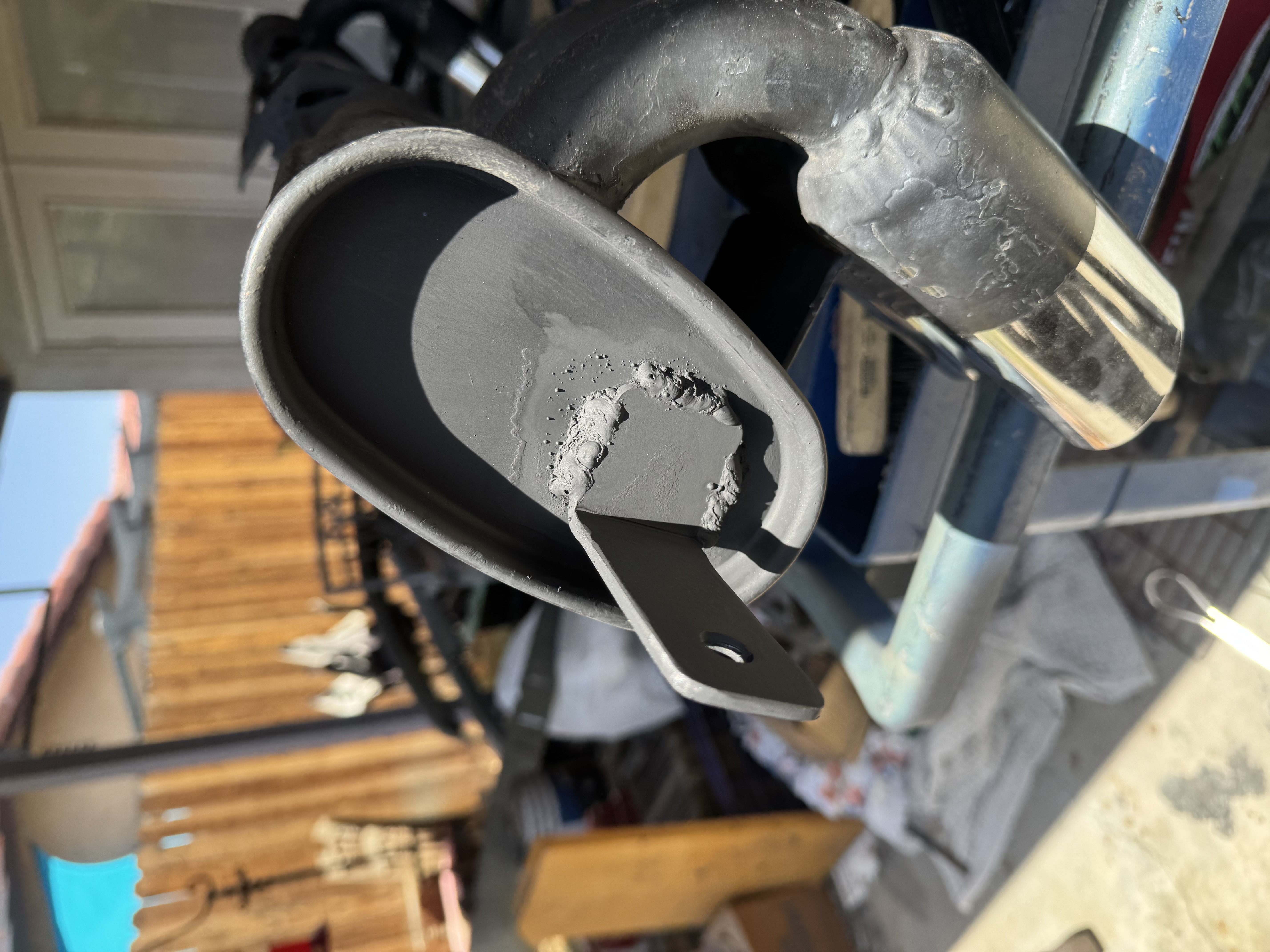

I’ll drop a carriage bolt down from the corner of the trunk. Even though I have semi solid mounts, if the engine needs to torque I’m going to sandwich the tab with springs top and bottom, washers and lock nuts. It will still hold the weight but should allow a little torque movement.

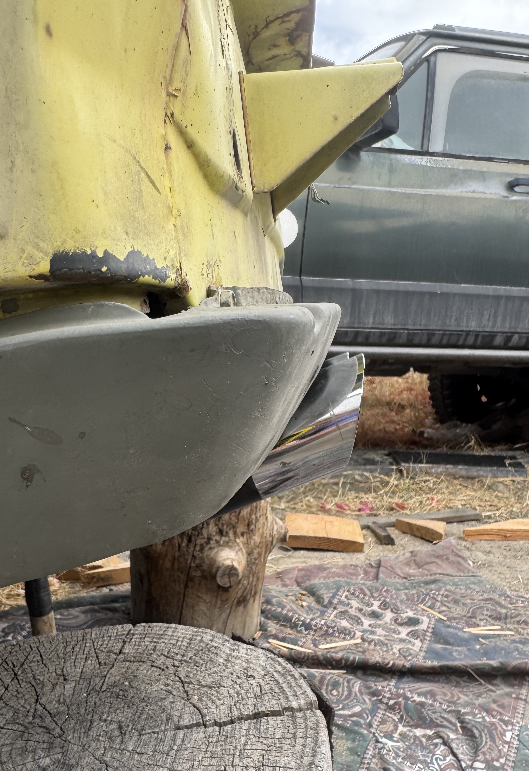

Thanks to Marty and the good folks at PMB I was able to get the dimensions I needed for the final cut on the tubes. Same size as the exit of the header.
