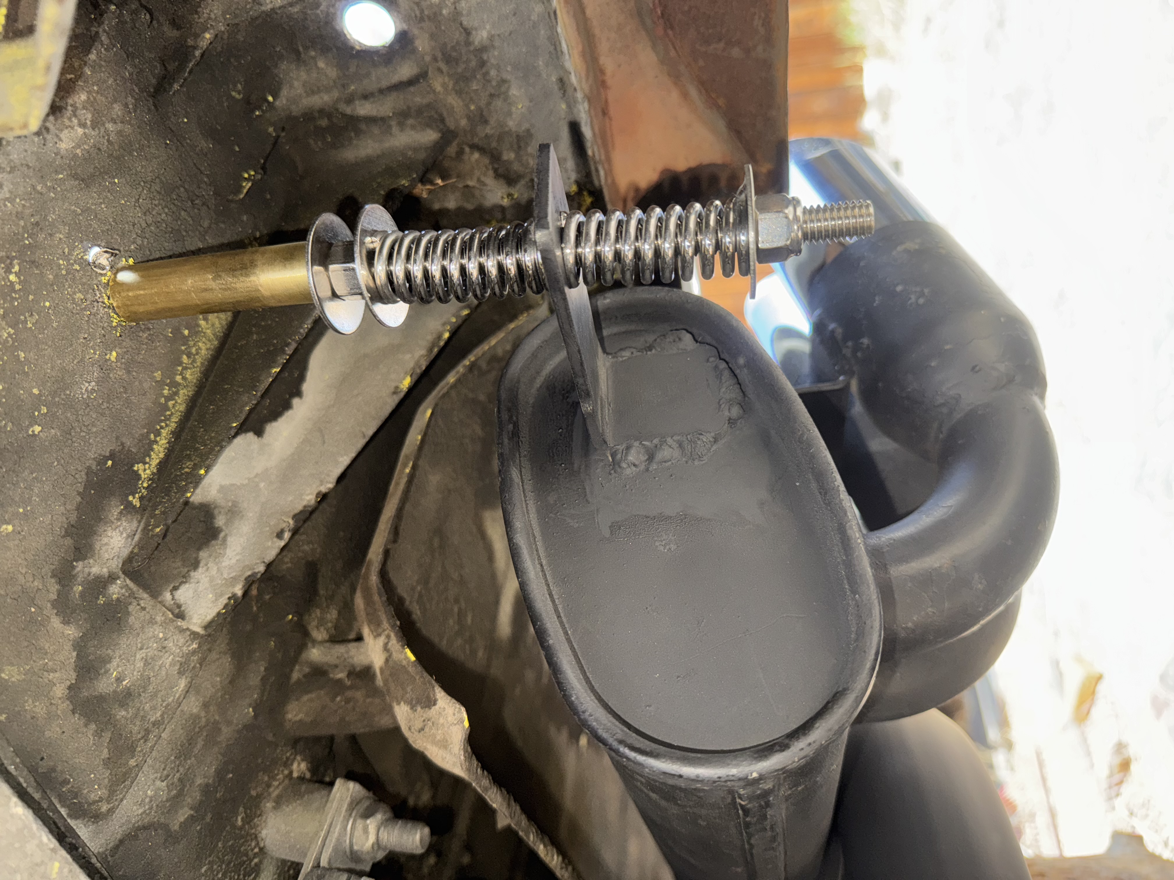

Rear mount to pick up the weight and allow torquing of the engine if needed. It is all non-ferrous

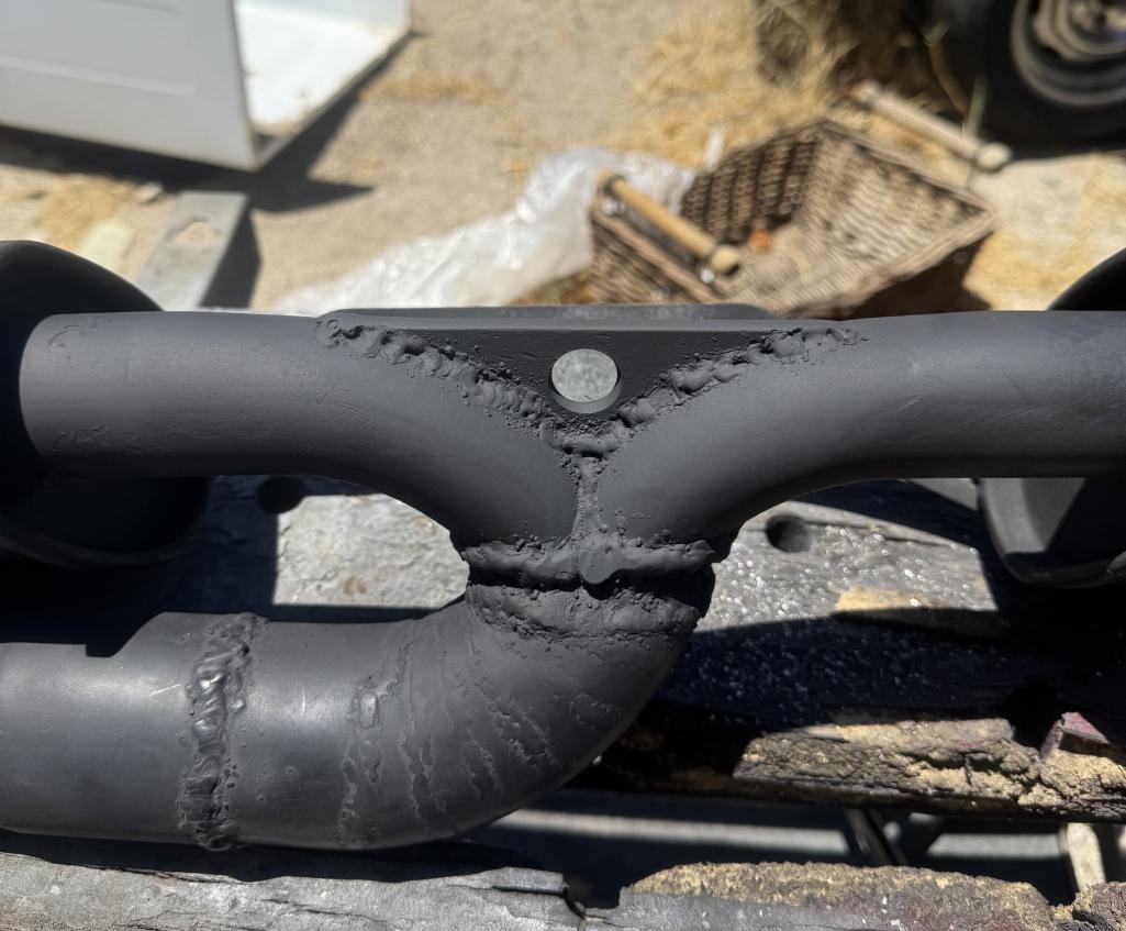

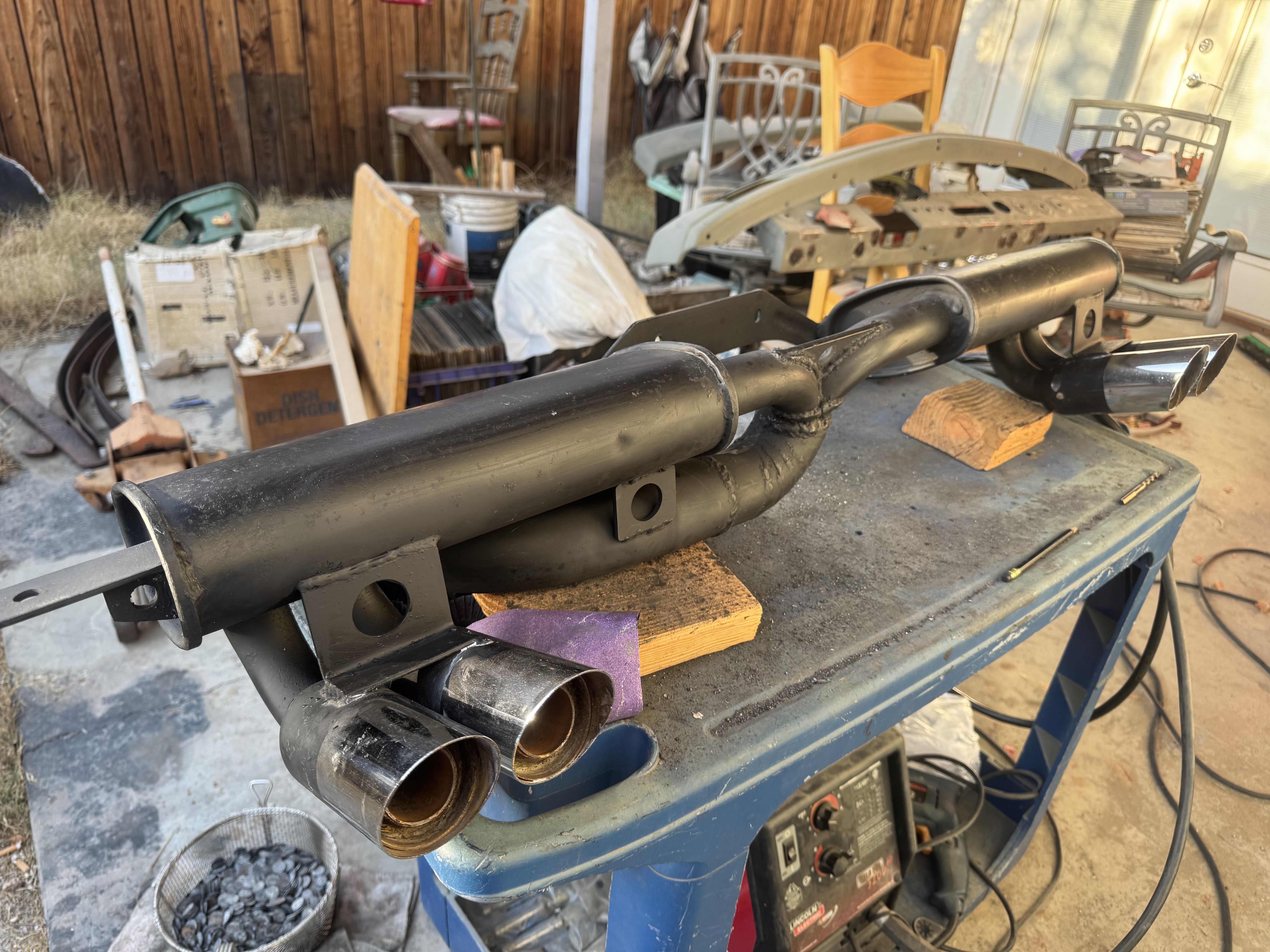

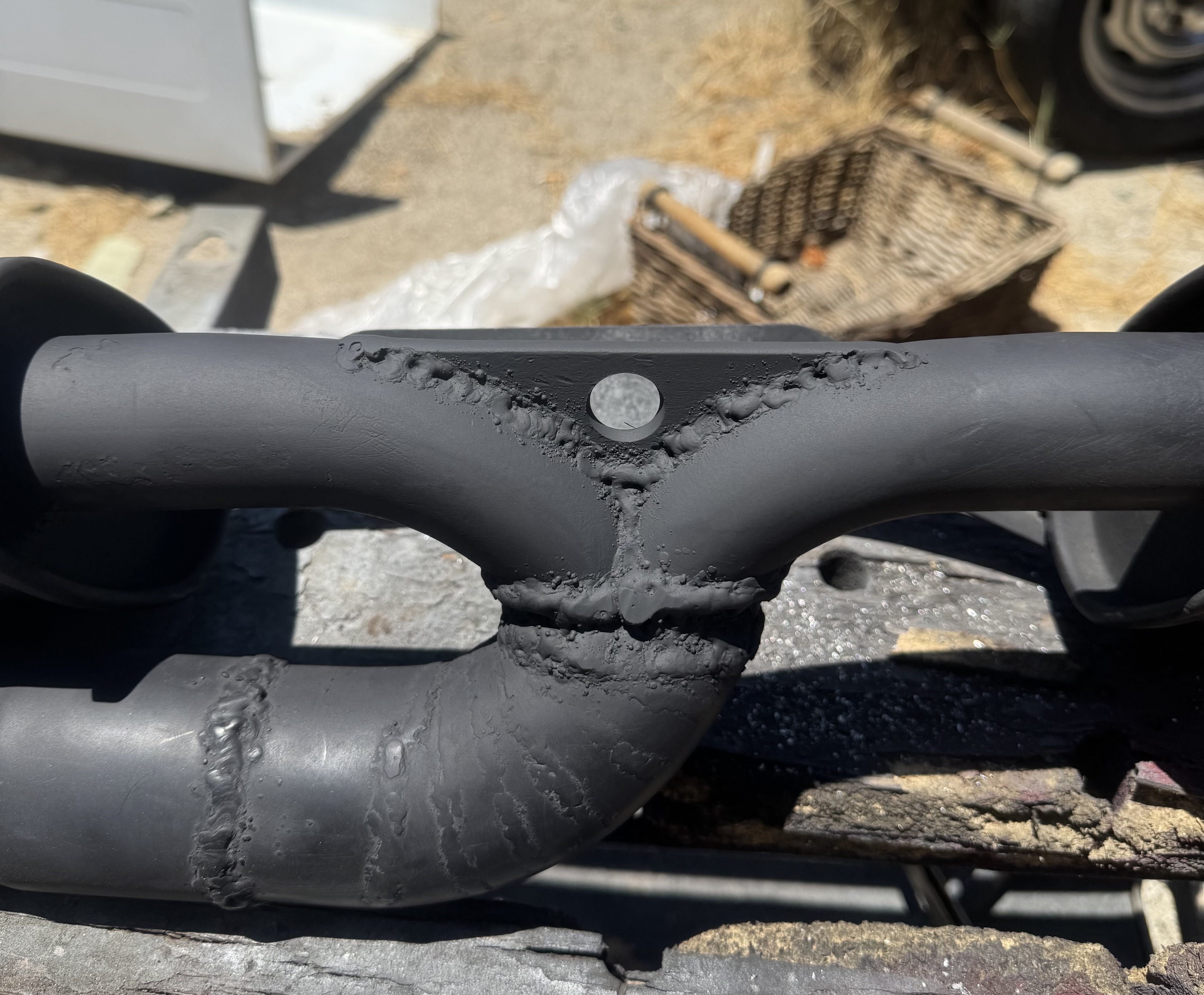

Since most of the other tubes were cut away leaving these two and the rear support
to hold it from folding I added a brace where the two come together in the middle. Finished till it gets welded to the header collector, then I’ll media blast it and it will get a coating. One less thing. (IMG:style_emoticons/default/smile.gif)

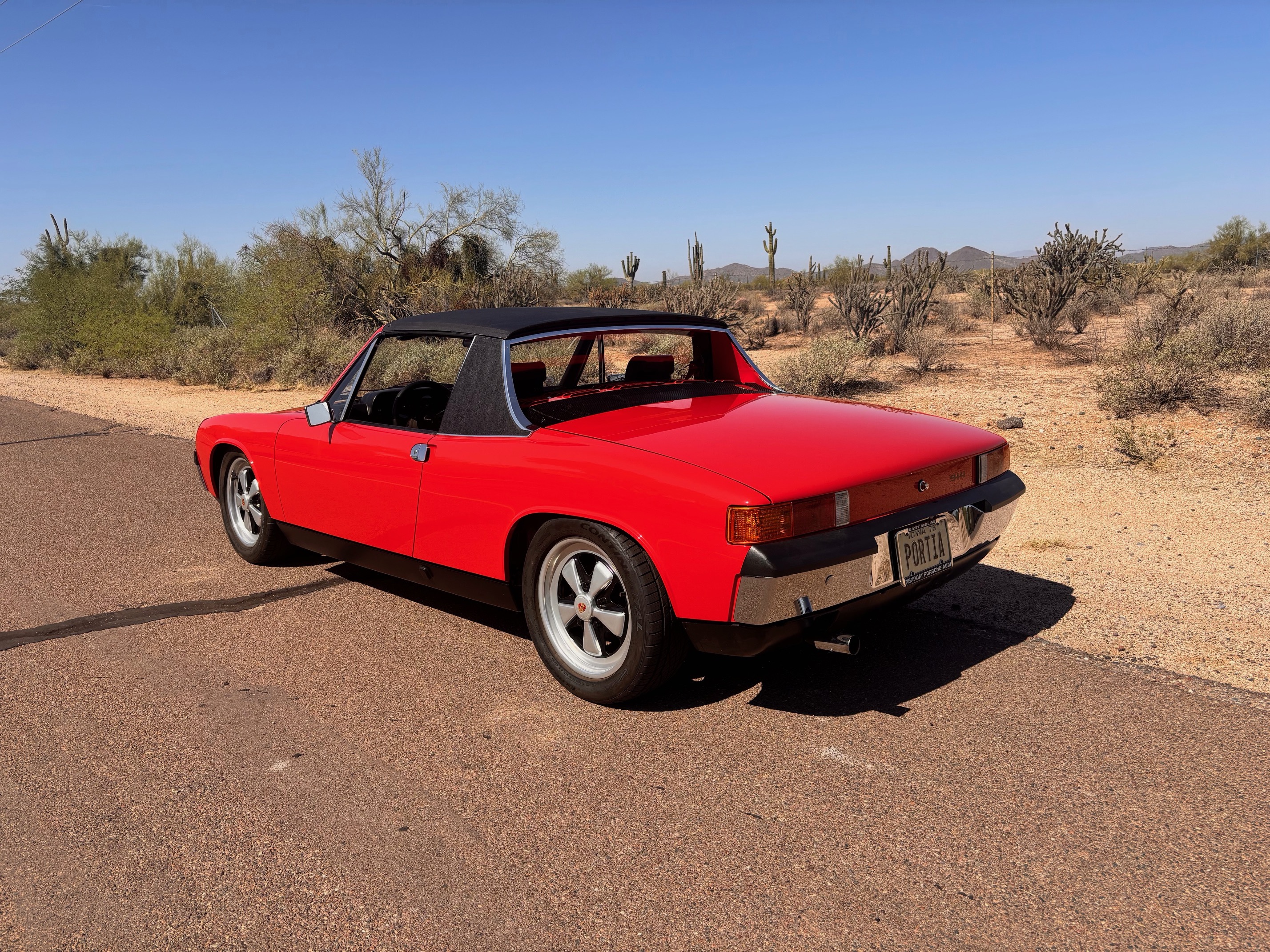

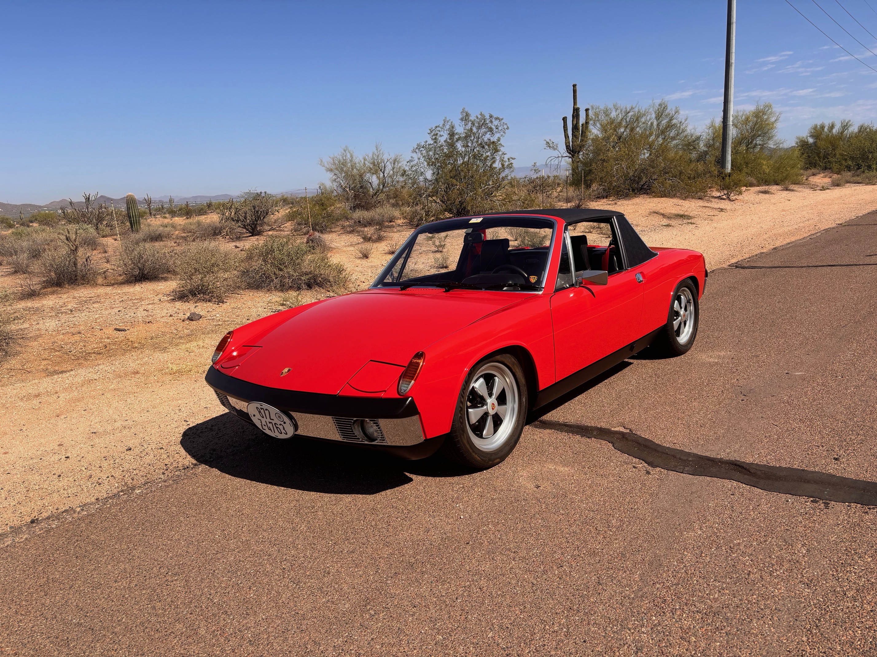

Longest shake down cruise after engine swap. Running great but need to do a little shift linkage adjustment- popping out of 5th. Hadn't gotten it into 5th since the swap- everything else feels good!

one more pic- got out before it got too hot...

Very nice! (IMG:style_emoticons/default/driving.gif)

Great Pic!
Love that color against the dessert setting…perfect.
Chrome bumpers look clean as well with that color. (IMG:style_emoticons/default/first.gif)

Thanks guys. Back bumper is original- I rechromed the front after taking off the tits and filling in the holes... like the clean look.

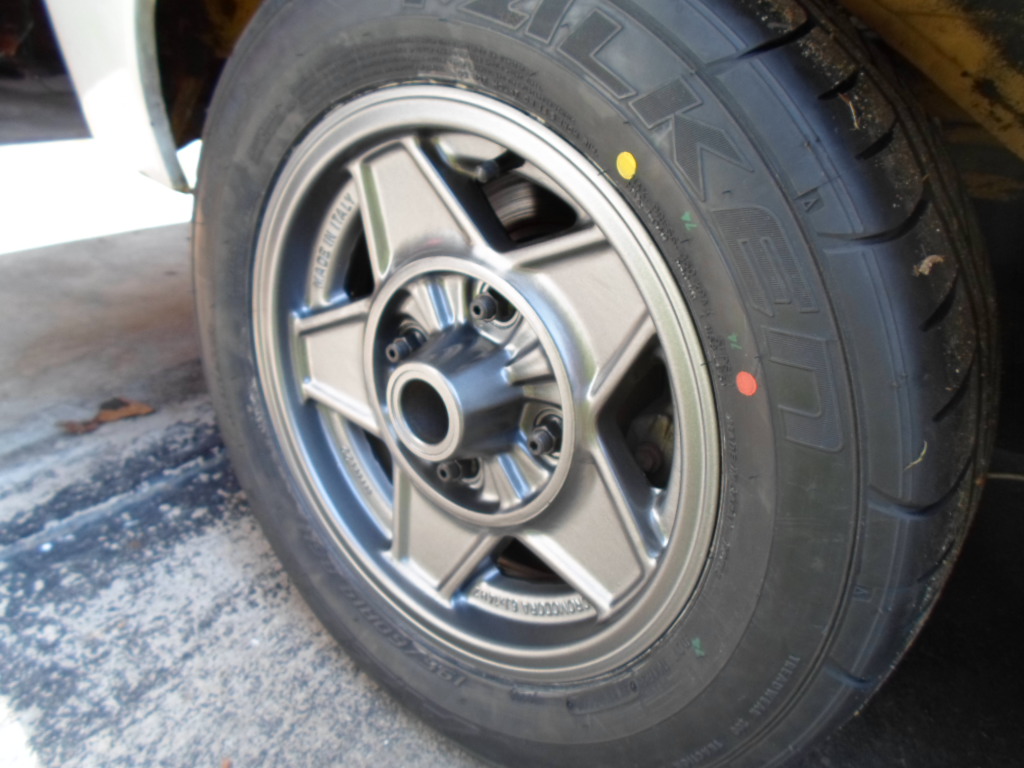

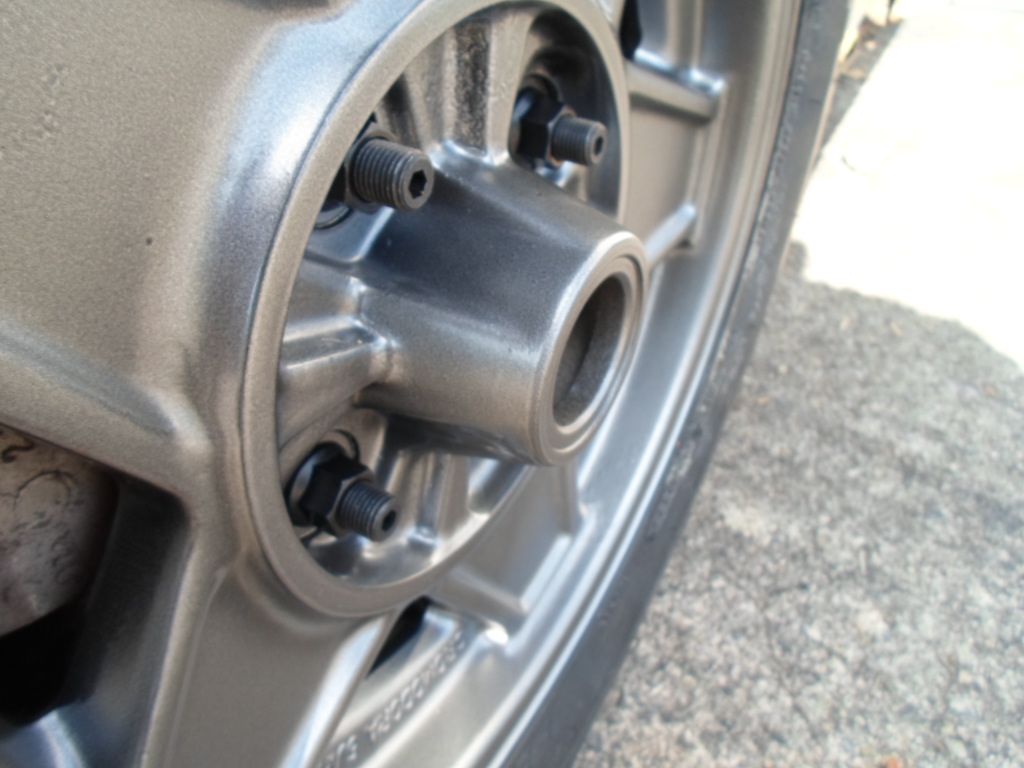

With the original intention of rolling my passenger rear fender, I ended up mounting my new tires and wheels. The fender "rolling tool" didn't fit my wheel studs in either pattern or size. Since they are now 14" wheels, I figured I'd just give it a shot. Long story short, I need to lower the car some, which I planned on doing anyways, but there aren't any clearance issues for now.
Some folks wanted to know how far the wheels studs protruded past the lug nut....about 3/8's of an inch on the rears and about 1/2 inch on the fronts. I was pretty pleased with the result, but I might have gone a little longer if I did it again. If you want a more "flush" look, you'd have to go shorter. These were 61mm studs with a 44mm shank. Here are some pics:

I was mistaken, now the fabrication is done. So glad, it is 110 out there.

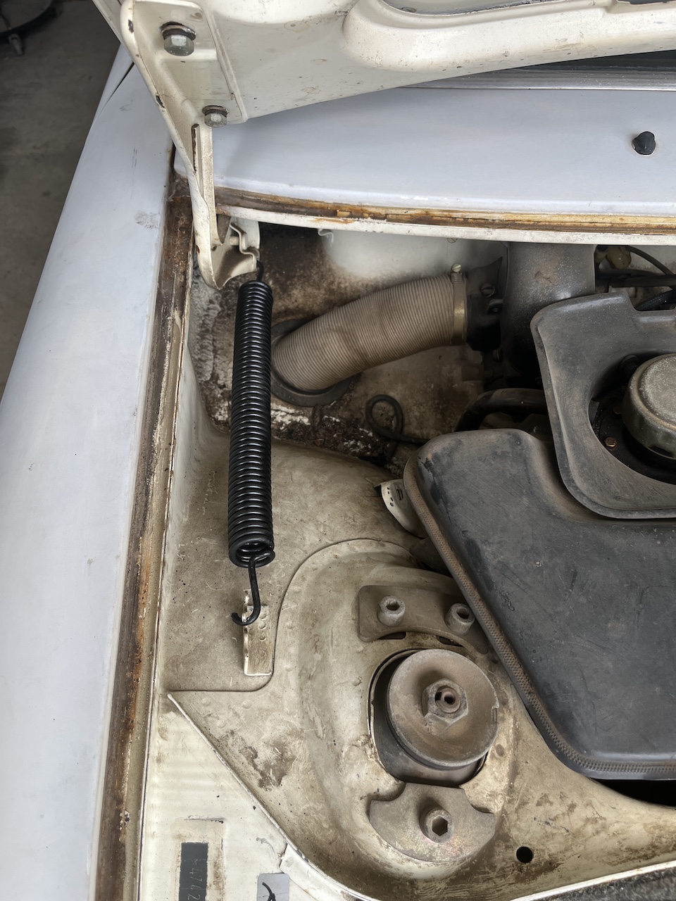

Tried to install hood springs, lol

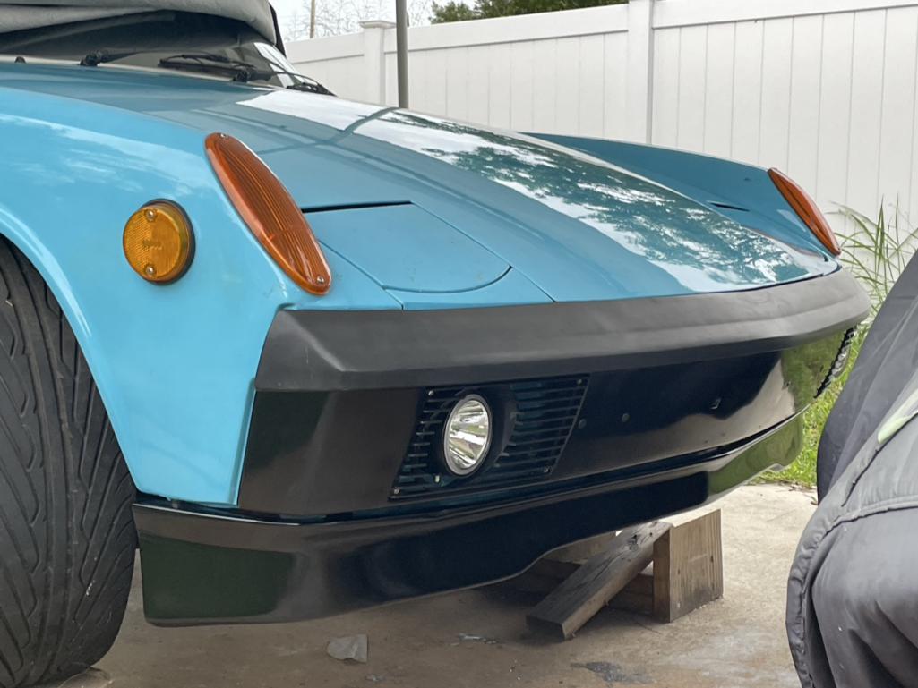

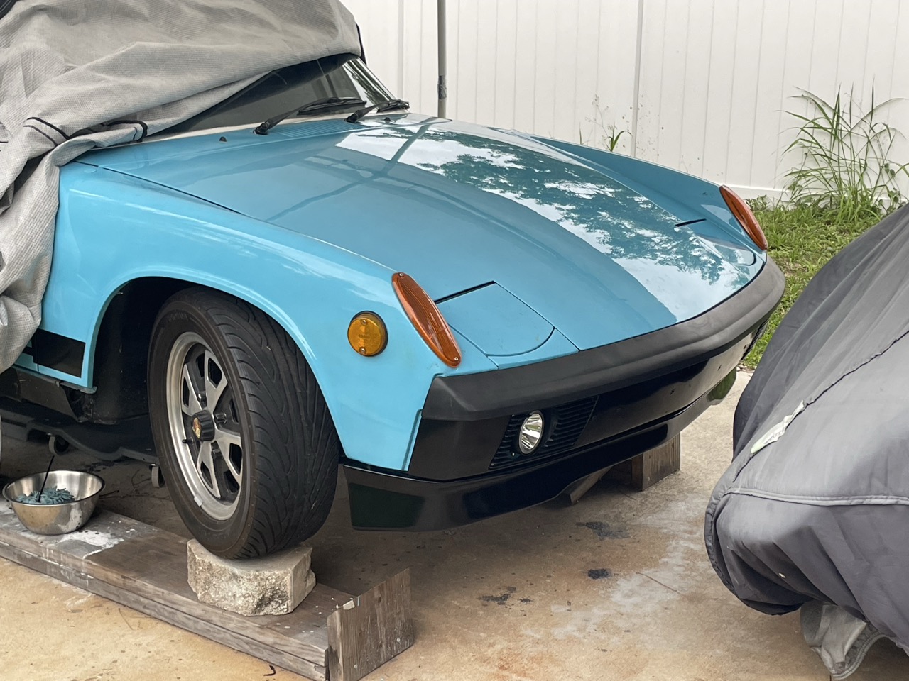

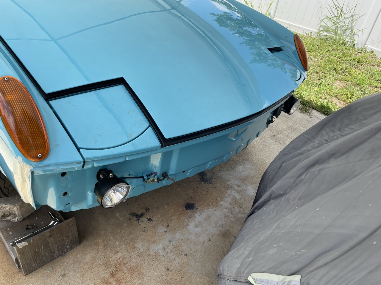

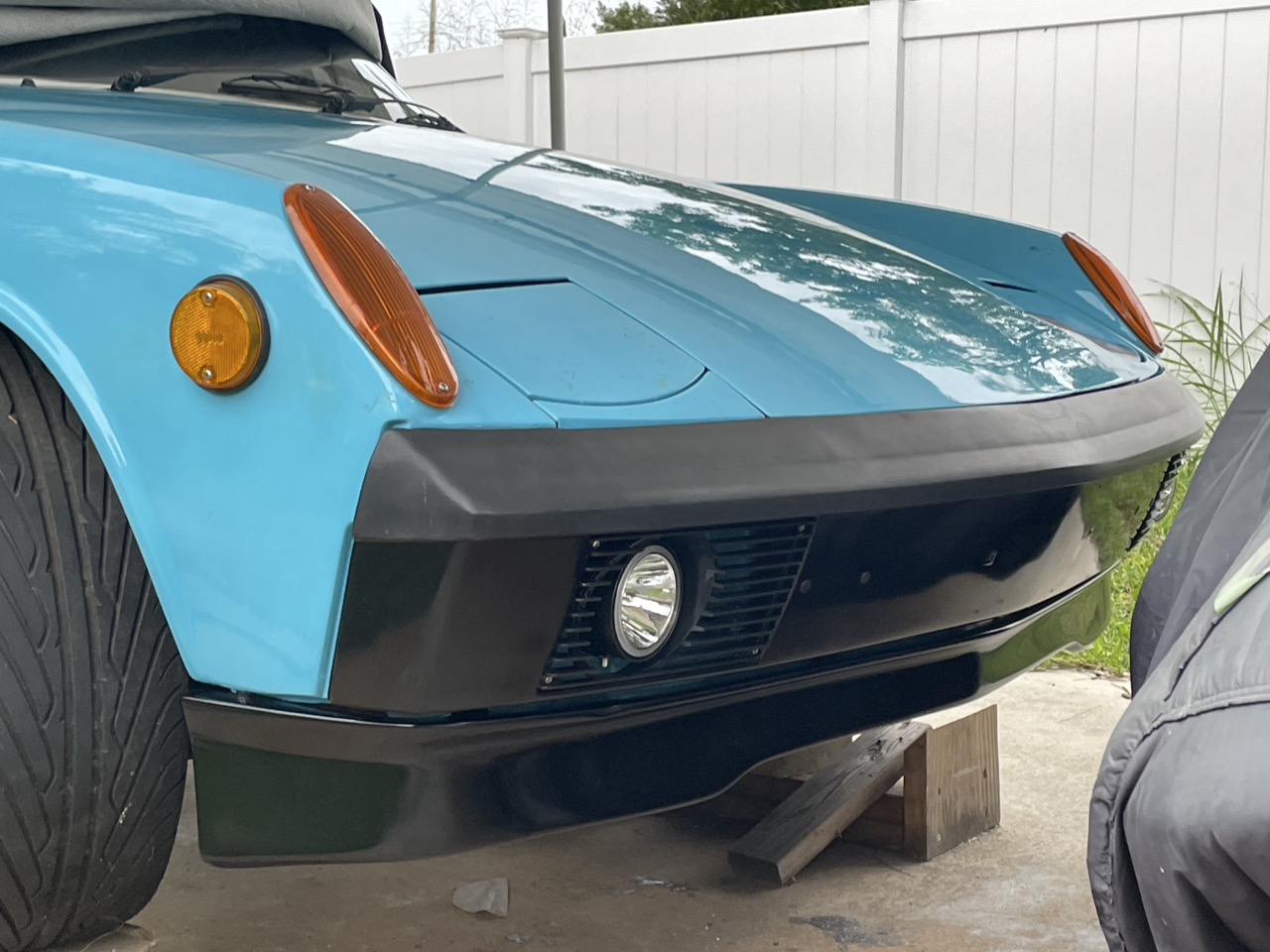

Finally finished up the front end! Had to fix old previous shotty body work and repaint the front section. Refinished the bumpers and ground effects, and added LED driving lights. Took a few weeks, but finally done (IMG:style_emoticons/default/beerchug.gif)

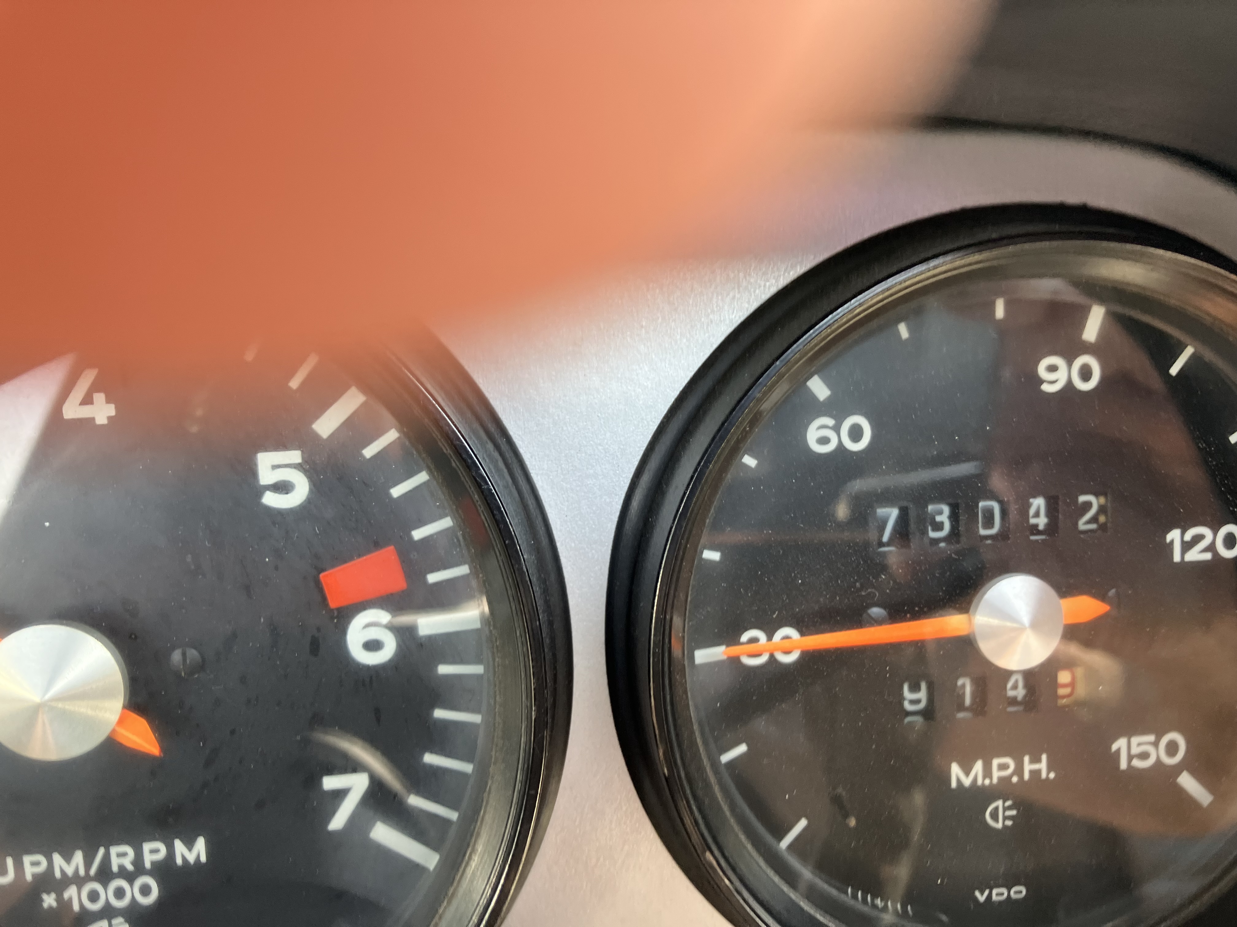

Drove my 1973 which I’ve owned since 1980 today and watched the speedometer hit 73 thousand and then the trip reader hit 914! Man I need to buy a lotto ticket! (IMG:style_emoticons/default/piratenanner.gif) (IMG:style_emoticons/default/lol-2.gif) (IMG:style_emoticons/default/av-943.gif)

Would have been perfect if you hit 73 mph...

Man I didn’t think of that! But I do find it hard enough to get the phone around the steering wheel, watching traffic and take the picture!

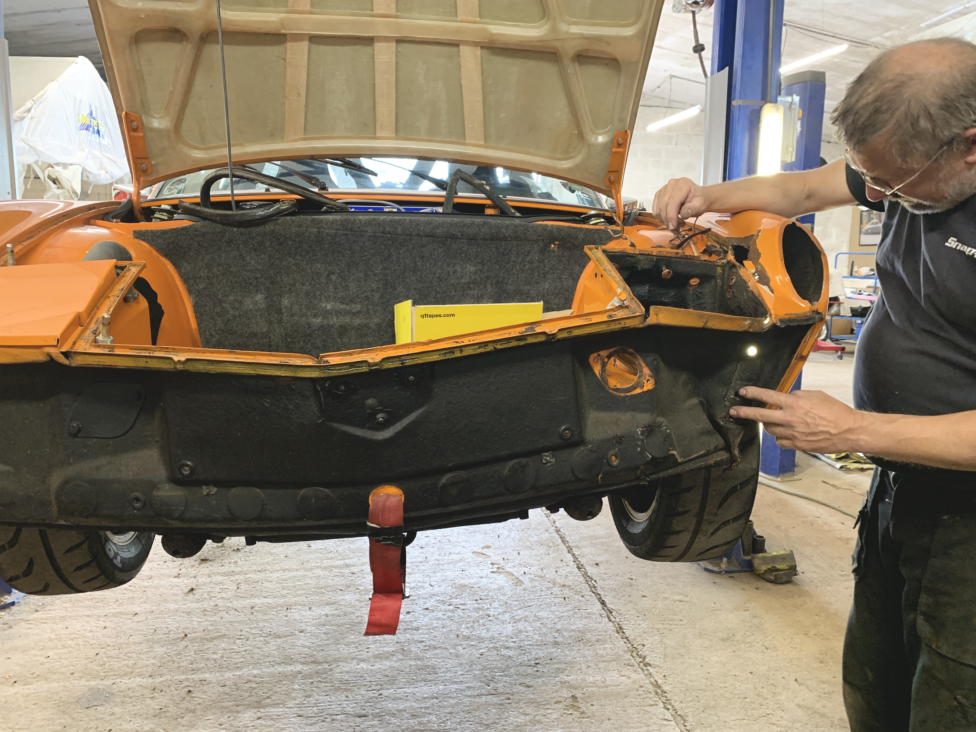

Began stripping the front end ready for going on Celette jig to repair damage following my "off" at the St Gouéno hillclimb! Not pretty but all reparable...
