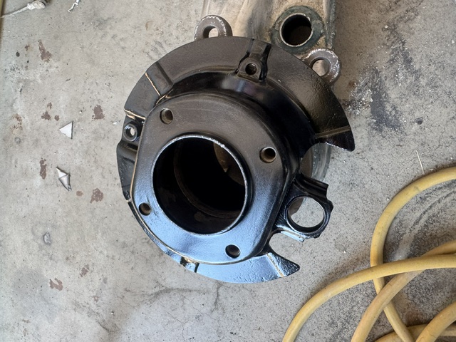

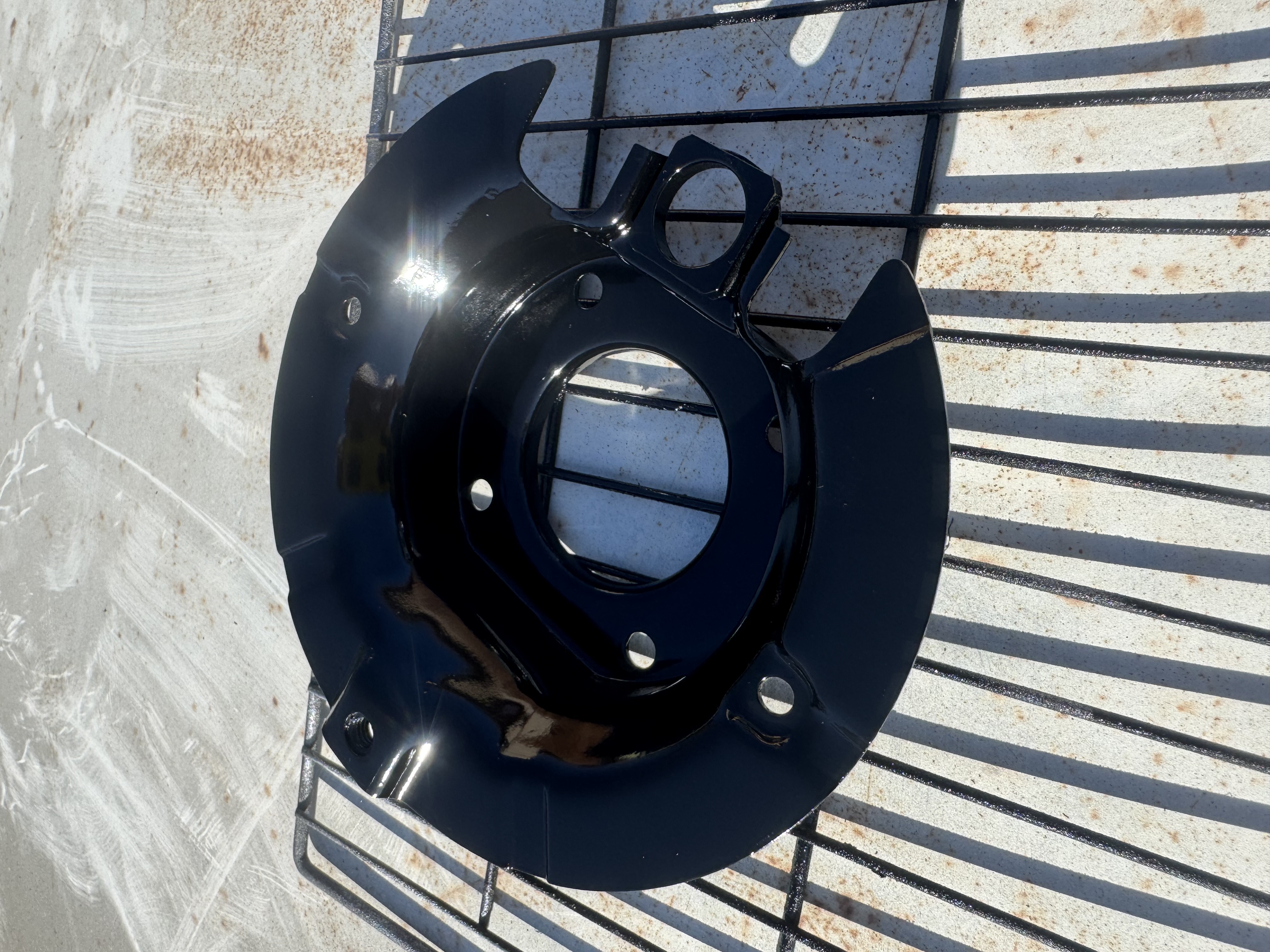

@Shivers , I use this h2o based Citrus Strip, after brushing on let sit 1> 2 hours and then the black paint easily falls off with an old tooth brush.
Rinse then final on a wire brush wheel. Otherwise that 914 black paint gets warm from a wire brush wheel and gets sticky...hard to work with.

Thanks Marty, I'll try it. (IMG:style_emoticons/default/smile.gif)

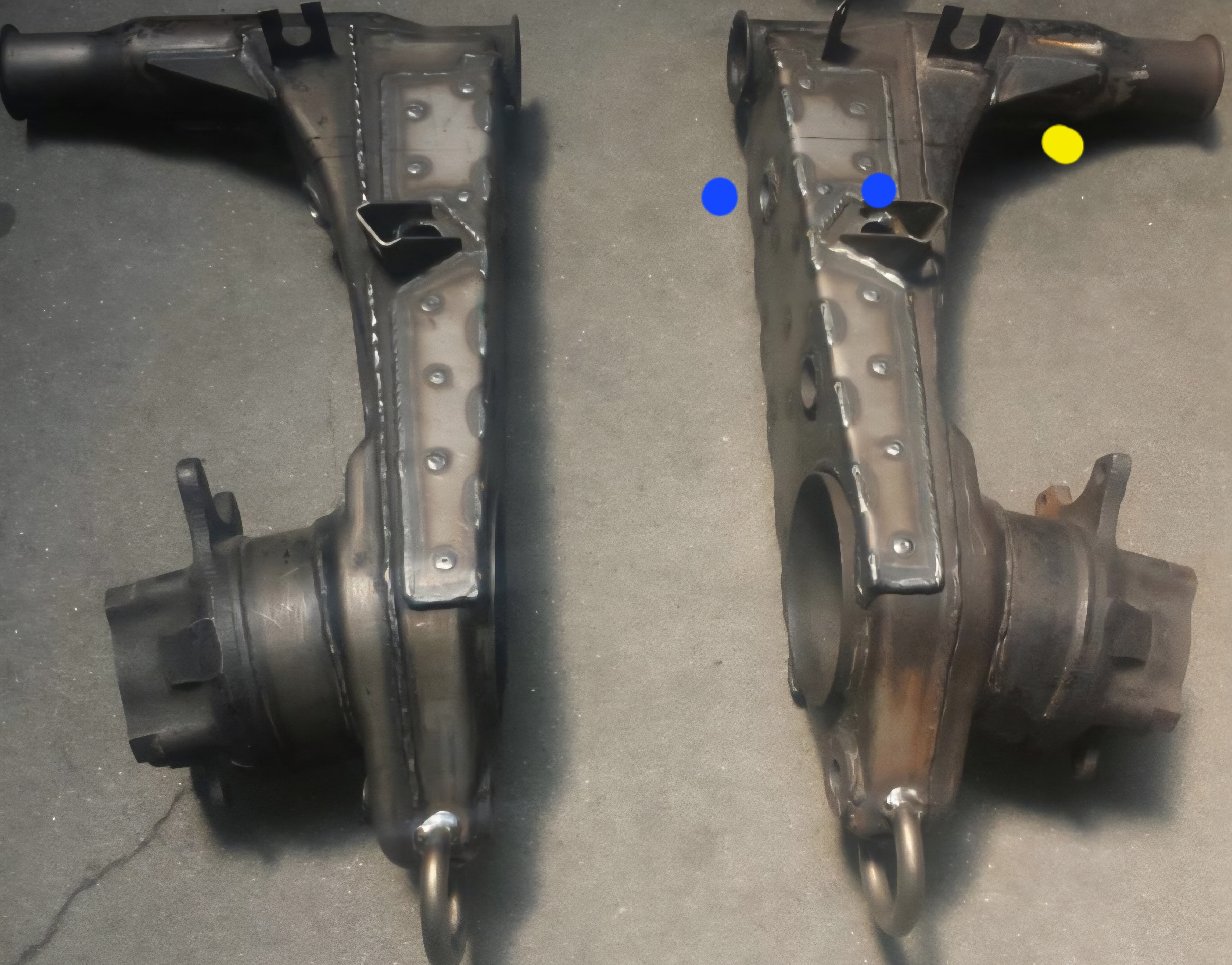

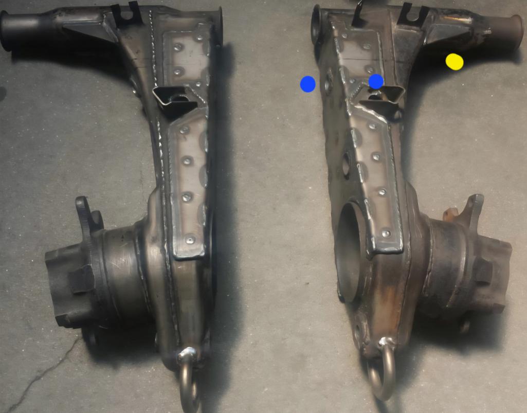

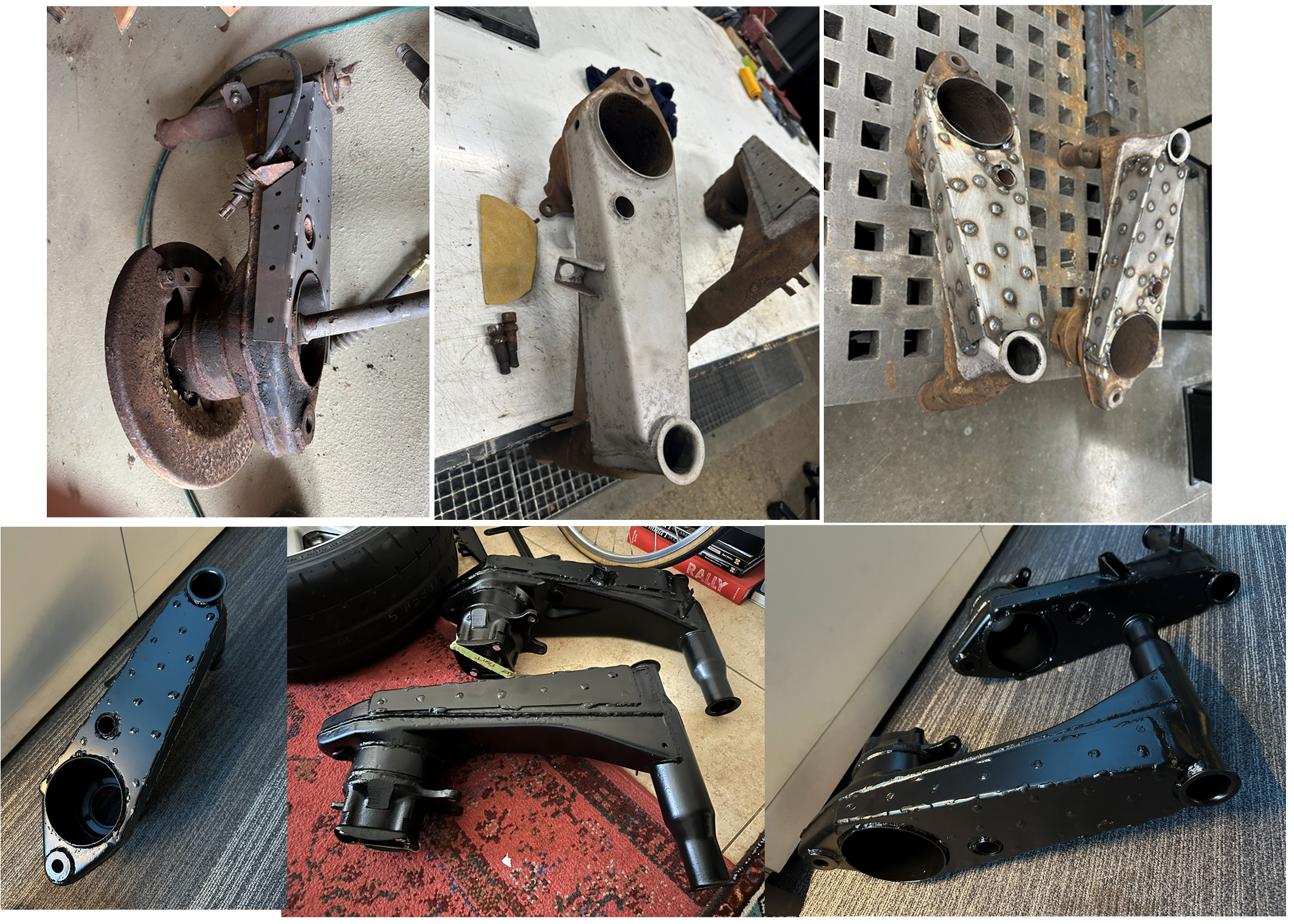

A friend offered to help finish the arms. Glad he did. More than adequate for my needs

Why the 3 tubes, more support?

QUOTE(Geezer914 @ May 18 2026, 05:16 PM) *

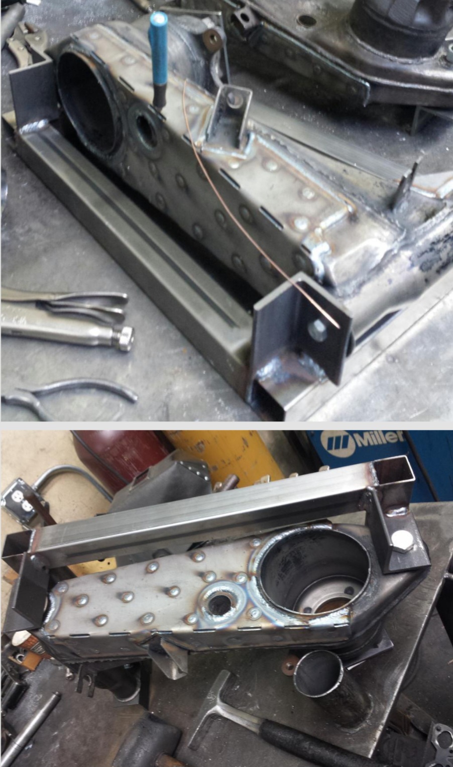

I'm a beliver in the stronger the better, so I add a .125" ga. round tube in one axis, and another tube in a cross axis (through the p-brake cable bracket). All welding done in custom jigs. Mad Dog sheet metal strengthen kits welded in; and a semi-circle ring welded on for trailer tie down.
Small .125" thick gussets added as well to trailing arm bushing-housing. Measure your tire clearance in this area before final welding.

Assembly jigs required as welding heat/ cool cycles shift dimensions around, can't be good.
