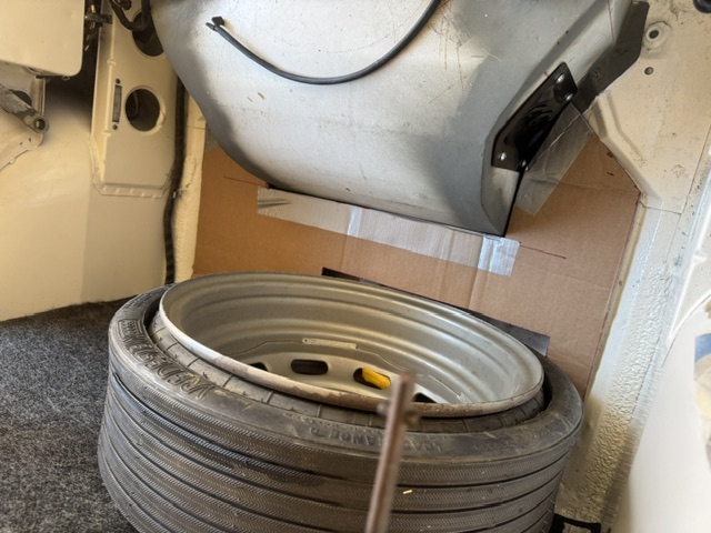

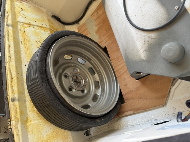

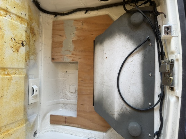

With the oil lines going through the frunk the stock floor I modified would not work. It landed right where the oil lines run. Then I noticed a shelf on either side of the floor pan. Puts me below the lines and still enough room for a tool kit and a pair of mechanics gloves. It too will be covered with perlon. That will work.

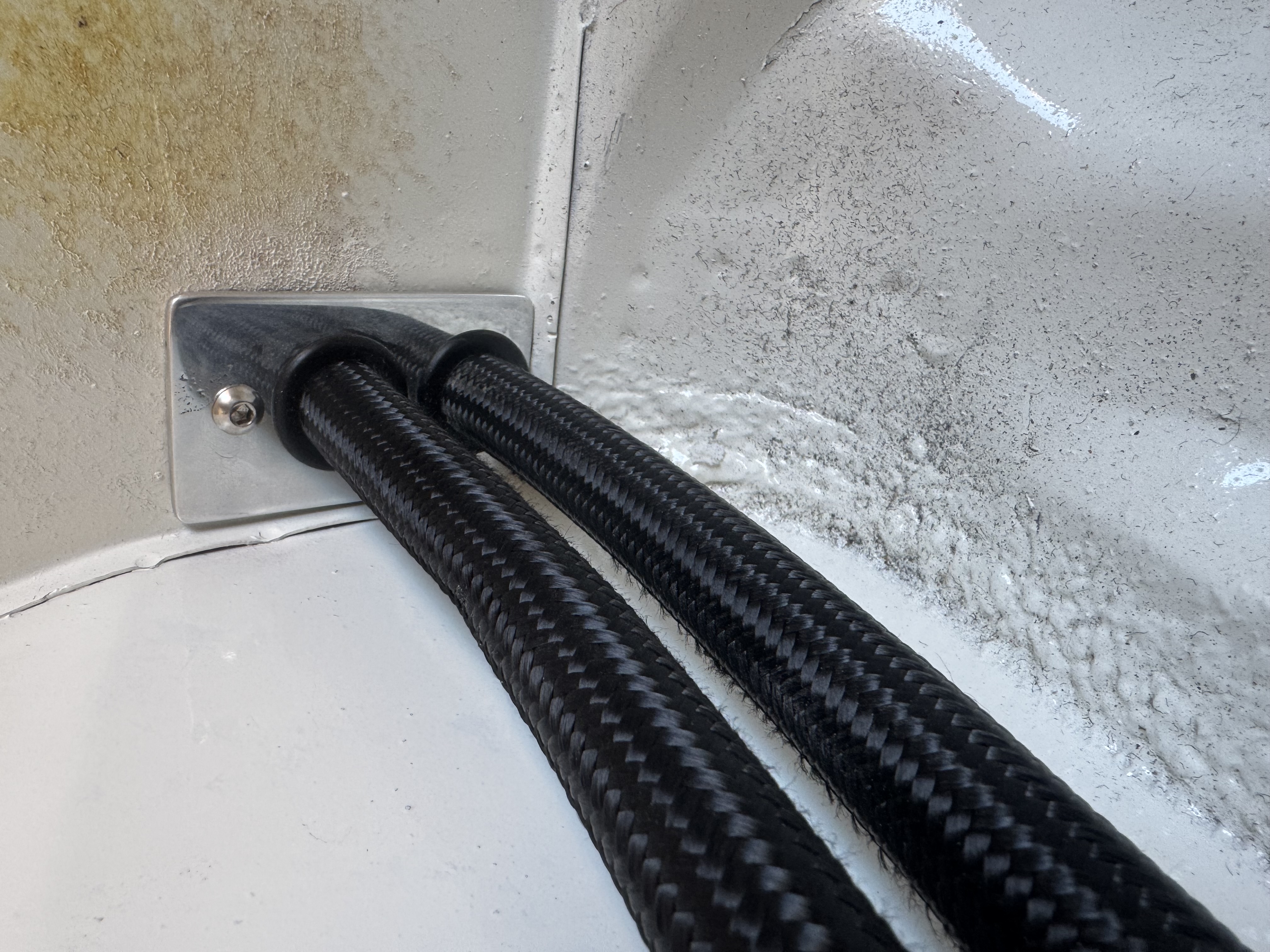

Laundry day (IMG:style_emoticons/default/biggrin.gif) Cleaned up real nice and got the grommets for the oil lines in. It is hot and humid so to avoid a stroke I think I am done outside for the day.

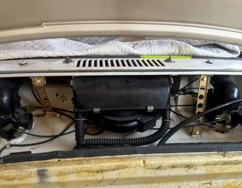

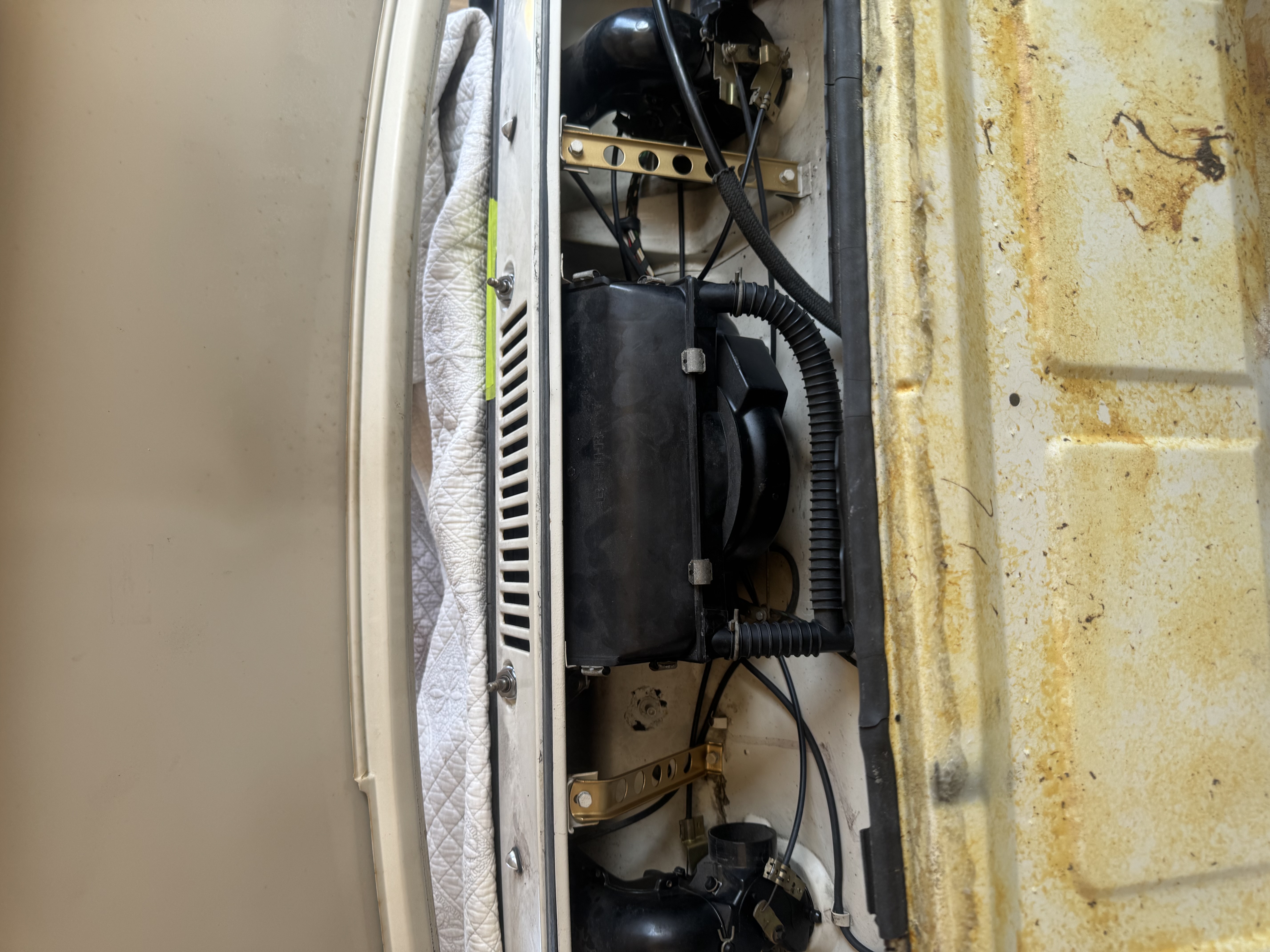

Windshield wiper assembly, fresh air box and some braces with holes in them.

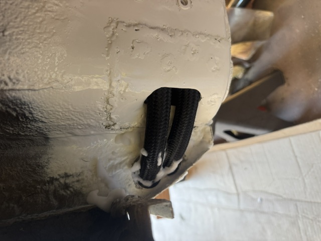

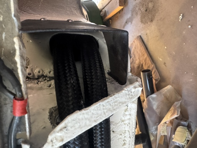

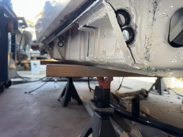

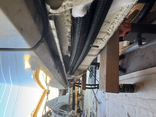

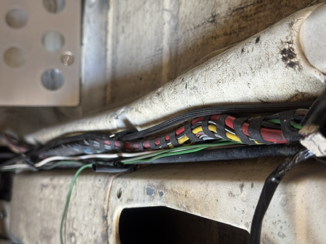

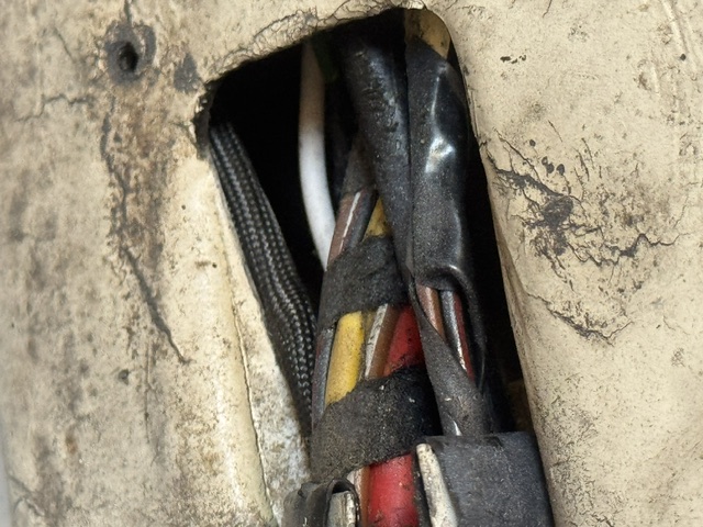

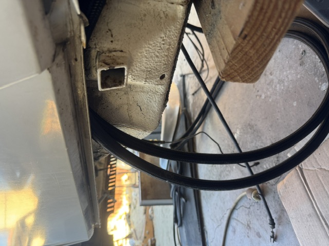

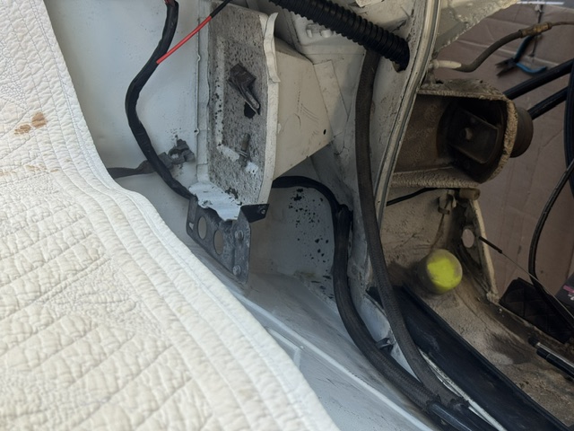

More "Fun" today. I started early and still Sweatball city. You live in a desert dummy. Pulled the oil lines, got it done but my hands are on strike. Bashed them good. Dang. I was looking for elephant snot wire pulling lube. Yellow slippery and a darn mess. But I ran into a foam lube and it worked well enough, and very little residue so my new go to. So glad to have that done. Pics:

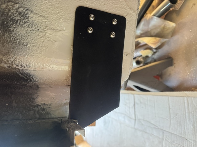

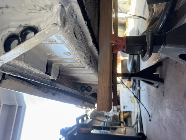

Oil line guard. I'm done for the day

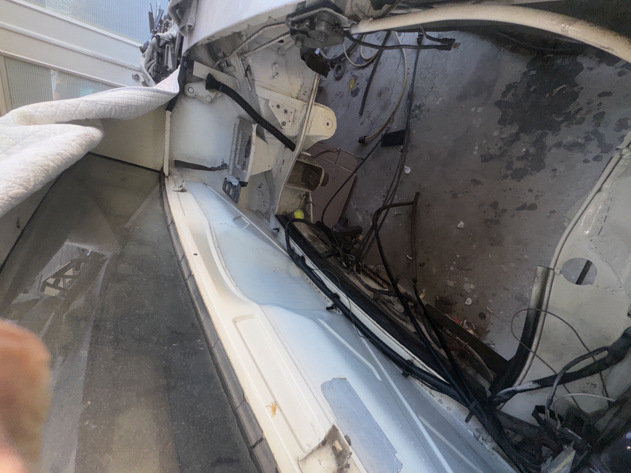

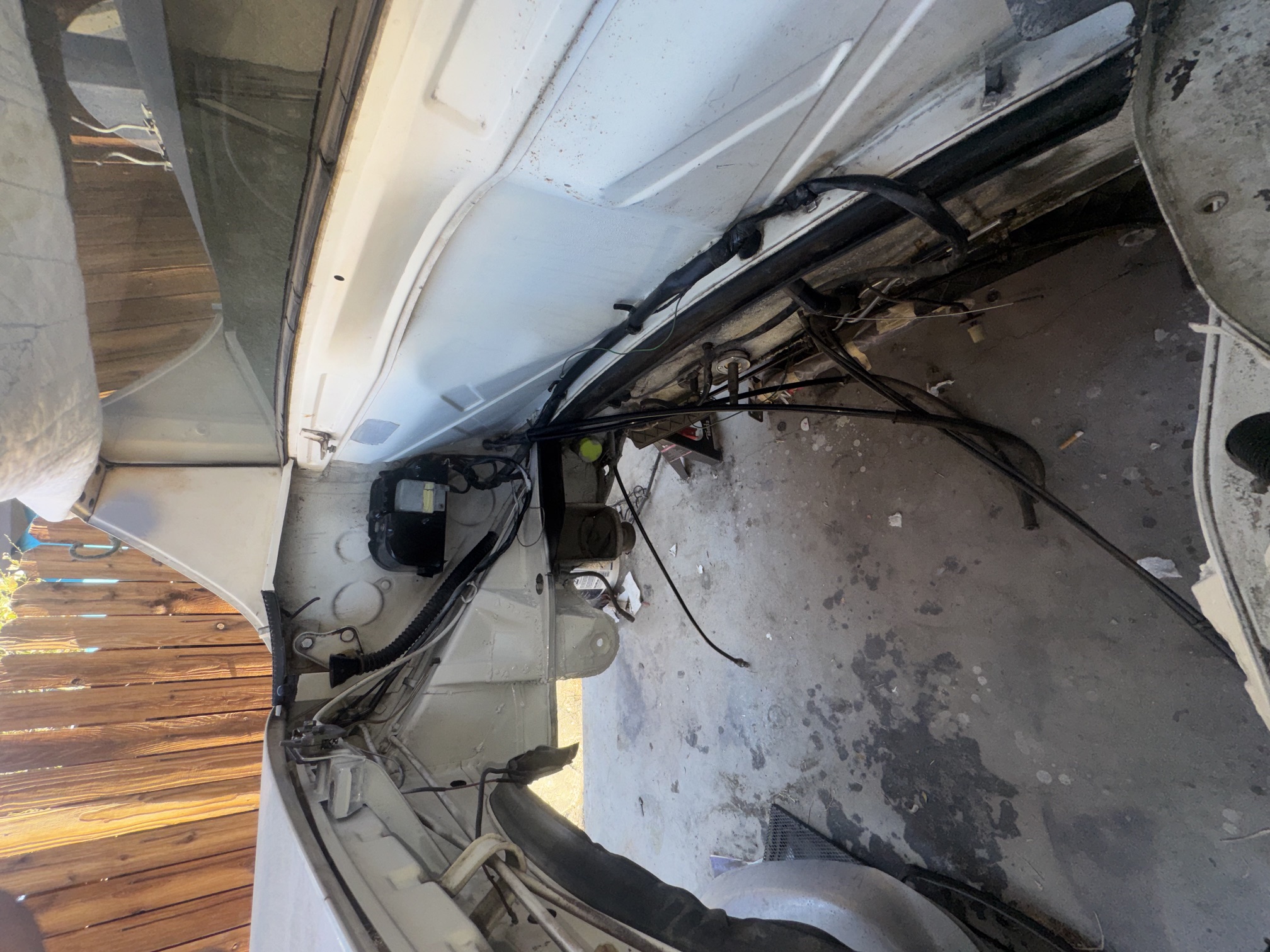

Nothing real exciting, except maybe for me. Sun came up and I was in the engine compartment. Scrubbing like crazy. Look below the shelf and it was similar to that.
I was thinking of painting, that thought has been downgraded. Go in there tomorrow and do one more pass and I think touch up will do.

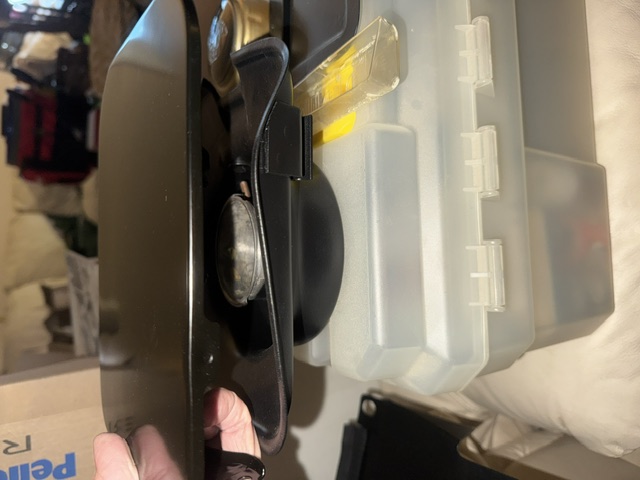

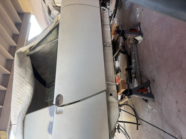

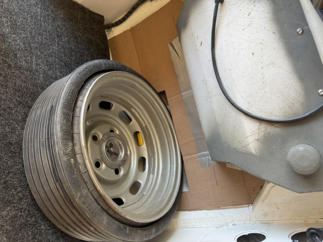

I've been working the shape of this lid to match the hood. little more work in the morning. I was worried it would be too small. No worries.
Don't hate me. (IMG:style_emoticons/default/welder.gif)

Your oil line work is looking good, and the space-saver spare (plywood) cutout looks trick ! Just don't dehydrate out there under that backyard roof >>Drink a lot of cool h2o. My workshop in the City gets a bit of a breeze, I have large fans but always humid inside and sweat running into my eyes, time to cool off & change tee shirts. I use neosporin on my cuts and bruised hands, arms...actually works good overnight too. Us old guys need to be careful with our thin skin (IMG:style_emoticons/default/dry.gif)

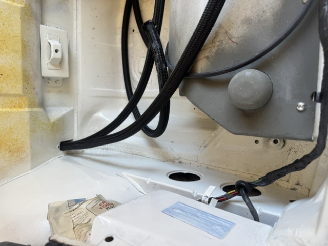

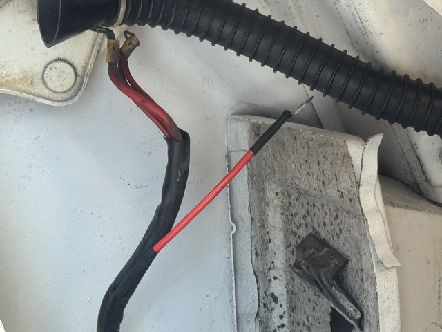

Finally got the wire I needed (#10) and the kevlar jacket for it. I have one high amp run through the tunnel from the battery to a relay in the cab. I made sure I have a good chance of no shorts from that wire. It will feed some type of rally lights up front. Vintage is out, add a few years to them and they turn to gold. But Hella makes the 4000 and it is a nice pencil beam driving light.

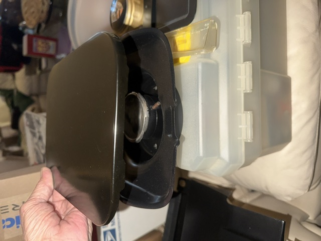

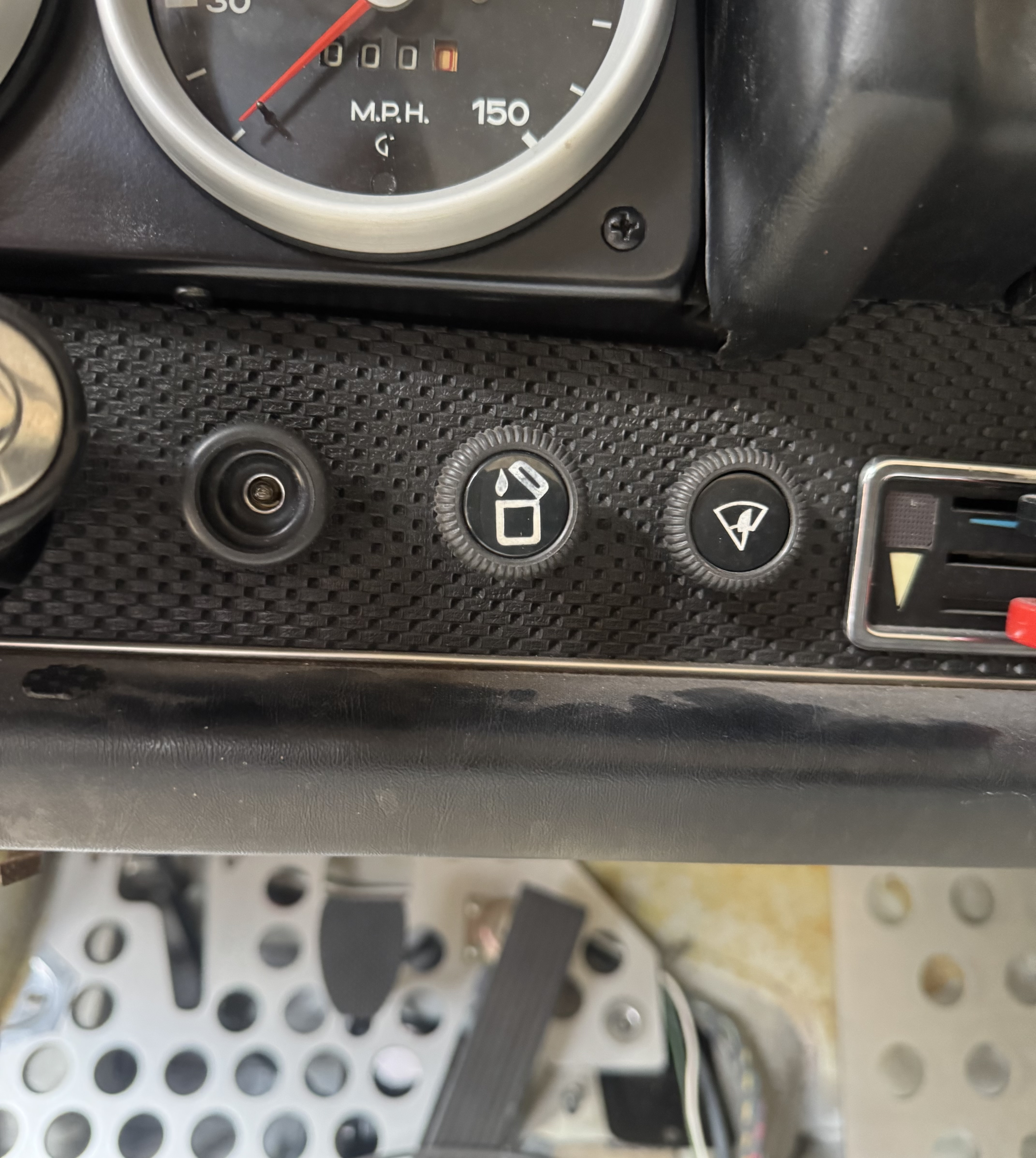

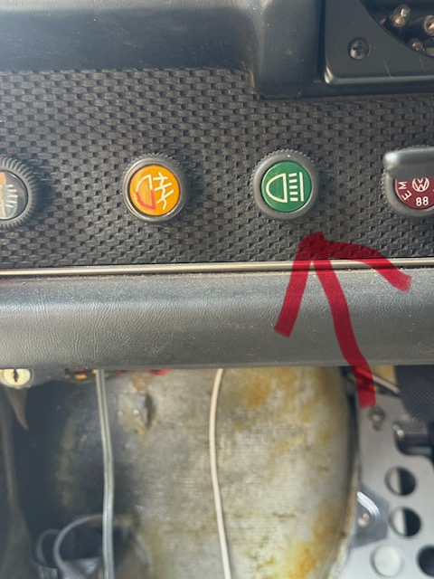

I’m putting in an electrical pump for the windshield washers. It’s a 1971 so the wiper switch is on the dash. So I started looking for a switch to replace the cigarette lighter. But dog gone I didn’t want to remove it and could not find a switch I was happy with. I’ve got six knobs across the dash, my head said just about anything you put there will look funny. Just about anything, except maybe another factory knob. I’d like to find an early one but this will do for now. Found a black identification insert. Sanded it down and polished it.
