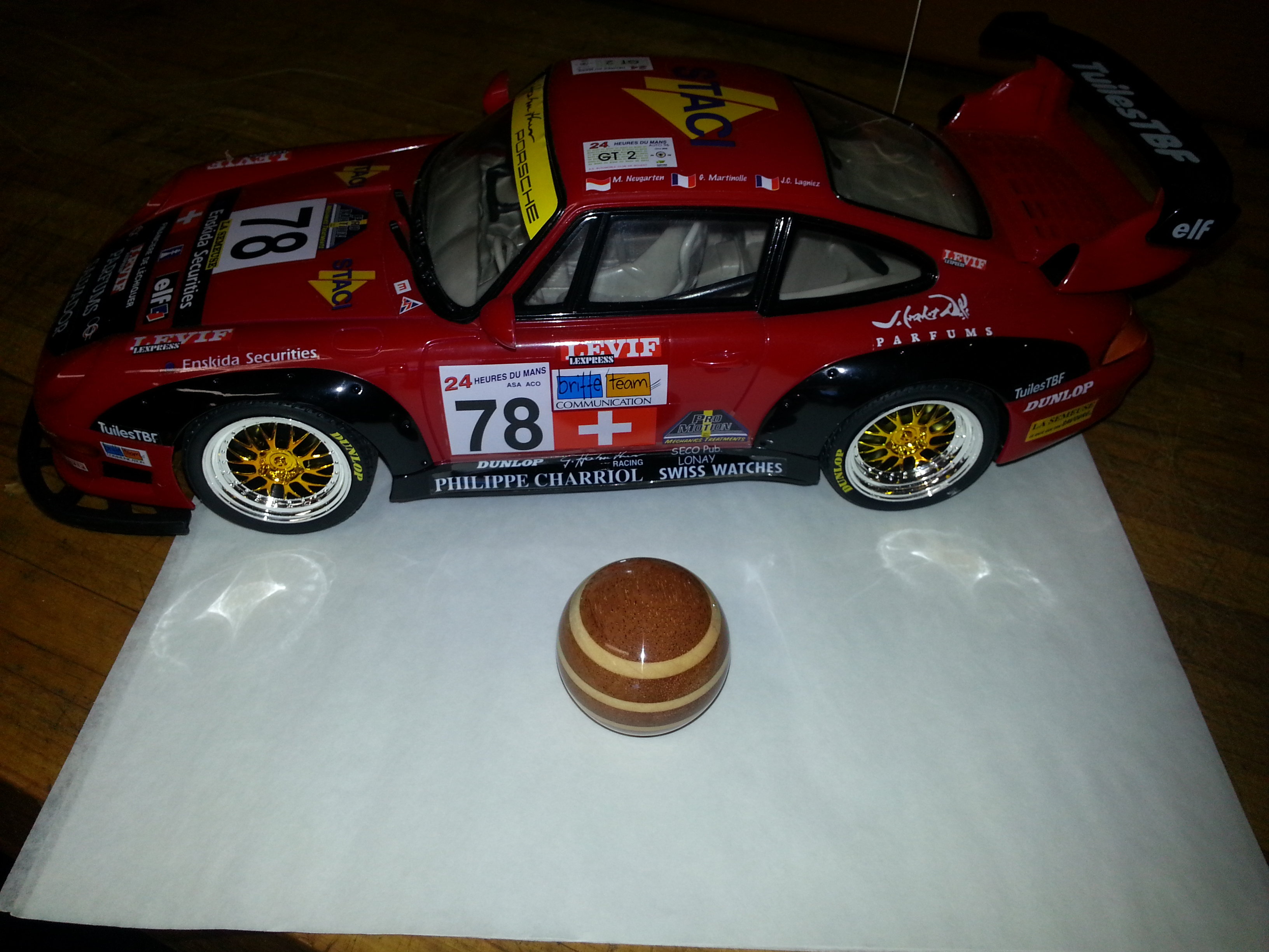

(IMG:style_emoticons/default/piratenanner.gif) Just got this cool knob in...thanks Zach (IMG:style_emoticons/default/aktion035.gif) Attached Image

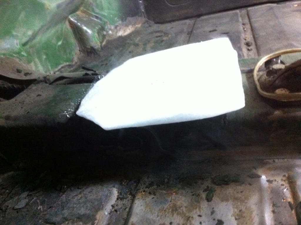

Picked up some dry ice from Fredmeyer and used it to help freeze the tar on the interior floor then scraped and pounded the crap out of it. (IMG:style_emoticons/default/barf.gif) (IMG:style_emoticons/default/smash.gif) think I need to get a few of these to remove it! (IMG:style_emoticons/default/ar15.gif)

I guess I was just lucky? Hit the tar with a heat gun and it came off in large sheets with minimal effort.

Really thought heat would make a bigger mess?

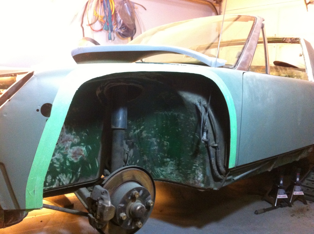

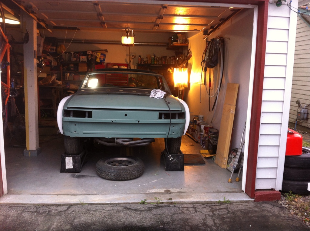

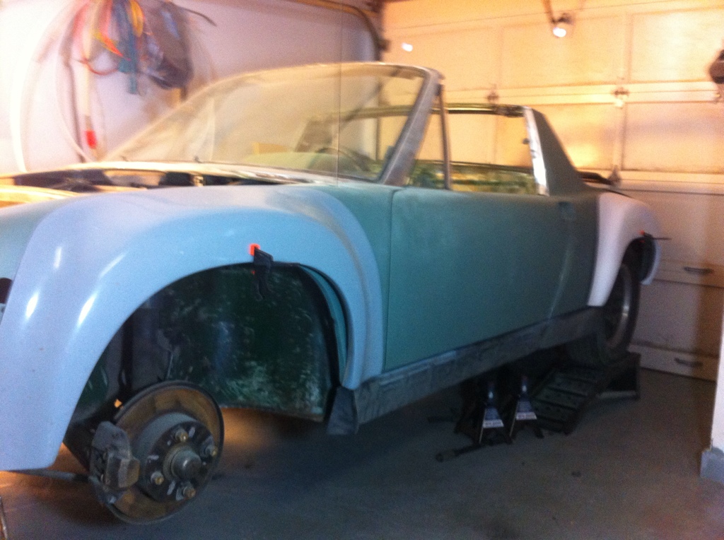

Brought out the big guns and did some cutting and some fitting of the F/G fenders ! Rears I bought off Pelican fit great, fronts picked up off a person on this forum fit like shit, seems like mold was warped edges are warped away from the body panels. (IMG:style_emoticons/default/dry.gif)

Oh ya this is a photo from last night using the dry ice!

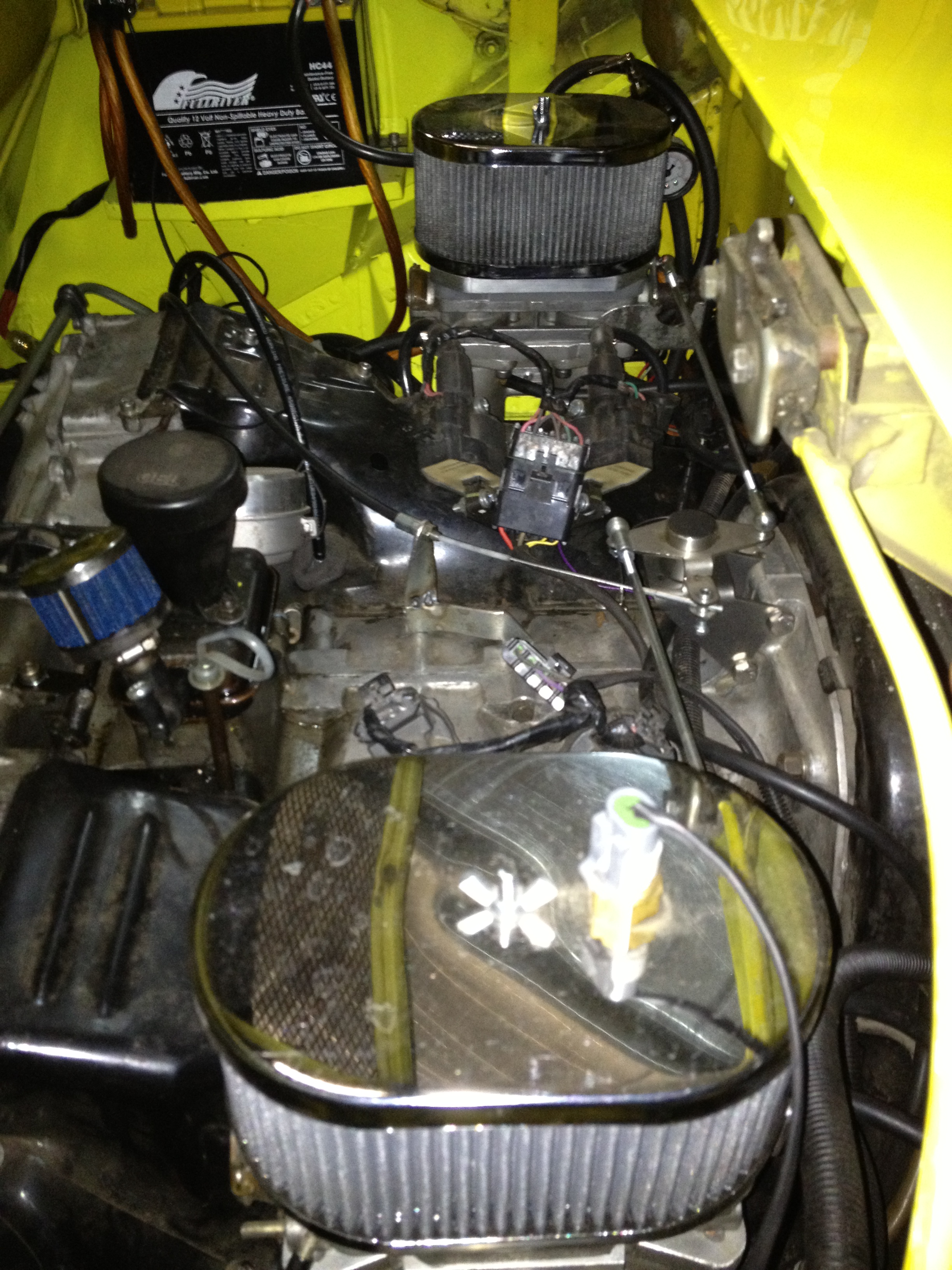

Installed shorter velocity stacks. The old ones hit the top of the air cleaner. Also installed the SVDA 034 accuspark distributor with the electronic ignition. Cheap at $90 from the UK.
