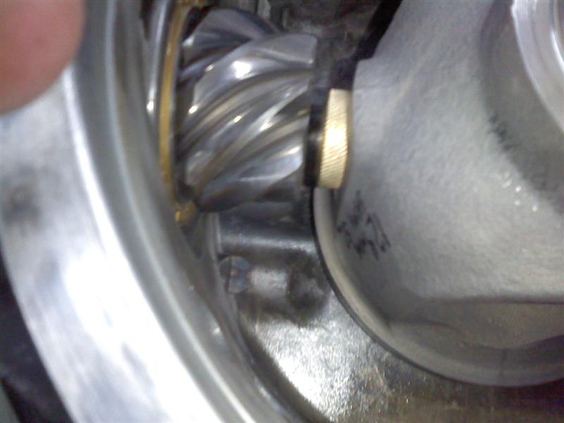

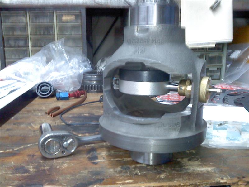

I finally got my pinion depth tool back from the machinist today and set the depth on Hershils gearbox. I had to make a few math formulas because of our modern tools and it came out perfect. But ran out of time to finish it. Tomorrow I will set the bearing preload, set the backlash, and then button it up.
Then I'm gonna finally get started on MY gearbox. Mine will be a stock 901 but will have a little "D&R GEARBOX" twist. Oil cooler, oil nozzels, the works. I am still debating on whether or not to go with a billit intermediate plate and billit side cover.
the first picture is my version of porsche tool P 285. The second picture is it going into the box.

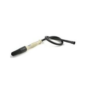

Just ordered a flow thru brush for the parts washer on AMAZON

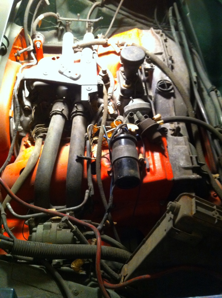

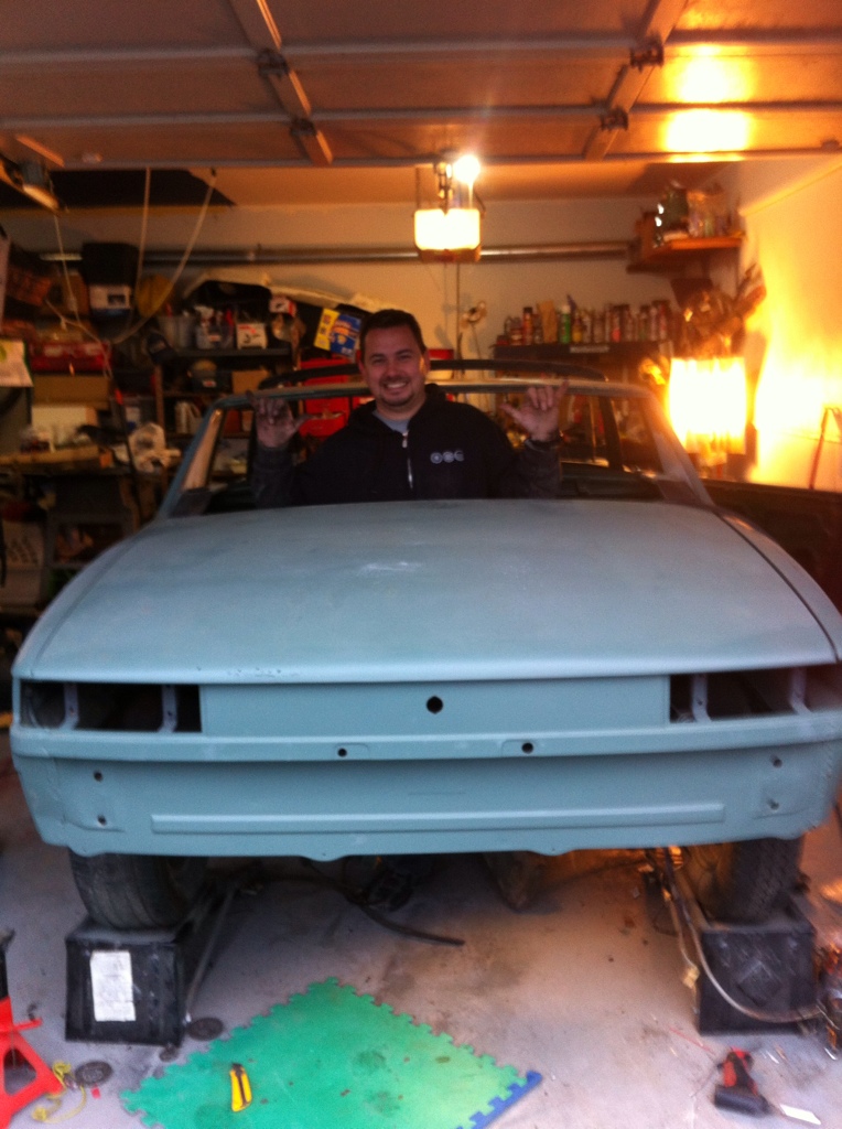

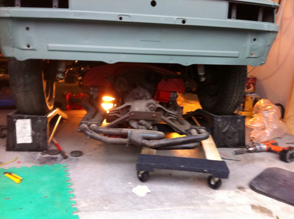

Pulled the engine in under two hours but a lot of things where unhooked from the previous owner. (IMG:style_emoticons/default/dry.gif) (IMG:style_emoticons/default/blink.gif)

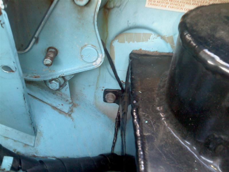

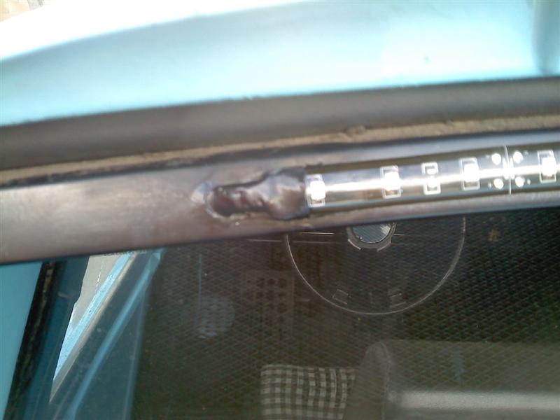

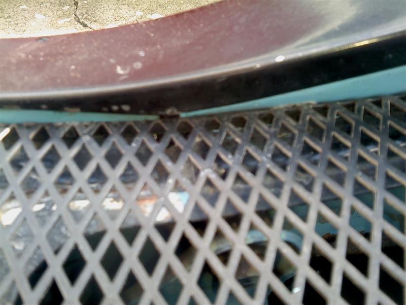

pnewman ask me a few questions about my 3rd brake light install so I thought I would answer them here. I drilled a 1/4 inch hole in the trim for the weather proof wires to pass thru. a dab of liquid electric tape for esthetics.
(IMG:http://www.914world.com/bbs2/uploads_offsite/i722.photobucket.com-12492-1359326082.1.jpg)

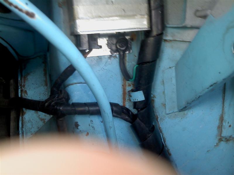

then I had to solder on some #16 wire to reach down to the harness in the engine compartment. I made my splice under the vertical trim on the driver side. There is plenty of room under there. In the next photo, you can just barely see the black wire where I penetrated into the engine compartment. I had to remove the wire mesh engine compartment cover. It is held on by three 8mm speed nuts. youll notice a shallow v where all the body panels come together. thats where i drilled a hole with a #7 drill bit. notice that the vertical trim piece forms a v in the same area? I then passed the wire thru the hole and reinstlled all the trim and wire mesh.
(IMG:http://www.914world.com/bbs2/uploads_offsite/i722.photobucket.com-12492-1359326083.2.jpg)
then i ran the wire behind/thru the rear trunk hinge and carefully routed them so they wouldnt get hung up on the hinge when the trunk was opened and closed.
(IMG:http://www.914world.com/bbs2/uploads_offsite/i722.photobucket.com-12492-1359326083.3.jpg)
then i carefully cut into the loom and soldered the positve wire onto the brake light wire, black with a yellow tracer. then wrapped the harness up to be weather proof. there are a couple brown wires in the loom but i didnt use any of them. i think the trunk light is on one of them i didnt spend the time to see if grounding it would turn the trunk light on. so i took the easy way out and grounded it to the chassis.then another dab of liquid tape on the screw head.
(IMG:http://www.914world.com/bbs2/uploads_offsite/i722.photobucket.com-12492-1359326083.4.jpg)
thats it. then i gave it the smoke test, and it worked just fine. and it is protected by the stock brake light fuse.

Doug wanted me to mention that he and I thought it would be important to recognize the ground post that could be utilized for the third brake light wiring in this instance without cutting into the stock harness. It is located in the engine compartment below the circuit board on the drivers side. Not necessarily easily accessible for all (Doug is running a dry-sump) but it would give you an opportunity to clean the grounds there and add a little dielectric grease while you are there adding the additional ground. Good PMCS (Preventative Maintenance Checks and Services. I give my military background away sometimes.)
Thanks for posting the details of your 3rd brake light as well as the routing. That is a huge safety feature! Especially when considering that all cars have a 3rd brake light as standard equipment. Younger drivers might not think that we are braking without it.
I am still on the fence as to how I want to proceed but a 3rd brake light is definitely in my cars future.
