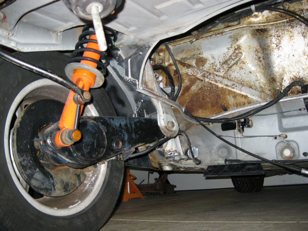

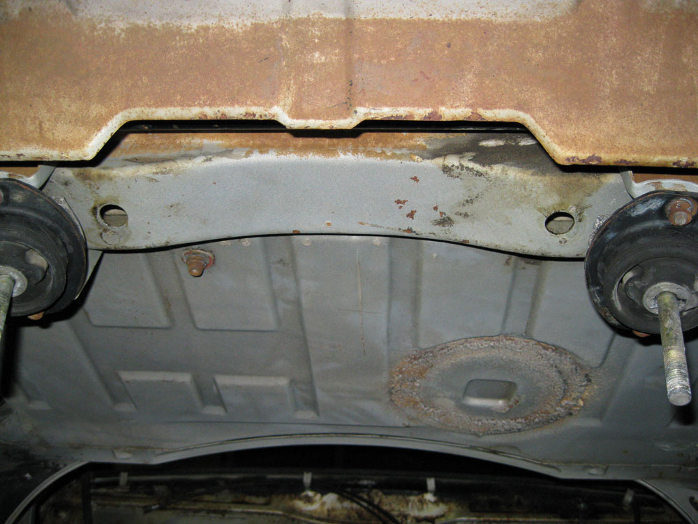

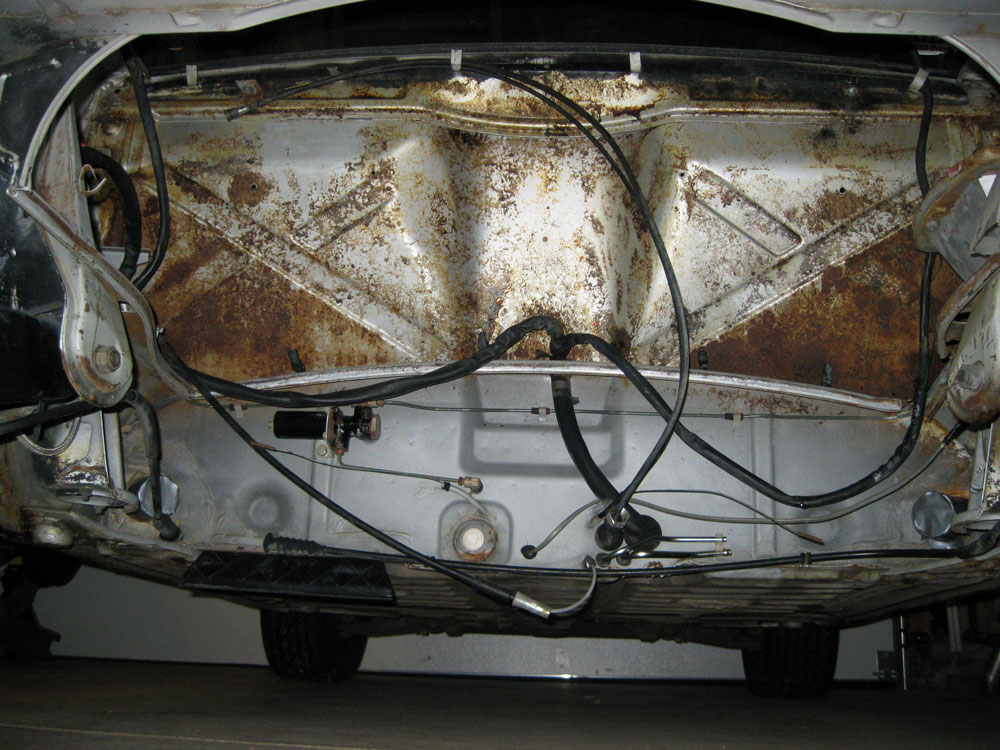

Progress! After pulling the car off the road over a year ago to fix a bad rear wheel bearing and massive oil leak, today I got the car off the jackstands, out into the driveway, and proceeded to power wash every thing in the rear of the car. The previous owner lived on rural property down a long dirt road. Mix that fine red clay dust with fresh oil and you have a petrified mess! I also decided to pull the trigger and go 5 lug (Eric Shea group buy). So back into the garage and back up on the stands. I'm excited again to be working on the car!
Oh, I also decided to pull the tattered backpad (sponge) out. I'm glad I did. Plenty of surface rust and a couple of spots to patch up. Dang!

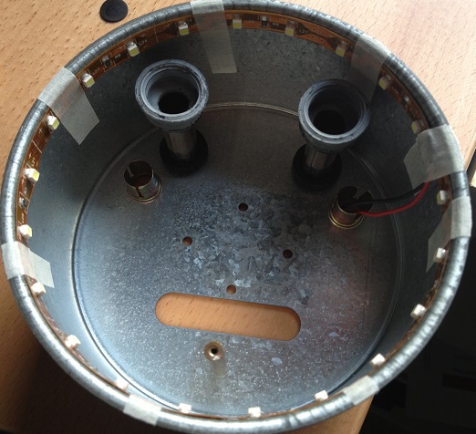

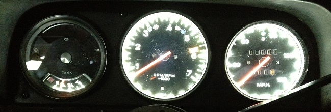

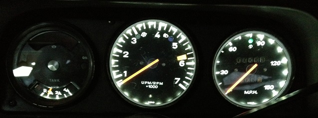

In honor of our COTM winner (Al Garcia), I decided to spruce up my gauges with some LEDs. (IMG:style_emoticons/default/evilgrin.gif)
I had no idea what the hell I was doing but it came out pretty damn nice...and bright as hell.
Rubbed some rubbing alcohol on the insides to clear any oils and grime then stuck the led strip right behind where the glass circles sit. Taped them in with heavy duty masking to let the adhesive set.
Plugged the light holes with vacuum plugs, grounded the LED off of each gauge ground and spliced the wire into the lighting wire. Not too shabby
I really should have sourced some glass circles instead of reused the scratched plastic crap I have, but thats an easy enough change later. As you can see on full bright the scratches reflect so bad its just a bright light...doesnt look as blinding bright in person though.
