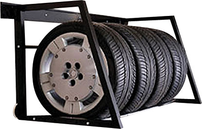

Did a lot of organizing of the garage today, put up a tire rack, a pulley system to lift the engine up to empi bolt on engine stand. I bolted the stand to a post in the garage but also modified it to fit my rolling stand too. I used a Thule box lift to store two trunks and a hood to get them off the floor and out of the way. I'll try to get some photo's once I get it cleaned and finished.

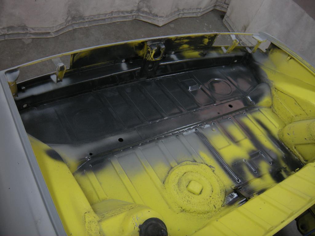

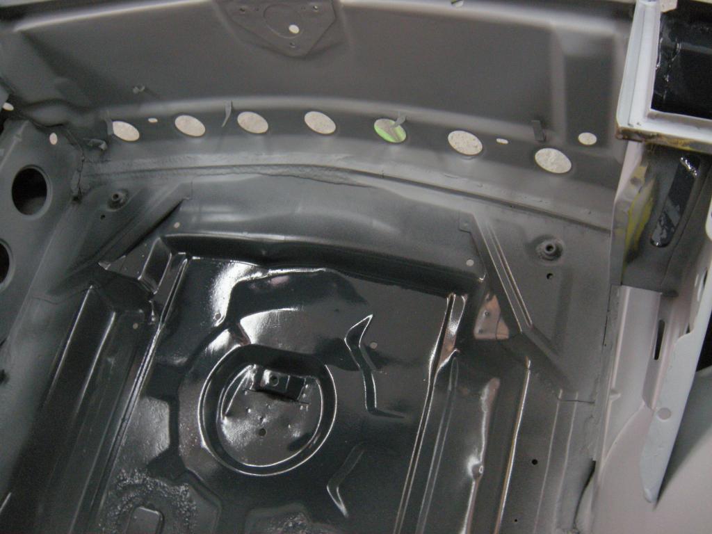

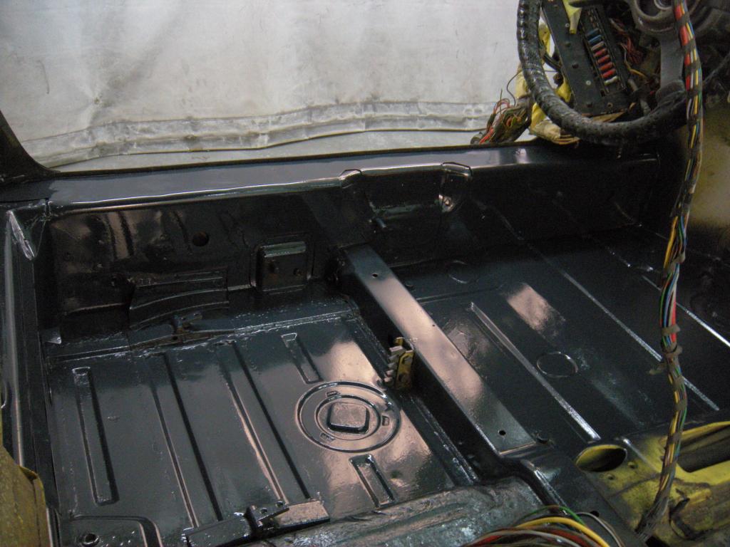

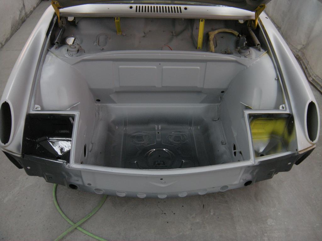

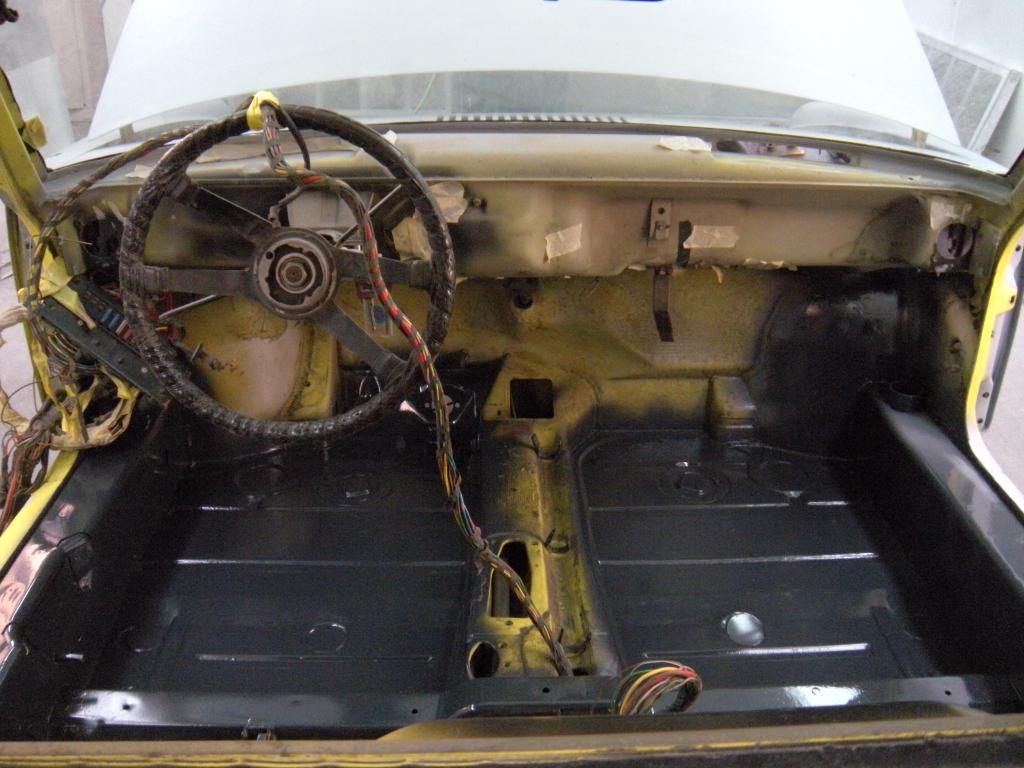

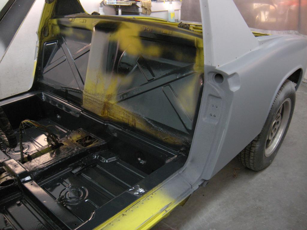

Epoxied and primered floors etc (IMG:style_emoticons/default/piratenanner.gif) :
(IMG:http://www.914world.com/bbs2/uploads_offsite/img.photobucket.com-12969-1363035915.1.jpg)
(IMG:http://www.914world.com/bbs2/uploads_offsite/img.photobucket.com-12969-1363035915.2.jpg)
(IMG:http://www.914world.com/bbs2/uploads_offsite/img.photobucket.com-12969-1363035915.3.jpg)
(IMG:http://www.914world.com/bbs2/uploads_offsite/img.photobucket.com-12969-1363035915.4.jpg)
(IMG:http://www.914world.com/bbs2/uploads_offsite/img.photobucket.com-12969-1363035916.5.jpg)
(IMG:http://www.914world.com/bbs2/uploads_offsite/img.photobucket.com-12969-1363035916.6.jpg)
Blocking and re-prime outside next !! LOOK OUT SO COOL ANDY, ANOTHER YELLOW
ONE IS COMING (IMG:style_emoticons/default/chair.gif)

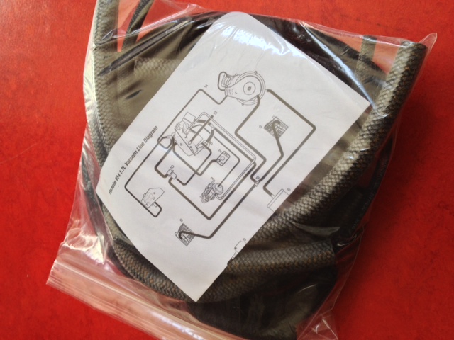

just got these in the mail. nice and new vac hoses and they have that great new rubber smell. going to install them under the watchful eye of Mark aka euro911 when he helps me lower the front end. i have had a small idling issue for the last month or so, should cure it.

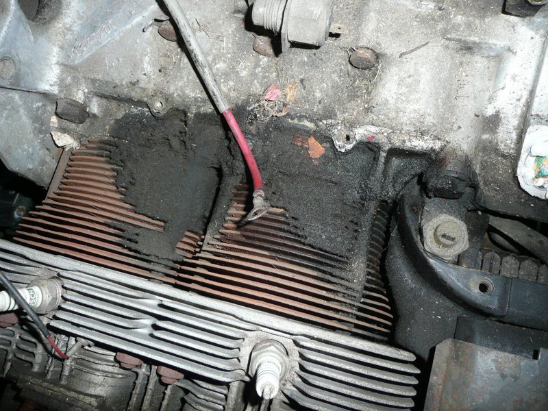

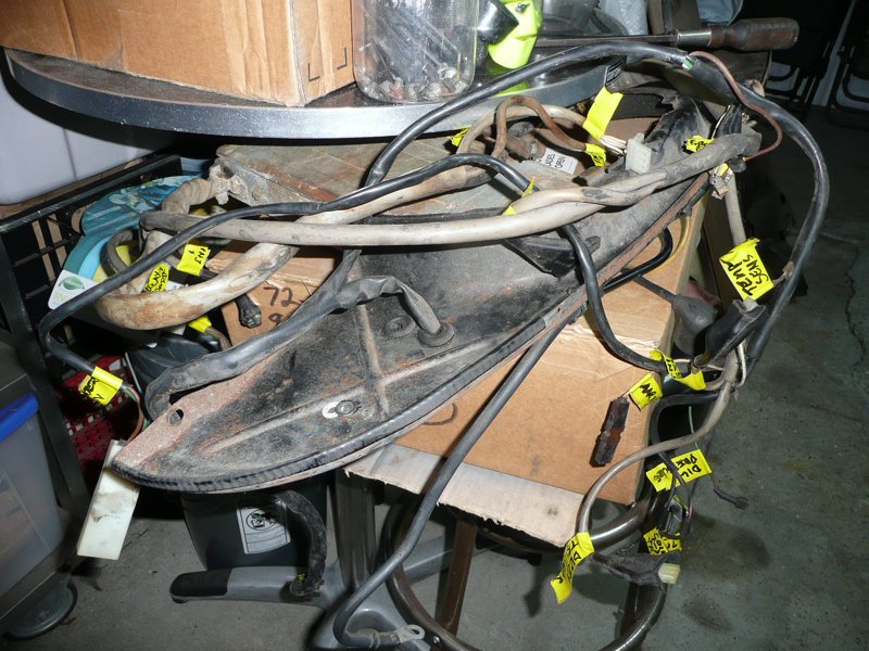

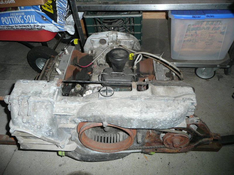

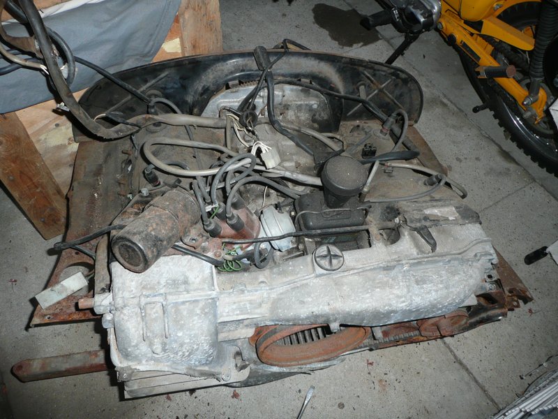

Started tearing Dianne's 1.7L motor apart. Removed the FI stuff
Labeled and removed all the electrical wiring
Only got this far this evening
Looks like we caught it in time, some ugly stuff in there (IMG:style_emoticons/default/sad.gif)
The ODO stopped registering at 108k so I don't know what the actual miles are on this engine, and I got fluctuating readings the last time I adjusted the valve clearances. I suspect worn cam bearings, but we'll see what all it needs after the tear down and inspection.

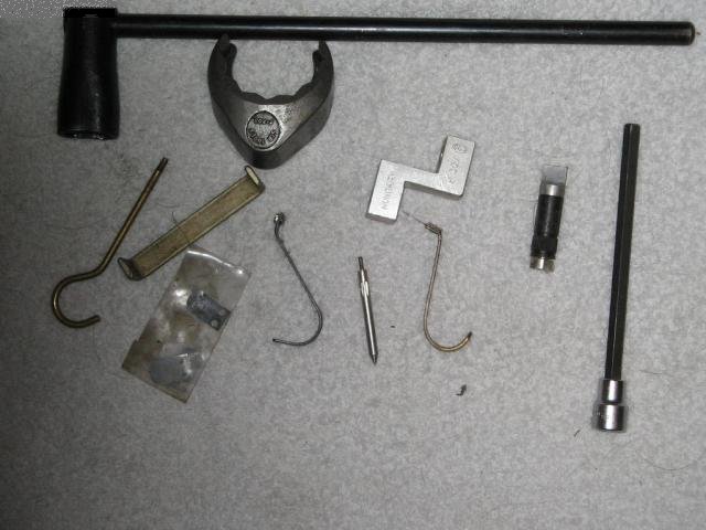

Also bought an extra set of some 911 tools (IMG:style_emoticons/default/smile.gif)

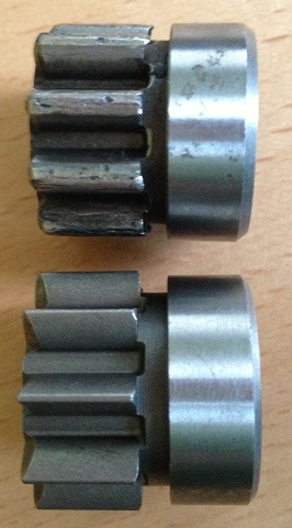

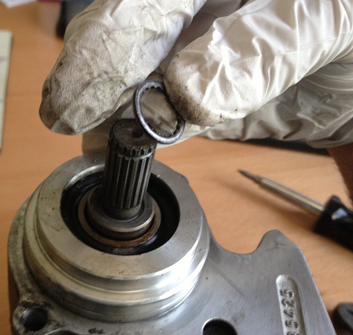

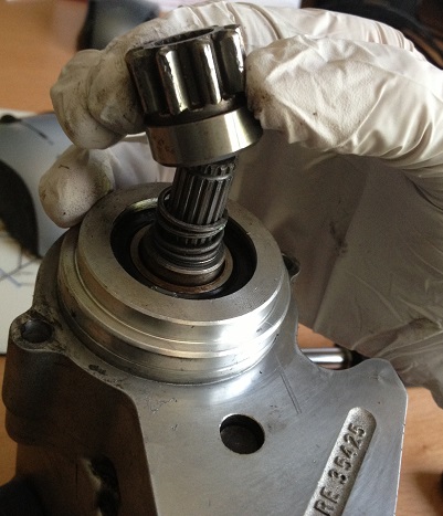

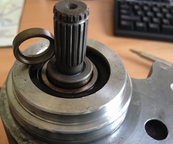

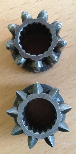

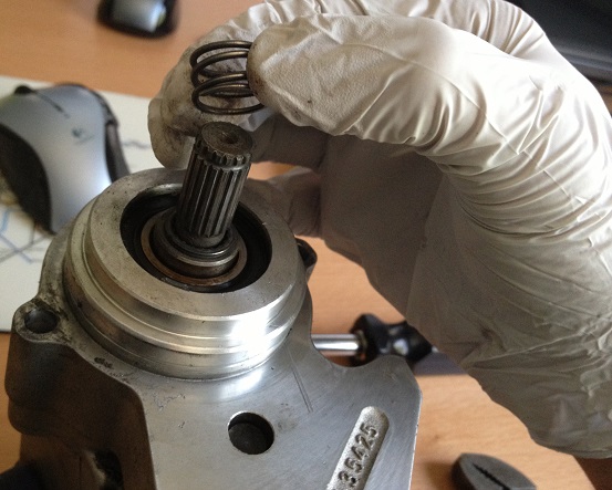

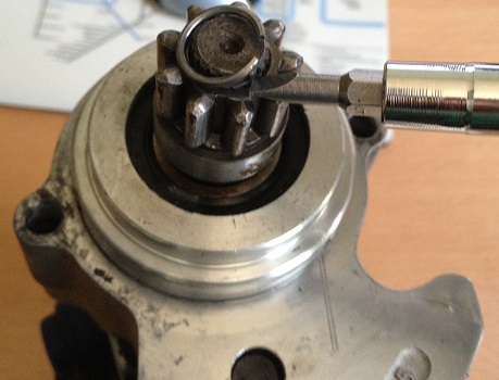

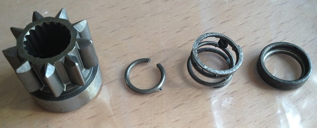

Replaced the starter pinion on my IMI hi torque starter. CB Performance sells these for under $20 so I bought 2. That grinding noise is haunting when you hear it for the first time, and you cross your fingers that your ring gear is not destroyed. Thankfully my ring gear is fully in tact.
The kit comes with the pinion gear, retainer clip, gear spring, and a bushing.
Push down on the gear, and remove the retainer clip
Pinion slides right off
Remove the gear spring
Remove toothed washer
Remove if you can the bearing bushing to replace. I could not and I didn't have issues with my existing bushing so I decided to not attempt to break things (for once).
Assembly is the reverse of disassembly...duh!
Worn gear/New gear

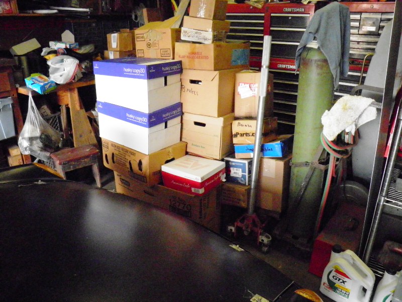

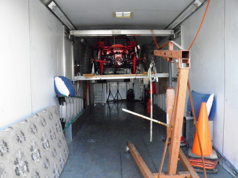

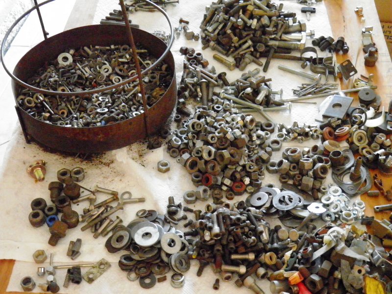

I've been sorting parts a packing for weeks now.
Parts already sorted.
A space for the car to go thru.

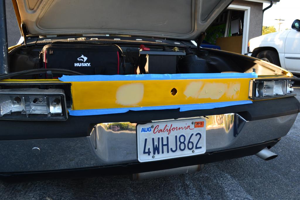

Weld, grind, fill, sand, prime, then paint. More to come tomorrow, all in the process of installing the badge that I've been looking for since I've owned my 914, courtesy of Dan Ellis. The back panel will get painted satin black to accent the gold badge. Thanks again man!

QUOTE(Joe Sharp @ Mar 15 2013, 03:24 PM) *
Wow, you ain't foolin' around are you ...
Do you need some empty (clean) plastic P-nut butter jars for your hardware collection?
LMK
