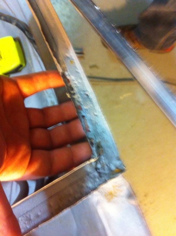

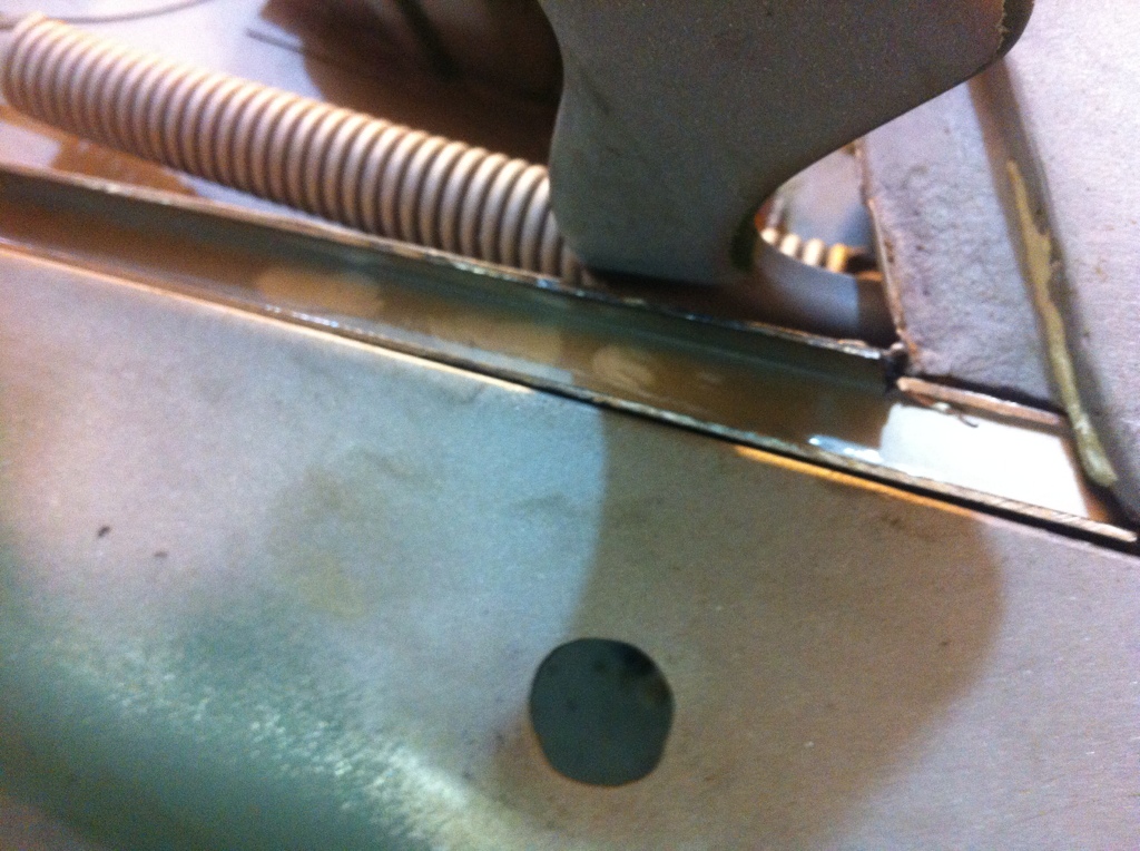

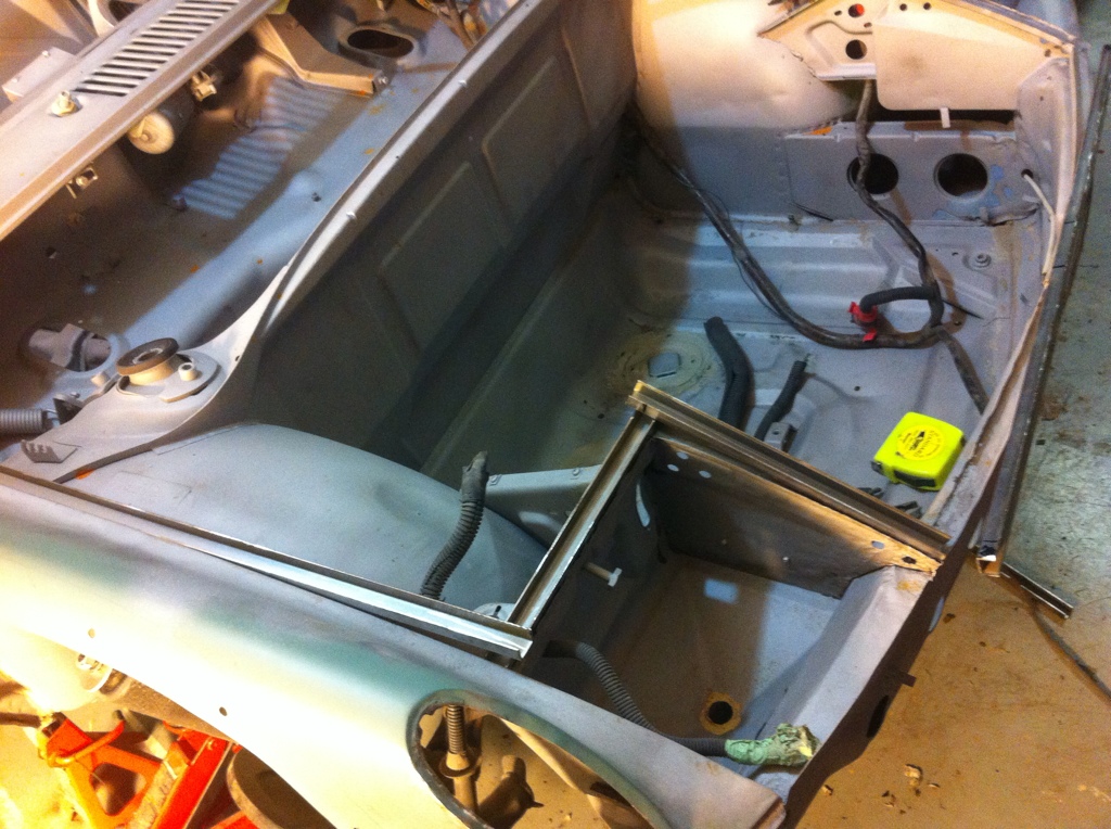

Working on the front trunk rain channels as they are half rotten been trying to figure out the best was to do this? Ended up buying some 3/4" square tubing and ripped it with my table saw with a 10" 3mm chop saw blade down to a 1/2". The width is perfect just not sure if the 1/2" is going to be too deep once I get the trunk rubber in. Also the metal tubing is fairly thick gauge but was thinking it might work as a cowl brace and stiffen it up a bit.
I'm still a little confused if I should spray the car in primer and just tape off the rusty sections till I fix it? Or just fix the rust and spray the whole car when it's done? It's in a heated garage but have a couple of areas getting a little bit of flash rust.. I spent a lot on getting it blasted so I don't want to waste it.. If I do prime it I'm just scared of the metal bits getting stuck into the fresh primer paint.

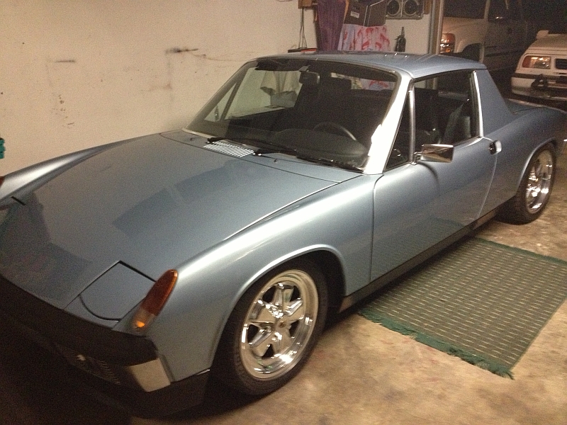

Looks Great !!!
(IMG:http://www.914world.com/bbs2/uploads/post-5956-1364256371.jpeg)

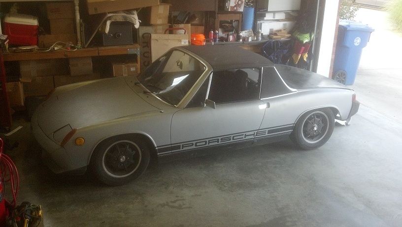

Posted October 2012:
QUOTE(kwfast @ Oct 7 2012, 01:29 PM) *
Swapped the wheels front to back, back to front and now the vibration is in the steering wheel. Hopefully that means a balance job only.
Simple stuff first...simple stuff first...simple stuff first...........
Will try to get that taken care of this week. Thanks for the help.
poorsche914 --->> was this your car at one time ?, I'm in the Chattanooga area.
(IMG:http://www.914world.com/bbs2/uploads_offsite/dl.dropbox.com-14977-1349645351.1.jpg)
